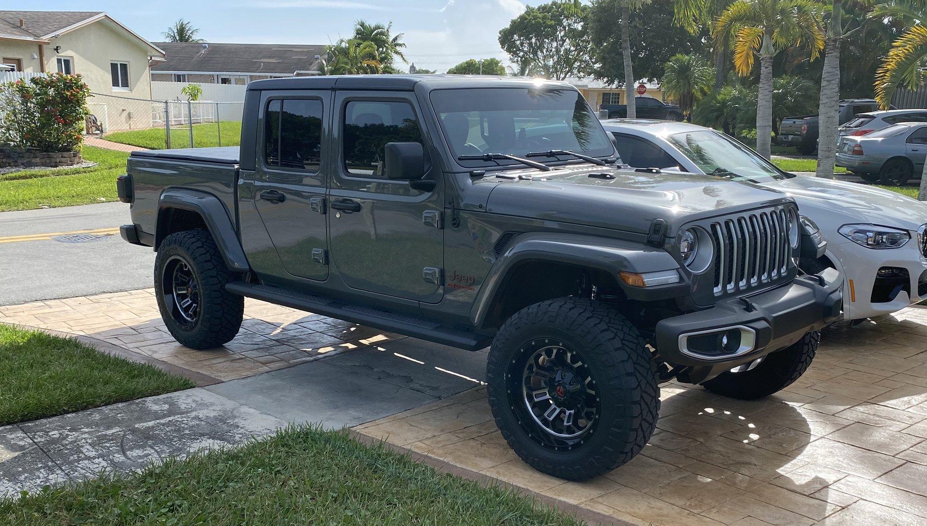

I just did the JKS 3.5 and love it. Perfect height for the JT on 35s IMHO. I opted for the added front LCAs and JKS shocks. It’s more firm over factory suspension without being harsh. Compared to factory the JKS corners flatter, mitigates body roll better on rough surfaces, and handles weight in the back better.
The JKS has multi rate coils front and rear over the RE multi rate rears and linear front coils. You should see less sag when adding weight on top of multi rate coils over linear coils. I love my lift! It’s like having a whole new truck!
PLUS the JKS is less expensive!
Nice ride! How are the JKS shocks holding up now? Have they caused you any issues? I ask since I plan to go JKS but for cost savings, thought to go with theirs first and then once they felt worn, replace them with something much nicer and allow myself some more time to plan for them.
