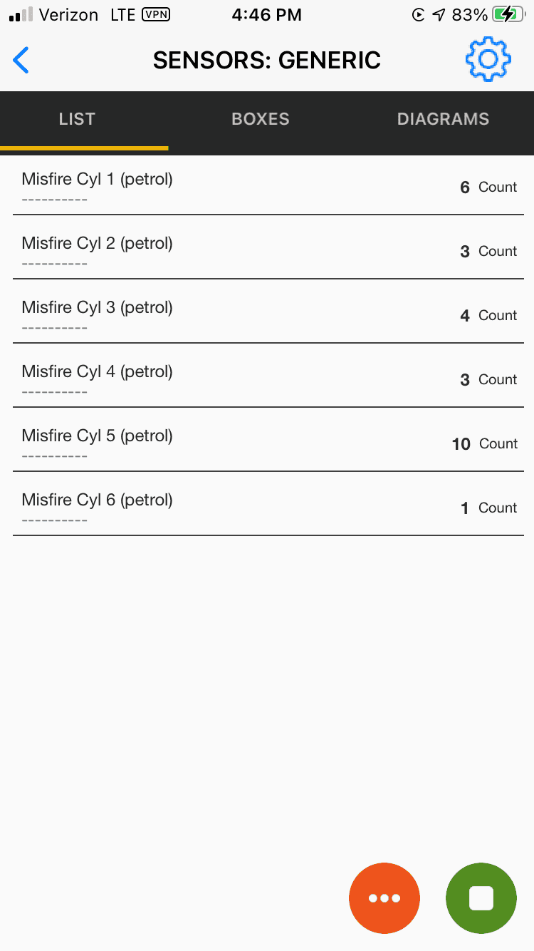

My JT has done this a handful of time so far...I cant catch the code and im all of 500 miles from the warranty expiring. So I doubt it will be a covered problem with a TSB anyway.

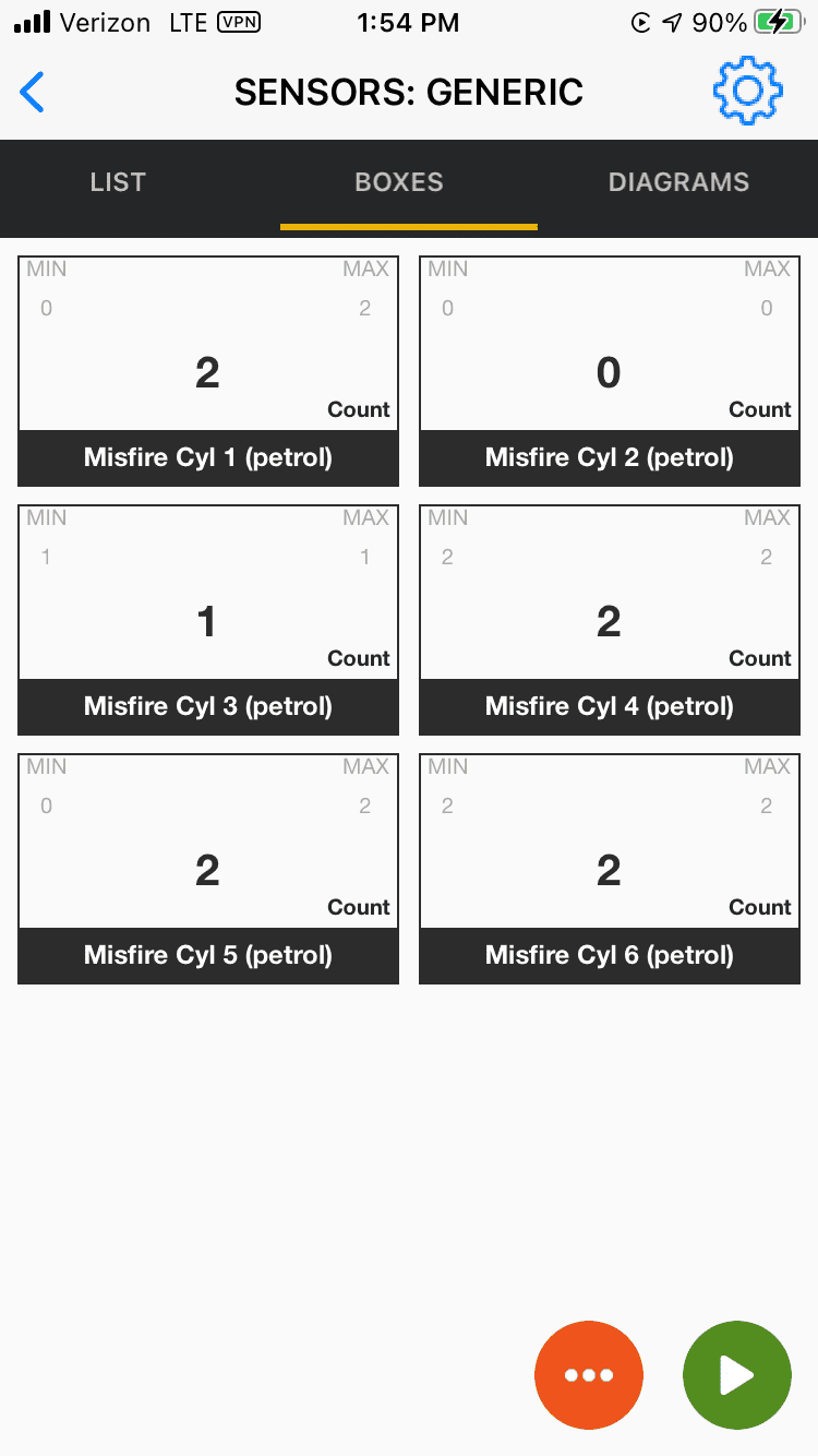

I ended up getting a different obd2 reader. And downloaded (and paid for) the jscan app before seeing this.
so far i can see misfires, but nothing like a report you have here. Are you familiar with jscan app at all? Id love to have more than just these screen shots to take to my dealer.

Depending on the time frame that is not an alarming number of misfires. I have had my jeep on the dyno to adjust the timing map. Not sure if the timing maps are all the same or close, but there where some very ruff spots, in the lean cruise, light load areas. If you drive lightly the throttle will adapt to a light agression factor and the acceleration enrichment is not enough in cold weather to account for tip in. If you do an adaptive learn reset on the engine and transmission. It will go away for a while. If you do the reset and drive like a teenager it will go away for a long while. My guess is you where judicious with the throttle taking it to the dealer so it clipped up the agression factor and you had the needed fuel on tip in. I am not sure how FCA did the mapping on this latest go of the 3.6, but all the info I have seen so far would indicate they messsd up a bit
i always drive conservatively so im not sure thats the issue. But is it really normal to have misfires like this? I notice them while driving and have them show on the app. Seems like its not normal to me but im far from an expert with engines
The counts are normal, if you are feeling them that is not acceptable. Is it broke not nessicarily. I have seen some information that unfortunately it is tuned to potentially run like this. The good news is at low powerit will not do any damage for a long while, and you can stop it if only temporary. The TSB software I have seen just dumbs down the diagnostics, which is not an acceptable fix.
To add to this most engines have some misfrire that happens as transients happen with throttle and shifting. As long as the counts don't accumulate under power, it usually is insignificant. They should also be mostly imperceivable. As it is a quick second on tip in or abrupt downshift. You actually hear this on modern muscle cars and people compliment the raspy exhaust

well that atleast makes me feel a little better. Im still going to have my dealer do a quick scan just to see if there are codes I am not seeing. Just seems odd that in addition to feeling the jutter ive lost 2mpg recently for no real reason

The TSB resets the adaptive learn and then slows down the adaptive learn. This keeps it from messing with the engine rating. Then they make the misfire monitor more tolerant. This will quell misfiring, not sure if it does it long term. The engine is set up to run LEAN.
I also have found the throttle dlictuates and causes what feels like a hesitation or misfire, but it isn't it is simply the throttle blades cyling during a steady state acceleration. I am fighting this on my tune right now.
