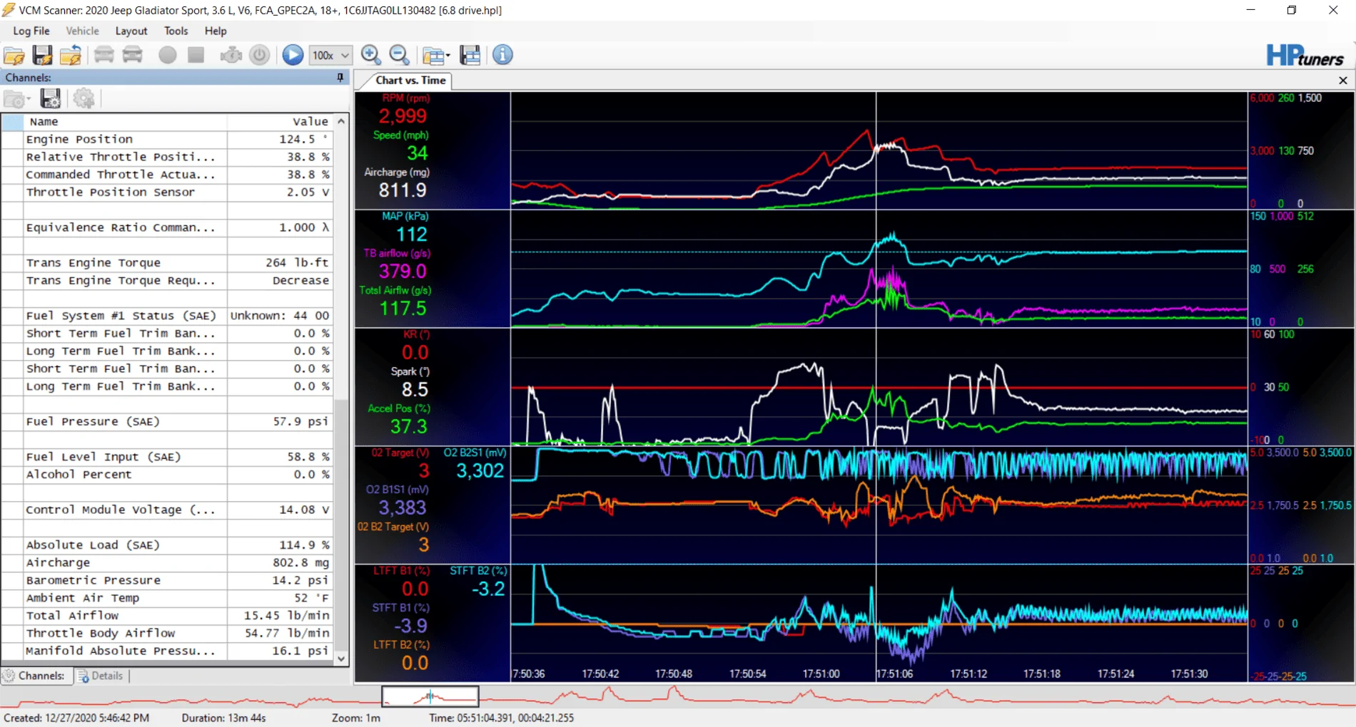

look at the top of third gear. No misfires are shown. It sure felt like a misfire. Looking at the data it was just the throttle moving on it own under load.

The TSB resets the adaptive learn and then slows down the adaptive learn. This keeps it from messing with the engine rating. Then they make the misfire monitor more tolerant. This will quell misfiring, not sure if it does it long term. The engine is set up to run LEAN.
I also have found the throttle dlictuates and causes what feels like a hesitation or misfire, but it isn't it is simply the throttle blades cyling during a steady state acceleration. I am fighting this on my tune right now.
That's likely what my wife felt when she was driving her GC AFTER the TSB was performed. She said as it shifted it almost felt like a misfire, but it wasn't. She was trying to speed up to get into another lane and had some pressure on the throttle and she said it wasn't the shifting, but felt like the engine did a slight hiccup as it was shifting. She's normally pretty light-footed with her GC (thus the 26+ mpg LOL)

I have managed to fix most of the oscilation in the throttle for most situations. It required going to a dyno and doing some adjustments to the timing and maximum brake torque angle setting in the torque management control. I am not sure what the issue in the picture is caused by, but I have seen it in two stock jeeps in second and third though not as severe as what mine does. I assume it is due to my supercharger hitting the limit with more gusto.
