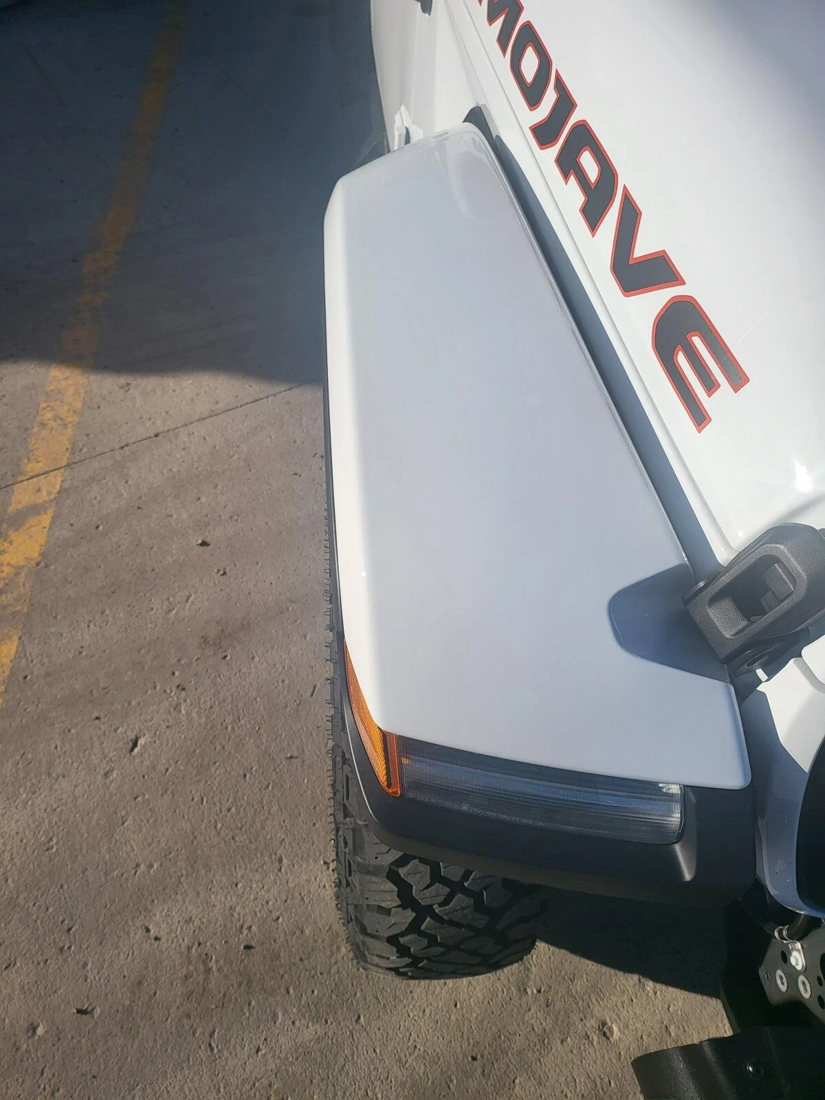

Okay thanks. This is what threw me off:
"I'm content with the lift so far as it's not huge compared to my 37s and 2 inch on the Rubicon."
BTW How much do they stick out ?

Gotcha, yeah I meant the little extra the larger tires give.
Jeep Gladiator Jon's Jeep Build 20211109_142655

Wow, they don't seem to stick out at all. Thx for the picture.
Can you give me the size numbers on those tires ?

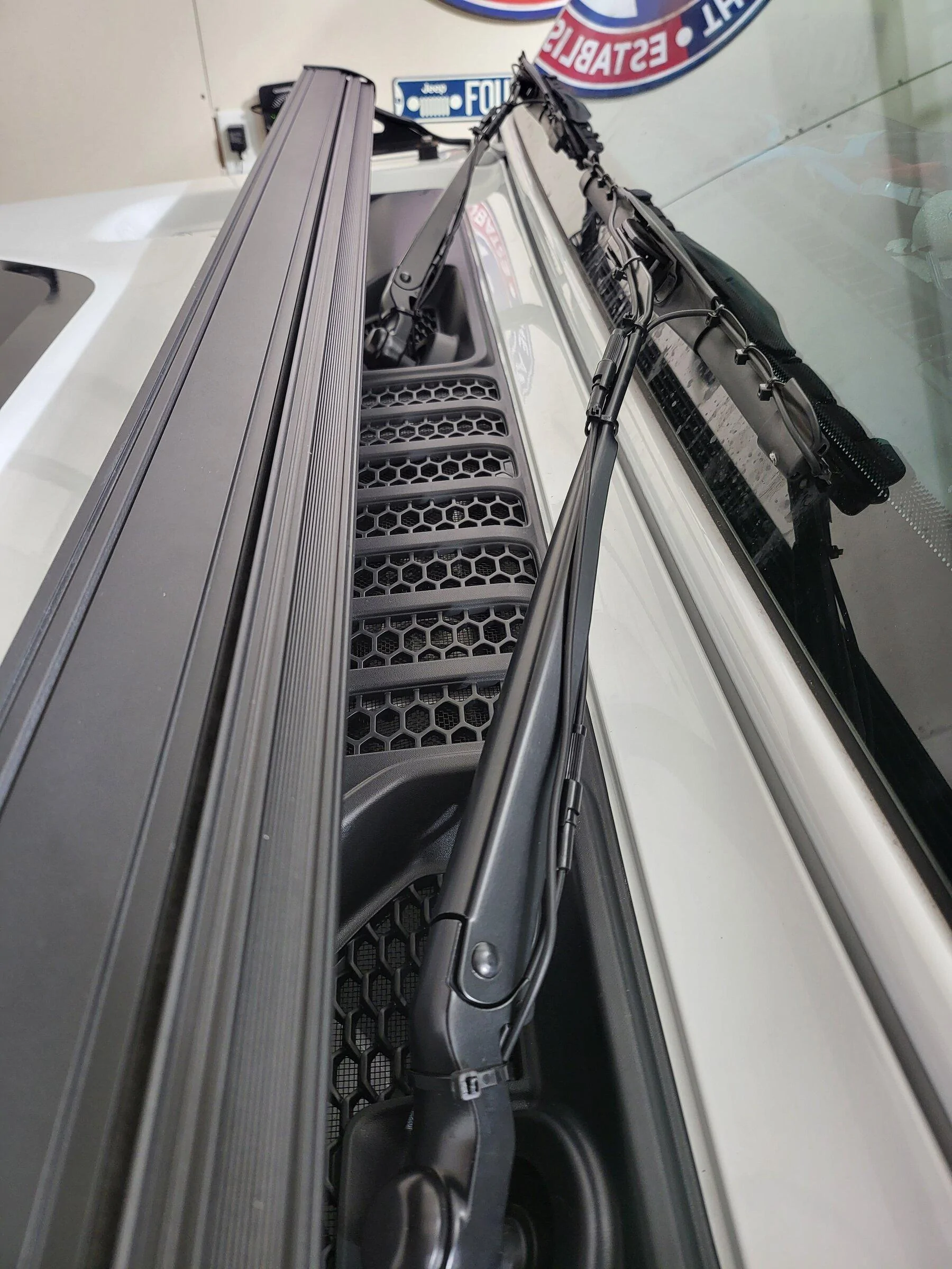

Installed my heated blades from my last JT onto the Mojave:
We are at around 6" of snow, which my Kendas handed beautifully, and have another 6" expected.
Ive never heard of or seen heater blades. Pretty cool. Have a link?
