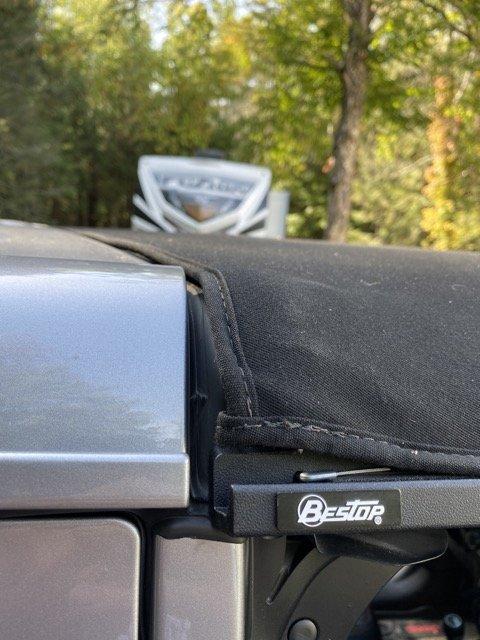

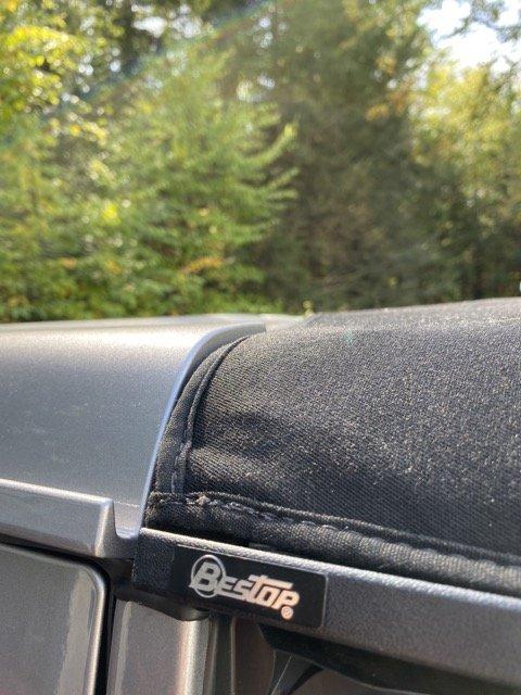

Ok .. so a bit more detail here if you please.. I have the EXACT same bubble going on. I emailed them as well they said to check the hooks I did that they are in correct. What is not straight..just so @Pat2Alaska can make fun of me.
K, so that rear fit is annoying me, I'm NOT in denial, I'm relatively sure I am the cause of it, but keep tightening and it's just not sitting right.
K, let's get BesTop involved:
Hey Bestop PEEPs!
I installed a Sunrider on my Gladiator, LUVIN IT!
The two rear corners aren't sitting down, (see pics)
What'd I screw up?
THX!
JP
24 Hours later, Adam emails me back:
You so STUPID!
The rails are ALL FUBAR'd.
Take it ALL apart and reinstall it STRAIGHT this time,
AND BE SOBER dammit!
embarrassing...
THIS is why we had to start offering install service.
OK, not those EXACT words, but you get the jest of it...
Low and Behold, when redone, IT FITS!
I've suggested to BesTop that they start IQ testing prospective buyers first.
Adam replied with, I wish...
and that last part IS 100% true...
I removed all 10 bolts and realigned the side rails to line up better with the rear rain gutter.Ok .. so a bit more detail here if you please.. I have the EXACT same bubble going on. I emailed them as well they said to check the hooks I did that they are in correct. What is not straight..
(I left it all together, on the JEEP, just undid it as one piece)
My hooks were correct also, the key is to get the gutters lined up.
As soon as I got those lined up, the thing just kinda decided to behave and sit down right.
Look at the gutters on the before/after pics and it makes more sense.![]()

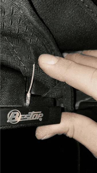

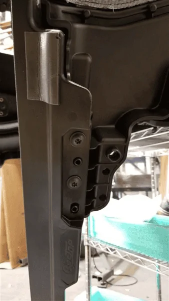

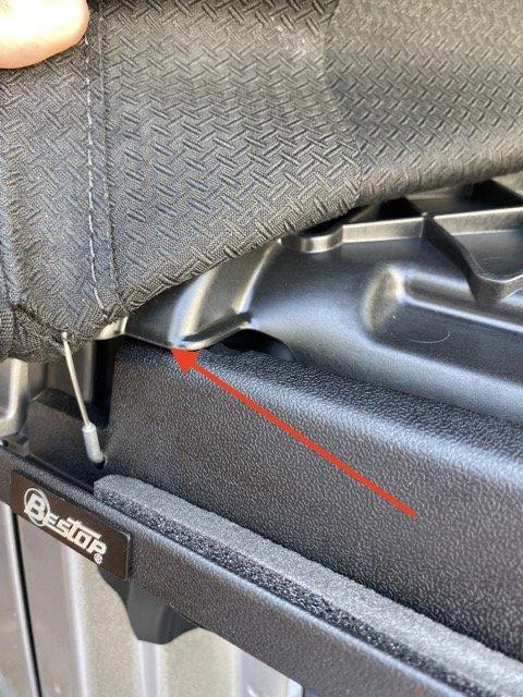

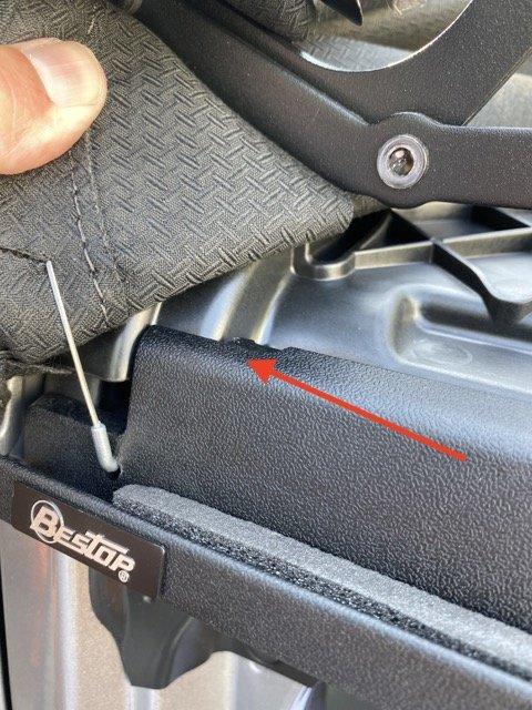

Ok so I got out there earlier and fixed mine. I searched all over to find the directions but I must have tossed them I swear it says put the side rails on then put the top on top of them. However evidently there is a part where it says tuck it under the side rails that I missed as well ( I'm joining the club ). But I took pics so hopefully it will make sense to others.
With the hump...
You can see here the top is on top of the rail..
I took out the 2 bolts holding the top to the side rail and loosened the bolts holding the rail to the roll bar. And Tucked the top behind it
No hump..
But I swear I didn't see this in the instructions.. It said mount the 2 side rails.. then put the top on top.
Maybe it was my two teenage sons that messed it up ..
