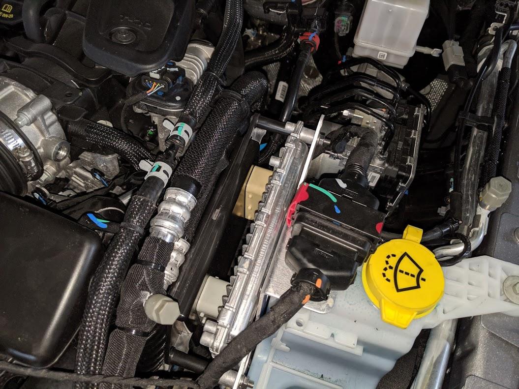

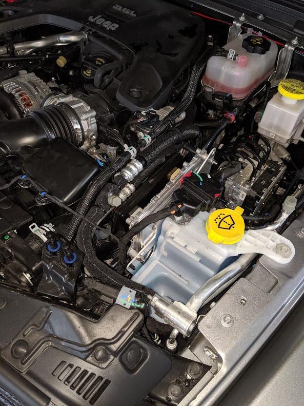

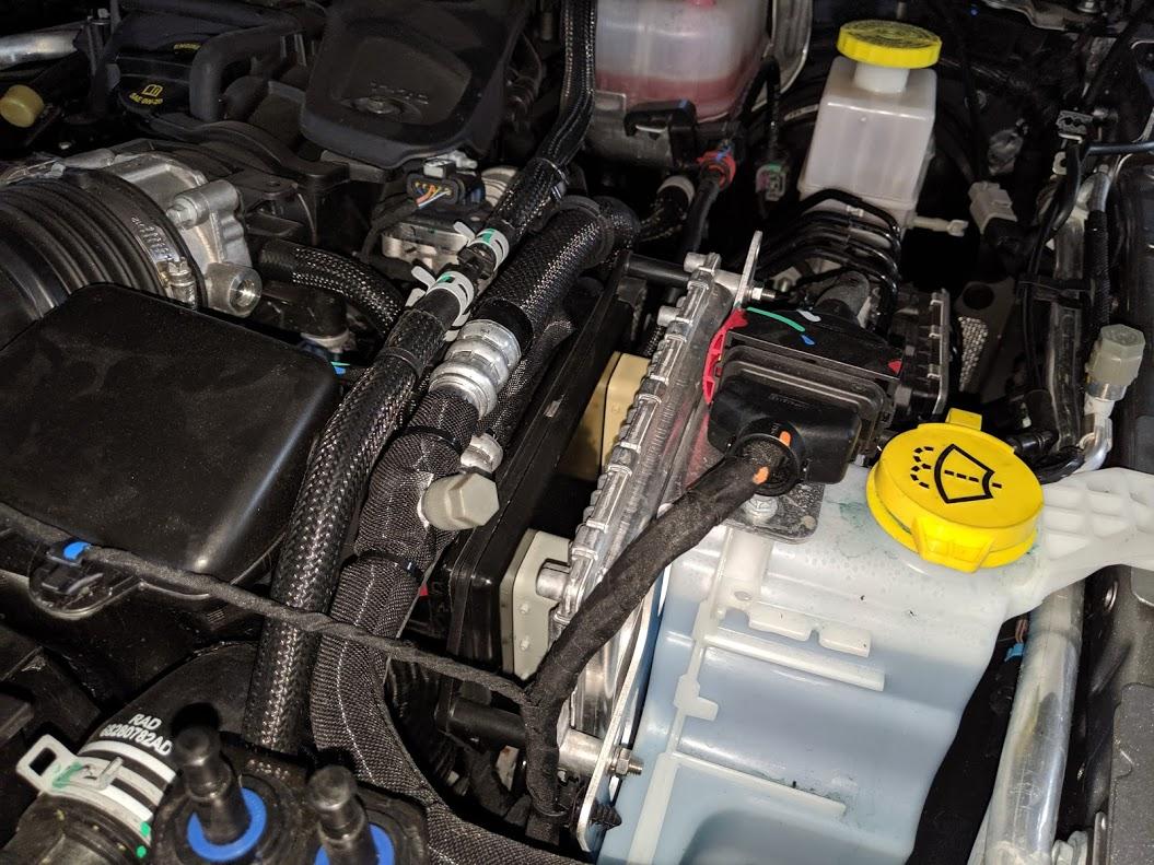

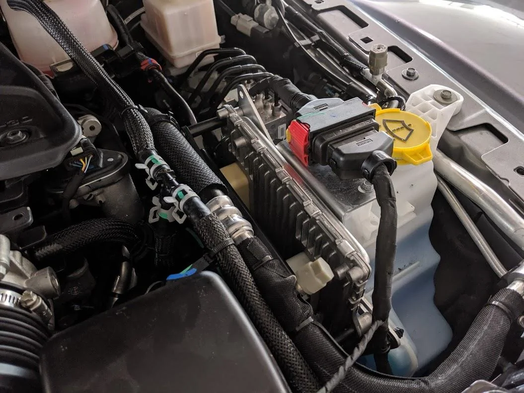

A little bit late to this thread, but a great looking build! By any chance do you have a photo of the Pulsar programmer installed? If the earlier pic showed it then I must be partially blind, cause I couldn't pick it out. Will be seriously considering that when I finally get my hands on my Gladiator (it's in JB status as of Monday).
pull ECM and ECM mount
Replace ECM mount with Pulsar mount
Attach Pulsar to ECM
Attach contraption to Mount.
Done:
Done:
Jeep Gladiator JP's Super-Duper-Gladiator Build Thread {filename}
You gotta get into the habit of wiping under the hood down with a microfiber cloth every time you open the hood, it is starting to get dirty :surprised:;). LOL

OK, so I got this thing in today.
DISCLAIMER, I'm ONLY using it for the modes as I already have a TAZER-JL Mini.
Install:
sucks.
So, it took me just under an hour, BUT remember, I need a damn ladder just to reach the ECM. most of this is the OEM mount removal/new mount install.
Now, with that said, I'm pretty sure that I could pull this thing tomorrow if needed for a dealer visit in 15 minutes or less.
I'm going to change two of the bolts from the mount to the ECM/Pulsar to some type of quick release. If this works, it'll be a 5 minute swap. There'd be NO reason to change the mount, just unplug the two plugs, quick release it from the mount, separate the ECM and Pulsar, put the ECM on the mount and replug it.
So, I flipped thru the settings, and my first 'seat of the pants' impression?
only 20 miles or so today.
HOLYCHIT!
This is one of the best things I've done!
Stock: Stock
ECO: This will be my interstate road trip setting, seemed to like 8th a lot more than before! I hope to see the same kind of mileage improvement!
TOW: This will probably be my day-to-day. better pedal feel, woke it up, pepped it up, even on the 37s.
PERF: Only tried it for a minute as they say high octane and I don't want to detonate it. but seat of pants? YA, they lying. This thing woke right up and wanted to run! I felt more than a 30 HP boost.
This will make my 3rd PowerTec tuner, This one IS impressive! :like:
I'm going to work :puke:
I'll update this weekend. :like:
Done:
Thanks for the Pulsar pics. It's allot easier to figure out what I'm looking at after watching the install video on Edge's website. I like that you really can't tell anything has been modified from stock.
Install:
sucks.
