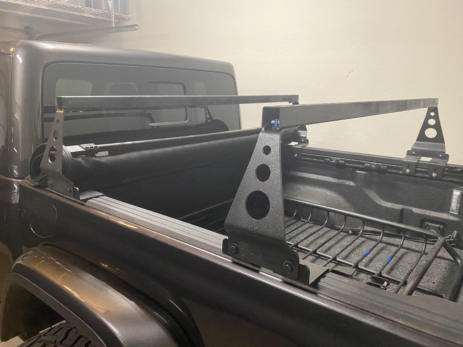

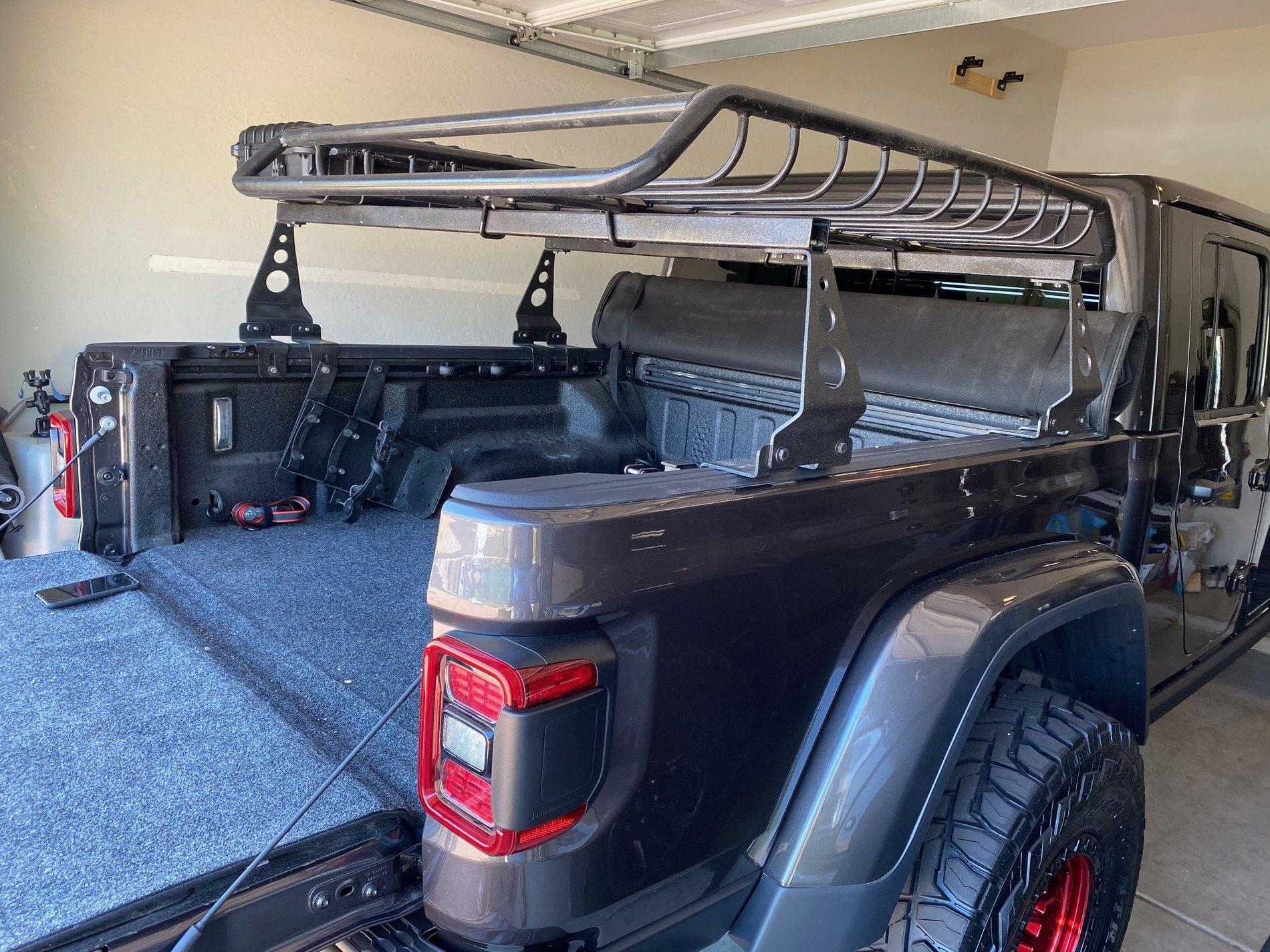

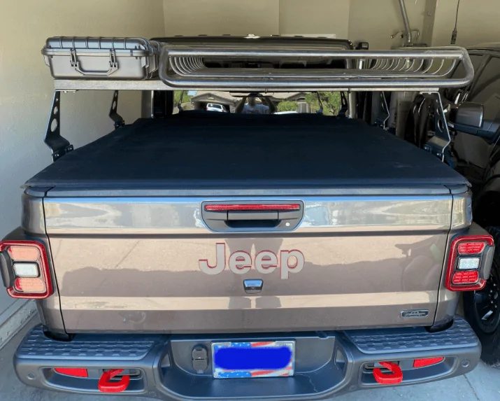

Revisions to the Perfect-for-Me-Gladiator-Rack...
As noted above I replaced the lighter, shorter profile 14-gauge Superstrut crossbars with the taller profile, heavier 12-gauge Superstrut crossbars:
Jeep Gladiator JTR LE Build Up with No Letdown gladiatorrack-2-jpeg-

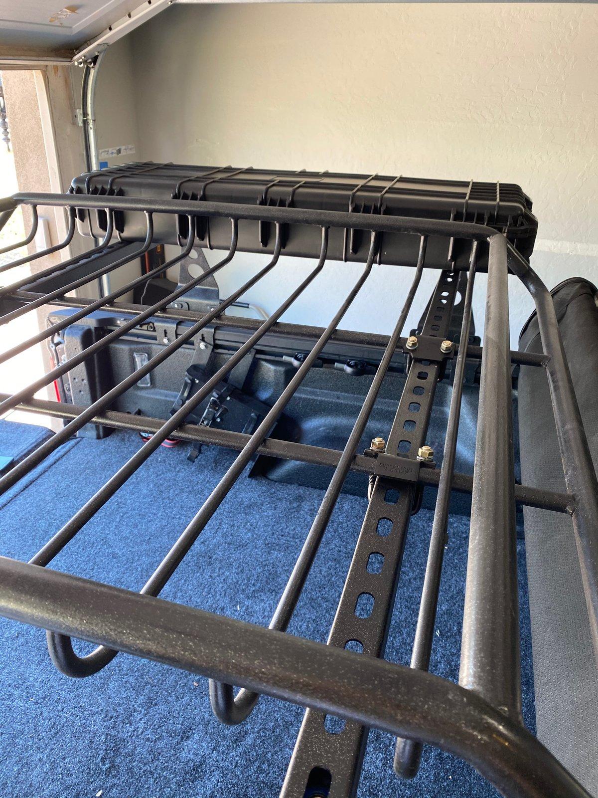

And then, instead of installing the steel tube Basket in the center, I moved it over to the passenger side. I used the above mentioned Superstrut U-bolt Channel to Beam Strut Clamps to secure the Basket to the crossbars.

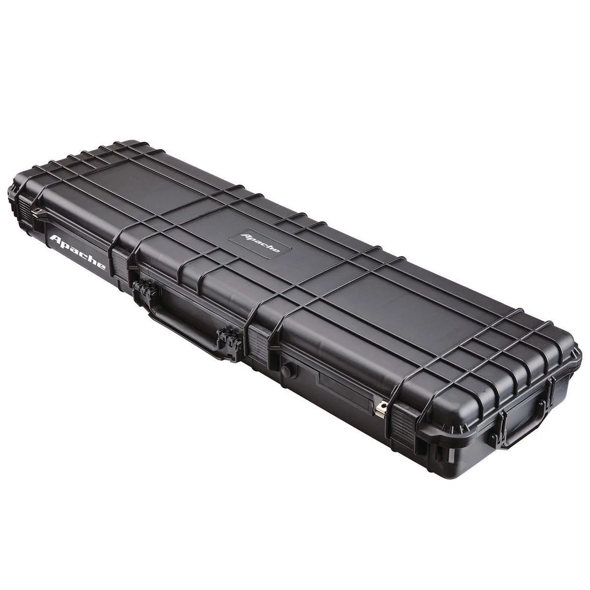

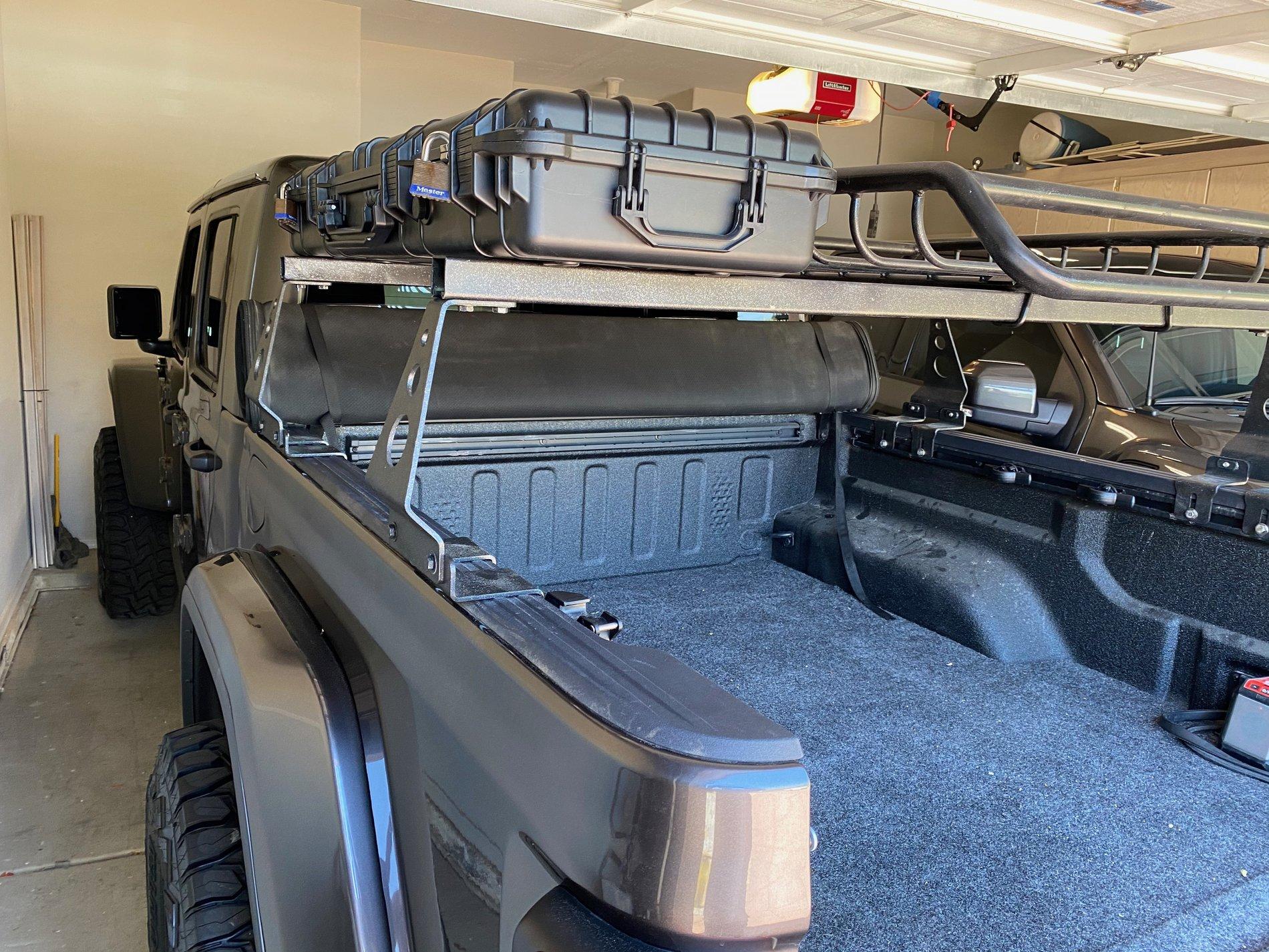

Next to the steel tube Basket I installed a long gun Case - it's a made in China Case identical to this one sold by Harbor Freight - this Case is very common on the internet - companies buy them in bulk and resell them with their name on them. It's decent quality for the price and for this application I had no need to spend 2X this or more for a higher quality name brand product that is more than what's needed.
Jeep Gladiator JTR LE Build Up with No Letdown 64520_w5-jpg
https://www.harborfreight.com/mater...f-protective-rifle-case-long-black-64520.html

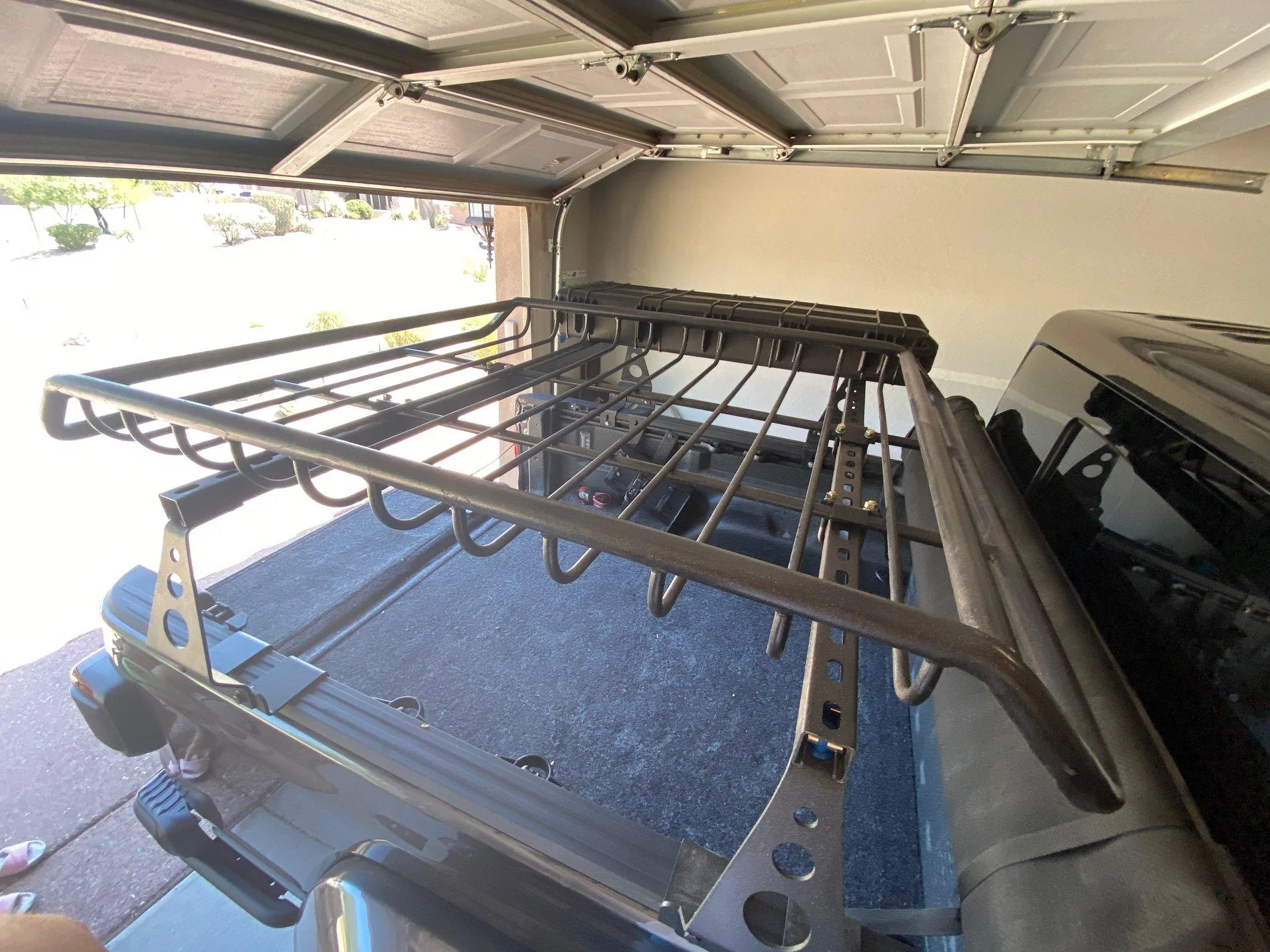

Here you can see some pics of the installation of the tube steel Basket and the Long Gun Case next to it...
Jeep Gladiator JTR LE Build Up with No Letdown gladiatorrackrevised-1-jpe
Jeep Gladiator JTR LE Build Up with No Letdown gladiatorrackrevised-2-jpe
Jeep Gladiator JTR LE Build Up with No Letdown gladiatorrackrevised-3-jpe
Jeep Gladiator JTR LE Build Up with No Letdown gladiatorrackrevised-5-jpe
Jeep Gladiator JTR LE Build Up with No Letdown gladiatorrackrevised-4-jpeg
I suppose it's worth noting that the Case is NOT used to hold or transport firearms. I'm using it for a variety of gear including some recovery items, jumper cables, first aid kit and a recovery strap.

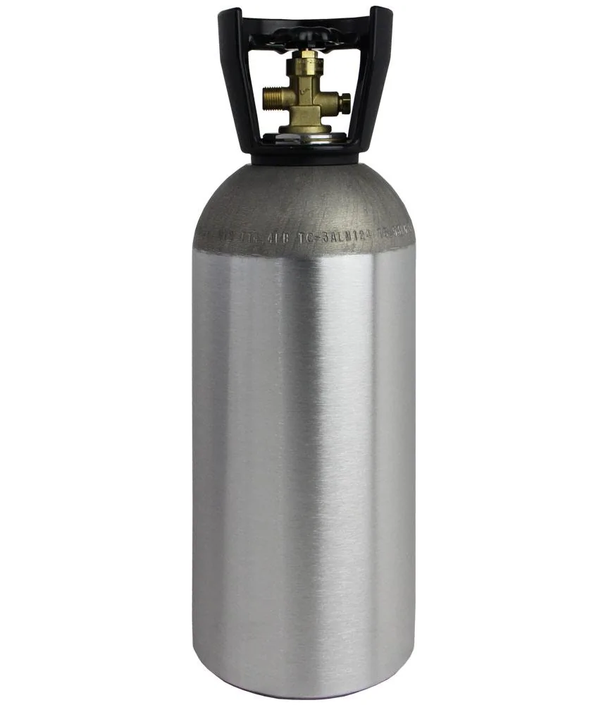

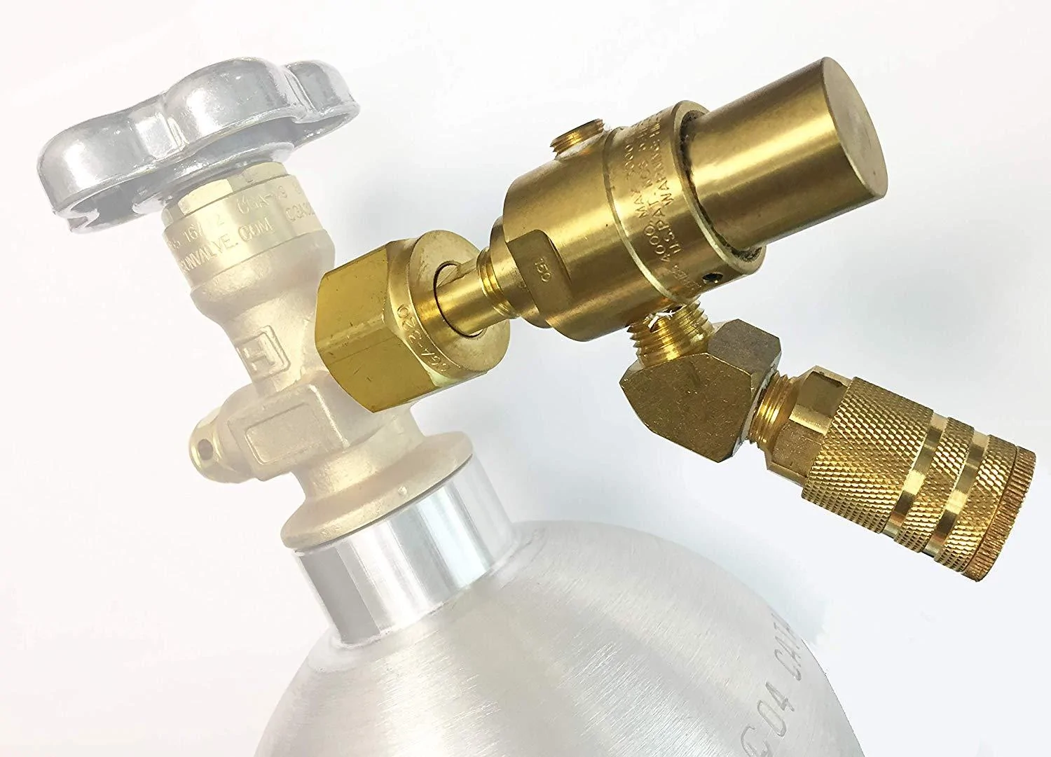

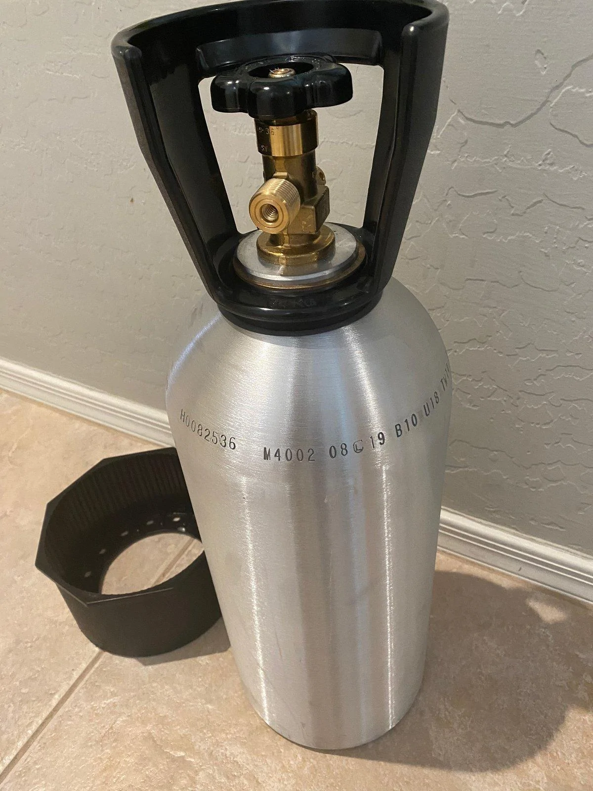

Here's the CO2 Tank system I put together (pics coming shortly) - much less spendy than you-know-who "Ptank"
Got a great deal on a brand new 10 lb. Aluminum C02 tank with handle from the Beverage Factory
https://www.beveragefactory.com/draftbeer/tanks/co2/C10.shtml
There's one on Amazon but this one has the Handle protecting the valve and I called and got a good price from them delivered with no tax: $108.00

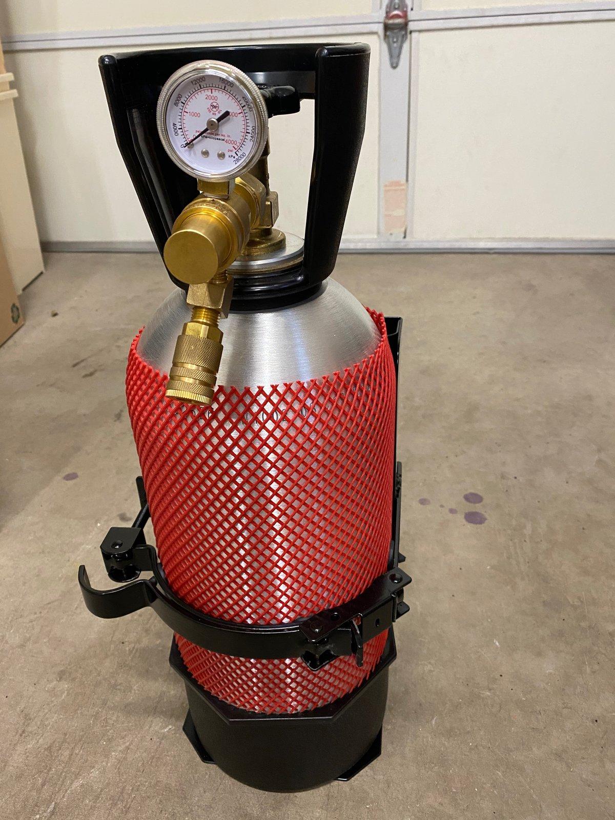

Regulator:
High Flow 150 PSI Fixed Flow Carbon Dioxide Piston Regulator for Tire Inflation
by Preece Precision
https://www.amazon.com/gp/product/B081S7YYPC/ref=ppx_yo_dt_b_asin_title_o08_s00?ie=UTF8&psc=1
$56.95

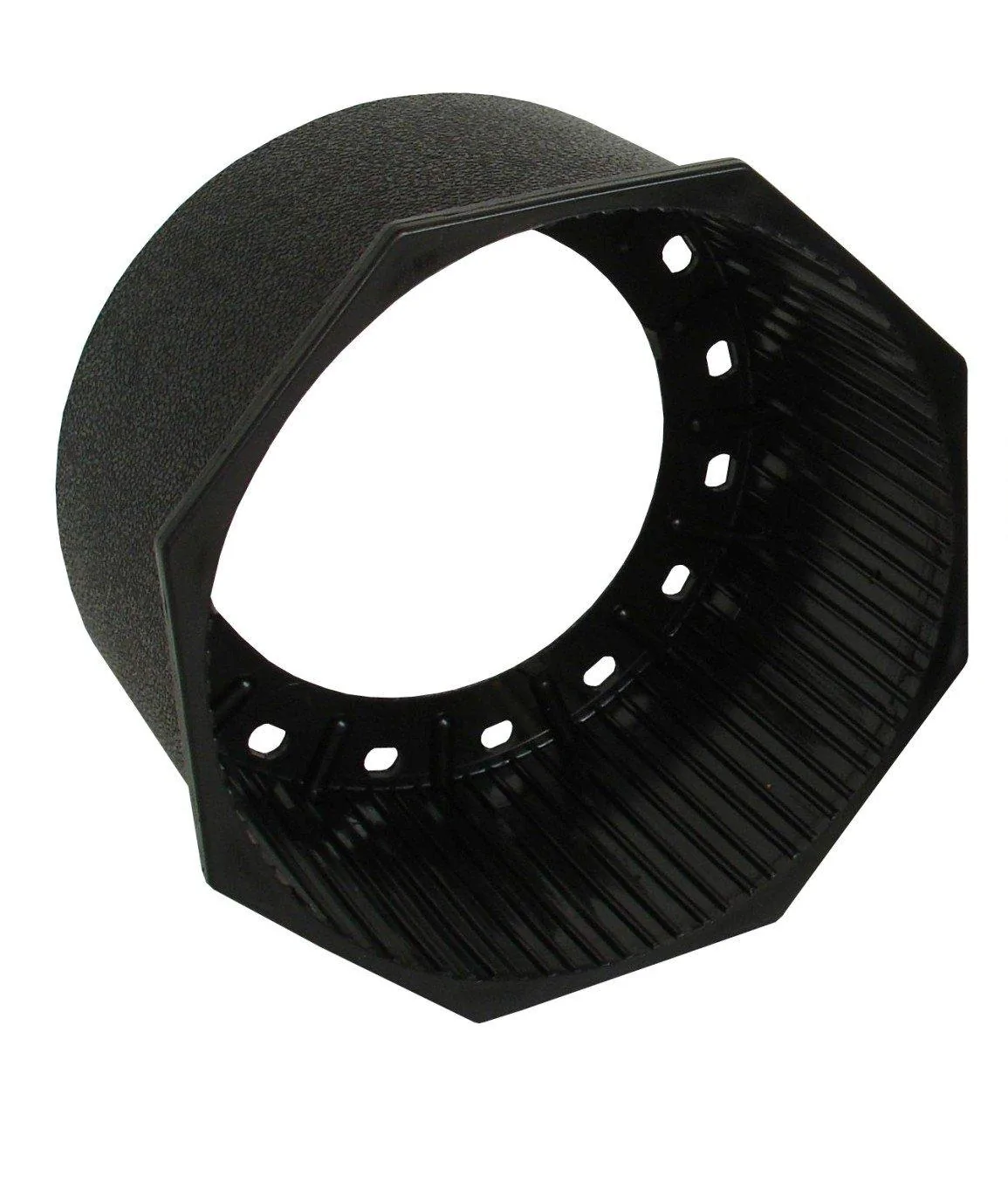

Power Tank TBT-6090 6.9" Diameter Tank Boot for 10 lb. and 15 lb. Tanks
by Power Tank - under $30.00 delivered
https://www.amazon.com/dp/B003ELL6J...colid=S6MSDIX2MAM0&psc=1&ref_=lv_ov_lig_dp_it

I purchased a tank bracket but I haven't yet received it. I'll mount this to the Trail Rail at the back of bed - it'll be on an angle so the tank will be below the tonneau cover:
Amerex 810 Heavy Duty Vehicle Bracket by Amerex
$49.99
https://www.amazon.com/gp/product/B00F5CKGHK/ref=ppx_yo_dt_b_asin_title_o02_s00?ie=UTF8&psc=1

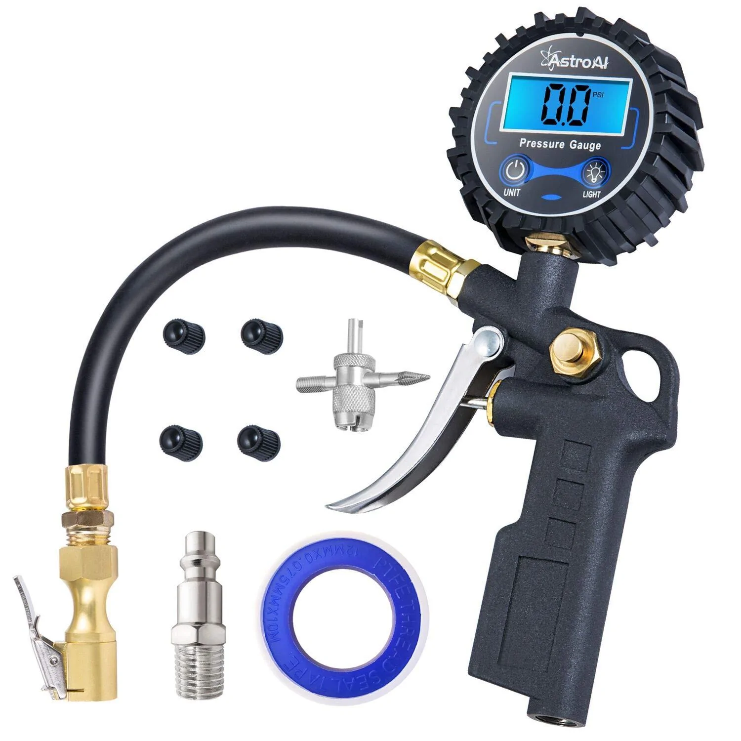

AstroAI Digital Tire Inflator with Pressure Gauge, Medium 250 PSI Air Chuck and Compressor Accessories Heavy Duty with Rubber Hose and Quick Connect Coupler for 0.1 Display Resolution
$22.99
https://www.amazon.com/dp/B07D3PVBJ...colid=S6MSDIX2MAM0&psc=1&ref_=lv_ov_lig_dp_it

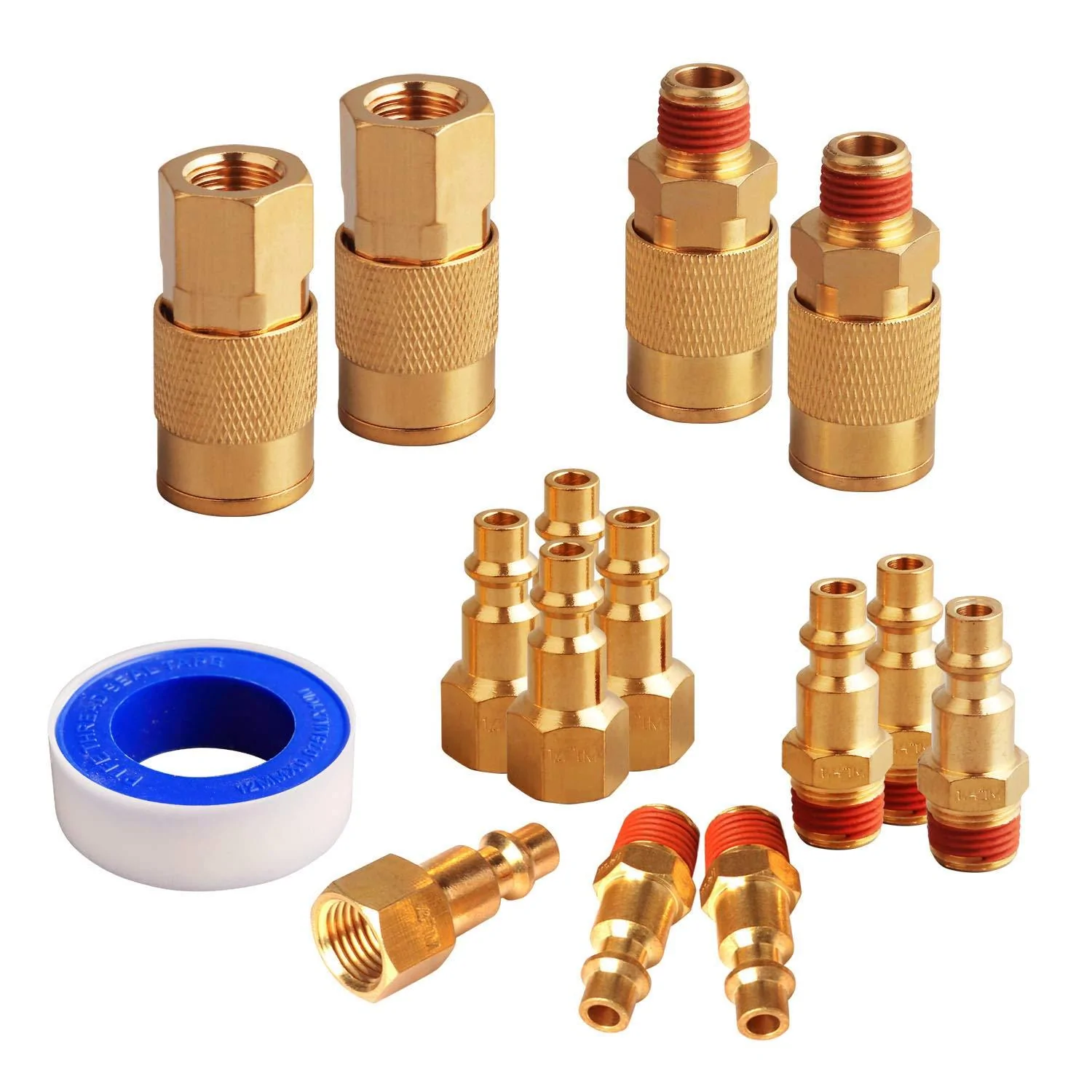

You may also need some hose end fittings and adapters. Here's one of many options:
FYPower 15 Pieces 1/4" NPT Air Coupler and Plug Kit, Quick Connect Air Fittings, Industrial Solid Brass Quick Connect Set
https://www.amazon.com/dp/B07NWQXC3...jbGlja1JlZGlyZWN0JmRvTm90TG9nQ2xpY2s9dHJ1ZQ==
<Edit: couple more pics of the tank ready for installation in the Gladiator>
Here's the mesh (I went with red) tank protector - it's a plastic mesh that slides onto the tank and it works well...
https://www.amazon.com/gp/product/B005FNRTXI/ref=ppx_yo_dt_b_search_asin_title?ie=UTF8&psc=1

with this system you just basically refill it at the gas station?
awesome build btw
Thanks!
No, CO2 tanks can typically be refilled at welding suppliers and beverage distributors
how much you can use it before runsout of CO2>?
I don't know yet. Depends on the size of your tires and how much you air down (and how much CO2 you need to use to fill them up). I've read online it should be 20+ tires but again, I don't know.
The speed of filling up is so good that you'll air down a lot more than you might otherwise which is a plus when off roading.
I plan on refilling the tank after a number of fills - it's worth it to know the tank is full

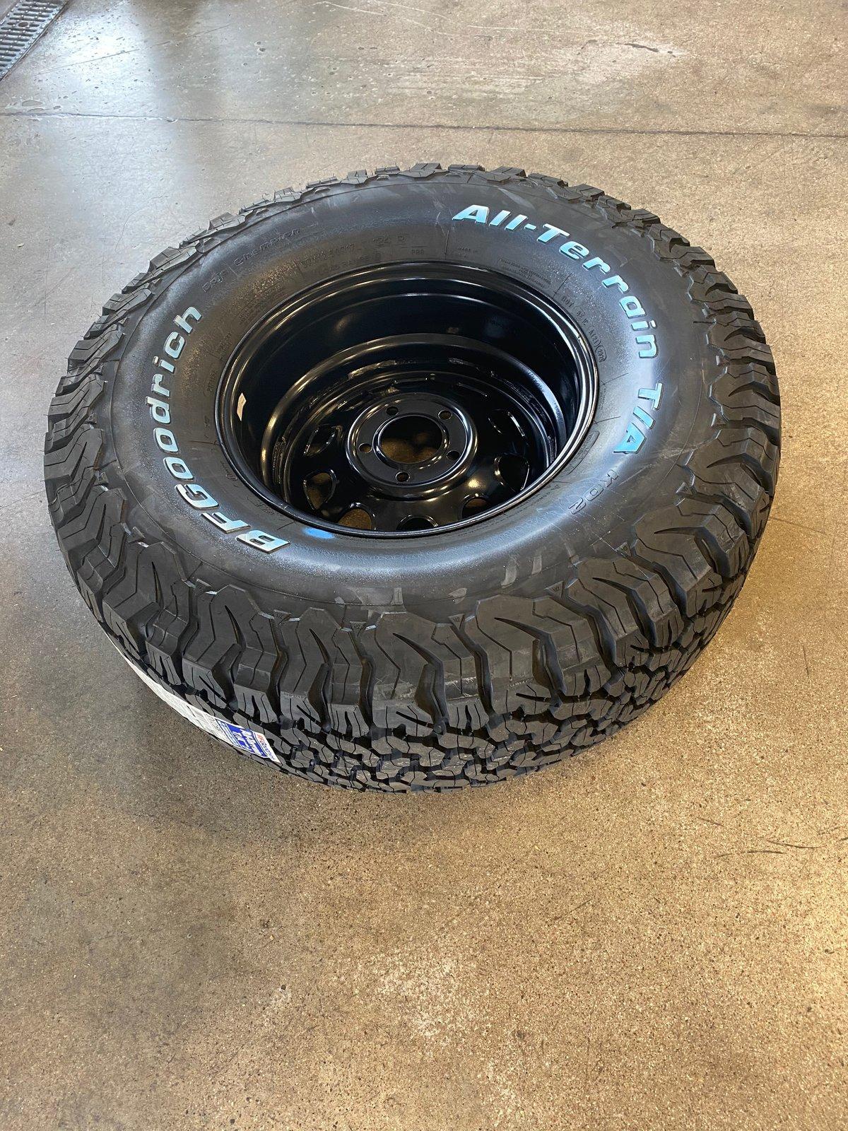

Big thanks :handsinair: to Joel Nunez, Store Manager at @Discount Tire in Mesa, AZ, for all his help with my spare tire program :like: I needed a spare tire/wheel that I could use rather than the factory spare that was nothing more than dead weight underneath the Gladiator.
Joel helped my by getting me a cost effective steel wheel that has the same bolt pattern and similar backspacing to my Fuel Zephyr wheels. And we went through the list of tires from this thread and I selected the 37x12.50R17 BFG All Terrain T/A KO2 tire which his team installed on the black steelie wheel.
I went to @Discount Tire and Joel and his team lowered my Falken Wildpeak factory spare, and attached the new spare wheel and tire and cranked it up under the Jeep Gladiator. It fit quite easily - more easily than I thought it would - and I was outta there after paying my bill.
The new spare before being put away. Hopefully this is the most sunlight this virgin tire and wheel will ever see...

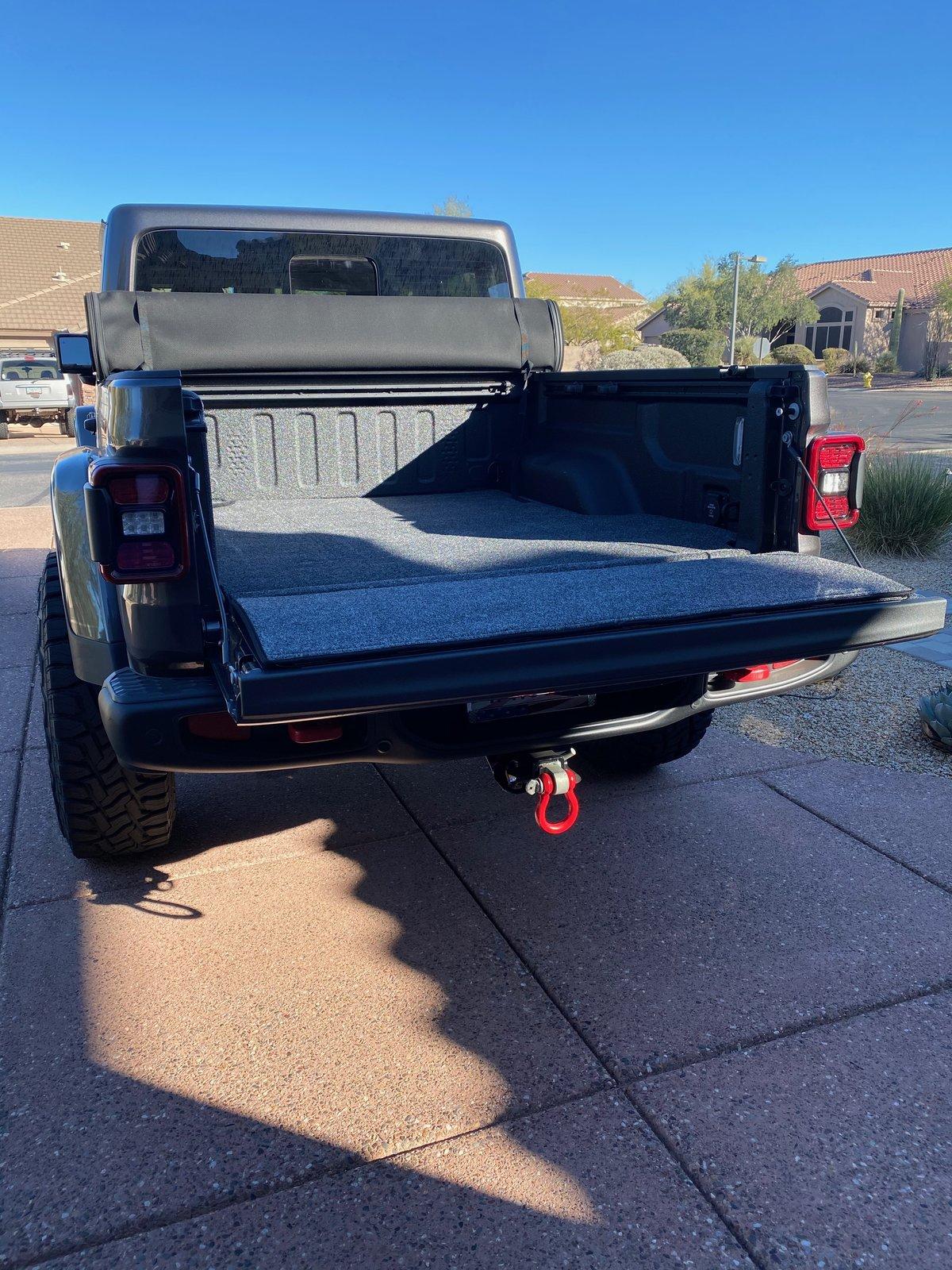

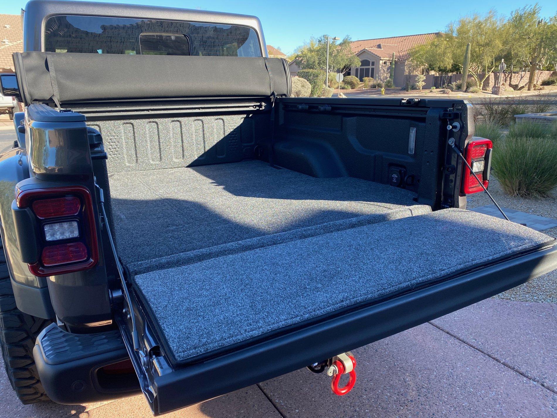

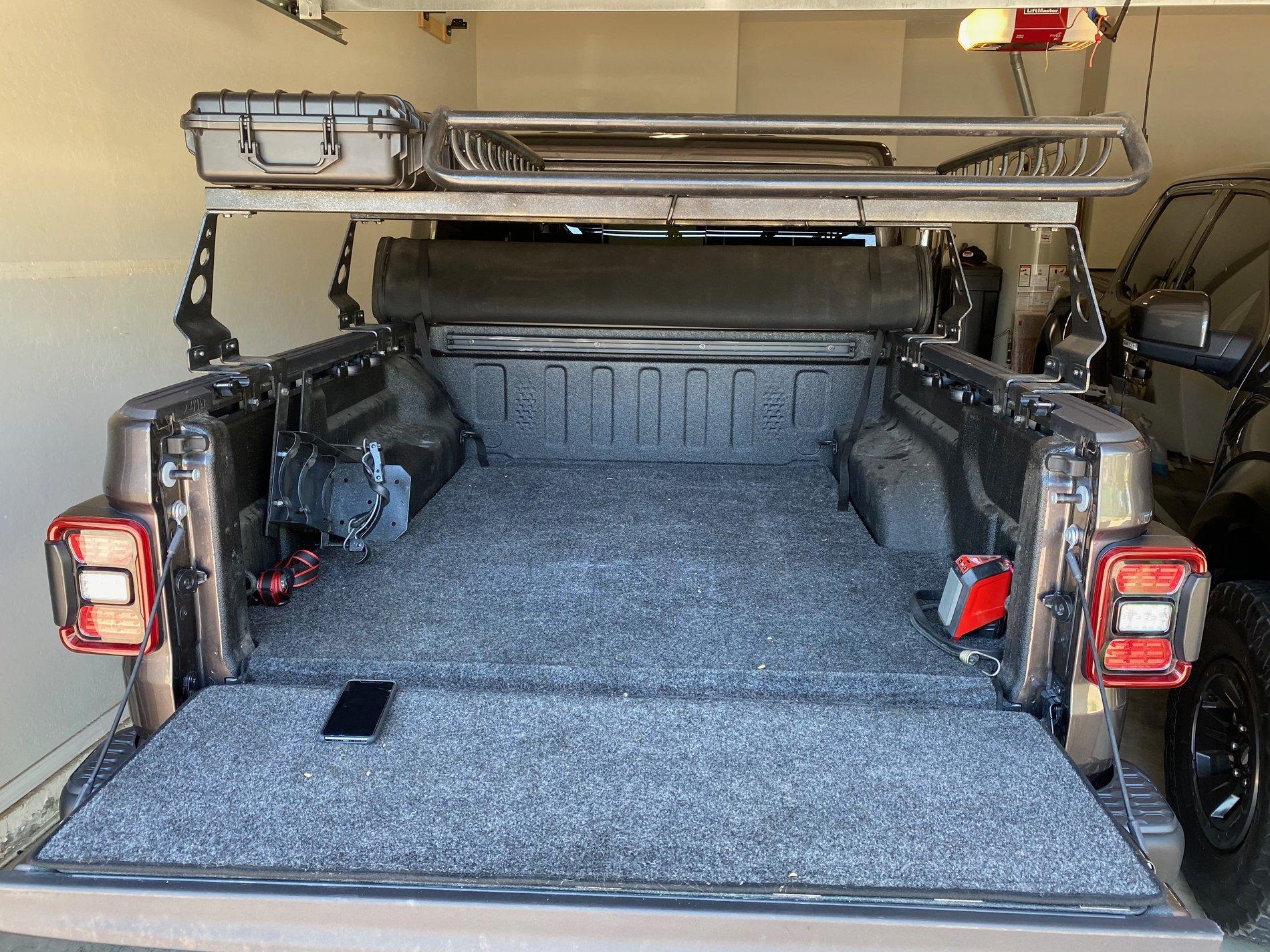

Here are a couple pics of the Bedrug installed.
The product is super durable, looks great and is soft on the hands and knees especially compared to the "sandpaper-like" spray-in liner surface. I have one in my Raptor and it looks great years later after some pretty tough use.

Is there a moisture issue between the rug and the bed after rain? I like the idea but it looks like moisture would get trapped between the two, causing mold/mildew....
WhatExit?
WhatExit?
Sep 13, 2018
54
1,943
2,688
48th State
Nope. No moisture, mold or mildew. The tonneau cover keeps water out of the bed
