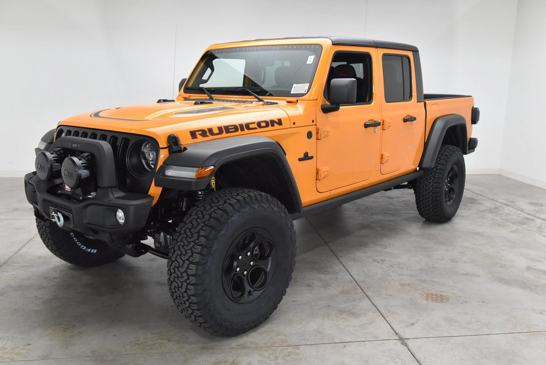

I just picked mine up today from getting regeared. I went 4:88 but am only running 35” tires. So if you are running 37’s I would say 4:88 for sure over the 4:56

I haven’t hit 70 yet still breaking them in. I have been a 60mph 2k rpm. I have an auto transmission with 35x12.5x17 toyo open country a/t. They are right about 34” actual height. Weight I would have to look up

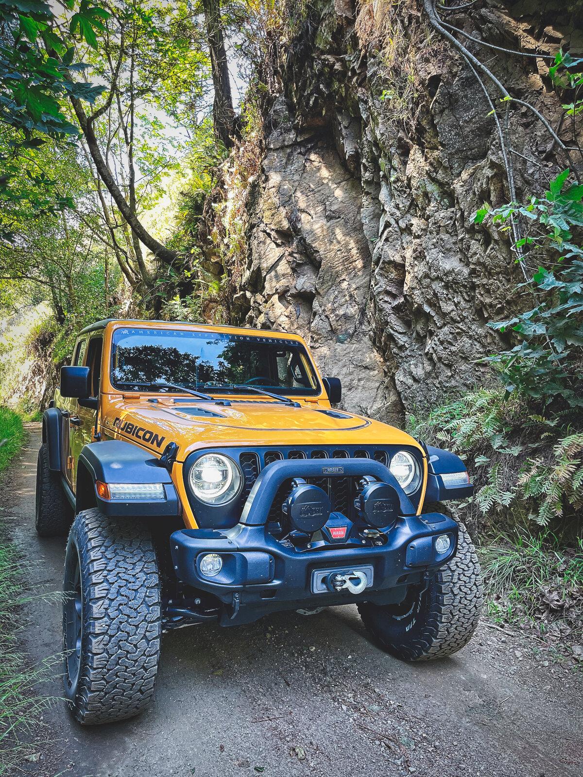

Looks amazing. But does it loose airflow with that bumper and lights?
