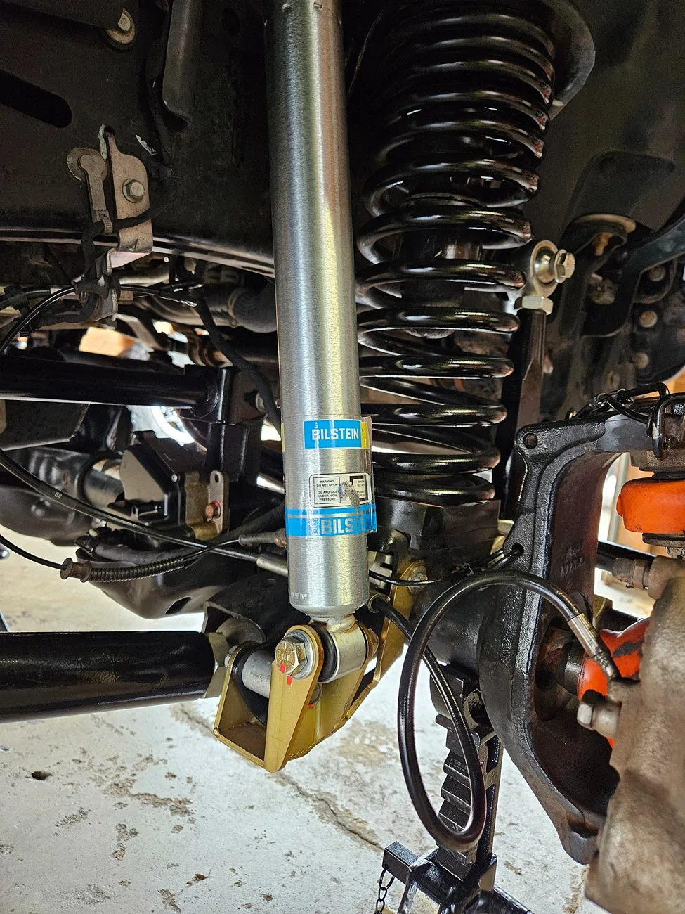

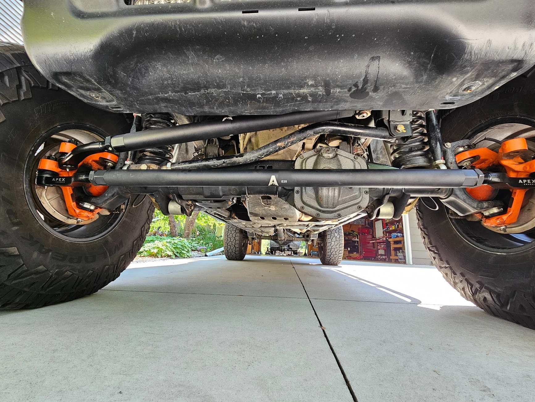

I havent posted updates lately but I have definitely made some changes!
PSC adventure kit. Replaces the entire power steering system: steering box, lines, reservoir, pump, and belt. I held off on the ram assist to see how it does, but will likely add it after a couple trails where I found I still bind up.
I also swapped my drag link/tie rod for a beefy 2" aluminum apex set up. Since I'm not worried about backspacing anymore I wanted the strongest set up i could get.
Installed some shock relocation mounts after finding they hit on MCs flex trailer.
Lastly, I trussed the front axle with an Iron Rock Offroad kit. This is in prep for the next mod, something I said I wouldnt do.... more to come

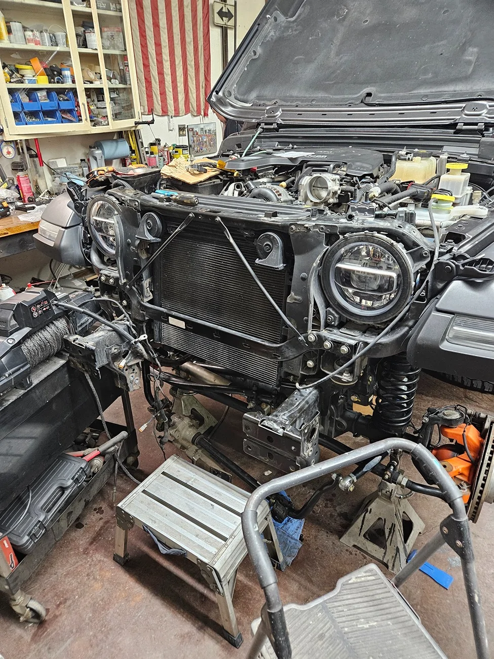

Initial impression: Beefy!
Seriously good word and parts choices
and
It's lookin' a bit crowded in that work area ;-)
and
I love the formand function of the AEV bumper...but what a pain in the ass to remove it just to get the grill off!
