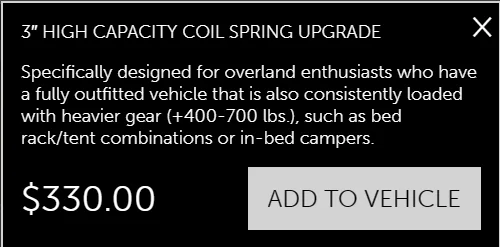

In looking at the JT370 there are some options that I'm hoping others have used or seen. When it comes to the lift, it looks like I can upgrade to the HiCap dual sport. Does anyone have this with 37s? With my planned build out this seems like the way to go.
  • AEV's 3" DualSport RT High Capacity Suspension System is AEV's ultimate dual-purpose suspension system, giving you better ride quality and designed for overland enthusiasts who have a fully outfitted vehicle that is also consistently loaded with heavier gear (+400-700 lbs. over the standard load spring), such as modular cargo systems or roof rack/rooftop tent combinations

Having a JL370 (Not a JT), here are my opinions.
With all of the recalls and issues with teh current manuals, I'd go auto. If you stick to the manual, you can get 4.88s from the factory order and ensure AEV credits you for the gear change if they don't do it. I don't see it listed as an option, but worth a call to them. Definitely option for the 8100 shocks and maybe the higher capacity springs. I had a 2020 Rubicon JL with the 5100 shocks and the JL370 with the 8100s and the difference is awesome. On a Jeep Jamboree currently and I can't tell you how good this system is!

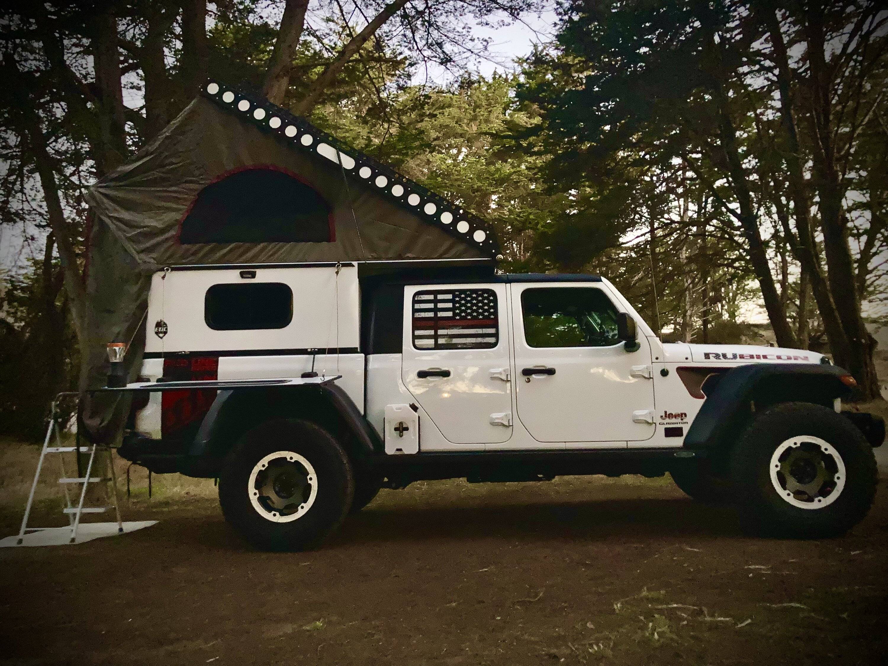

I hope you move forward with the build and thank to Warped for posting his review of the Dual Sport. I am currently in the financial gathering phase for that exact suspension. I currently have the Mopar 2 inch with the Harker Outdoor EDC Camper. Although it is a light camper, all of the gear starts adding up!
