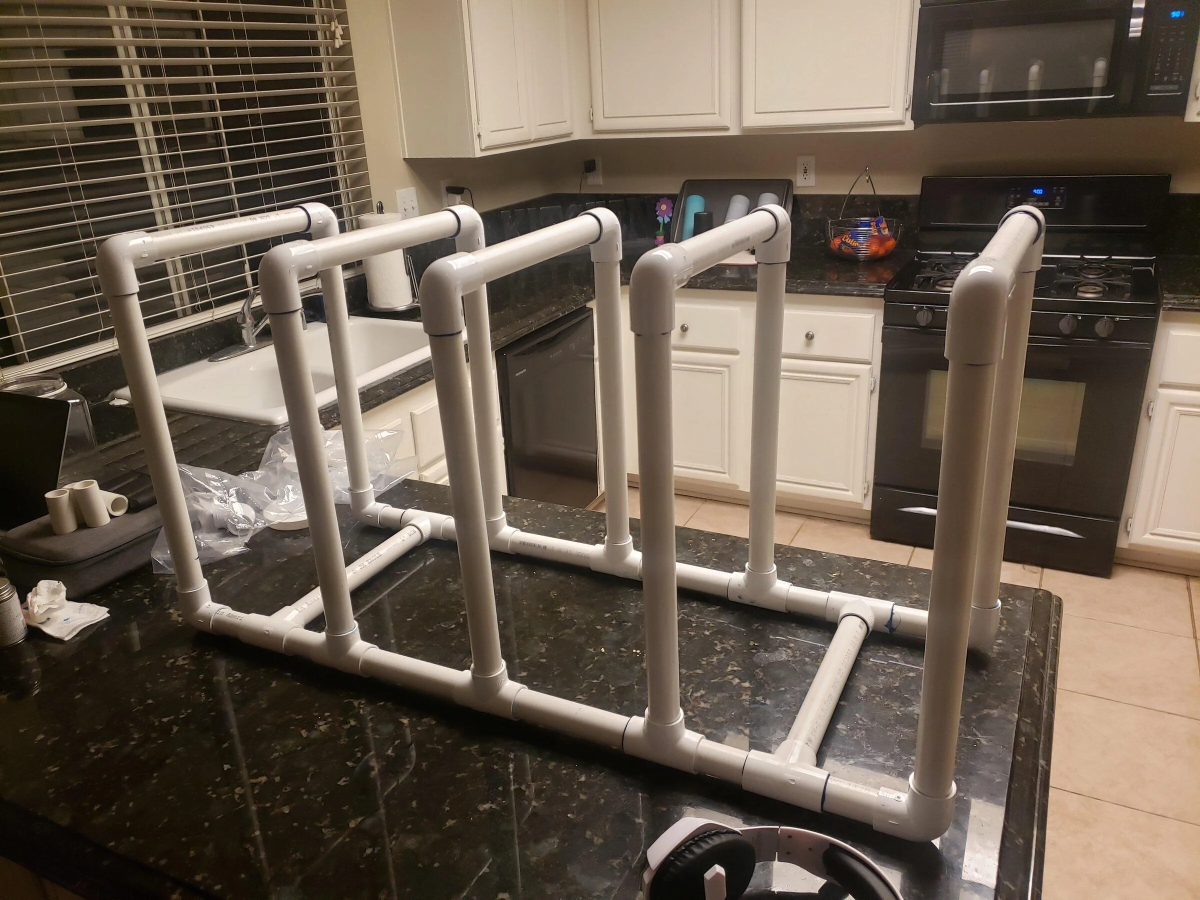

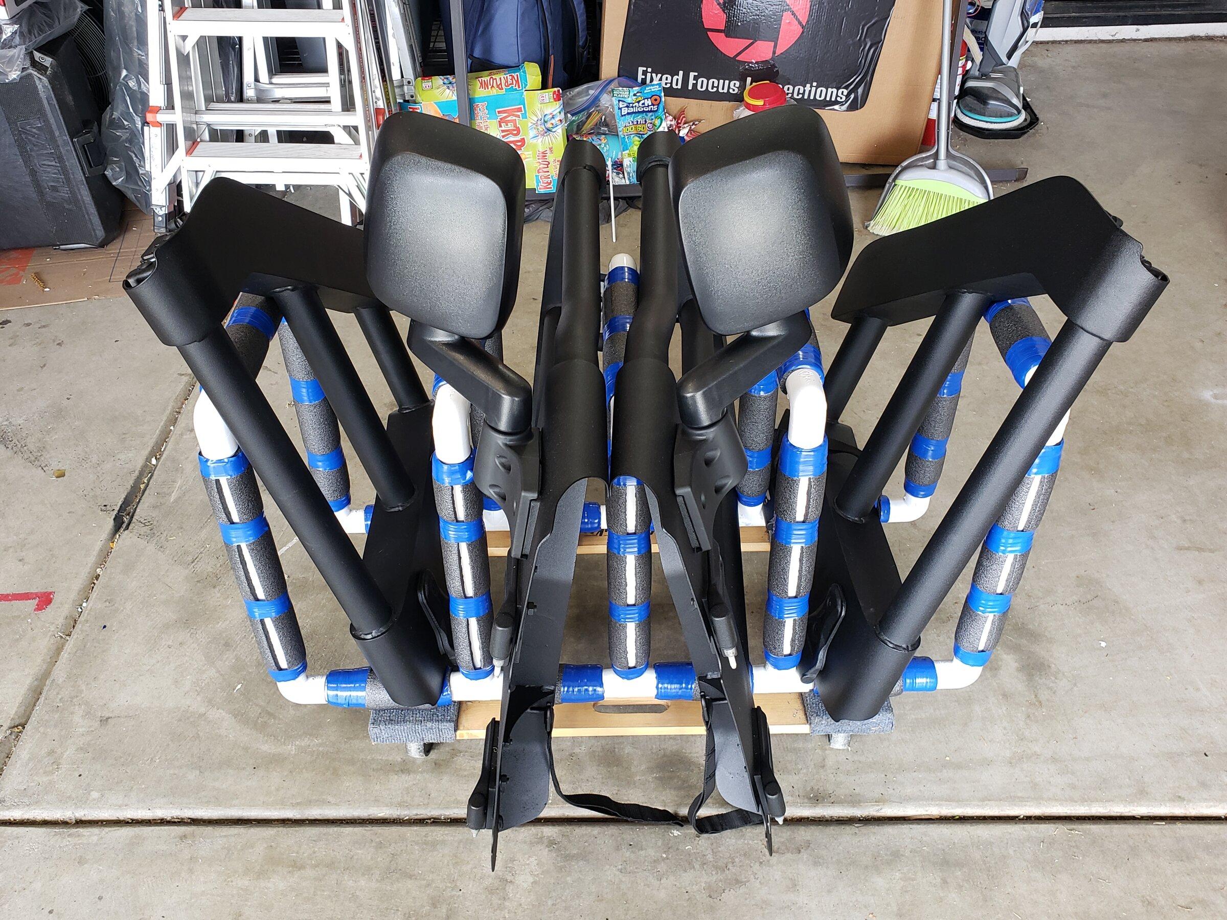

I found some online build plans to build door storage racks from PVC. This DIY rack took me about 1-2 hours to build and cost around $100 in parts. The rack holds my tube doors curently but will soon be ready to hold the full jeep doors with the nice weather we're having in Southern California.

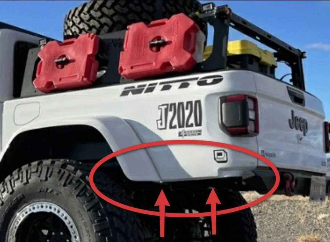

Are you planning any kind of skid for the portion of bed left unprotected? Like to look of that Artec bumper but I'm leaning toward the Motobilt or NVM due to the built in bed protection.
I personally don't like the extra bulk a skid plate or bumper extension or even a full bumper wrap around looks. Its too much in my opinion (kind of like a full width front bumper vs mid-width vs stubby).
I also know of a few cases where the factory Rubicon skids in that section get pushed up into the body and still cause damage. I'm going to do one of two things. Either take my chances of not hitting my bed in those areas and if I do then cut my body (highline it) or highline cut the body before a do any damage.
I like the look off cutting the body right at the seam where the plastic trim piece is. I don't have my exhaust back there anymore so you won't see that. By cutting the body up say 4 inches the bed frame becomes the lowest point which is perfect. I'll attch a picture of what I mean.

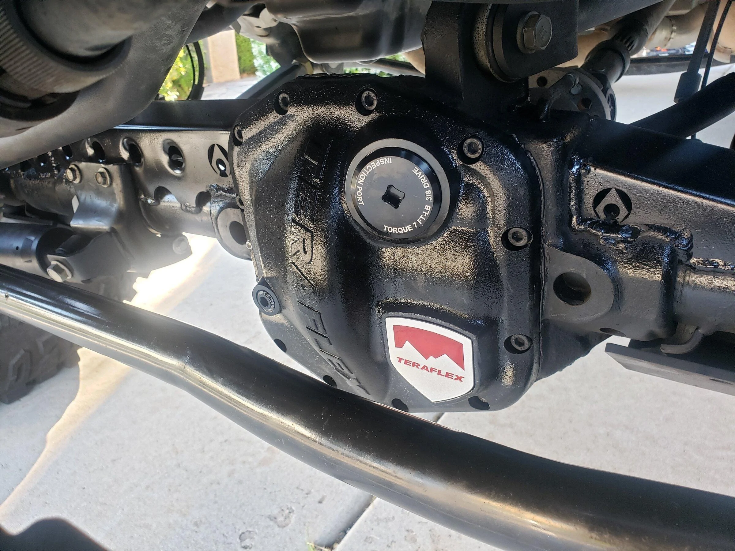

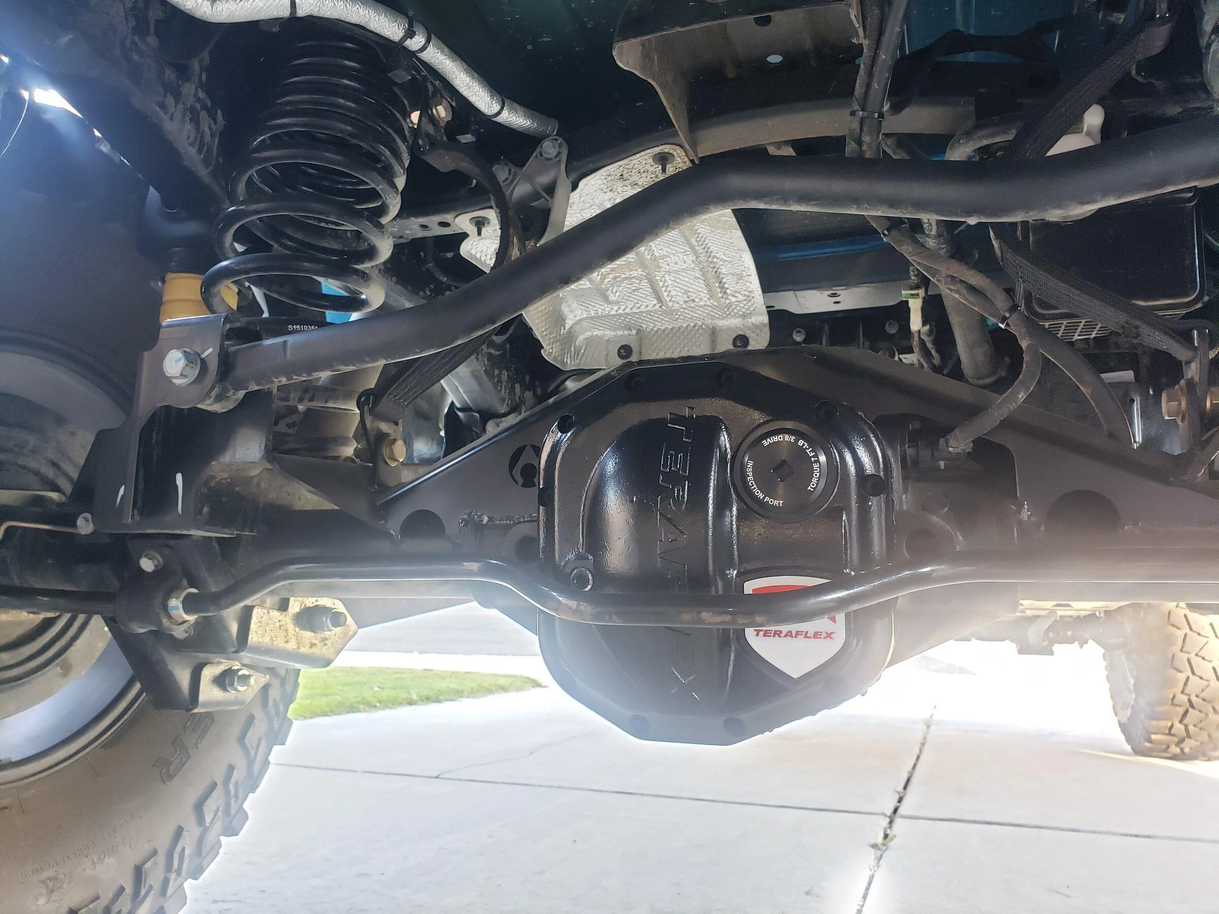

I'm feeling good about my Axle situation at the moment. I always felt confident with the strength of these latest generation Dana 44's on my Mojave but now I have more confidence having added front and rear Artec trusses and some very HD Teraflex diff covers. I head out to the Rubicon Trail in less than a month so we'll see how the Mojave does. I did sell my Quadratec sliders and ordered some VKS frame mounted sliders that I will have welded on. Pictures to come on the sliders.

I may be ignorant here, but what does a new diff cover do for strength? Never really researched that.
I know it adds impact and peel back protection…
The Diff Cover is much thicker and stonger than the factory stamped steel cover. Since the differential is a low point on the Jeep when Off-Roading it takes lots of hits from rocks. It can take a lot of abuse plus the mounting lip is much thicker so it won't peel back if caught on a rock. Lastly, the added strength and thickness stiffens the axle housing which helps reduce deflection which makes the gears happy.
On the Teraflex Diff Covers they also have recessed bolts that dont get smashed with rocks plus a large fill / inspection port at the top which most don't offer. At $171 dollars each on sale it was cheap insurance.
Most of the axle strength I added was the front and rear trusses. The combination of trusses with the HD Diff Covers is just a smart pairing. From here if I need more strength it will probably be Dana 60 axles.

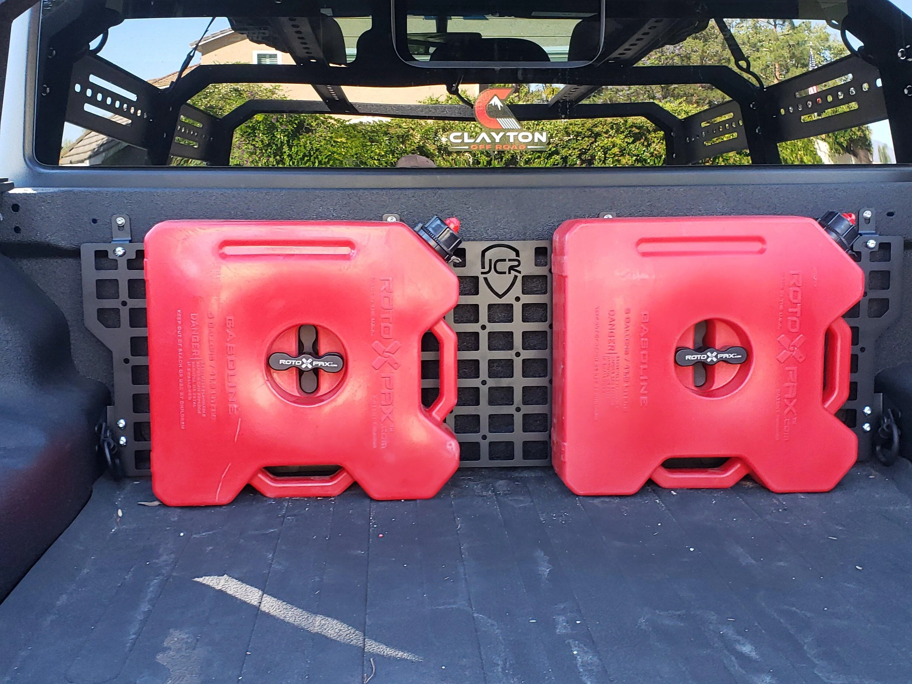

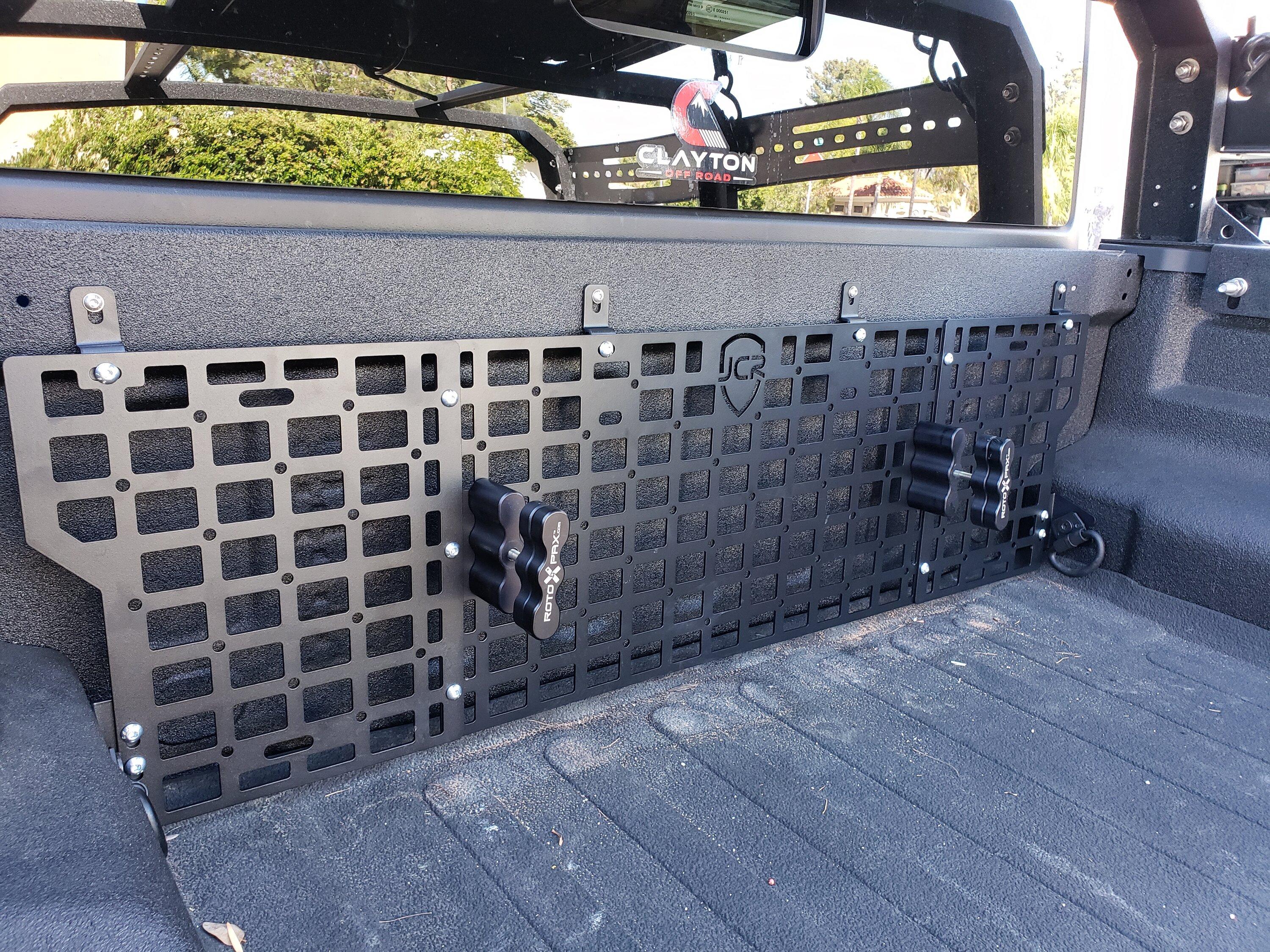

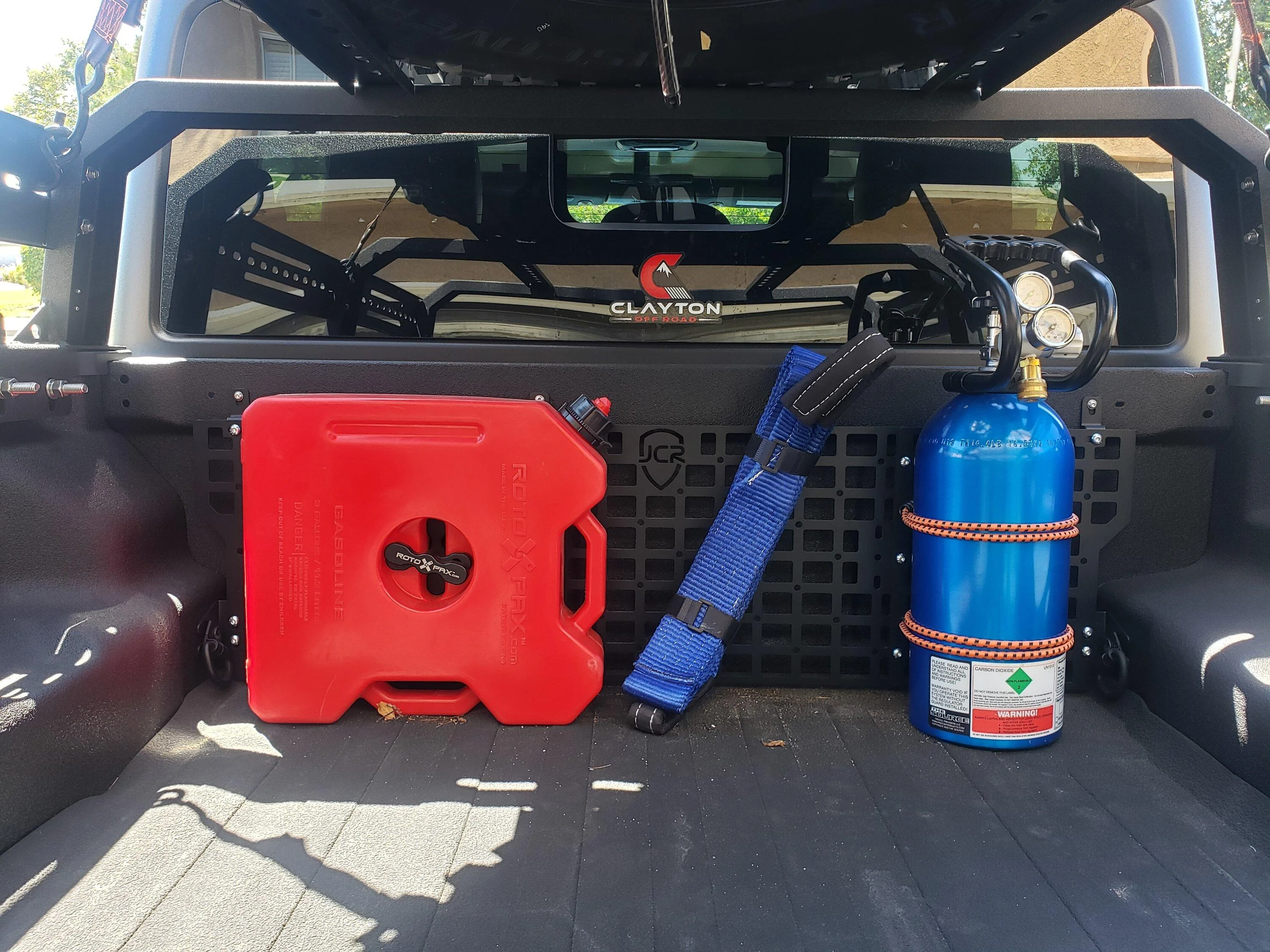

I made a few additions recently in preperation for my upcoming Rubicon trip at the end of the month. I added a front bed molle rack from JCR. I built a CO2 system to fill my tires. I finally got around to adding fender chop brackets from Rugged Ridge without lights. Finally, I welded on some VKS frame mount rock sliders.

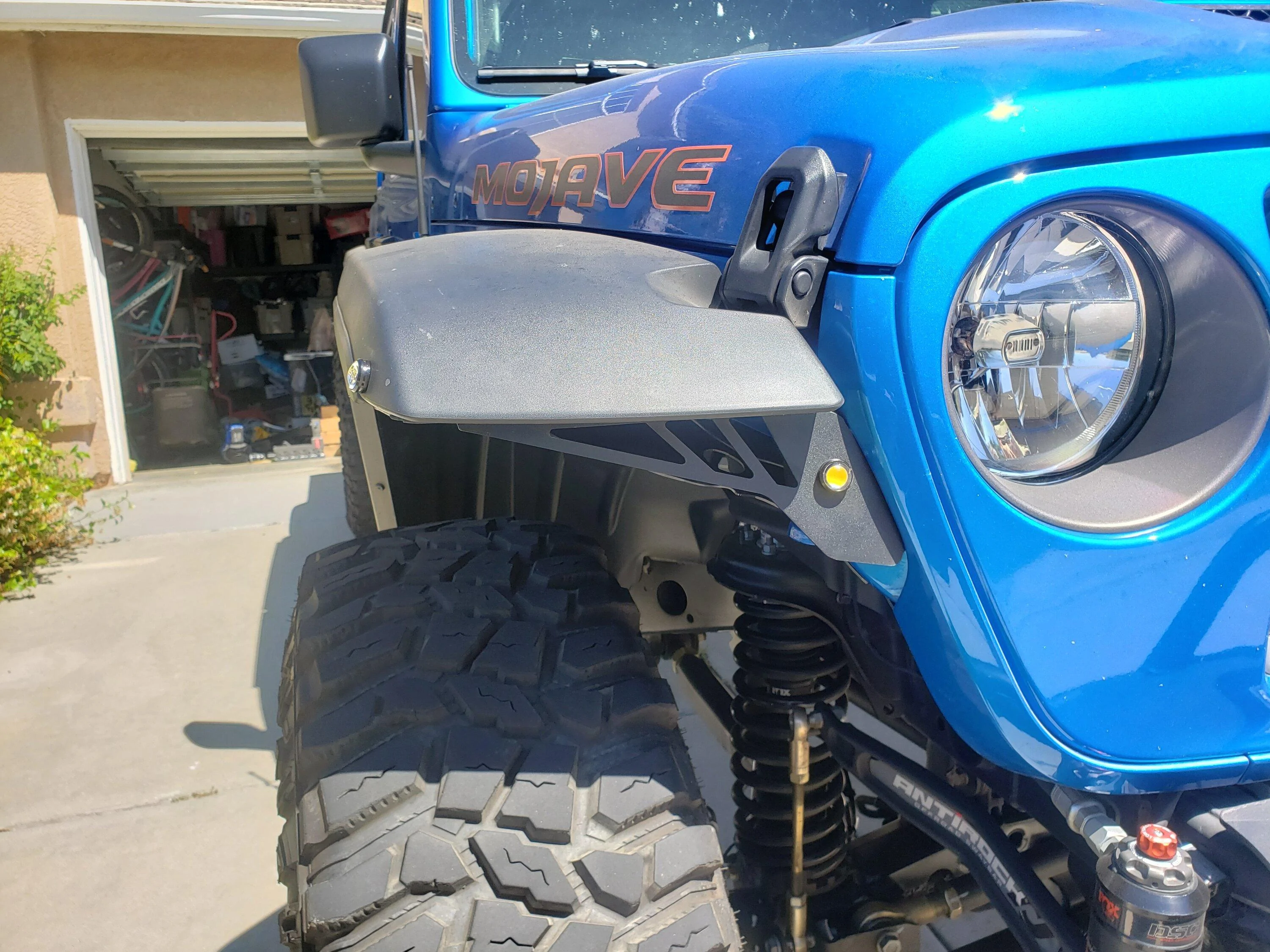

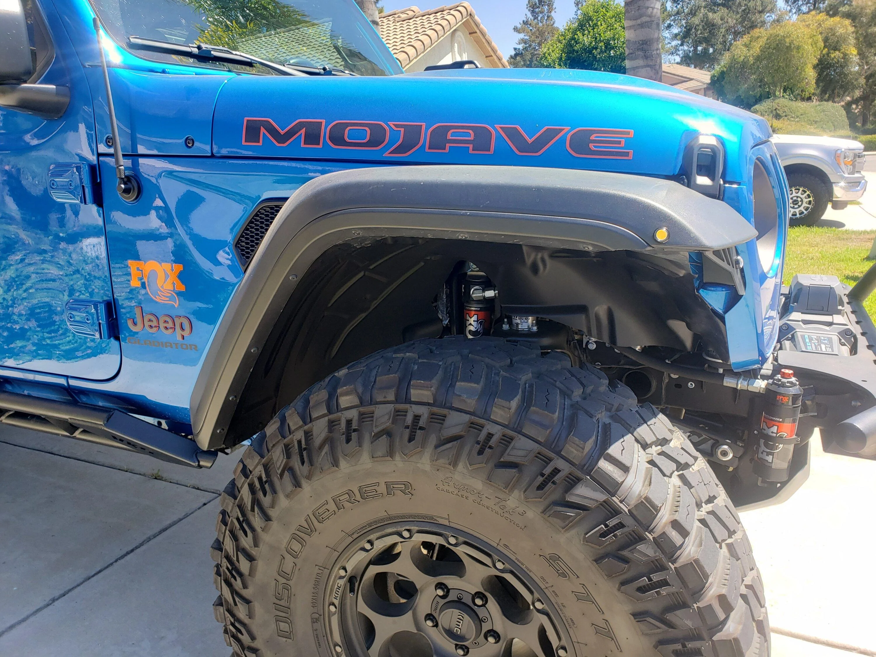

Here are some pictures of my Rugged Ridge fender chop brackets without DRL lights. I was able to retain the factory plastic inner fender liner.
