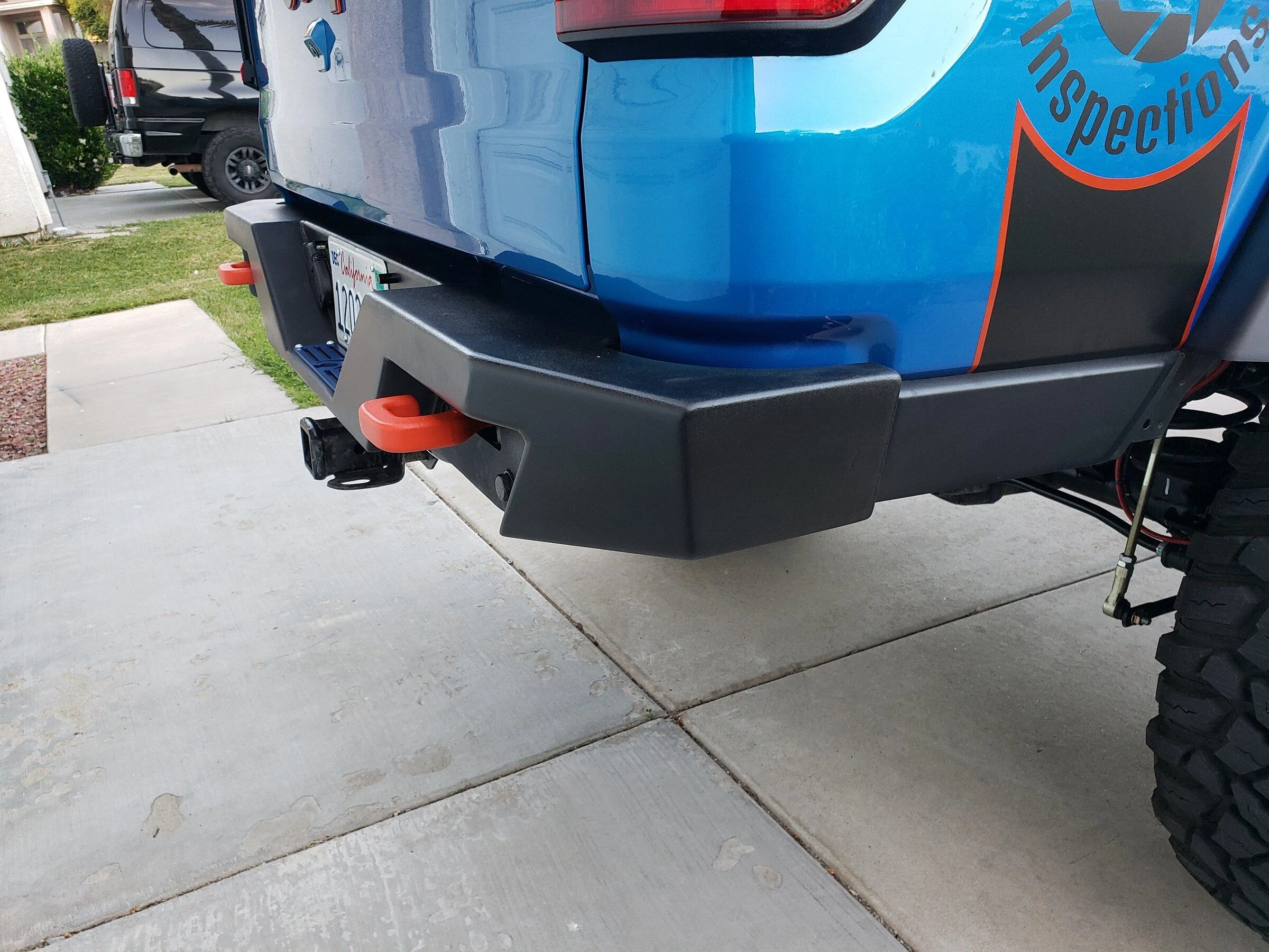

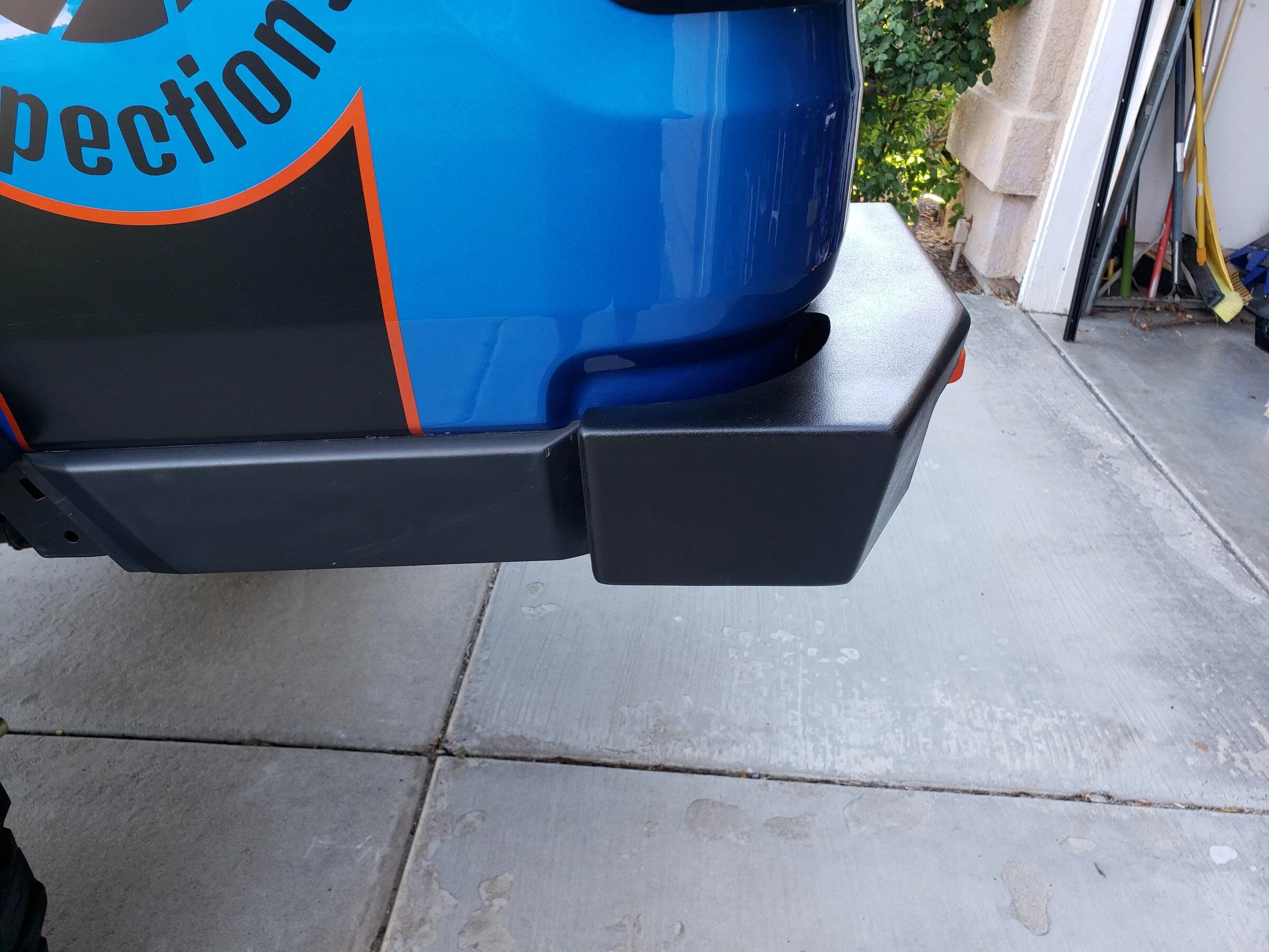

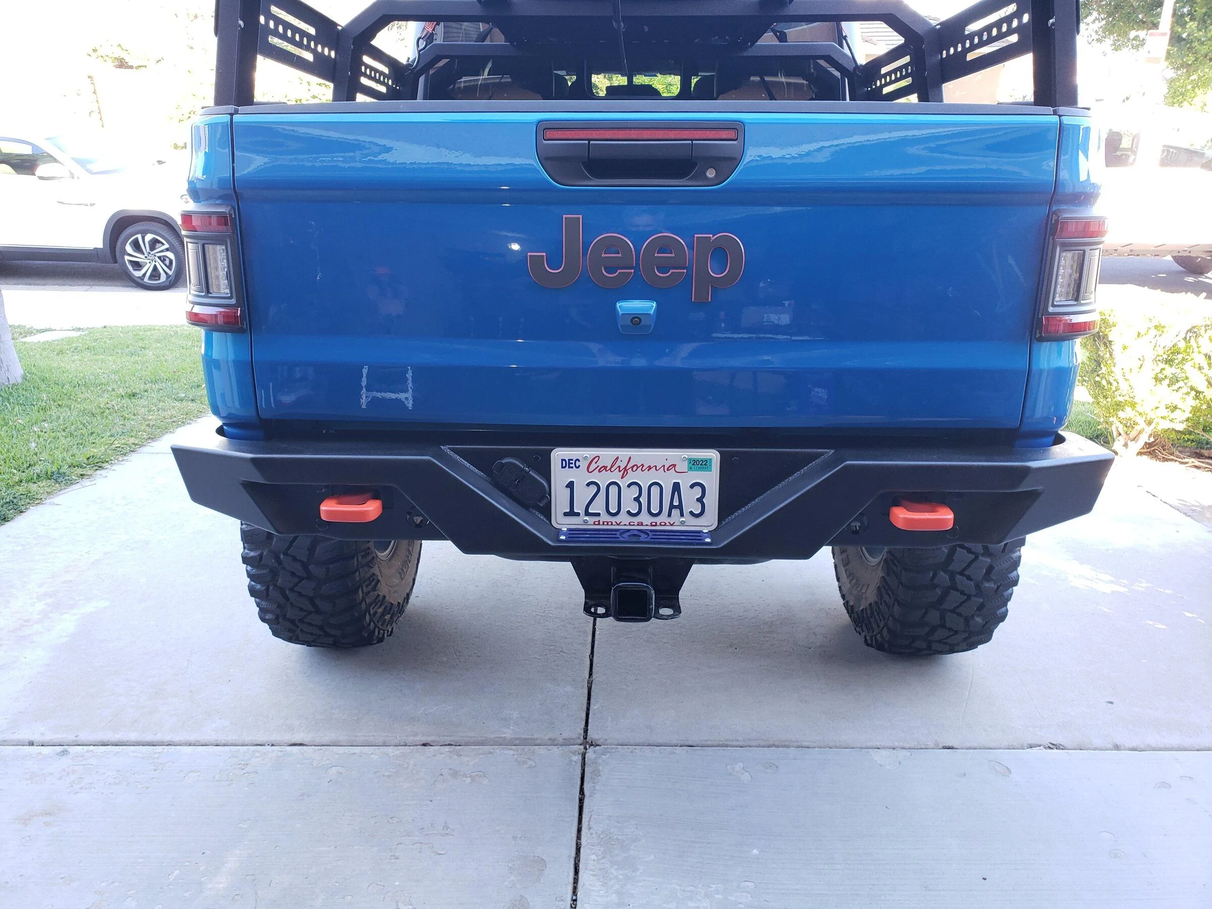

So its been a little bit between posts and upgrades but during that time I've been on a few Off-Road trips up in Big Bear. The Jeep continues to preform very well completing a lot of the extreme trails up there (Dishpan / Holcomb / John Bull).

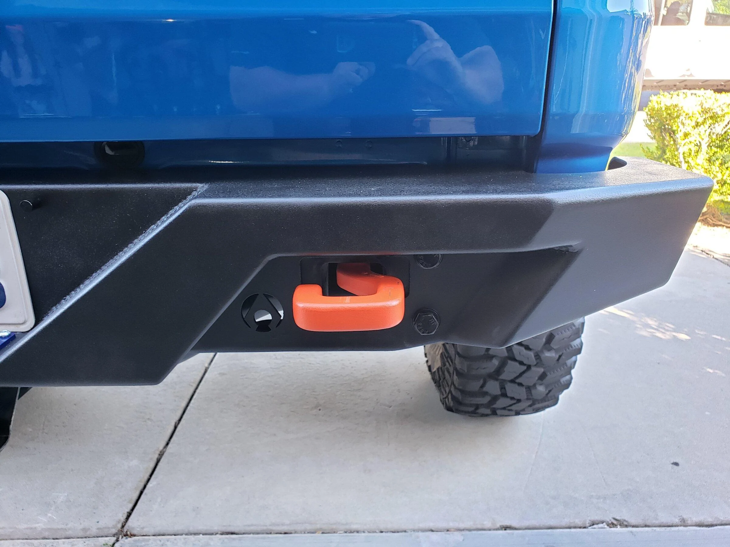

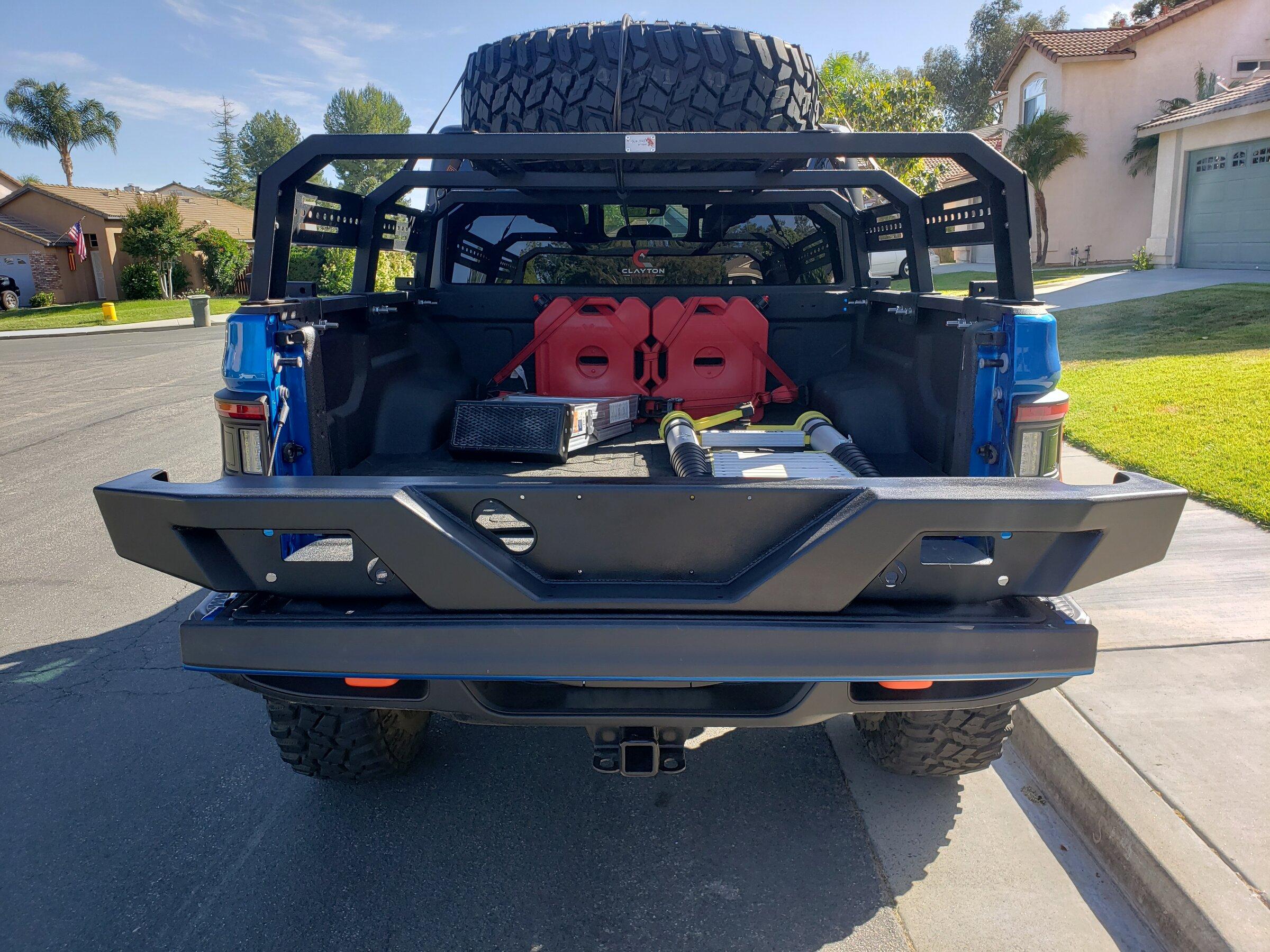

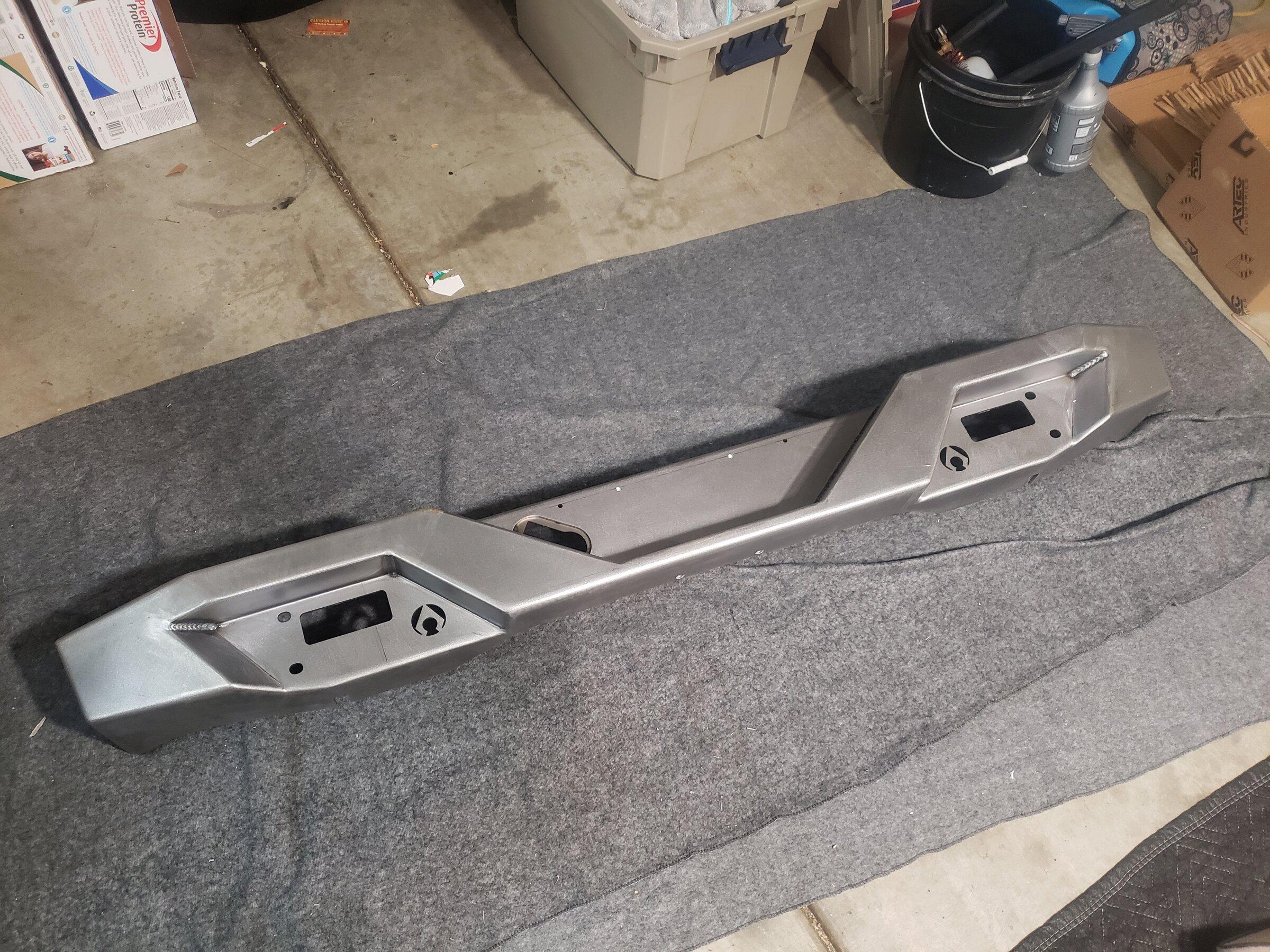

The biggest component taking a beating on the Jeep was the rear plastic bumper. Originally I had ordered an Addictive Desert Designs pro bolt-on bumper but they decided to discontinue making that design so I was back to the drawing board. After a ton of research I ended up ordering the Artec rear bumper. I'm very happy with this decision as it has very good body lines, beautiful welds, and was about $300 cheaper than the ADD brand.
Jeep Gladiator Building a Mojave on 40's 20220428_201416
Jeep Gladiator Building a Mojave on 40's 20220510_164547

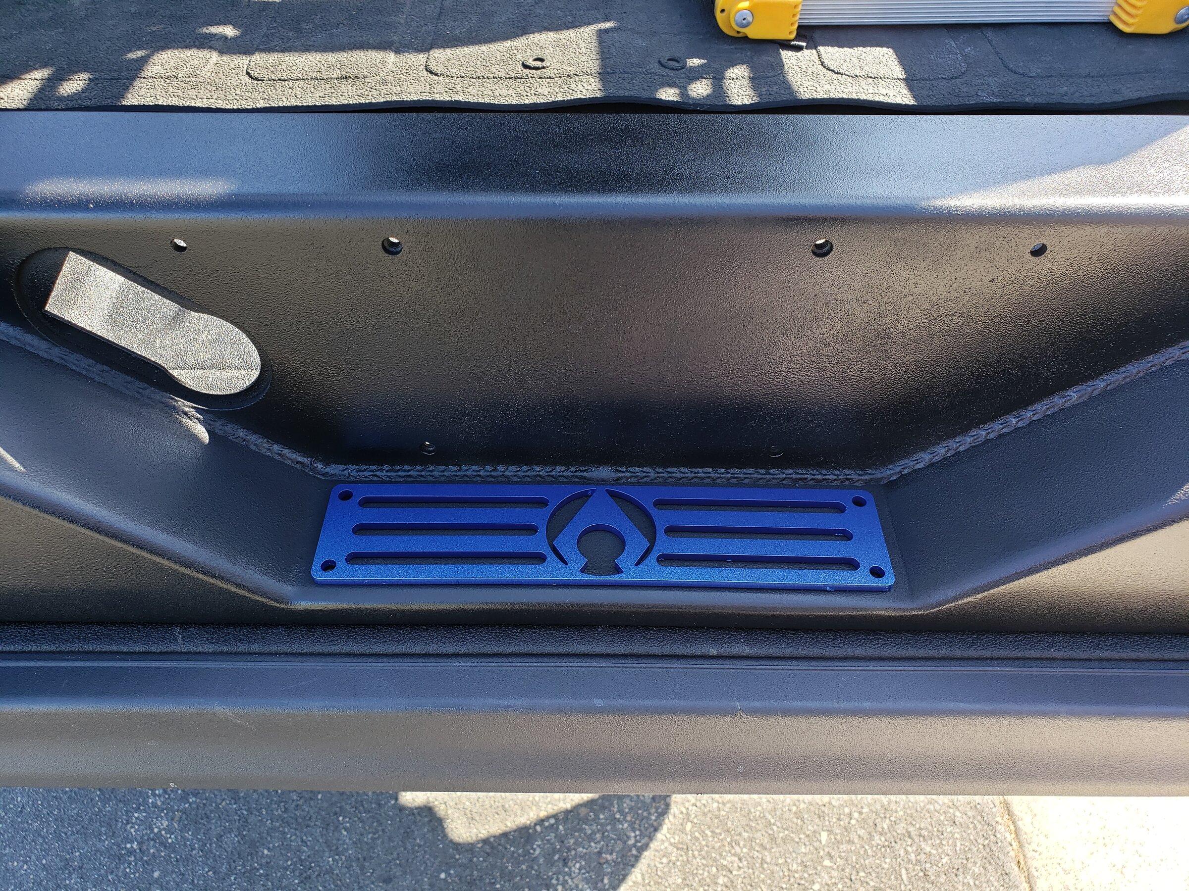

I spray painted it with the same Textured Rustoleum as the front bumper to make it easy to touch up when I drag it over rocks. This bumper utilizes the factory tow hooks which I thought was kind of cool since I have 2 orange Mojave hooks. It also comes with a step plate I decided to plate blue to break up the black. 2 LED license plate lights finish the bumper. Here are some shots from different angles.

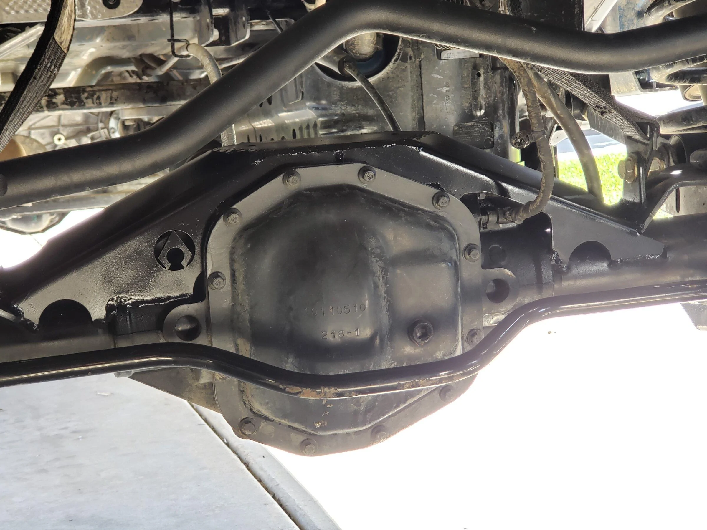

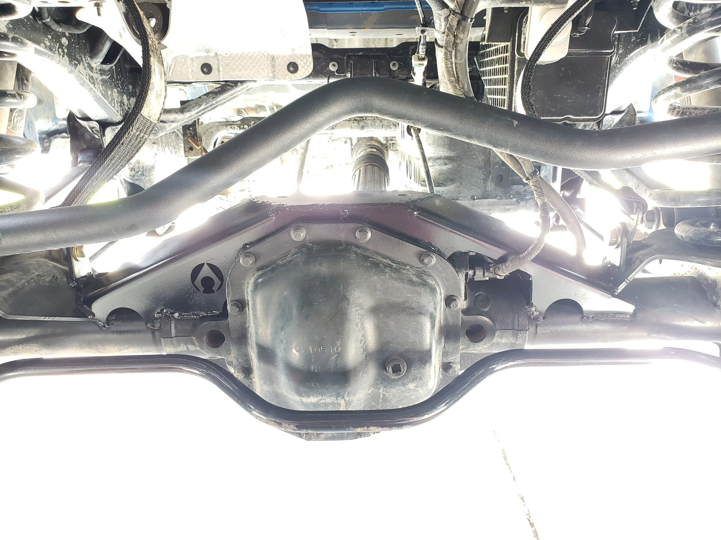

I've had a front and rear Artec truss sitting in the garage for a while. Finally had a little time to get the rear installed the other day with the help of a friend with a welder. Nice to have that added strength to the Dana 44.

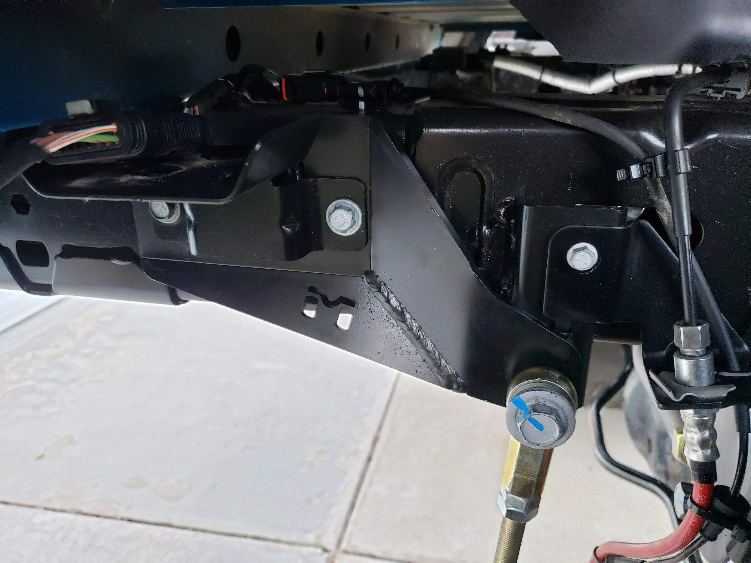

The other quick upgrade done that day some to add some MetalCloak rear swaybar reinforcement brackets. I didn't even know these were a thing until I had 2 friends with Gladiators rip off or bend their swaybar brackets up in Big Bear. Apparently this is a weak leak and MetalCloak designed a fix. I believe the 2 brackets cost arounf $79 and took about 30 minutes to install.
