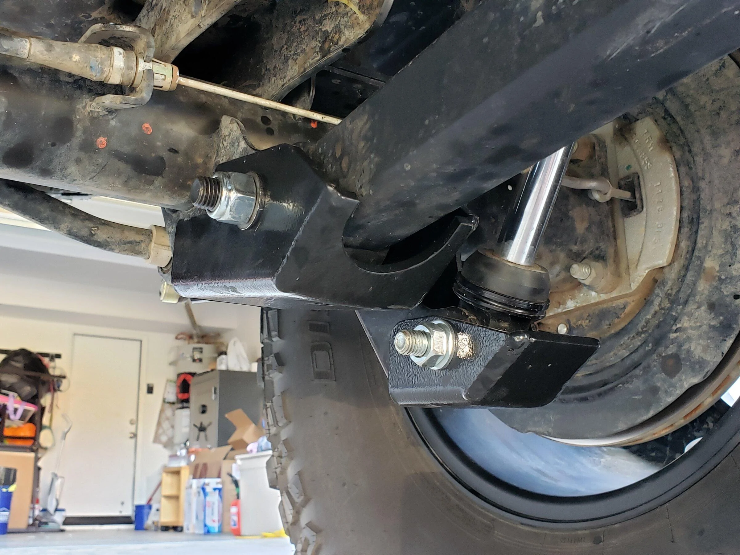

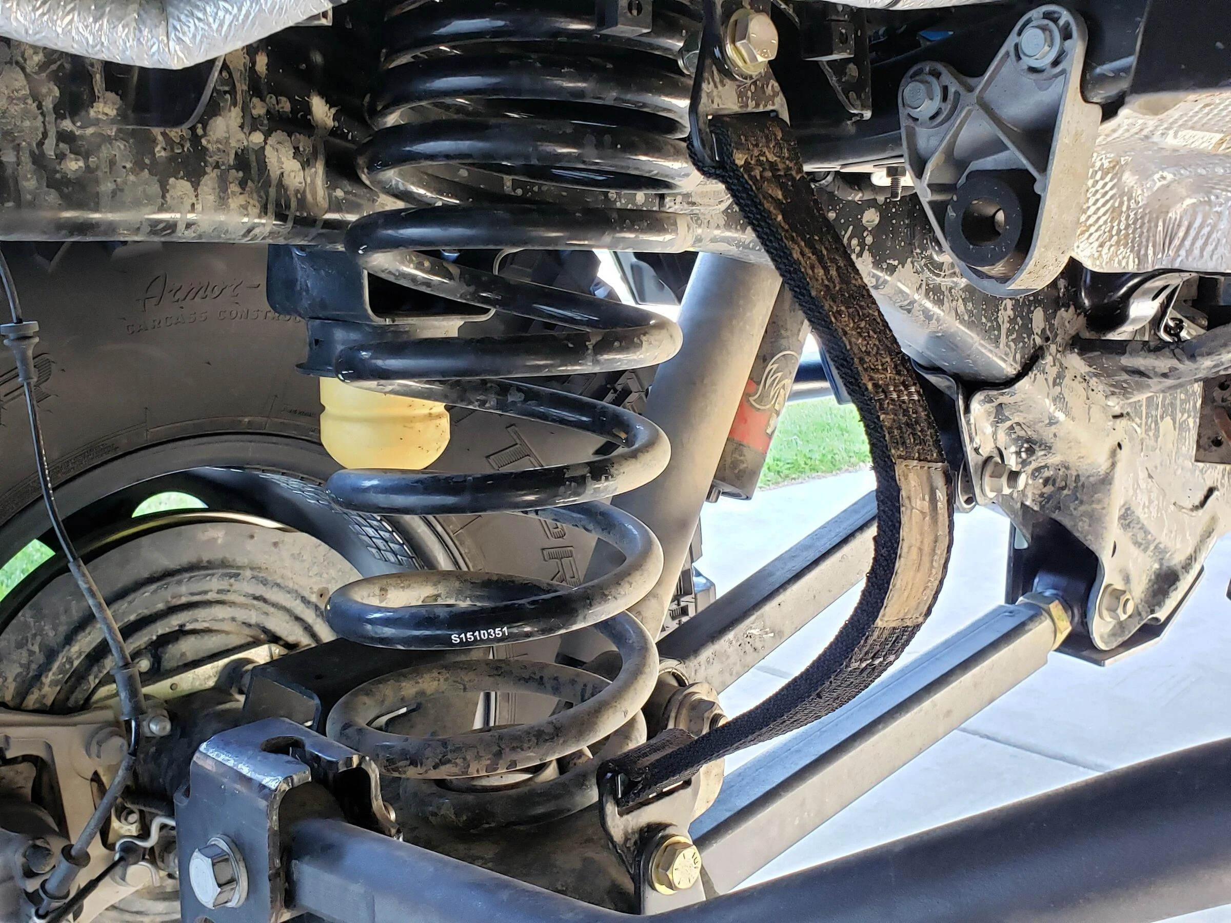

A few more upgrades to share now that I've been rock crawling a few times in the Mojave. On my first local trial I found out that I have more droop than my rear springs could handle and both my springs became unseated. Before I took the jeep to Utah for a extended offroading trip I knew I needed to fix the problem. I decided to add limit straps. I bought some tabs and had a buddy weld them on as close to the springs as we could get. After articulating the suspension it was determined I needed 18" straps for where the tabs were welded. I went with PRP limit straps. During all my days on the trail in Utah I never once unseated a rear spring. Very happy with this upgrade and all done for less than $100.

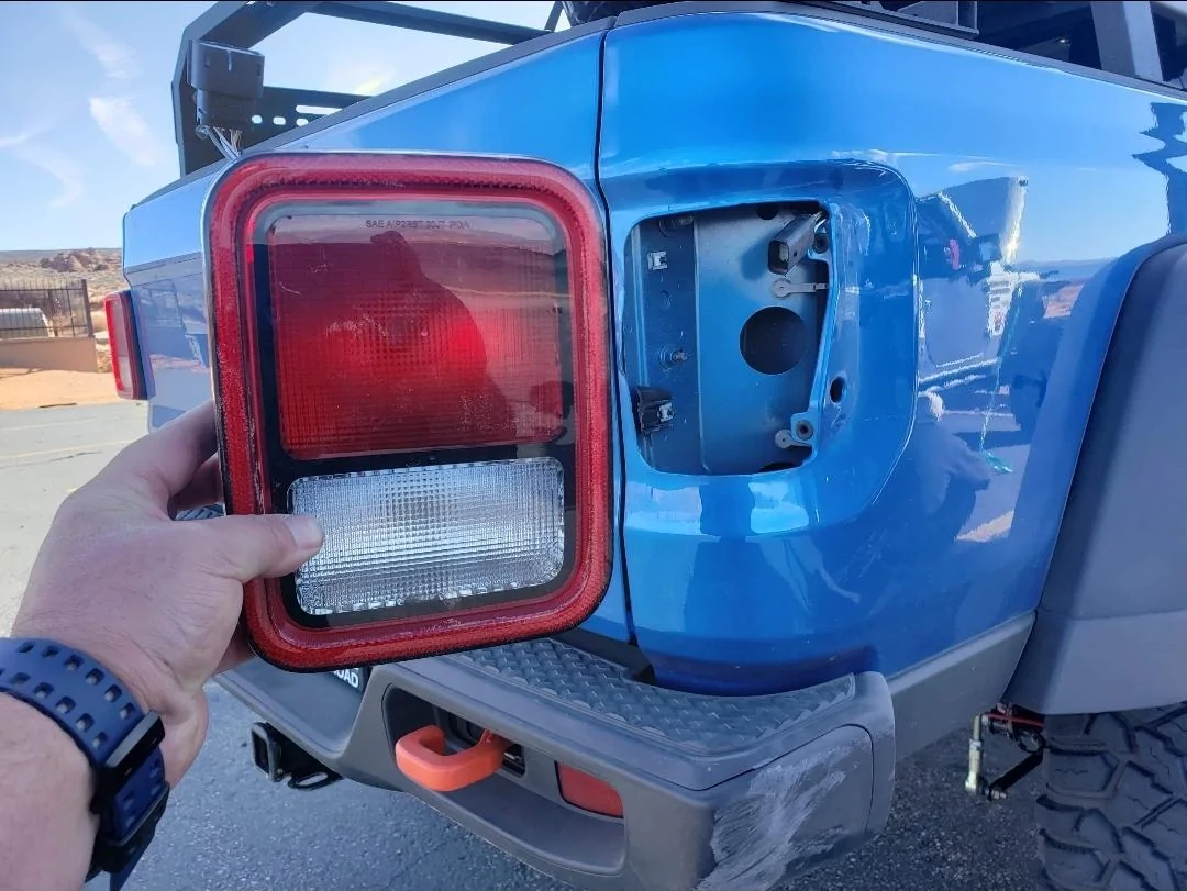

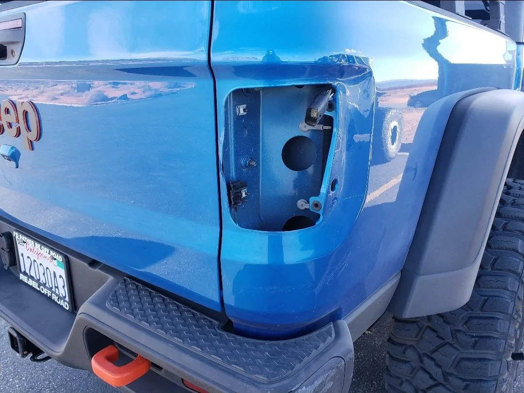

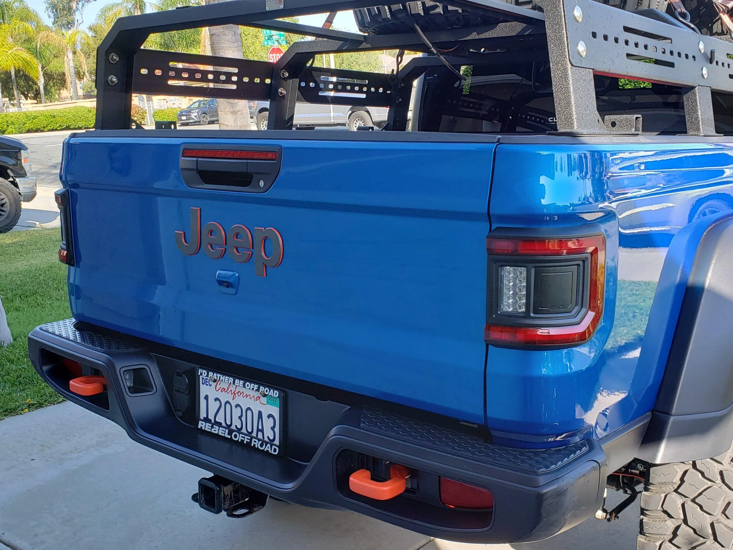

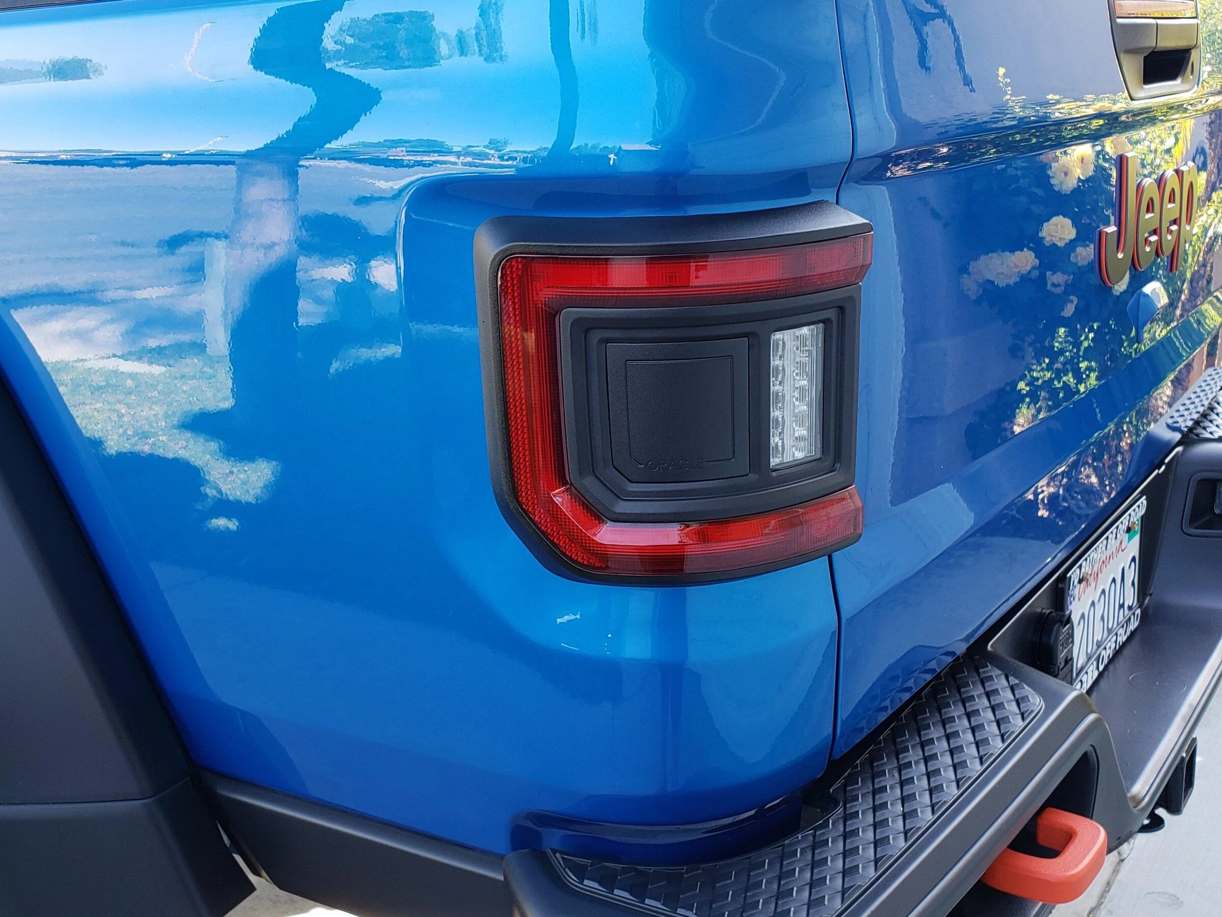

While I was in Sand Hollow, UT I busted my rear tail light off on a trail called "The Fallen" which is rated a 9. I've been wanting to upgrade the rear lights to flush mount Oracle led lights and this gave me the perfect reason to upgrade. I was able to JB Plastic weld the broken tab on the light to get home to California. The Oracle lights are so much brighter and better looking. I think I paid $340 total for them.

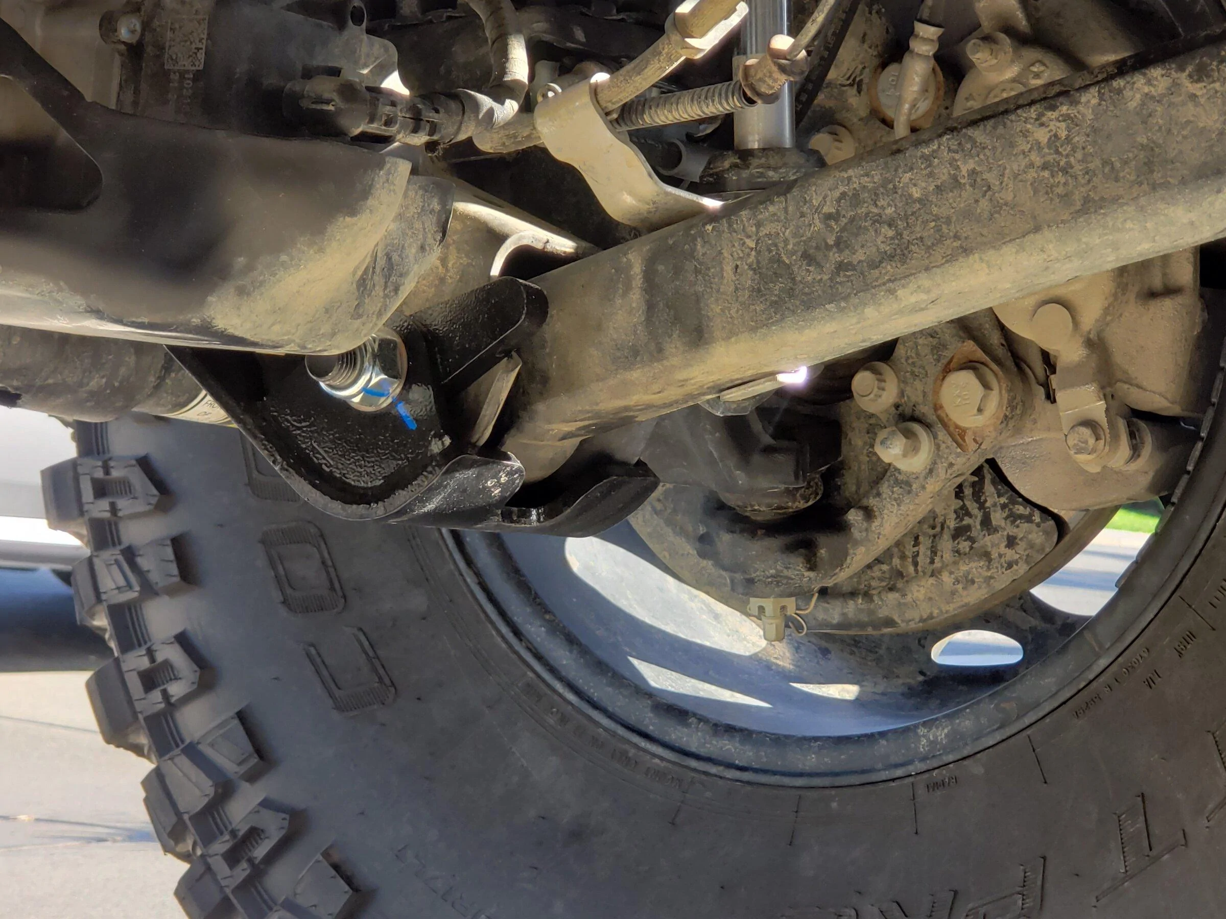

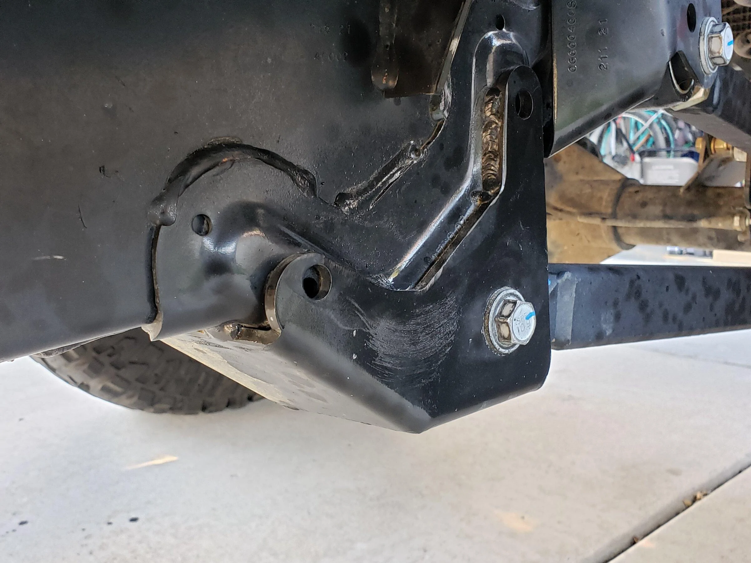

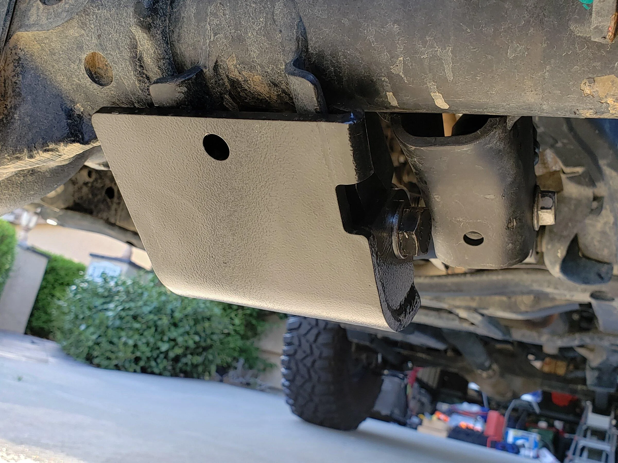

I almost forgot I also added some lower control arm skids and rear shock skids. The rear lower control arm bracket at the frame seems to be the low hanging fruit I always hit so I ordered some skids from Rusty's OffRoad. I had my buddy weld these on when he welded the tabs for my limit straps.
The rest of the skids are bolt on from Rock Hard 4x4 and cover the front lower axle mounts, the rear lower axle mounts, and the rear lower shock mounts. I had these on my 2016 JK and found them useful so I'm happy to once again add them to my Gladiator.
