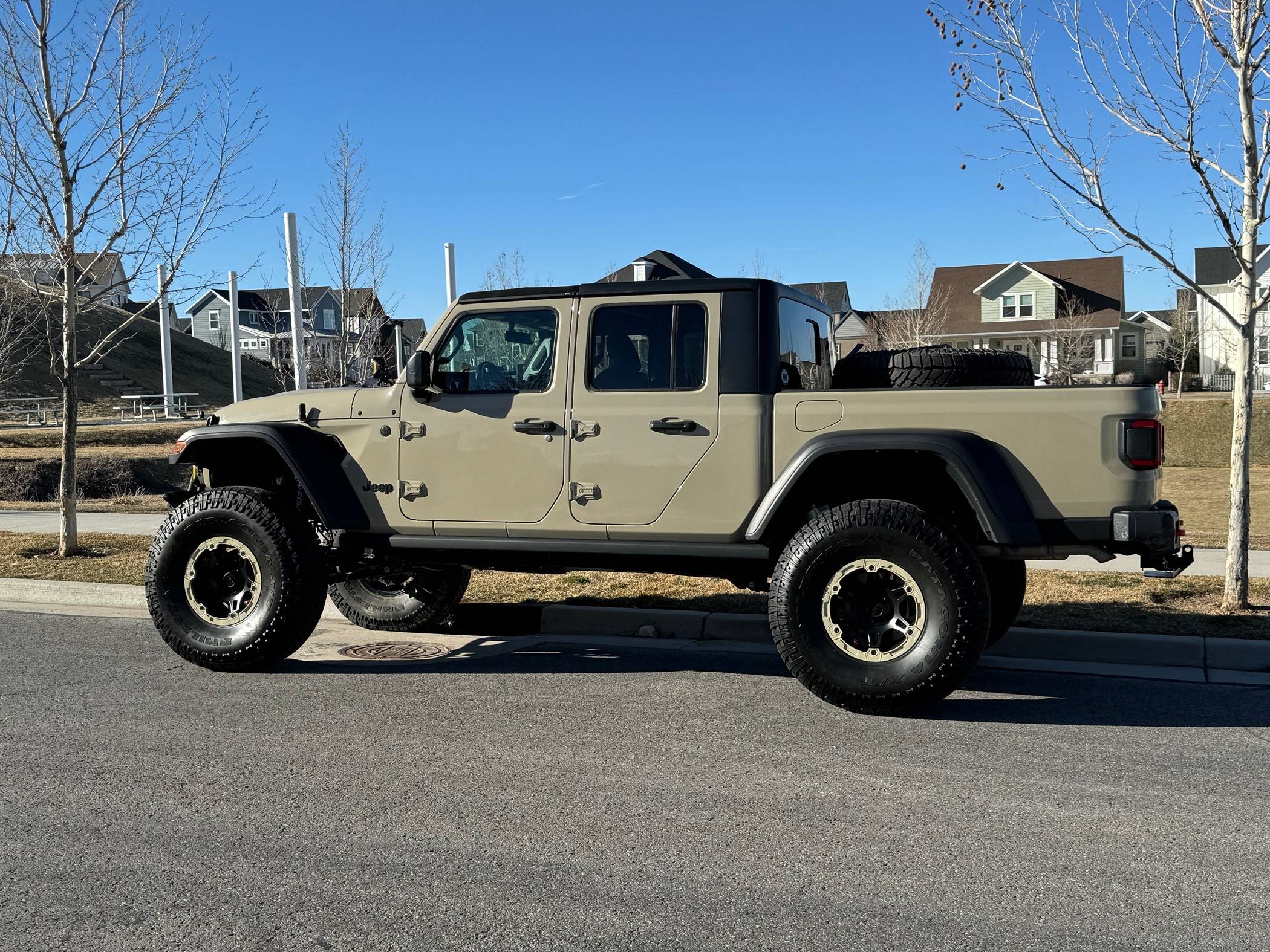

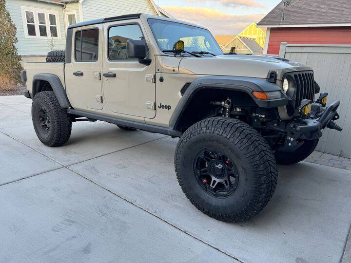

Before:
Jeep Gladiator Another Mojave on 40s jeep stuff
After:
Jeep Gladiator Another Mojave on 40s img_0197_720
Jeep Gladiator Another Mojave on 40s img_0100_720
