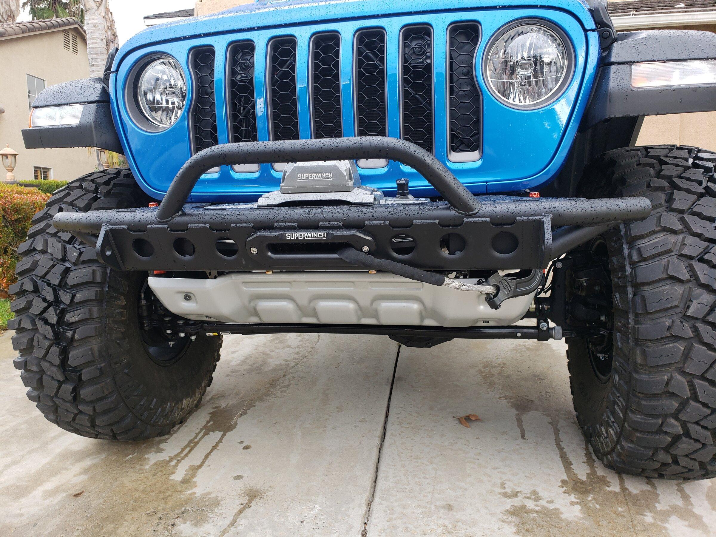

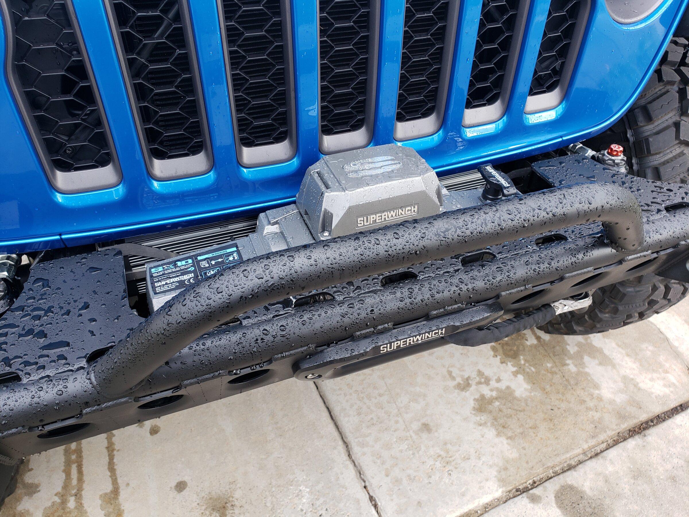

Installed the APEX Steering Booster yesterday and then finished installing the Barnes 4wd bumper and SuperWinch SX.

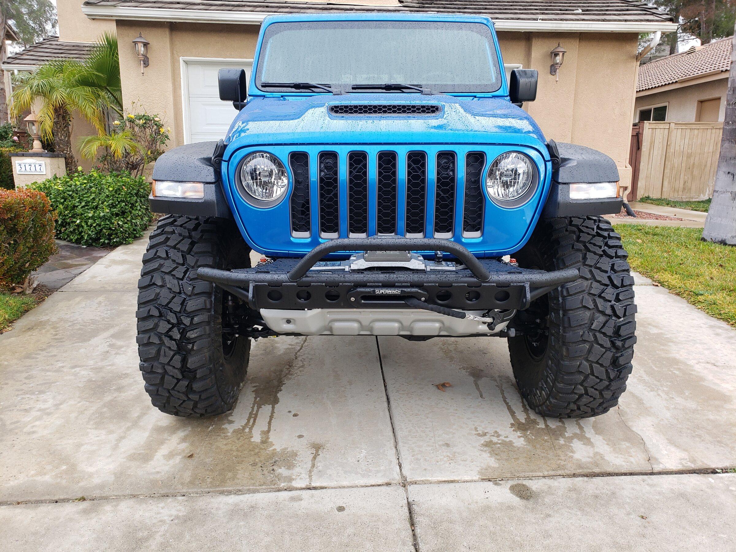

Just had the Mojave regeared to 5.13 and added an Adams 1350 front driveshaft today. I had Rebel Off-Road in Orange County do the work. When I got home I had a present on the driveway. My Barnes 4WD Prichett Canyon front bumper arrived. Time to get it painted and installed and add my SuperWinch SX10000 which has just been sitting in the garage.
Good looking bumper

I decided to paint the bumper with Rustoleum Textured Satin Black most because I didn't want to wait till Tuesday for Powdercoating plus Rustoleum is easy to touch up after Off-Roading.
Your bumper came out great. I stopped getting stuff powder coated ages ago and now I paint everything that will scrape rocks. I totally agree with you. It's just so much easier to touch up and you only have to worry about the area that scraped.

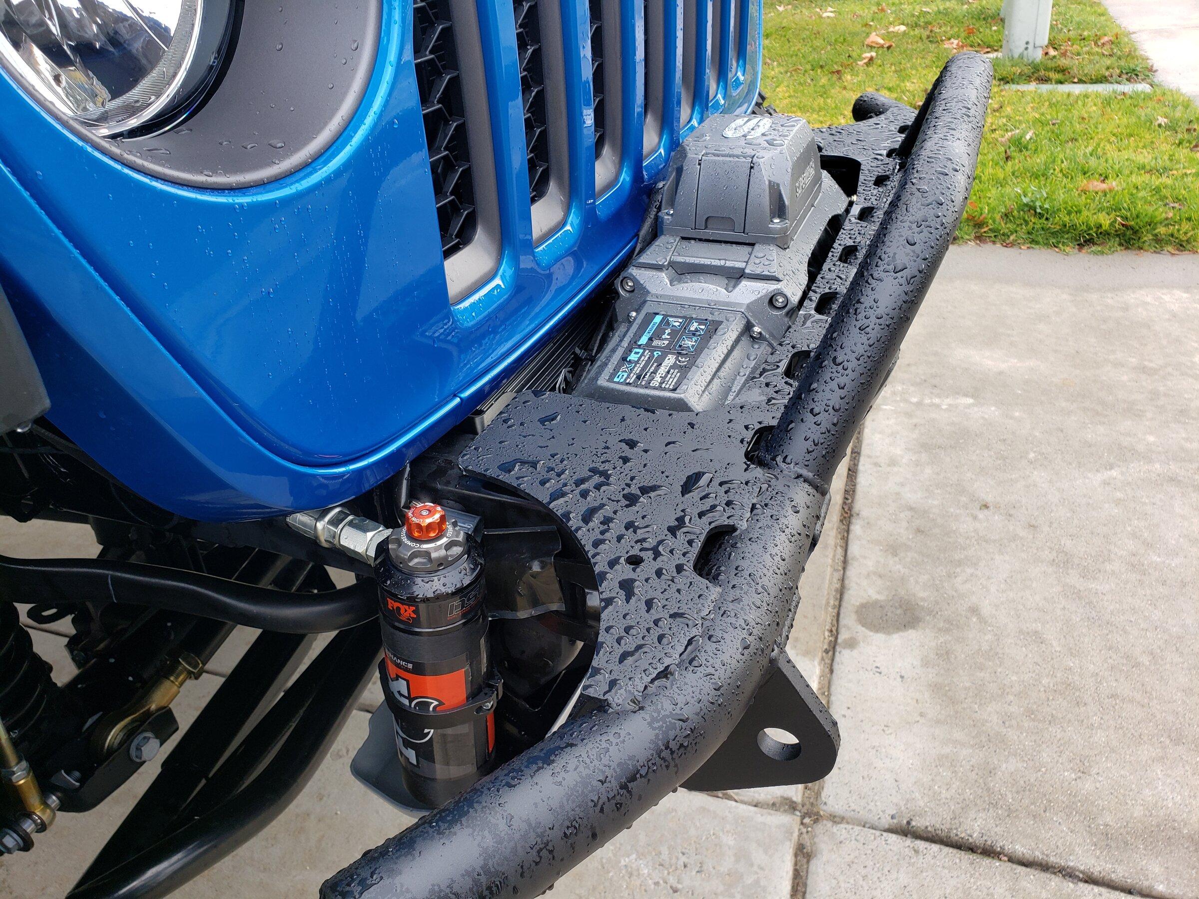

A few pictures of the new 2.5 Fox Performance Elite Resevoir DSC shocks. Love the adjustabilty of these shocks and didn't sacrifice any performace from the Mojave Shocks minus the internal bypass feature. I had to drill out the bushings on the front shocks only because the Mojave Gladiator uses M14 bolts and everything is designed for the JL/JT which uses M12 bolts for the front shocks.
Did you drill out both the top and bottom bushings of the front shocks? If so, did you have any trouble with the bottom bushing spinning?
Yes I had to drill the metal sleeves inside the bushings out larger on top and bottom. I thought it would be easy and it was a huge pain in the butt. The heat created from drilling melted the bushings a little. It was a slow and frustrating process for me. I didn't run into a spinning issue, just a heat issue.

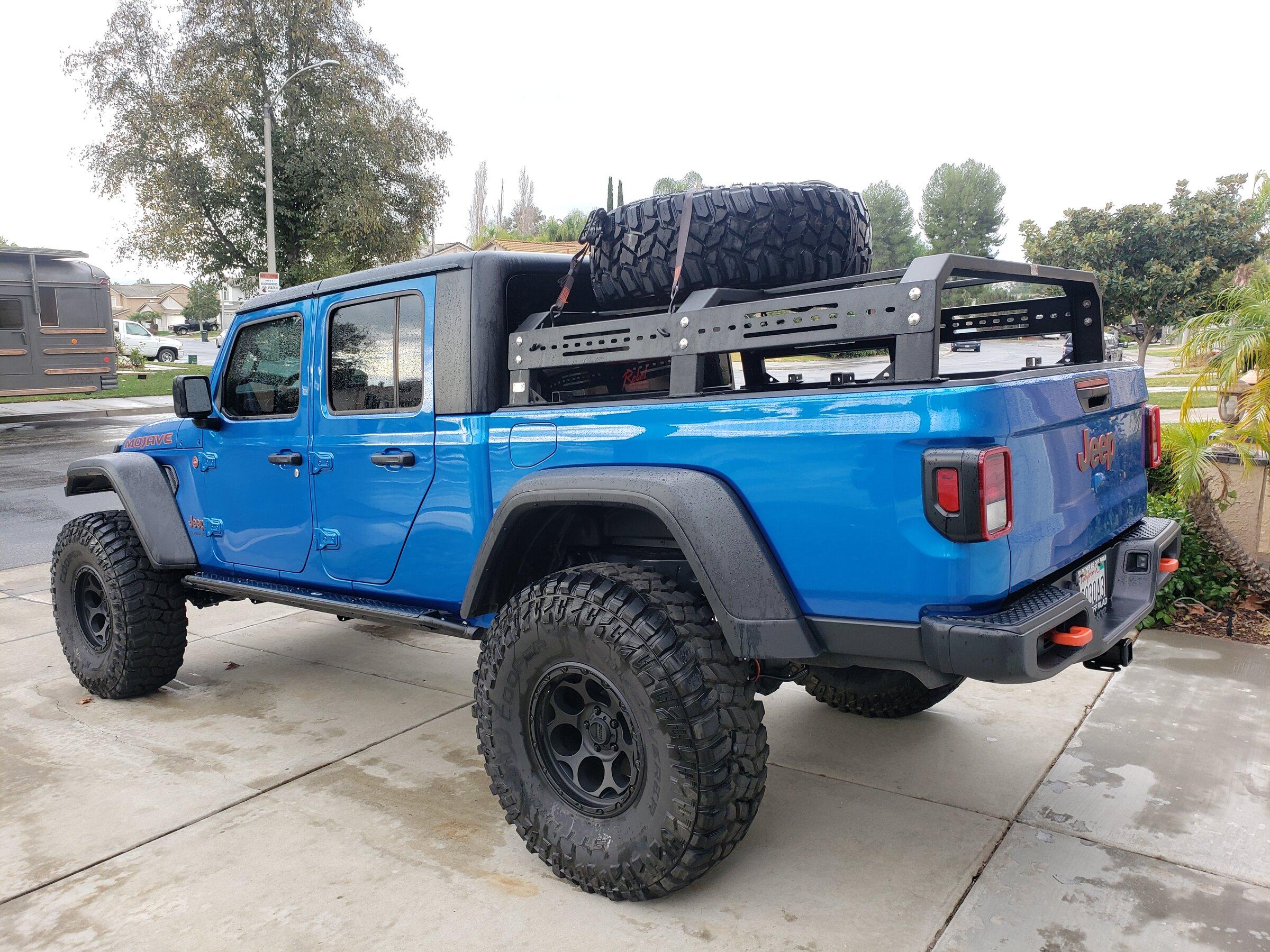

My rack mount is from Fishbone Off-Road and is called thier "Tackle" rack 1/2 height. I bought it through Quadratec on a sale before Christmas. It was one of the first modifications I added.
How do you like the Fishbone? Heard some negative things about the loc washers etc but there is bad stuff about EVERYTHING. I think it looks pretty great. I called and they said it only weighs 97lbs - does that seem accurate?

I am seriously debating selling my ACE bumper for the Barnes unit to get more of a prerunner look and so I can fit in the garage again...the stinger on mine sticks out a bit too far to fit. I have only seen 2 or 3 other Gladiators with it so it is great to finally see a recent build with it!
Jeep looks awesome thanks for sharing! Looking forward to seeing future updates.
