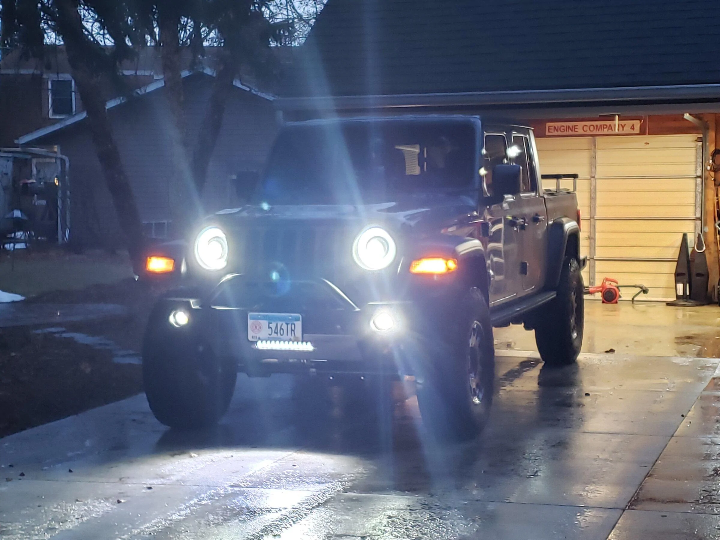

After staring at my front light bar for months I decided to take it off. After upgrading to the Oculus LED headlights/fogs it really doesn't add much light up front and it's always looked kind of just stuck on to me. I didn't like the look of the naked mounting tab so I cut that off as well. Looks much cleaner to me now.
Before:
During
After
How attached is that tab and what did you use to cut it off?
I have the same bumper on order and won’t be mounting any lights. What paint did you use to touch It up and how well did it match?

The tab is welded on. I used an electric cut off wheel/grinder to cut of the tab and then smooth out the the bull bar. Then I hit it with some rustoleum self etching primer and rustoleum flat/matte black. The paint matches pretty well and it's on the back side of the bull bar so it isn't noticeable.
https://www.homedepot.com/p/Rust-Ol...amel-Flat-Black-Spray-Paint-7776830/100670370

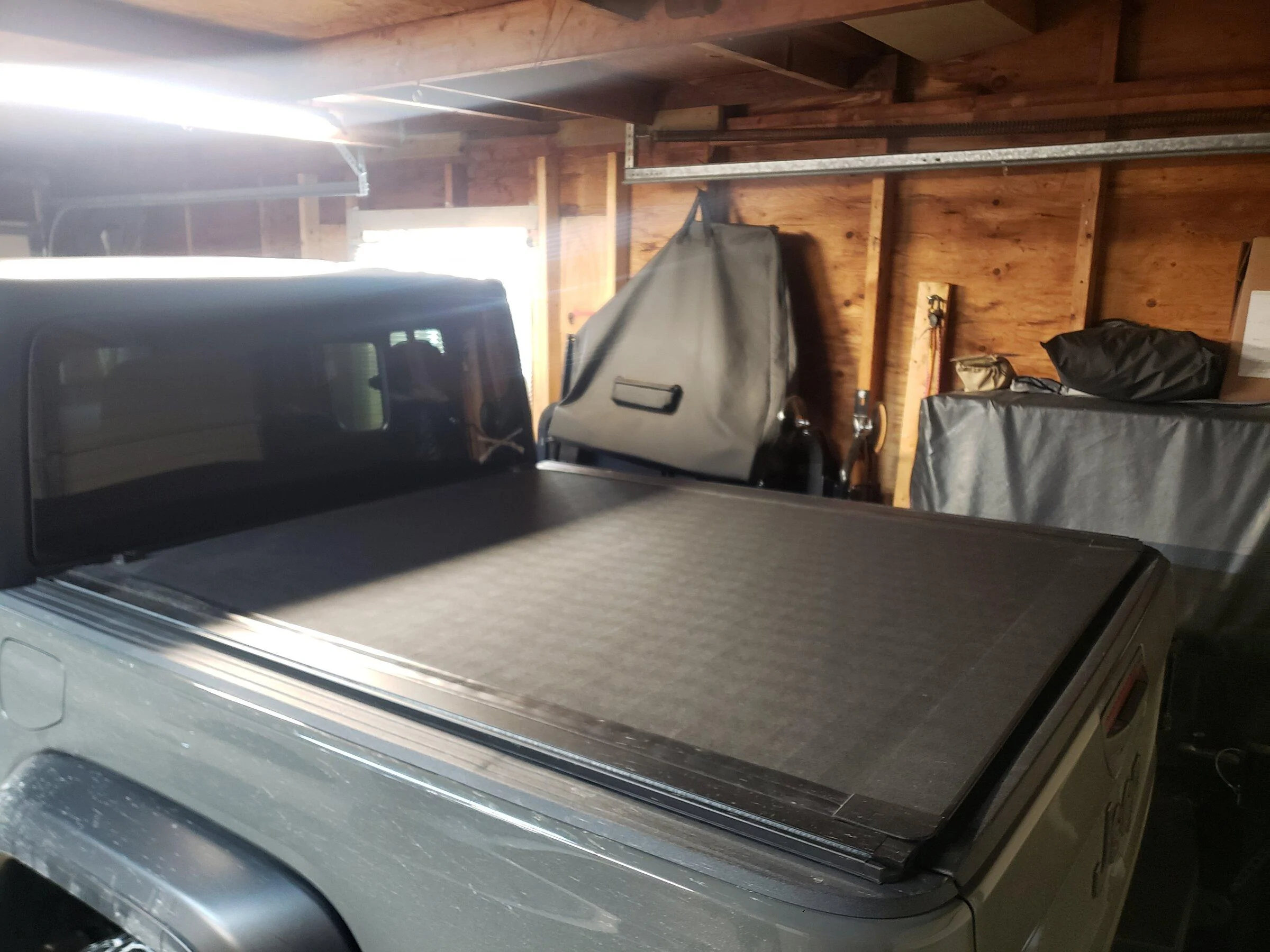

Changed up my bed/tonneau/rack
Went with a Bak X4S cover. It's a hard rolling cover that secures the bed when locked and has t-slot on the bed rails for mounting a rack. I will be using front runner legs and crossbars to mount the RTT now. When I'm not using the RTT I can strip the rack off and have a completely open bed (for mulch and truck stuff)
Jeep Gladiator RodReckets Sport S Build Thread 20220113_074555
Jeep Gladiator RodReckets Sport S Build Thread 20220226_152636

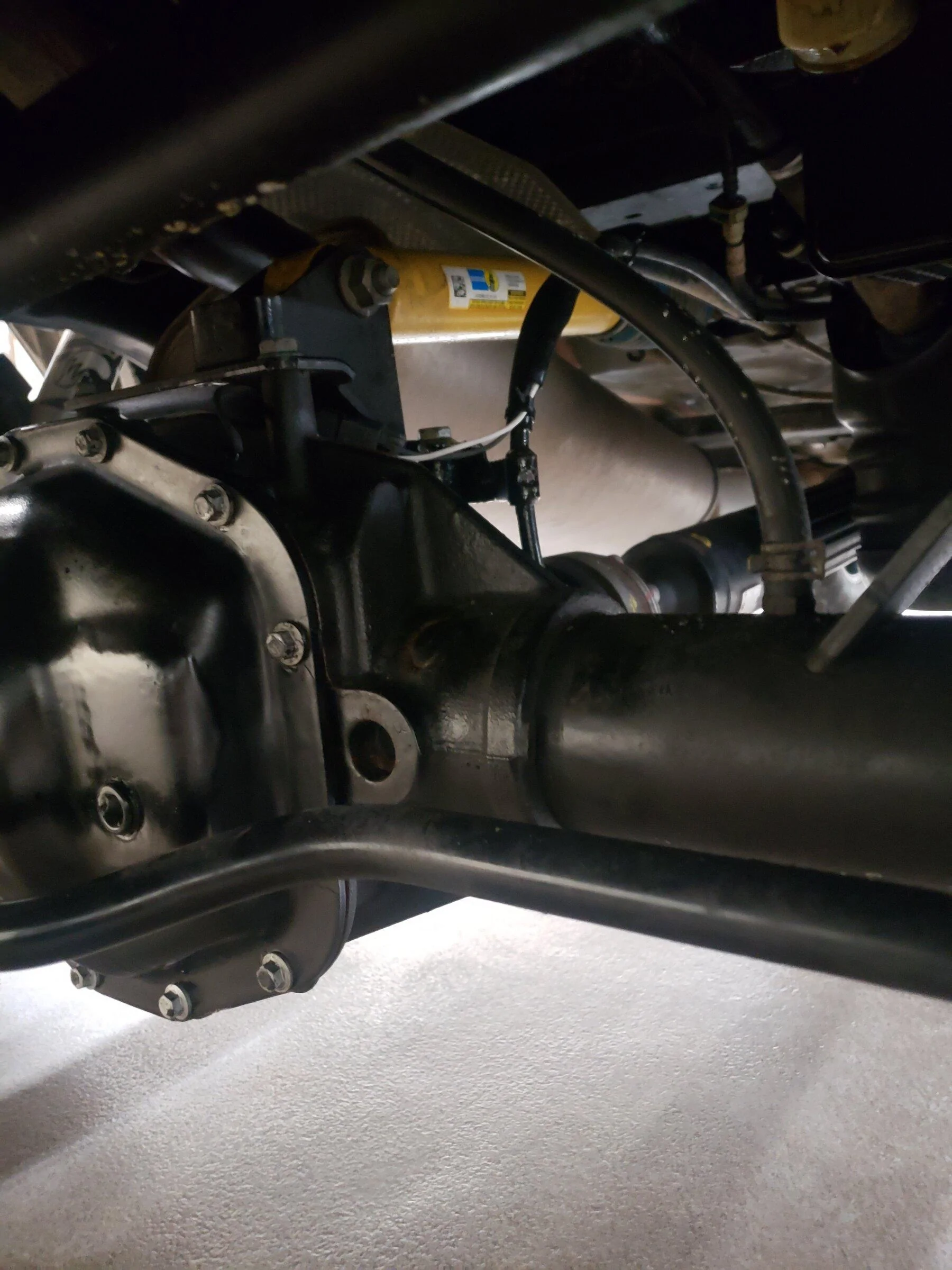

A very exciting addition to the JT Sport was the installation of an Eaton e-locker. A lot of consideration went into this choice vs air locker, ox locker, and truetrac. I didn't want to worry about an air pump or condensation freezing in arb air lines, didn't want to run the ox cable, and didn't want to have any daily driving interference (and not a truly locked diff) from a truetrac. The e-locker is wired up to my auxiliary panel so I can engage it in 2high, 4high, or 4low. Wiring is simple and tucked out of the way.
Jeep Gladiator RodReckets Sport S Build Thread 20220227_205726

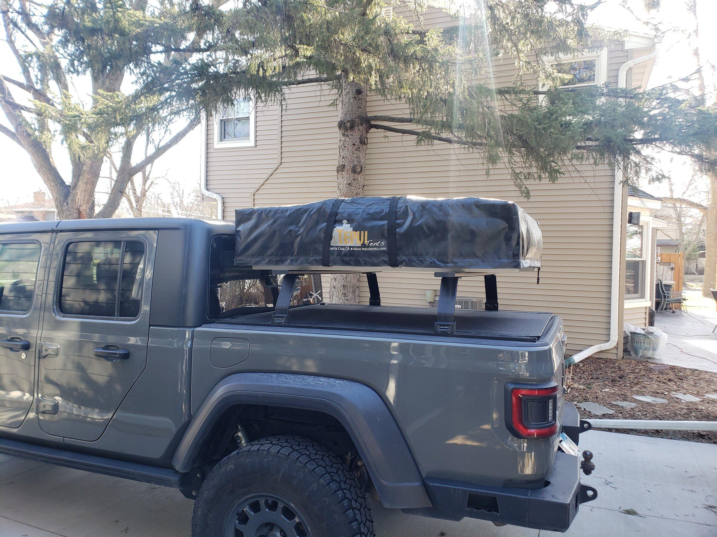

Here's the updated tonneau/rack/tent combo. Held up very well on a trip to Moab for EJS and back from MN.
Jeep Gladiator RodReckets Sport S Build Thread 20220419_092430
