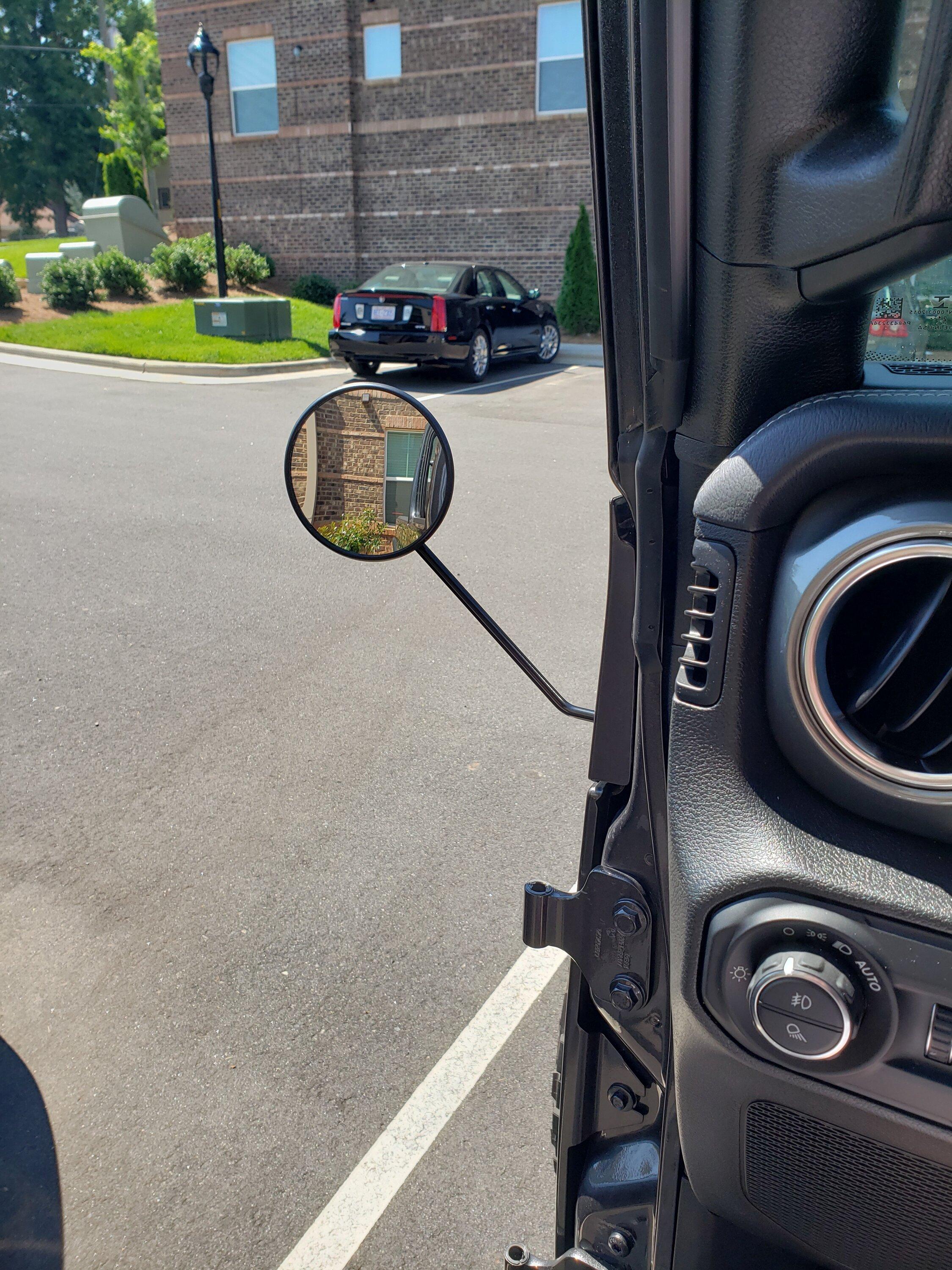

OK, I'll get a pic next time I have the doors off. The mirrors screw directly into the cowl; you can remove a bolt using the Jeep toolkit and then screw the mirror right in. Then there is a nut on the mirror's threaded stud to secure it. So far mine hasn't slipped down even once, and the vibration is fine up to 50mph or so. It's not super useful on the freeway other than keeping me in accordance with Michigan law, but, yeah.
They work great for me. Just want to be legal.

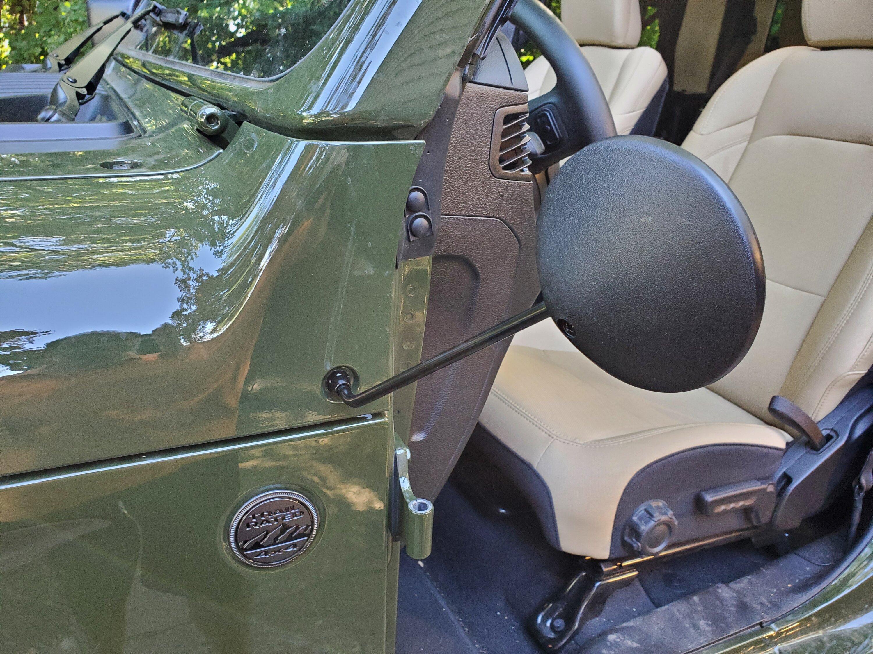

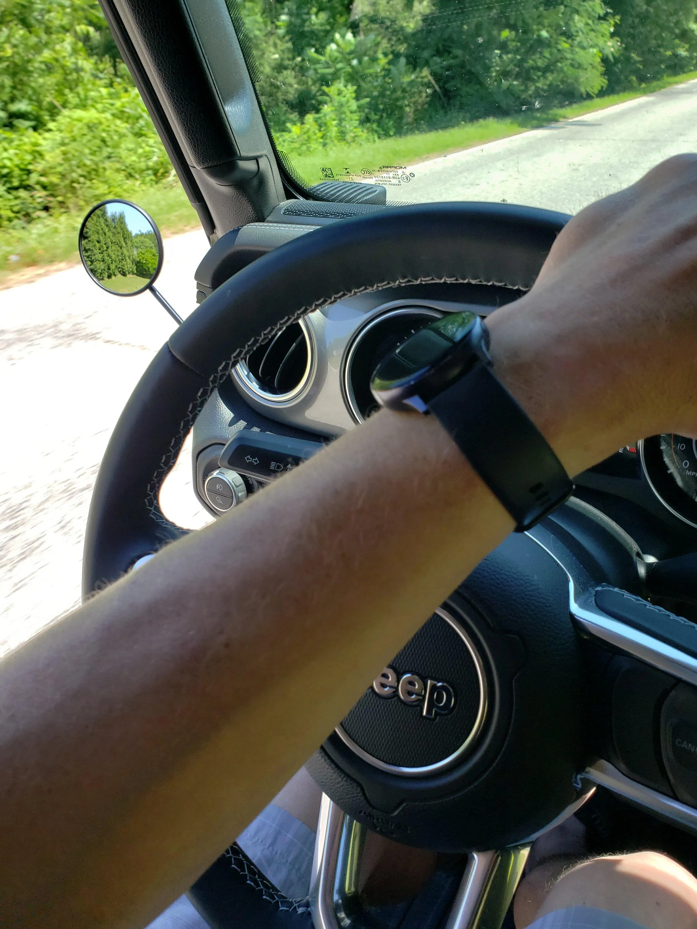

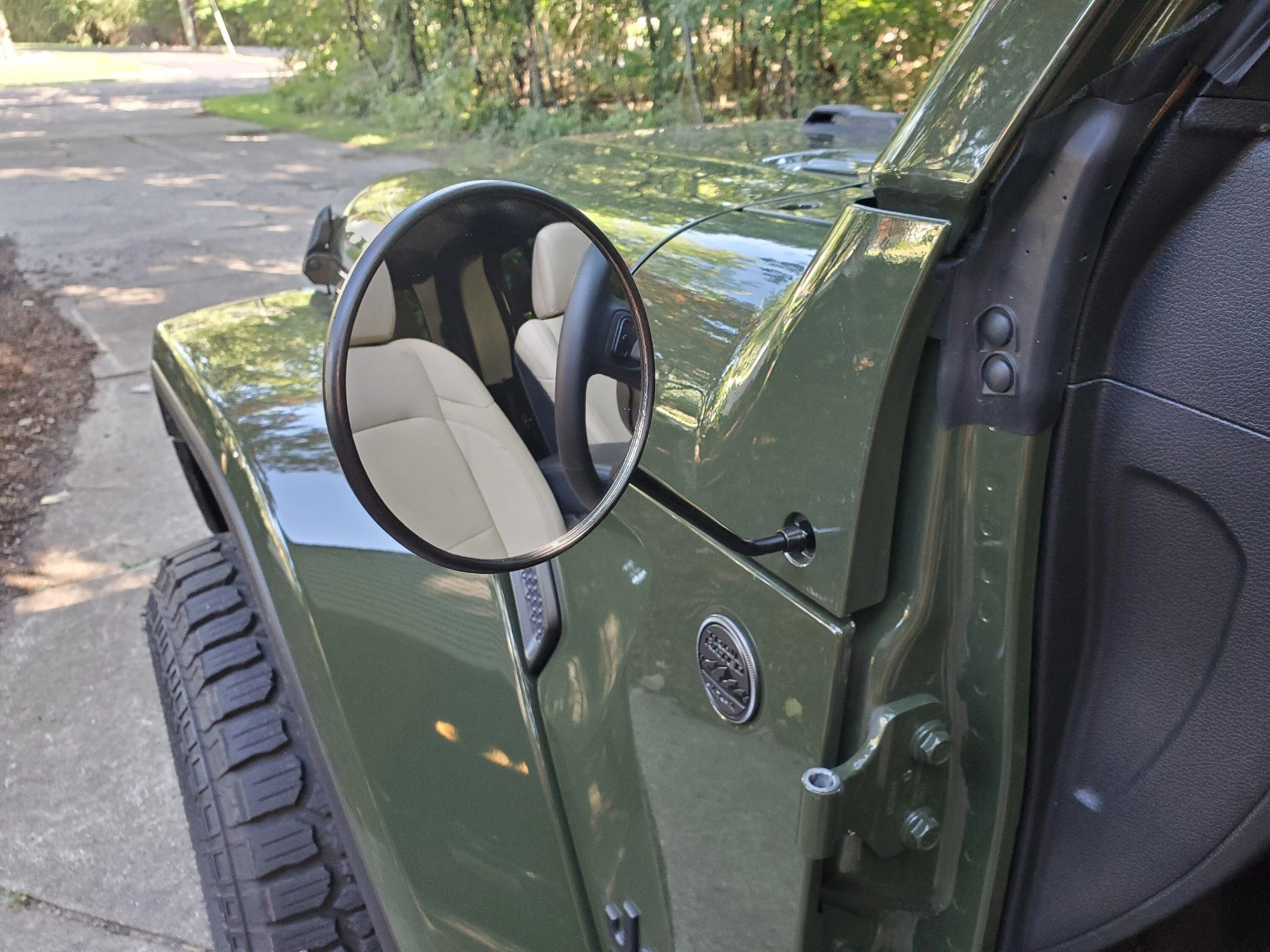

Nice look JT. I’m a fan of the green. Mines a Gator. I’m curious how those scooter mirrors mount and look.
OK the scooter mirrors are these: https://www.amazon.com/dp/B00DOV2LUE
...and they kind of just work:
Jeep Gladiator Sarge Green Sport S HIGHLY UNNECESSARY Build Thread 20220725_093251
Jeep Gladiator Sarge Green Sport S HIGHLY UNNECESSARY Build Thread 20220725_093246
The nut is a tiny bit hard to finger tighten, so I might put some kind of washer or spacer on it (Narrator: he is too lazy to do this), but for the money, it's a no-brainer.
