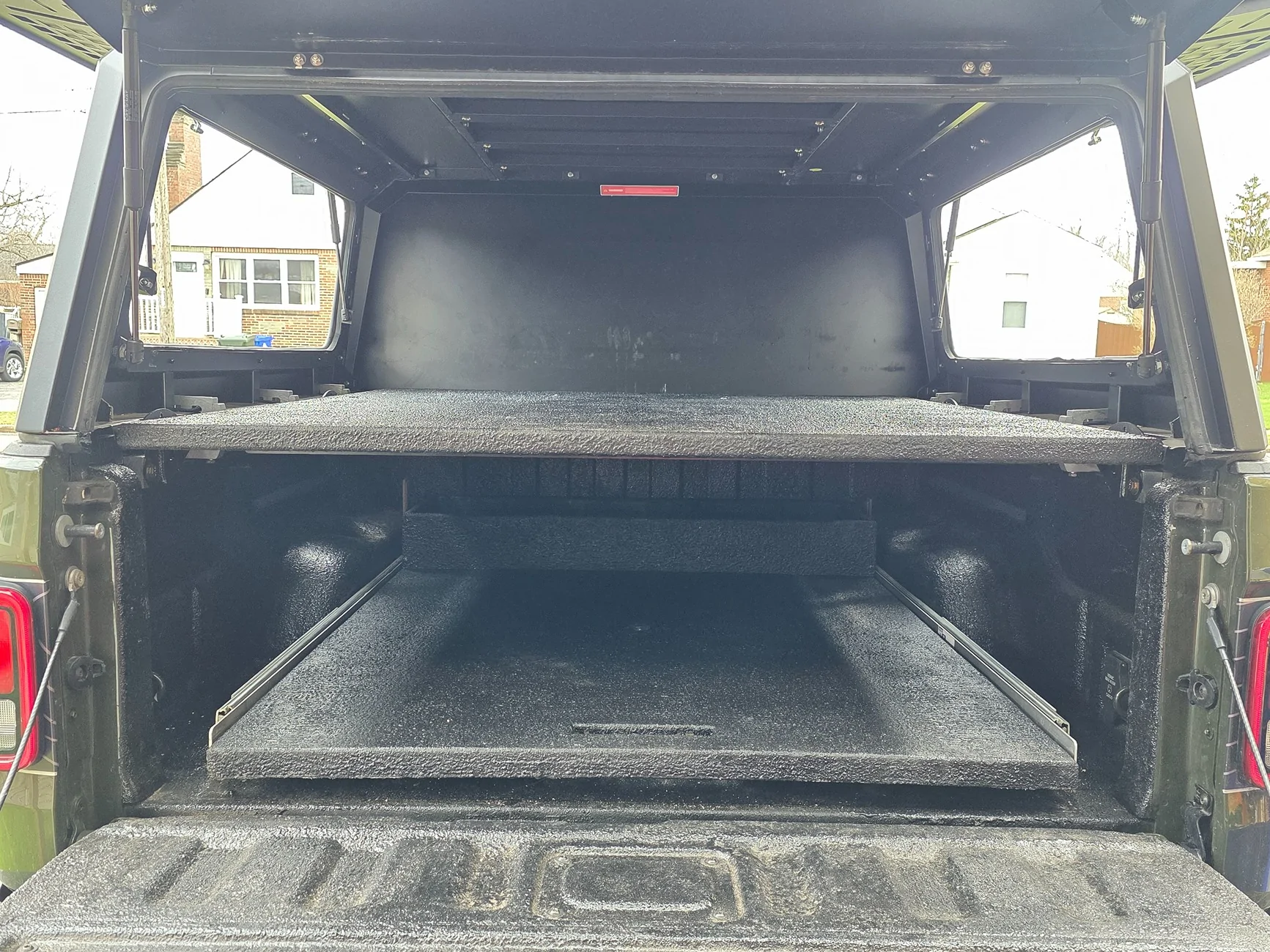

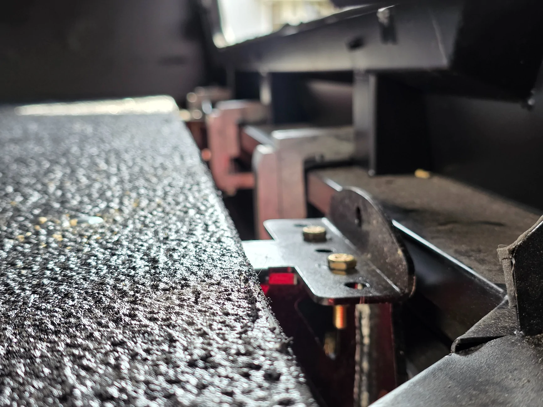

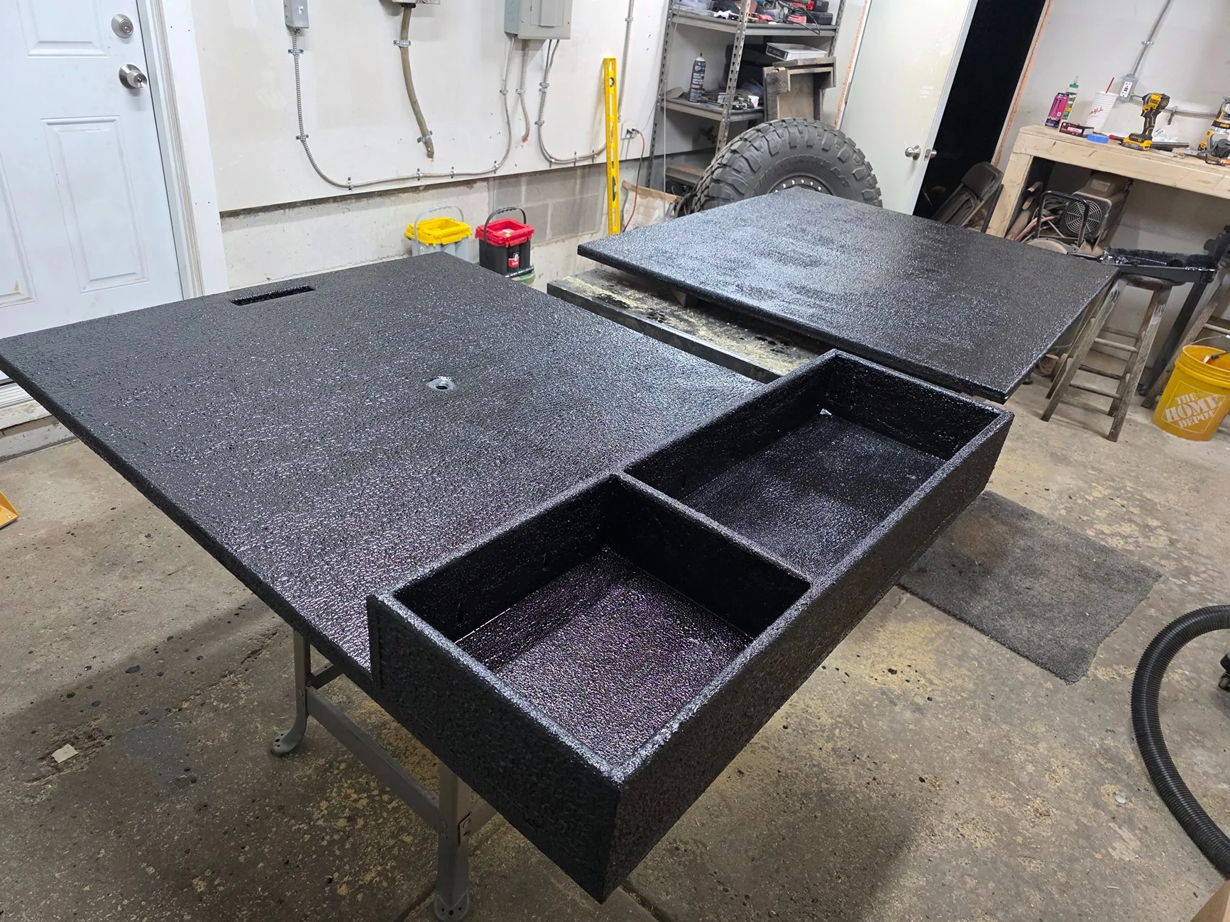

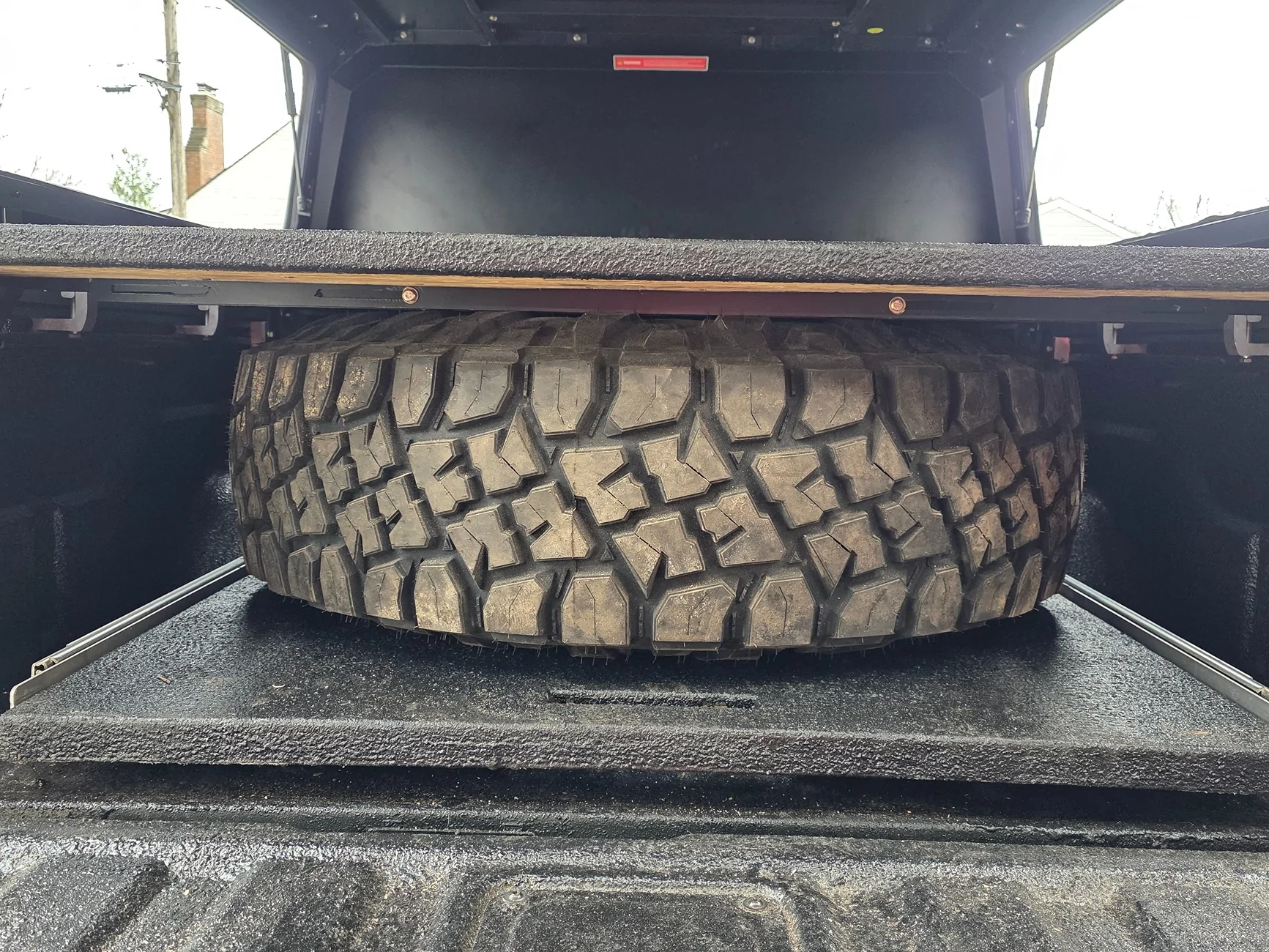

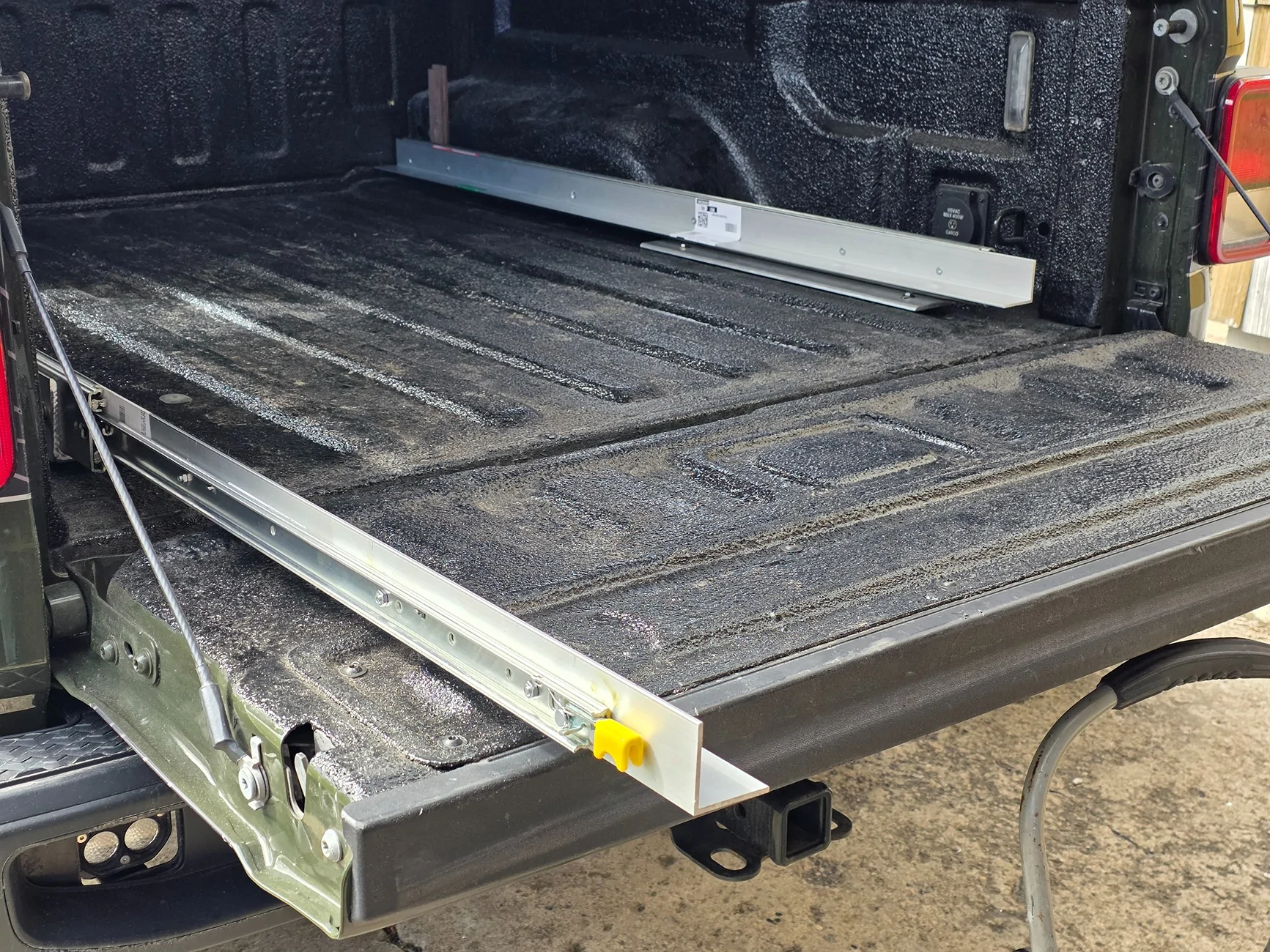

I wasn't happy with the original blackstone setup & the upper level. I decided to change everything up and make my own DIY bedslide + re-make my upper level.
Did the usual 3" aluminum L channel & nutsert mount method.
I need this to be a low profile as possible.
Jeep Gladiator Sarge Green Build Thread, 42s (2025) max tow... overland etc 20260330_111953

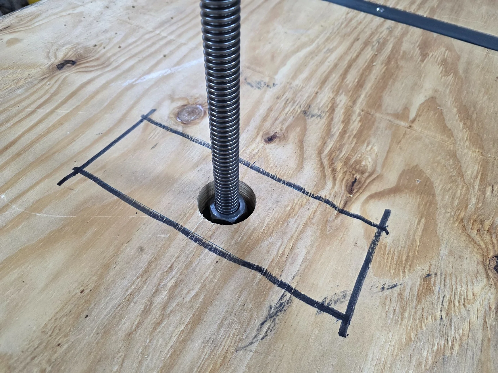

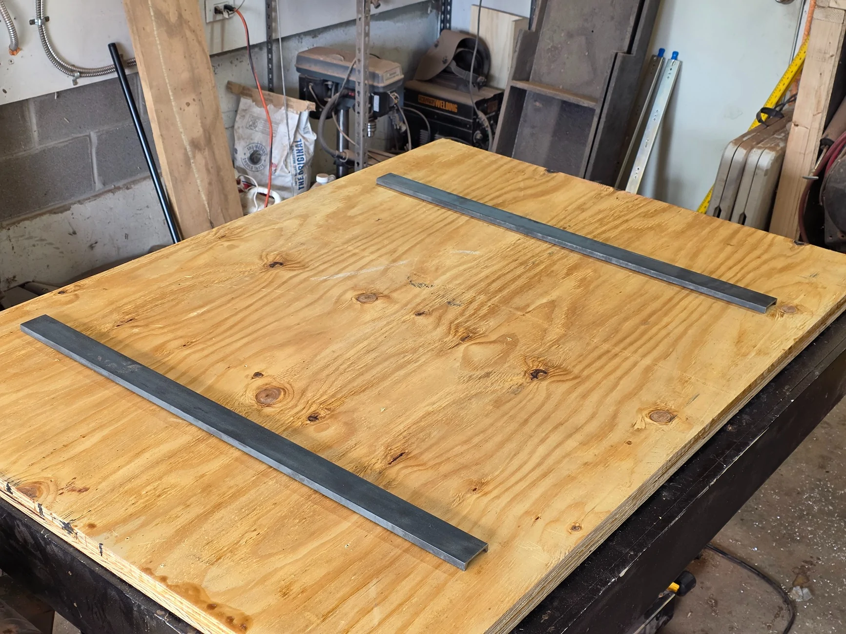

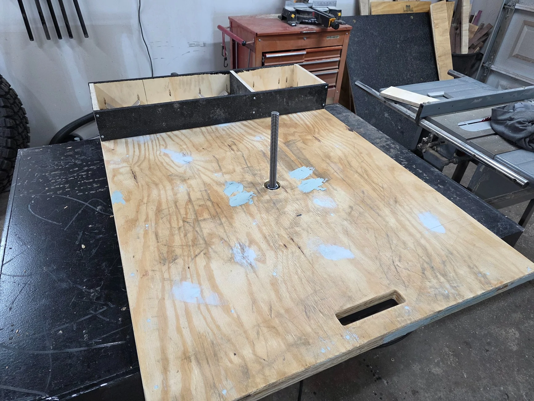

I glued two 3/4" sheets of plywood together. I needed them to be 1.5" thick for the next steps

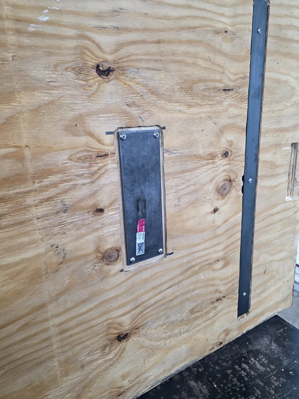

I used steel C channel and inset it 1/4" into the wood for support. This let me build in some "preload" to the panel to account for sag over the next couple years.
I also welded a 1-5 acme nut to a 4x12 plate and inset that as well. My spare will bolt to this
Jeep Gladiator Sarge Green Build Thread, 42s (2025) max tow... overland etc 20260330_113716
Jeep Gladiator Sarge Green Build Thread, 42s (2025) max tow... overland etc 20260401_111227

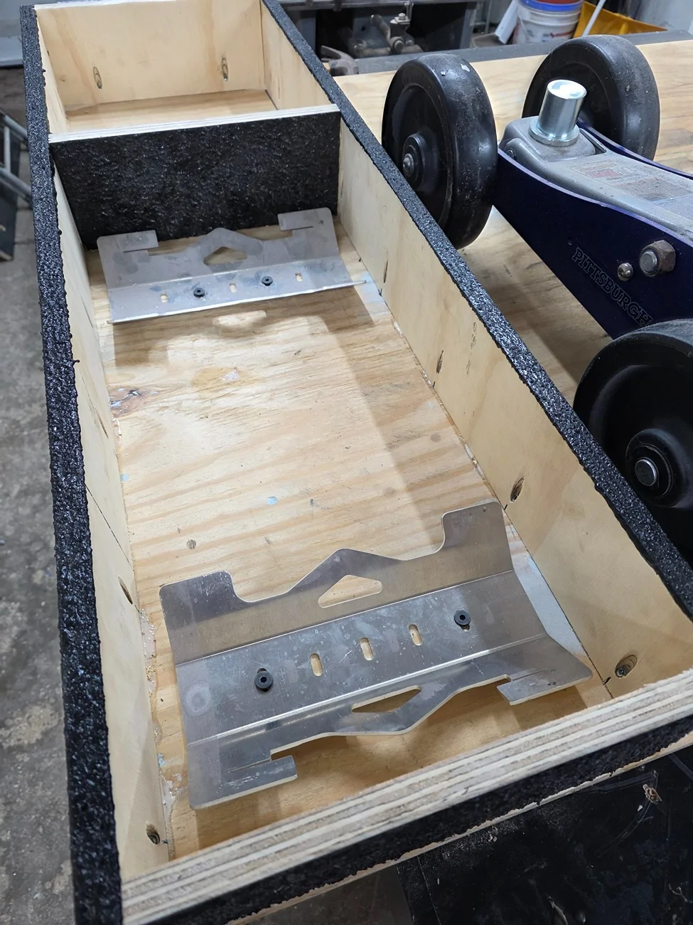

Also made a box for my jack mount & fluids
Jeep Gladiator Sarge Green Build Thread, 42s (2025) max tow... overland etc 20260401_100802
Jeep Gladiator Sarge Green Build Thread, 42s (2025) max tow... overland etc 20260331_170808
Jeep Gladiator Sarge Green Build Thread, 42s (2025) max tow... overland etc 20260401_111257

Jeep Gladiator Sarge Green Build Thread, 42s (2025) max tow... overland etc 20260401_204016
Jeep Gladiator Sarge Green Build Thread, 42s (2025) max tow... overland etc 20260401_204030

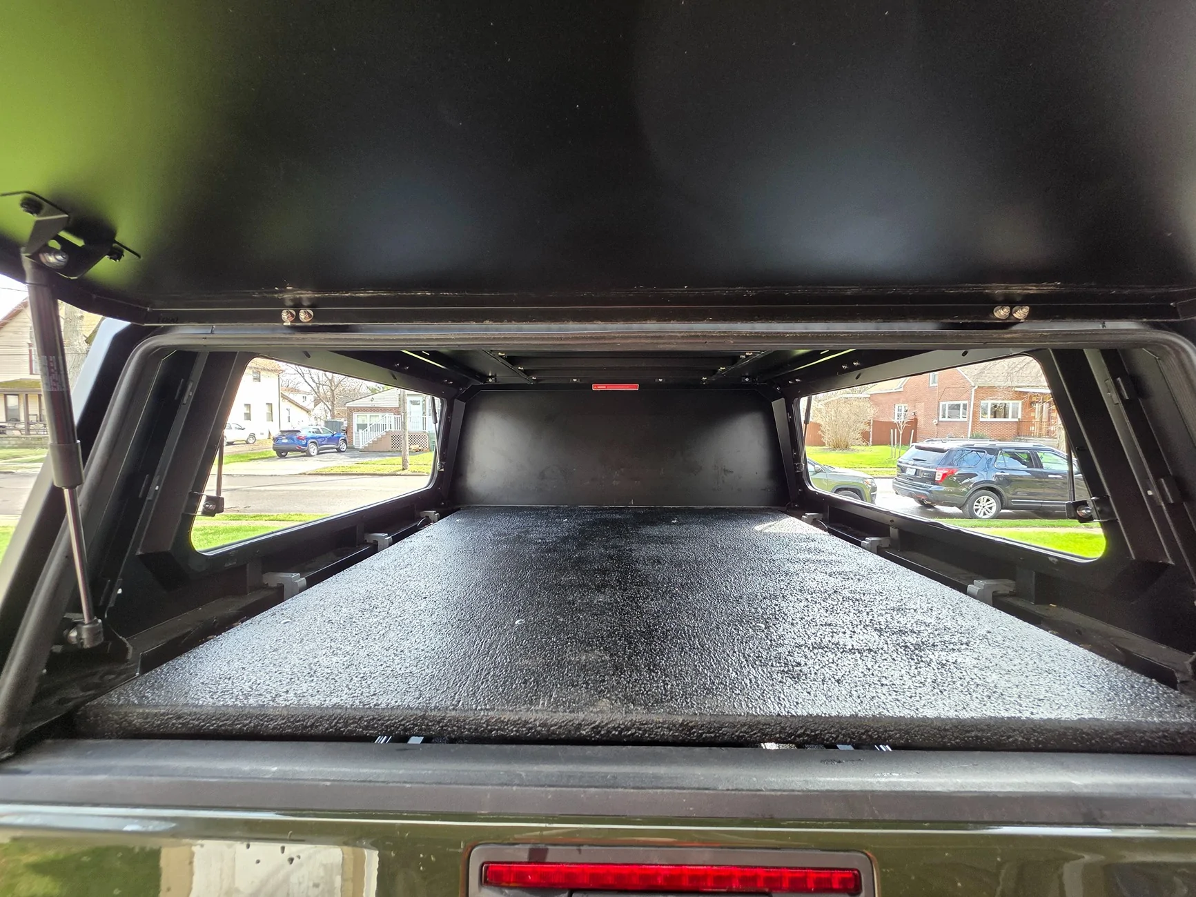

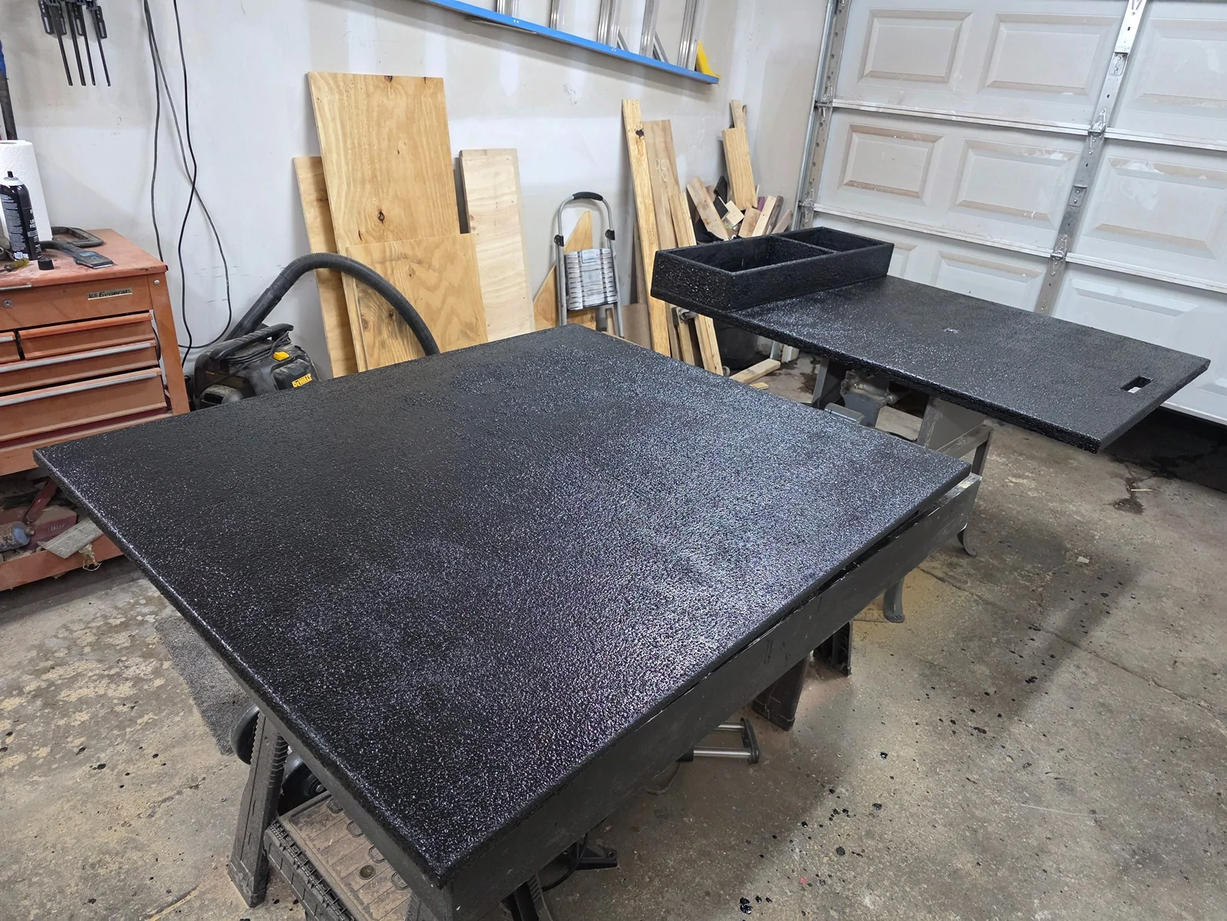

Coated with herculiner

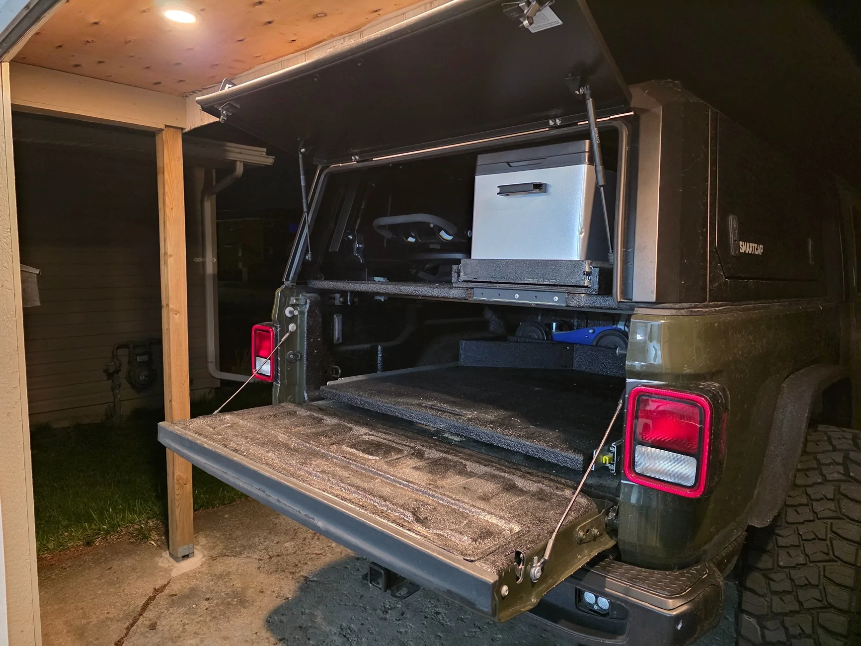

the new upper level is 50" wide which gives me just enough room to reach my inner tie downs & I can still reach the trail rail.
It is full length from cap to tailgate
Jeep Gladiator Sarge Green Build Thread, 42s (2025) max tow... overland etc 20260402_150524

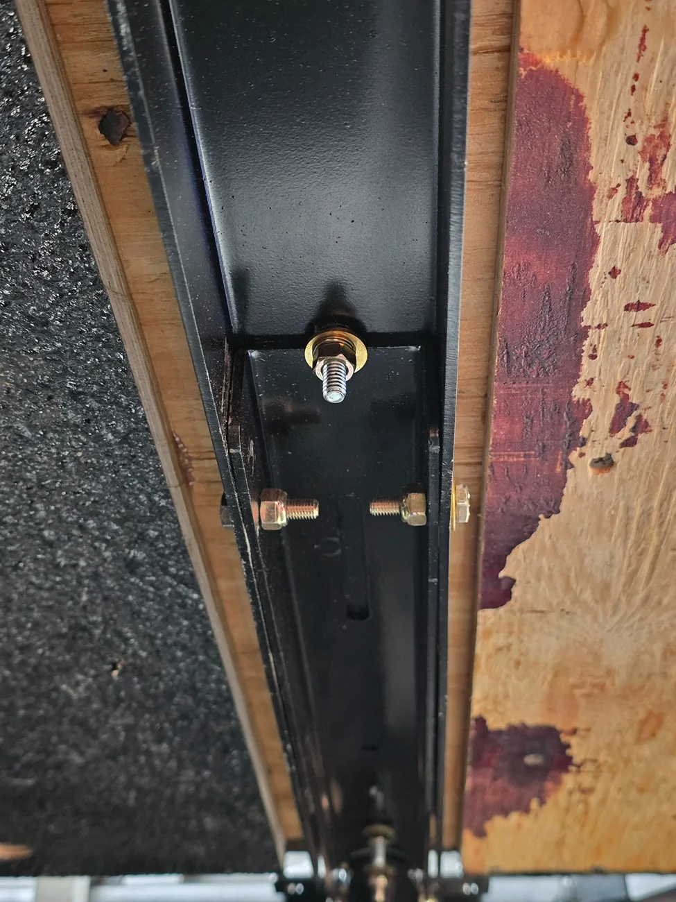

This one is two sheets of 5/8 plywood glued together but I left 3" channels between the laminated sheets so my rails would sit inside.
I wanted the extra room for my fridge freezer that will be going on the top platform.
Jeep Gladiator Sarge Green Build Thread, 42s (2025) max tow... overland etc 20260402_150511
Jeep Gladiator Sarge Green Build Thread, 42s (2025) max tow... overland etc 20260402_151612
Jeep Gladiator Sarge Green Build Thread, 42s (2025) max tow... overland etc 20260402_150536

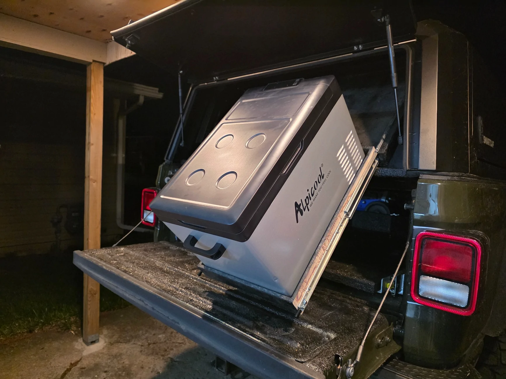

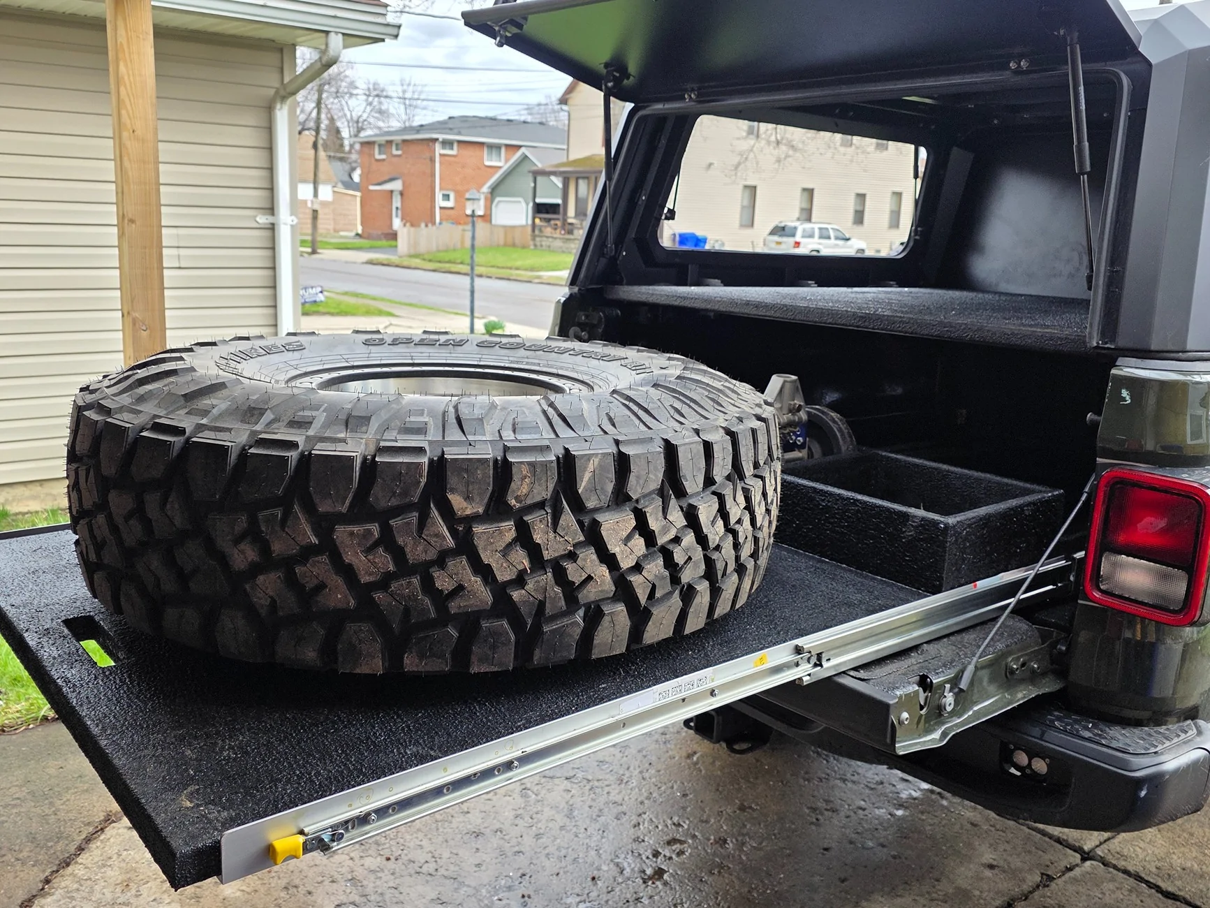

Quick update:
I am still waiting on some solar controller parts to come in, but in the meantime I did get my fridge mounted on a custom built slide & tilt tray.
I did have to change the opening mechanism hinges over to the short side but overall it's great.
Jeep Gladiator Sarge Green Build Thread, 42s (2025) max tow... overland etc 20260407_233643
Jeep Gladiator Sarge Green Build Thread, 42s (2025) max tow... overland etc 20260407_233631

Good job on this build!! I was thinking similiar but just going half slide. Slide half will be tools on the bottom with some storage bins type things up top for camping equipment. Probably use Unistrut to make the platform. Other half will be spare, jack, and maybe Jerry cans. I’m only going for a 38” max though. That 42” has to be crazy in the bed. Can’t imagine that in person.
rob_o
rob_o
Rob
May 27, 2021
96
138
ny
gladiator
Thanks
I did make a couple triangle shaped cubbies for tow straps etc, you can kinda see them in one of my pictures. Im trying to keep weight down low for stability.
The 42s are definitely a bit much, but they just look "right" on these trucks.
