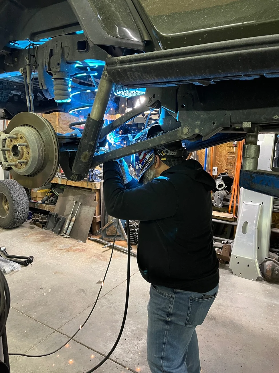

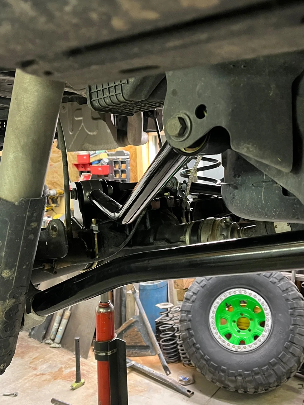

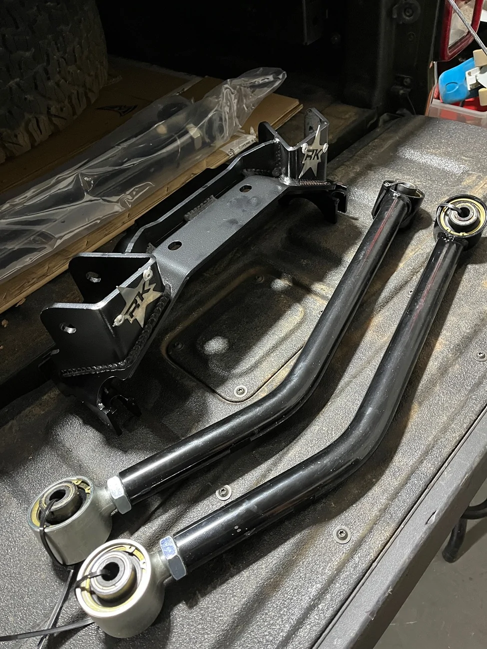

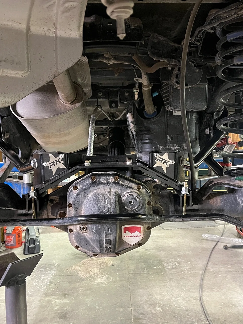

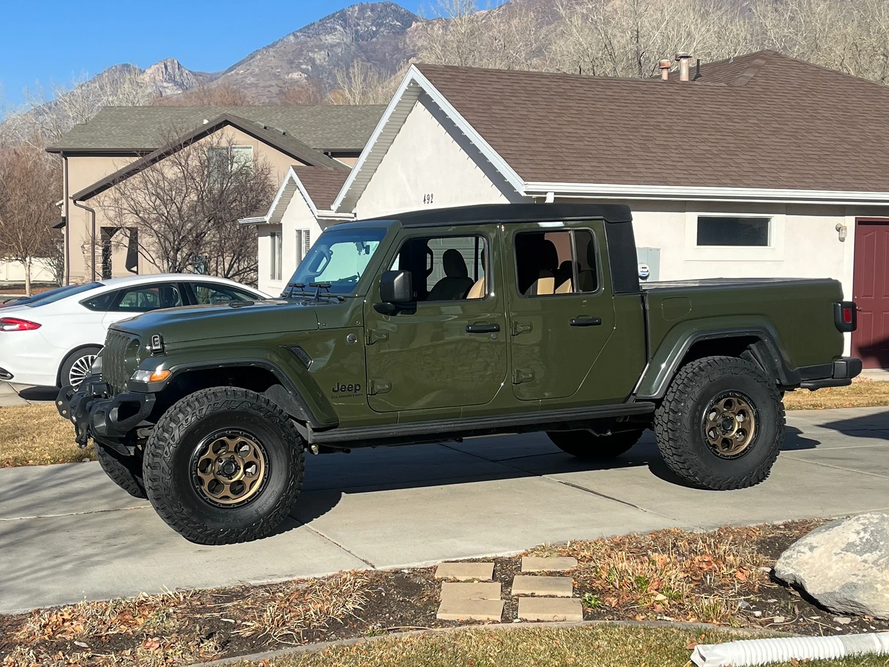

Link to abs extensions and the brake line extensions.@Rock Krawler Suspension rear arms installed over the weekend. I love the difference in how the jeep rides now. No more cross talk in the rear track bar, floats over some train tracks in my neighborhood that use to make the truck shimmy sideways. Another benefit is this kit also fixes the stupid pinion dropping while flexing problem.
Some things I learned that I didn't know from my research...
1-You will need new rear brake lines. This kit gave me way more flex than the Mopar lift and the brake lines were tight. I think they were the limiting factor when doing the install not my shocks. I ended up installed a DOT set from Currie.
2-Extend those abs lines while you're at it.
3-The rear sway bar extensions from the Mopar lift are also not long enough, they need another inch or two, there is a possibility that they could flip backwards while on the trail.
4-I'm going to need spring retainers, this flexes so much that I could possibly drop a rear spring at full flex. With the axle hanging from the shocks and brake lines the springs were slightly loose.
5-Most important, make sure you find an alignment shop that understands how this suspension works and making sure the axles are centered and square to the Jeep. I'm lucky enough to have a good 4wheel drive shop here in Utah that can do this and understands triangulated suspensions.

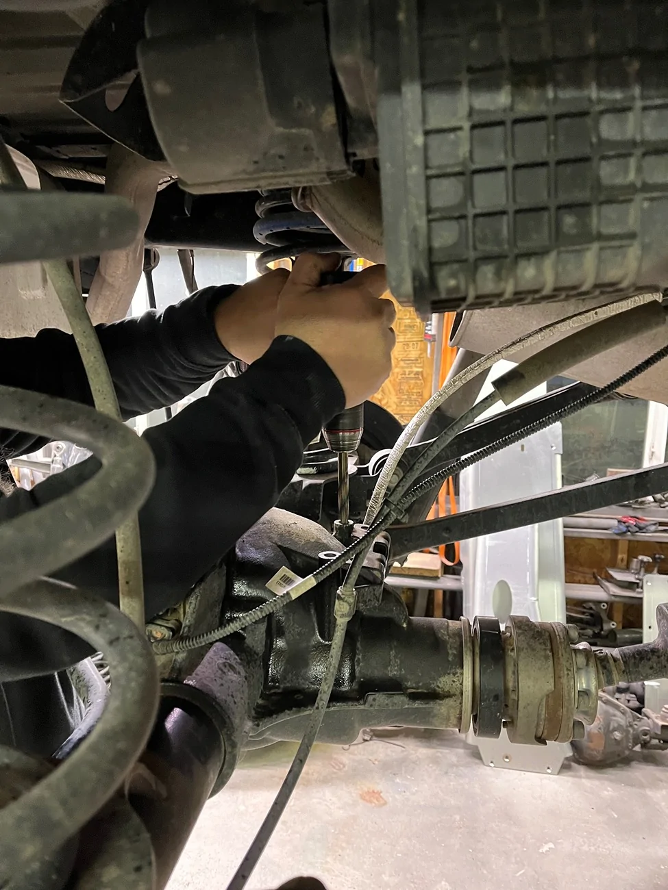

Scariest part for me was drilling the holes in the housing and tapping them. Everything worked great and RK provided everything to do it. Although make sure to use cutting oil, I didn't on the first whole and it made the drill bit dull, nothing I couldn't fix with a sharpening, but when I used cutting oil it made it a lot easier.
Looking forward to getting this on a trail and seeing how it does.

What I've got and why

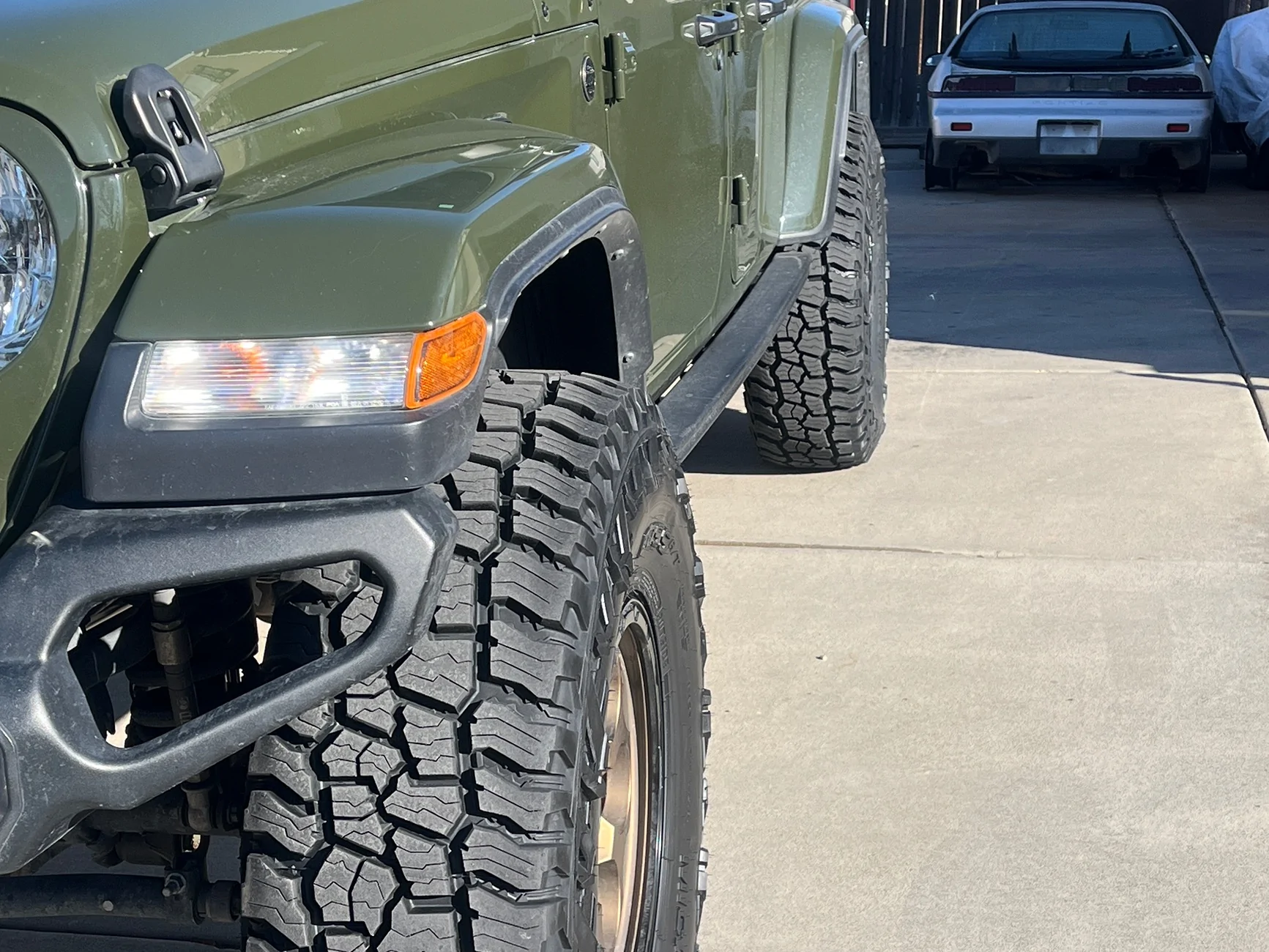

2022 JTMT I ordered and got almost everything I wanted. (Only thing I wish I would have done is order the half doors with it) My son calls it Master Chief (from Halo) and the name has just kinda stuck. I ordered the Max Tow model because I pull a recreational trailer around the mountains/deserts of Utah/Idaho/Colorado/Oregon and anywhere else in the spring/summer/fall and didn't want to deal with DEF in the diesel.

KMC Dirty Harry Bronze with +18mm offset. The wide track axles allow this offset and no rubbing.
BFG KO2 - 315/70 R17
