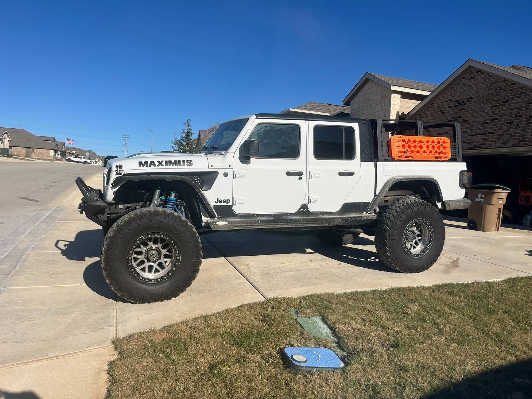

Just finished the build.
4.5"Rock Krawler X Pro
42" Nittos
20" KMC Grenades
Artec trusses
Adams front driveshaft
Rockslide engineering steps
Artec inner fenders
Rock Joc anti rock swaybar
Chopped fenders
Quake LEDs
Tazer mini
2.5 ton RPM steering
5.13 yukon gears
Fox Steering Stabilizer
Fox 2.5 bypass adjustable shocks
With that being said, I've got a ton of brand new parts of the jeep. Only 500 miles on this thing
Nice rig. Does it still have the factory power steering? Didn’t see it mentioned. How’ does it steer? Stiff??
I was wondering the same thing. I have a similar build except on UD60s and I had hydraulic steering and my ram was undersized and I had a heck of time trying to steer it and I just upgraded to a larger ram to be able to steer it better. With my setup not moving I wasn't able to turn my wheels I would have to be moving to get the wheels to turn and that was with a 1.5inch hydraulic ram. I just installed a 1.75inch and it fixed my issue. I am definitely curious on how this steers without hydraulic steering.
Standard power steering and no issues yet. I'm not taking this one offroad until I break the other one and at that time I'll put PSC on this one as well. Steers great
Just throwing this out there with tires this size it’s generally not a great idea to steer without moving on a roadway or high traction stuff like moab. Its putting a lot of unnecessary stress on the ram, its mount and the ball joints. The tires themselves are generally the weakest link but Ive avoided it like the plague after a demonstration from a PSC rep several years ago.
I generally don't but there are some situations when you are off-roading and you need to turn the wheels when you aren't moving and I wasn't able to do the that.
