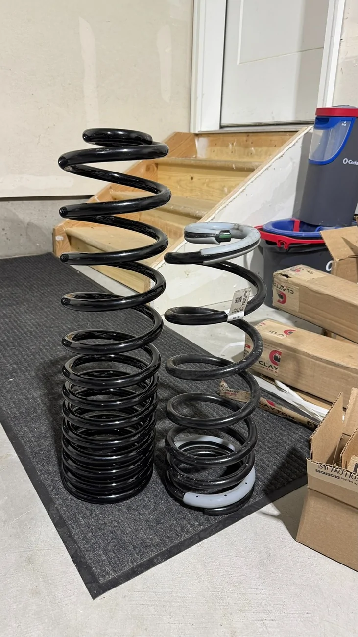

Hello everyone, I'd like to start a thread for my gladiator for infomations and review of things I buy or build. This will be used and abused in the mountains in colorado and not hanging out at a mall.
2025 Sport S
Completed

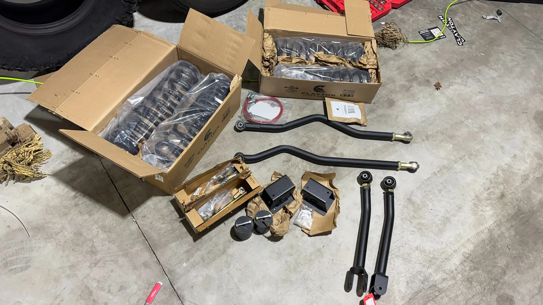

Clayton 3.5" overland plus lift
Alloy Ion Style 171 17x9 0 offset
kanati overland rtx 37x12.50r17
tonneau tri fold Cover
OEM Rock Rails
5.13 gears
Gear and tire size reprogramed and GPS verified.
In Progress

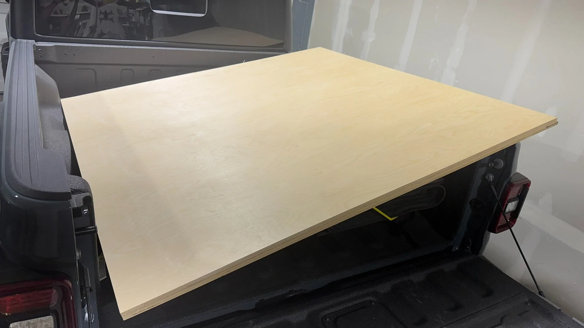

Russian 1/2" baltic birch plywood for the following projects
DIY 100% rear seat delete
Bed drawer system
Incomplete
bed rack for RTT
RTT
Power system, have 12v 100ah lifpo4 and 100 watt solor panel just need a 1500~2500 watt inverter.
Lockers front/rear, Eaton looks like.
Rock Jock Currectlync High Steer Knuckle Kit
Teraflex Rear Sway Bar Kit
Front sway bar disconnects, Maybe JKS? Do I need the anti rock system.
Front stuby bumper
Rear bumper
LED headlight upgrade and offroad lighting.

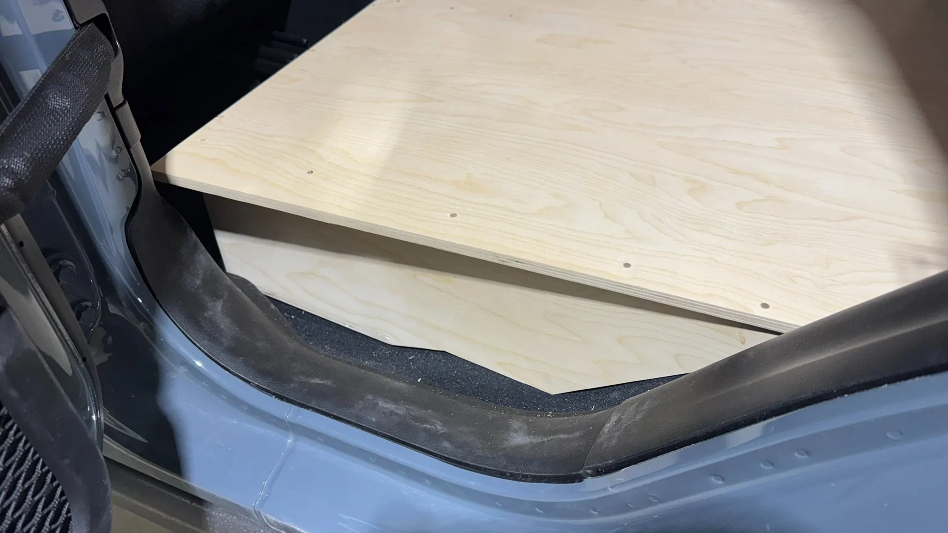

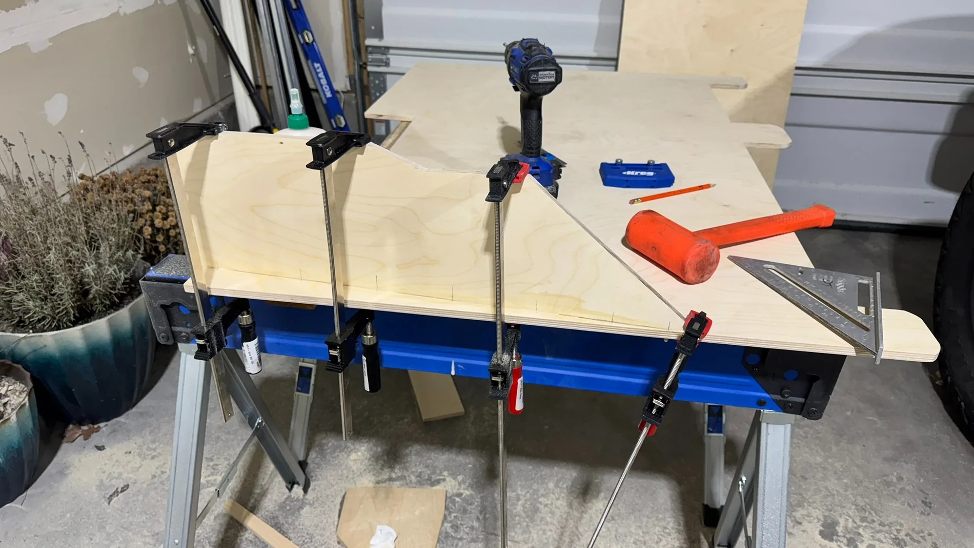

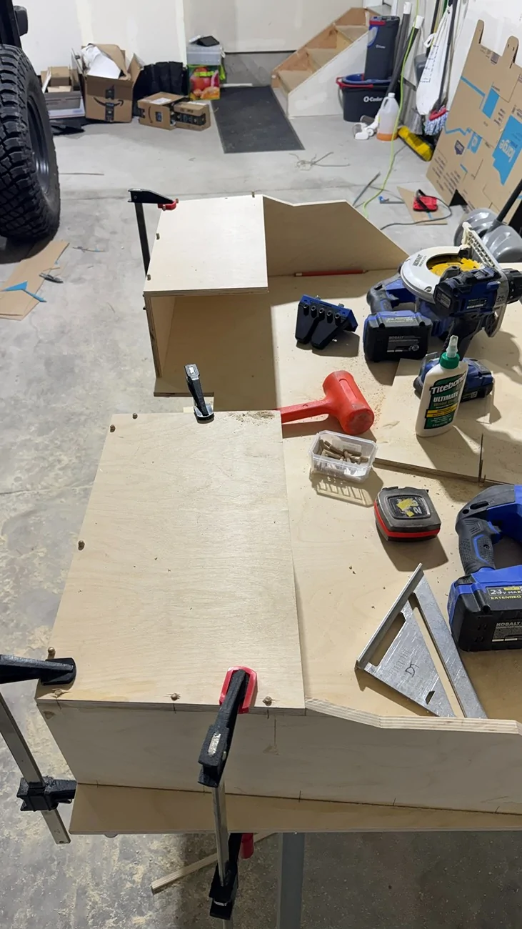

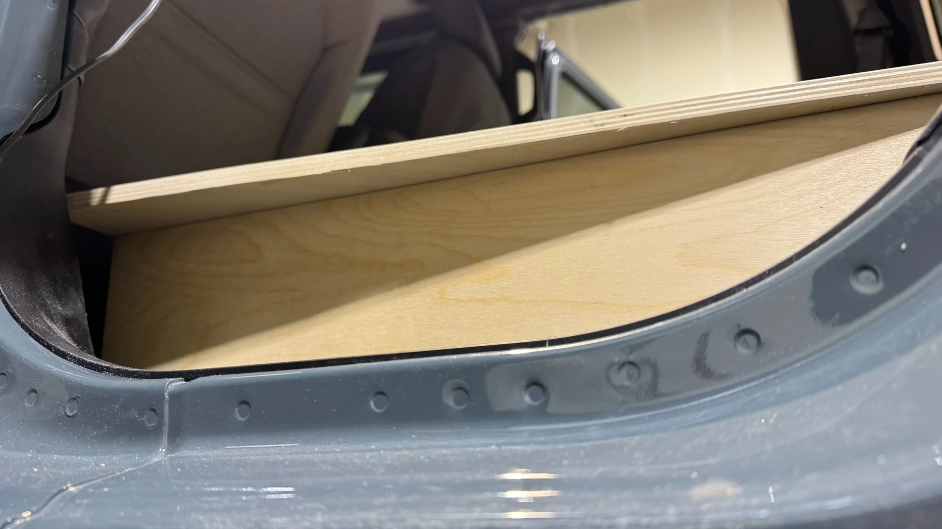

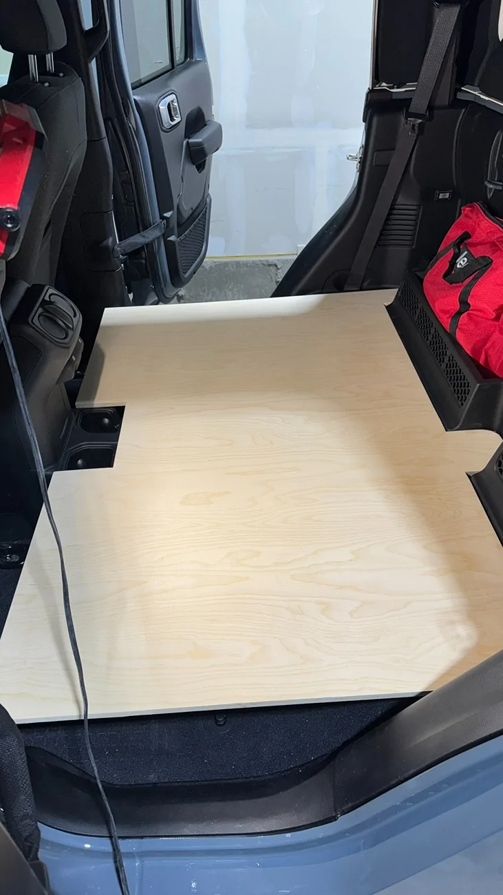

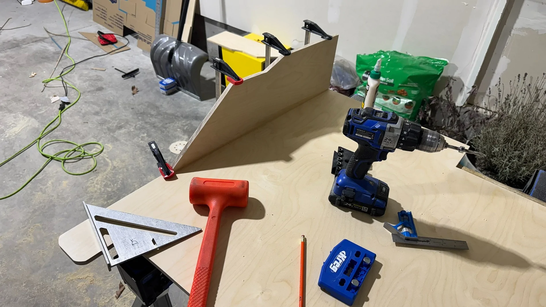

Working on the platform today and got a big portion done. Just need the front 2 pieces and the bottom front pad that lays on the carpet. Using kreg dowl tool and wood glue. Thinking of a Raptor liner or some of that marine-grade carpet for a covering. Once done I'll weigh it and see, thinking about 75lbs.

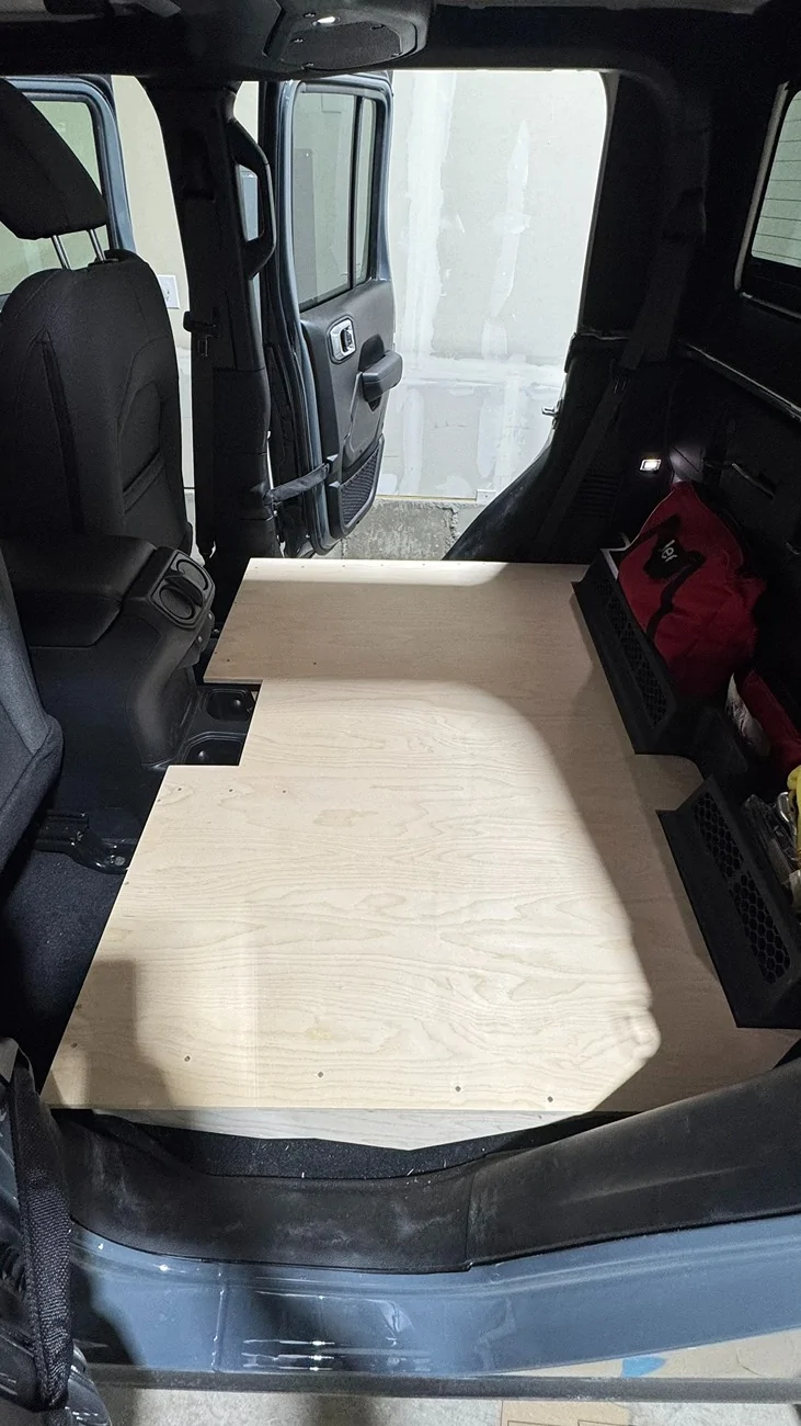

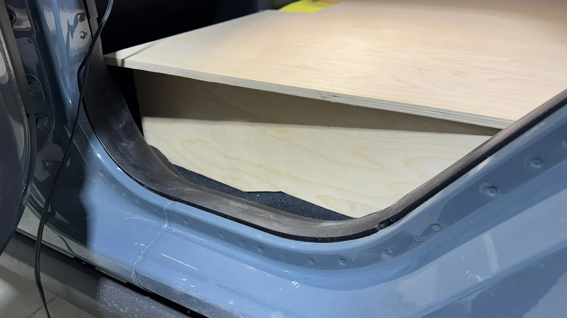

More done today, just need to install a center brace and cut the doors and drill for the bolts. It doesn't need a center brace but never know how much weight will sit on it. It's pretty light I's say around 50lbs.
