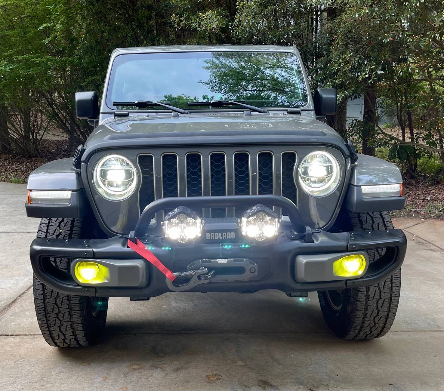

The Warn 12k fit nice without trimming or shimming with the Rubicon steel bumper and the Warn baseplate. I was just wondering how the Apex would fit. I ha e it on my Silverado and it is awesome. Even the wireless feature works well.
Warn winch plate and Apex 12k.

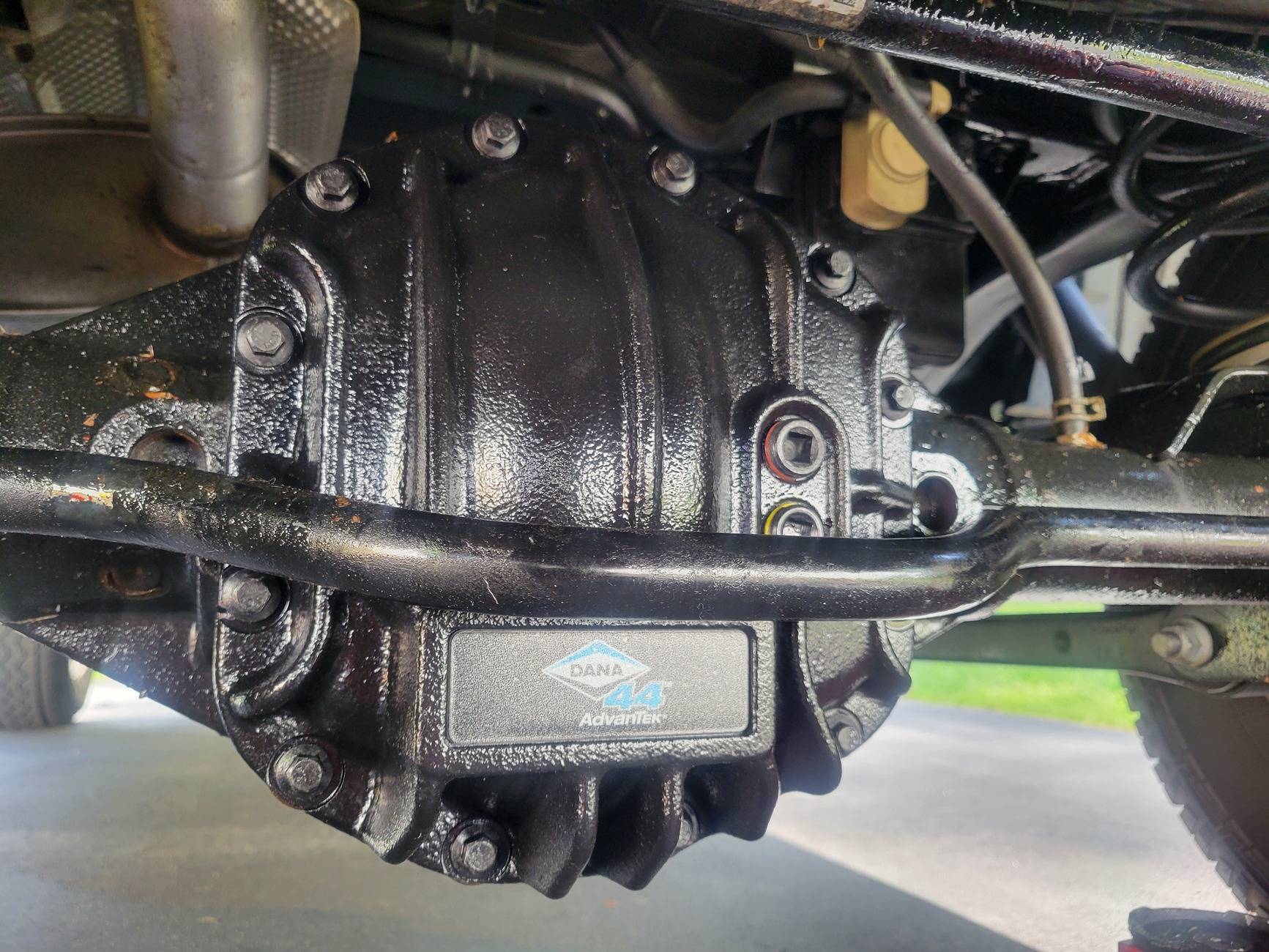

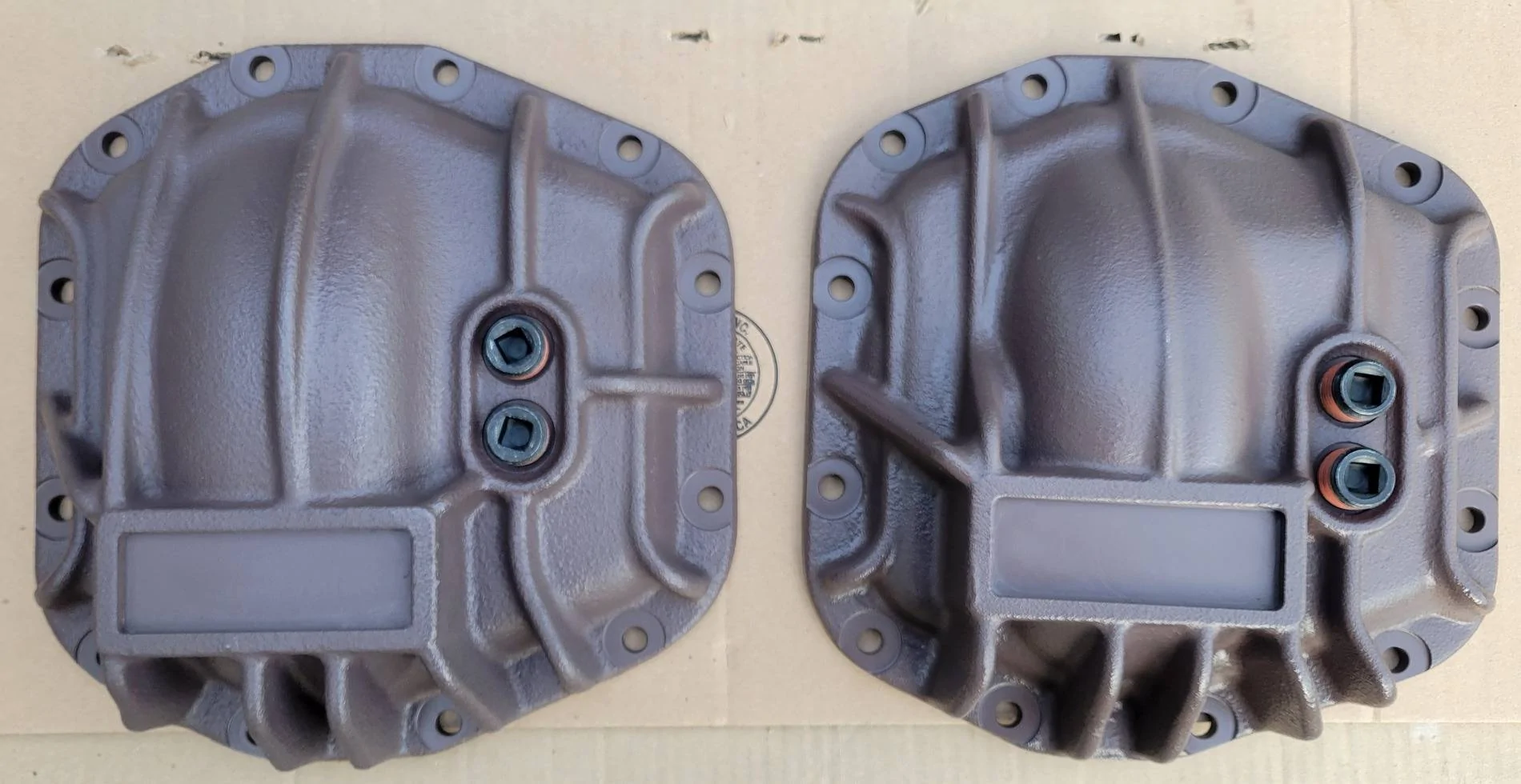

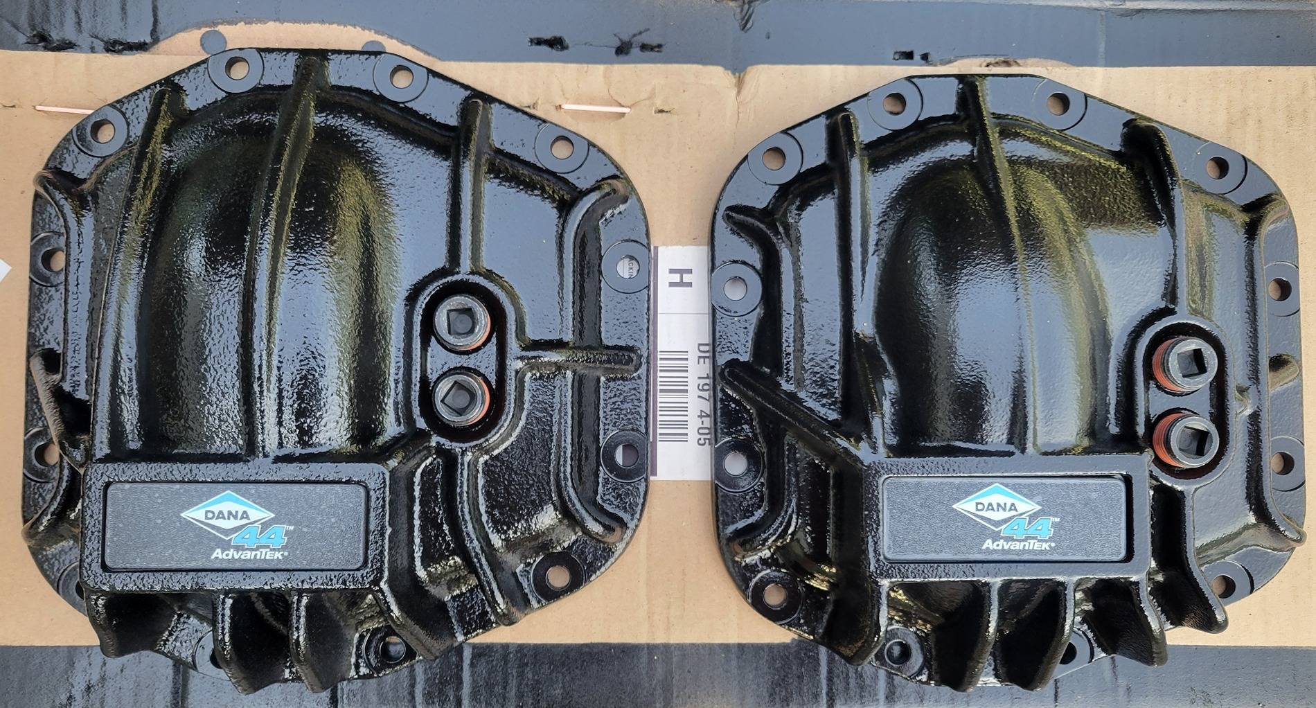

Arts and Crafts day at the house. Got in some primer DANA covers and threw of a few coats of gloss black high temp engine paint. Saved about $150 for the set buying them primer coated vs. finished on Amazon.

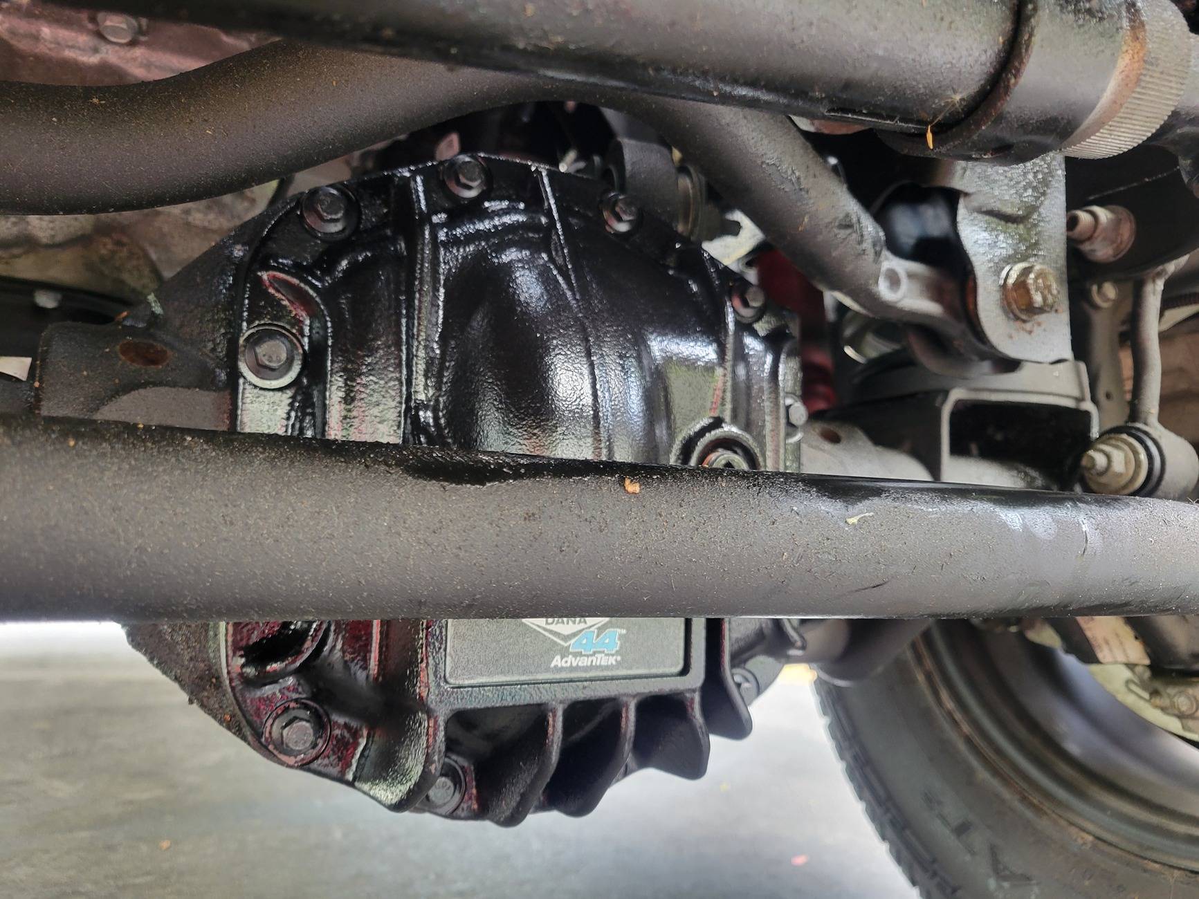

Installed the DANA covers today. Front got TOTAL 75W-90 and rear Amsoil 75W-140 gear oil.

Those look sweet!
Thanks. Surprised they came out so well. I am usually not so good with painting things and it looking presentable.

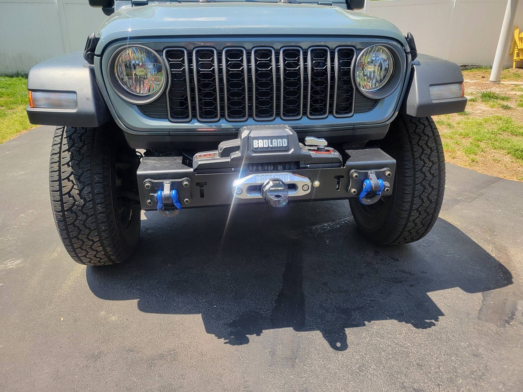

Installed the EVO 1/4 Pounder bumper. Had to install an extra 1/4" spacer set to push the bumper out so the APEX BADLAND winch would fit. Seem it is a slightly bigger winch dimension wise than other common brands.

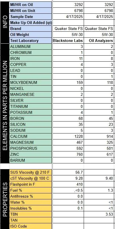

Did my first oil analysis on my 2025 Gladiator Sport 3.6L Pentastar. Samples were taken with 6768 miles on the engine with 3292 miles on this oil change interval. Oil used was Quaker State Full Synthetic 5W-30 using a FRAM PH10575 oil filter on a Baxter Performance oil adapter.
Replaced with Quaker State Euro 5W-40 and a Premium Guard PG2500 oil filter.
Decided to try "Oil Analyzers" for the first time but also sent a second sample taken at the same time to Blackstone Laboratories to make the comparison between the two. Below is spreadsheet comparison between the two labs for the results.
Basic take away from either lab results is that it is wearing in normally. Wear metals between the two labs are nominal with some slightly higher number spreads on the additives but they seem to be in expected ranger for the grade and API spec of the oil used.
Main difference and I have heard this before, Blackstone Laboratories does a guestimate on fuel dilution based on flashpoint and Oil Analyzers does a true fuel dilution test and those numbers came in higher than what Blackstone Laboratories estimates
Going forward, I am probably going to use Oil Analyzers for my oil analysis needs at least for this Gladiator.

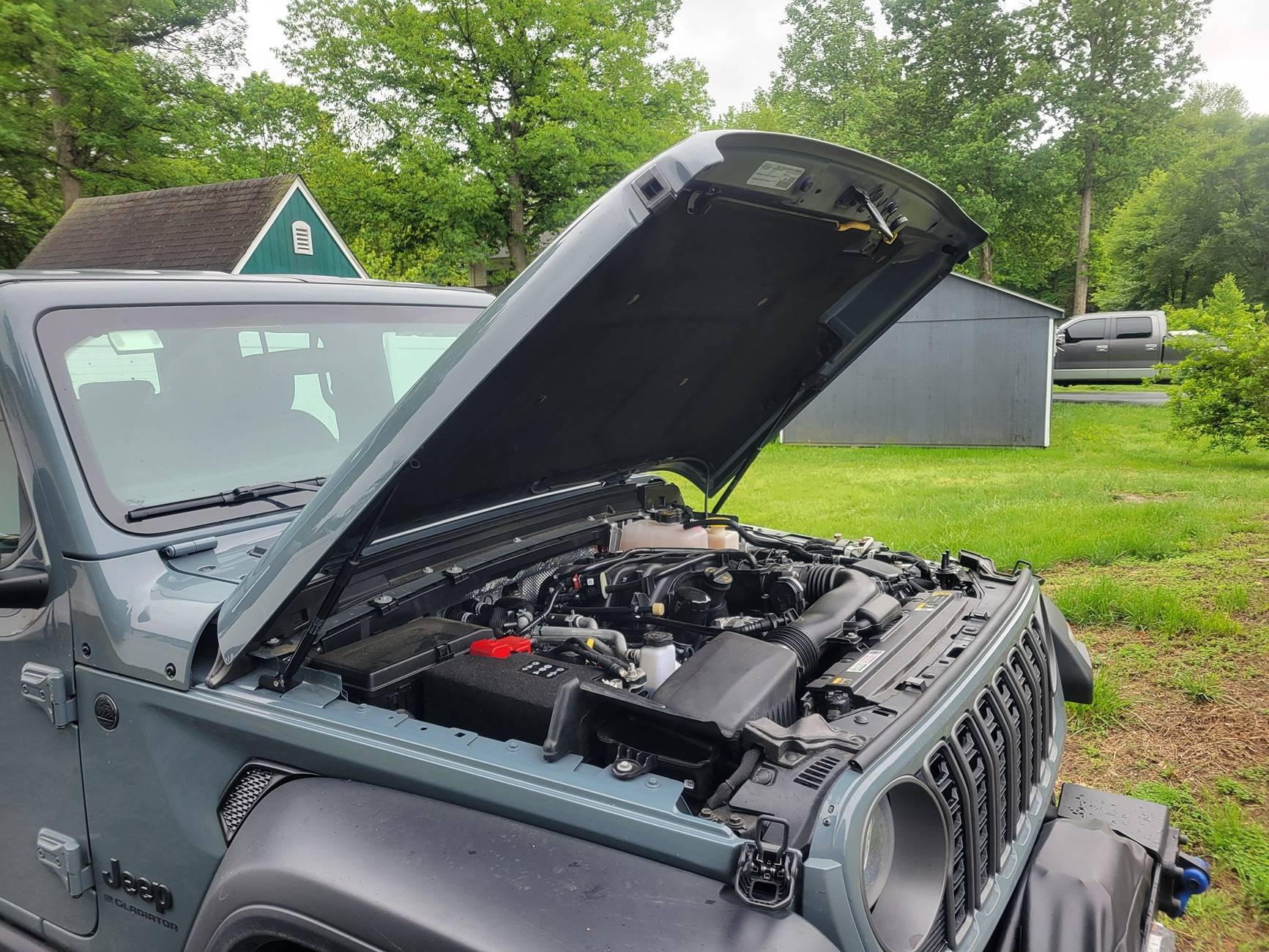

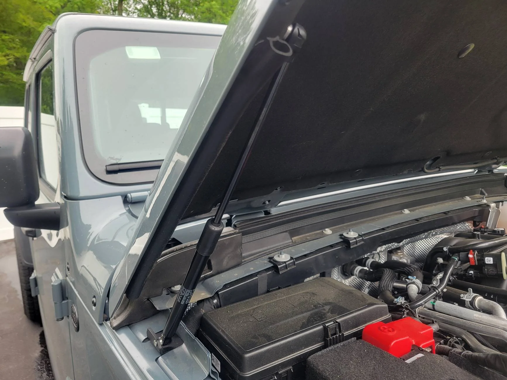

Installed the Rival hood strut kit today. One of those mods I underappreciated until I installed one for myself.

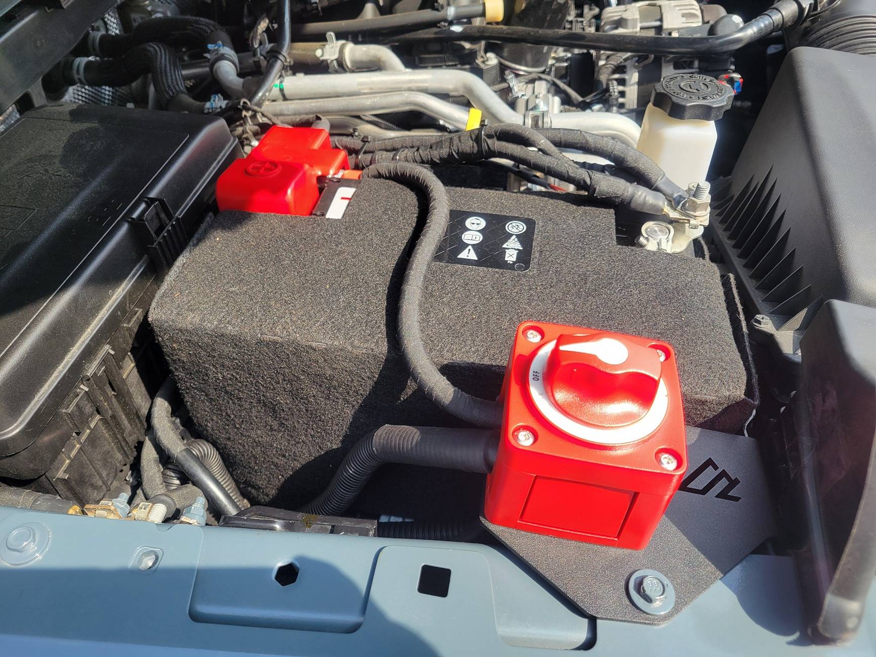

Finished out my winch install with the American Adventure Labs switch mount I received recently. Just a FYI with anybody that tries to use the battery cable cut off switch included with the APEX BADLANDS winch, it will not fit without egging a couple of holes on the switch mount. The Blue Sea Systems 6006 series switches will fit without issue.
