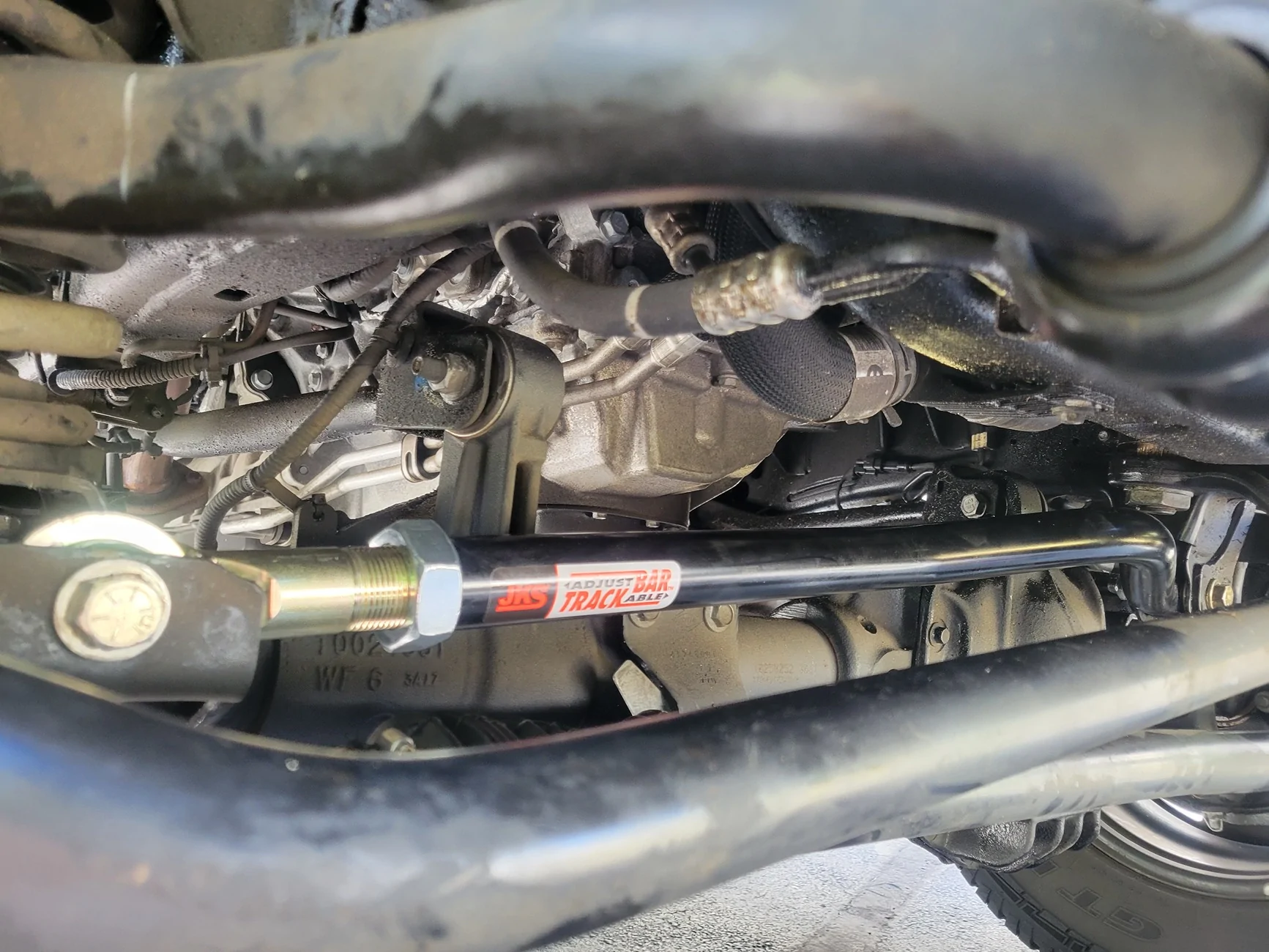

Got off work a little early today and installed the JKS Manufacturing front track bar this afternoon. Used 9/16" Grade 8 hardware. I will say there was a lot of preload on the Rusty's Off Road track bar reinforcement bracket as it was installed loose with the OEM track bar and everything tighten down. Had to loosen things up again to get the new JKS track bar installed.

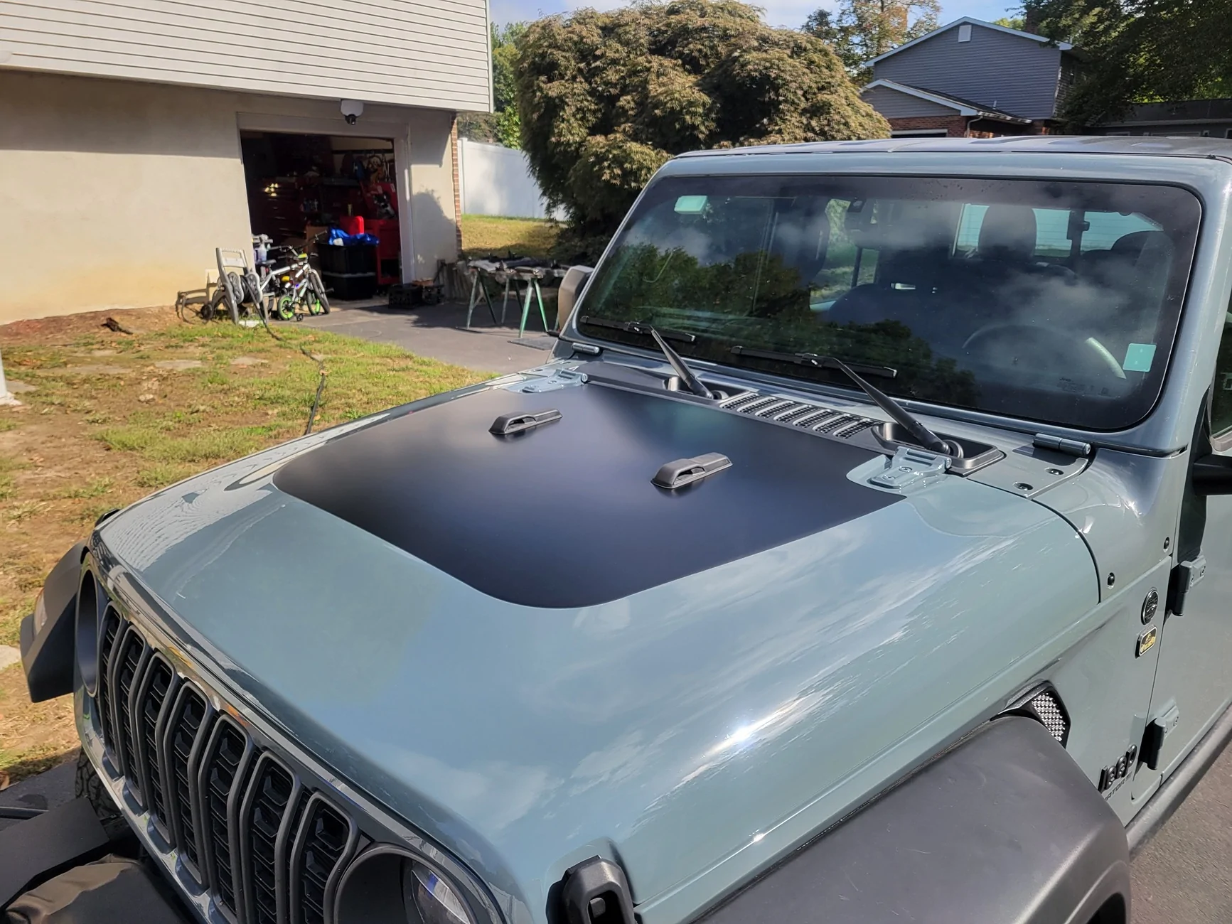

Installed the SEC10 hood decal I got from Extreme Terrain. Went pretty easy but did have to remove the hood tie down and washer nozzles as it was not cut for them.
Jeep Gladiator 2025 Base Sport Anvil 20251002_112208
I'd rather remove them than try to work around them.
I've considered this on mine, but I'm convinced I'd manage to get it off center or angled just enough to drive me insane.

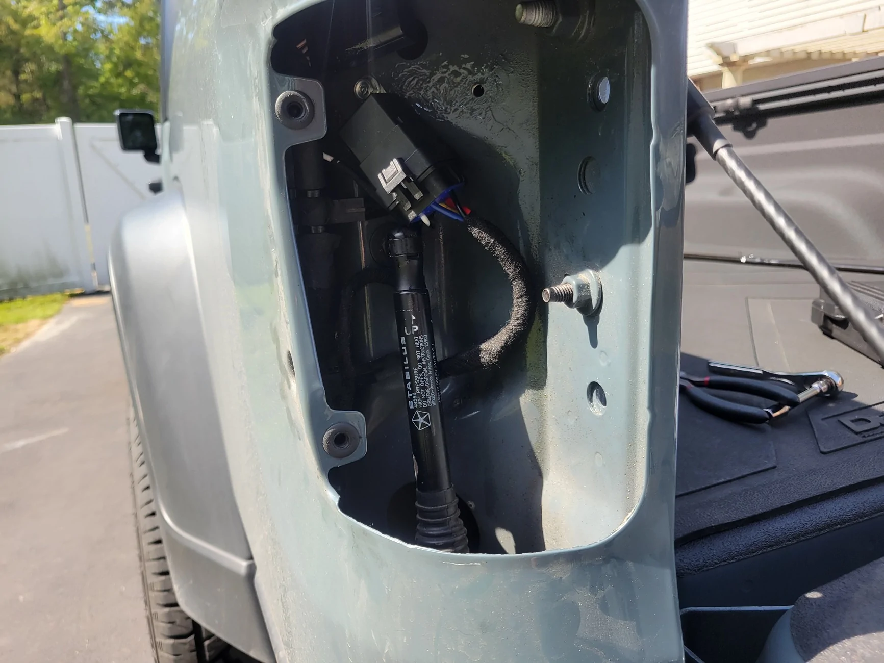

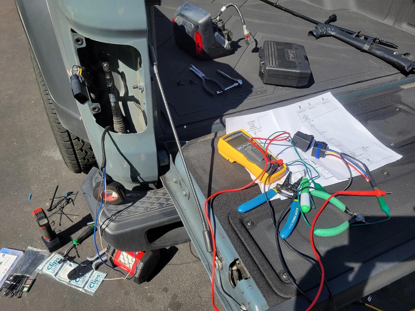

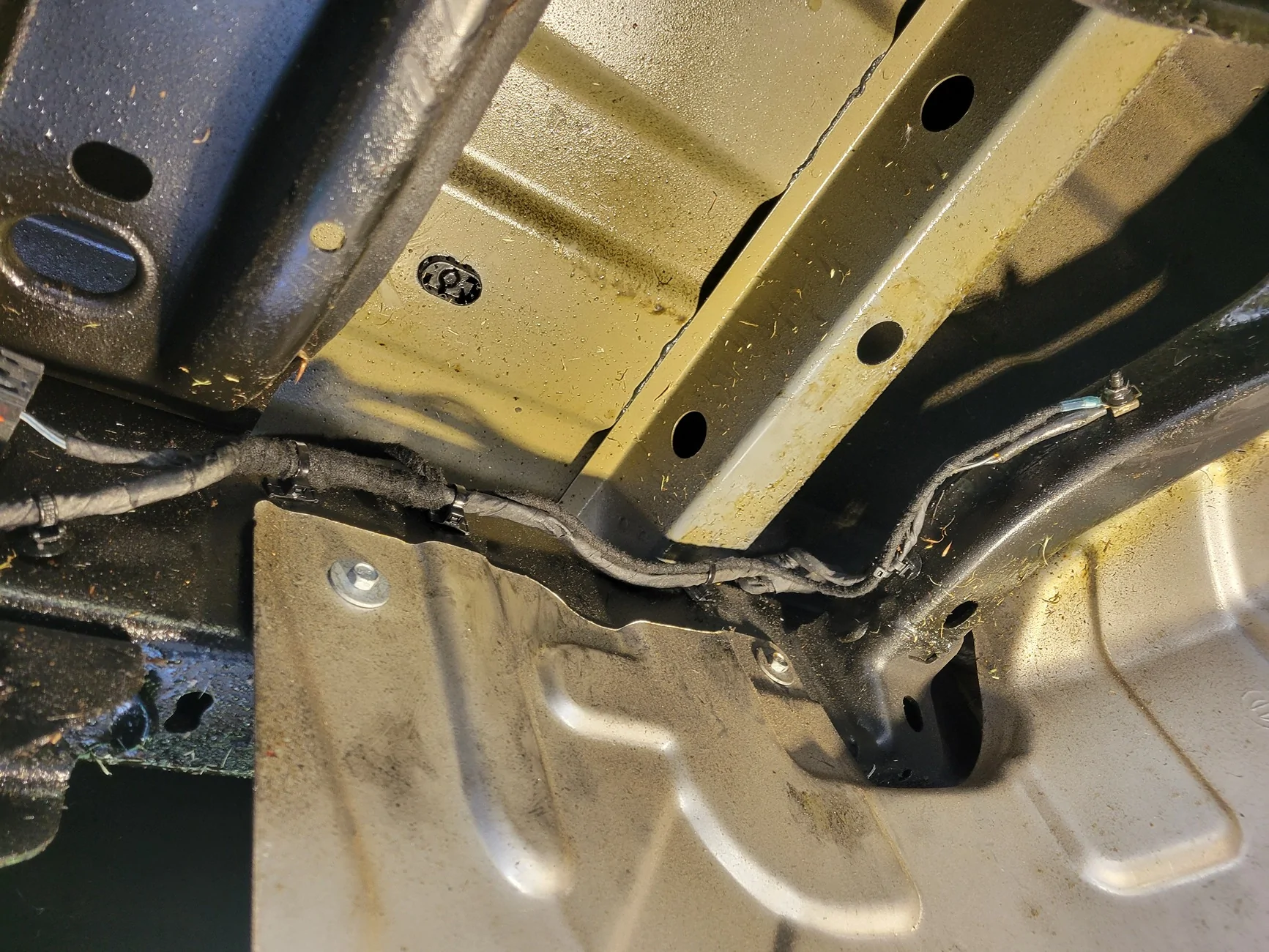

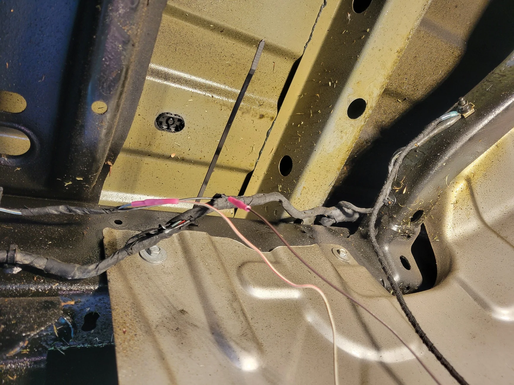

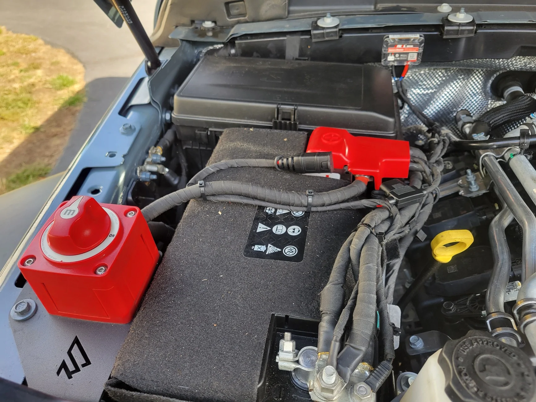

Today was electrical day.
Wired in a ANCEL BM200 battery monitor. Also put in a NOCO battery tender lead set.
Hardwired in a license plate light reverse blanking relay.
Jeep Gladiator 2025 Base Sport Anvil 20251002_125344
Was the reverse light relay a kit. Or a diy you came up with. Easy enough with the right parts and diagram no doubt but kit makes it even easier. Been thinking of getting tinted lens covers for mine. Wife new GC has same issue with license plate lights being way too bright.
Hootbro
Hootbro
Apr 13, 2019
10,199
19,978
2025 Gladiator Sport
This one was a DIY. Had a plug in kit on my last JT but this was easy enough. Just have to interrupt the license plate power wire with the relay and tap into the reverse light for the relay trigger and run a ground.

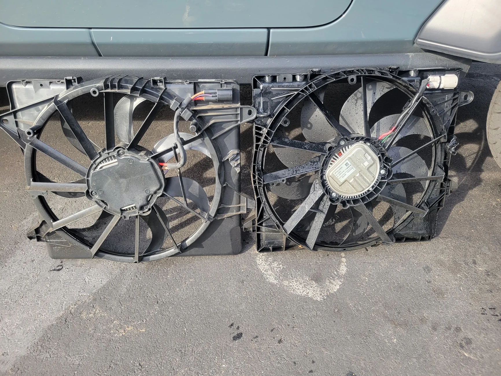

Posting for posterity sake. Swapped out last Sunday my standard duty 600W cooling fans for the heavy duty 850W cooling fan.
