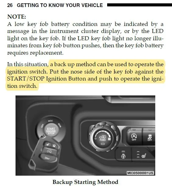

Does it start with the backup method of pushing the nose of the FOB on the start button? If so, I would be looking at a possible battery issue but could still be a FOB issue.
Does not start, then definitely a FOB issue with possibly a bad transponder chip.
Jeep Gladiator Key Fob Issues FOB
Deleted member 30519
I have a sport with manual doors and locks so I don't have any light indicators on the key fob itself. I'll def try that trick next time though. Thanks
