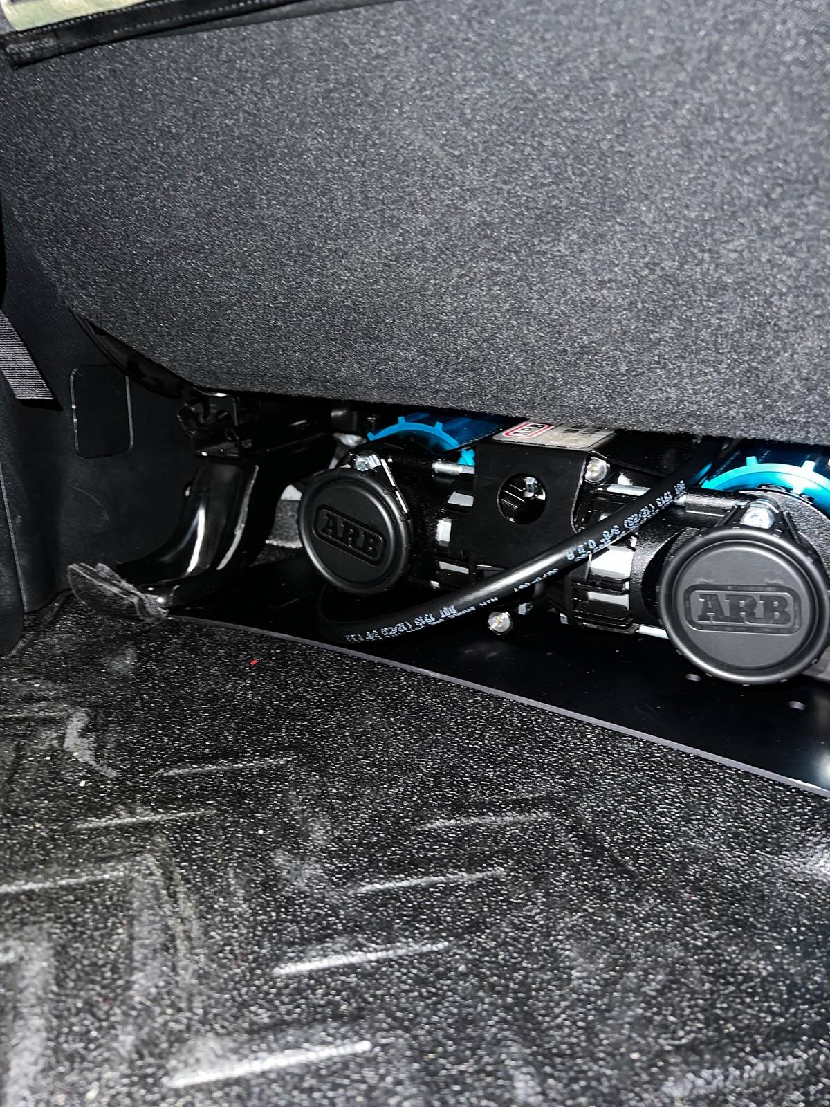

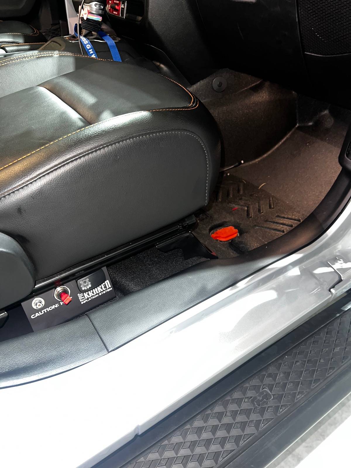

Finished the kraken install with the Armorlite flooring. I would recommend longer seat bolts for the rear bolts as the Armorlite is thicker and the baseplate for the kraken adds thickness too. The electrical pin part of the kraken install was the worst part as the flooring is not very pliable and it was hard to hear the click of the pins reseating into the plastic housing. I did have to cut a slit into the front Armorlite section to allow access for the wiring harness to reach. No other issues with the set up just expect slightly more difficult install as the flooring is thicker.
Jeep Gladiator Kraken with Armorlite install IMG_3122
Jeep Gladiator Kraken with Armorlite install IMG_3123
