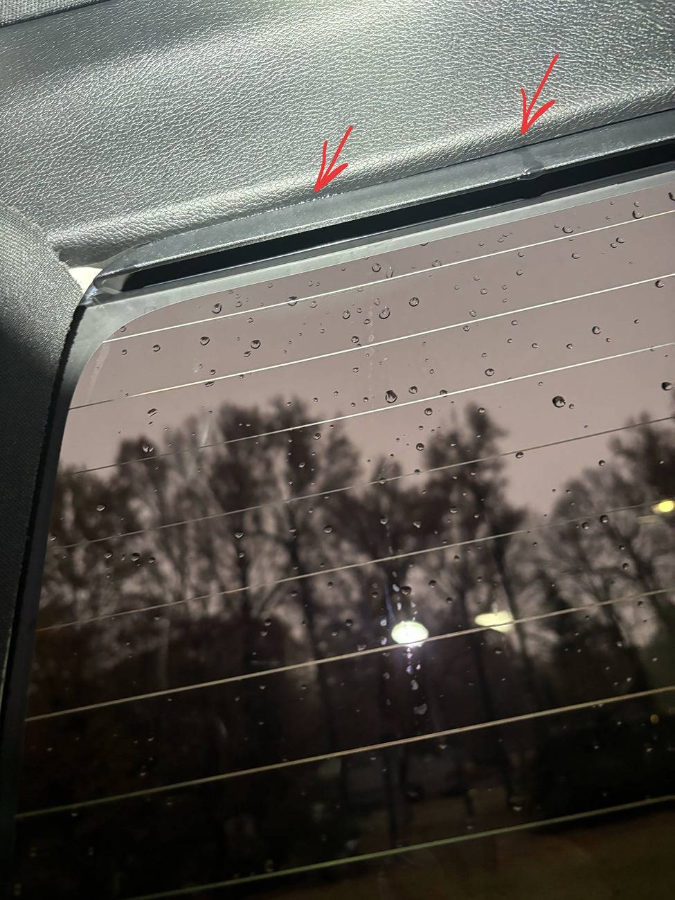

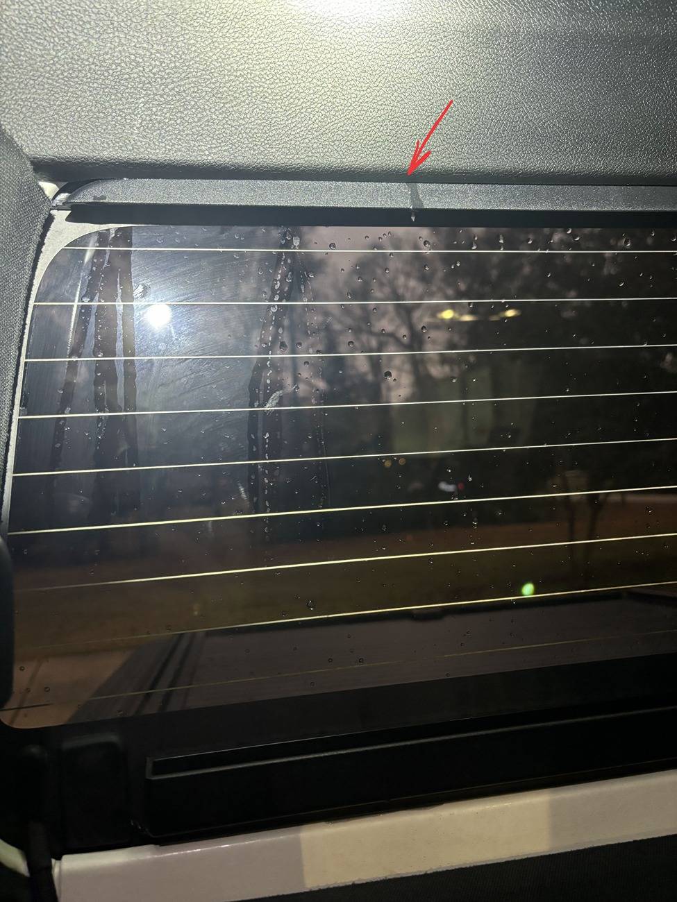

Any body had a leak at the rear window in a similar location as shown in the pics? Top of window behind passenger side head rest. If so, what was the fix?
Jeep Gladiator Leak at Rear Window IMG_3763
Jeep Gladiator Leak at Rear Window IMG_3764

It happens. If in warranty, the dealer or a contracted 3rd party will replace the window. If not in warranty, people had success installing rubber tubing in the gap. It looks good too. 7mm I think is the od size. Better search here for more info.
