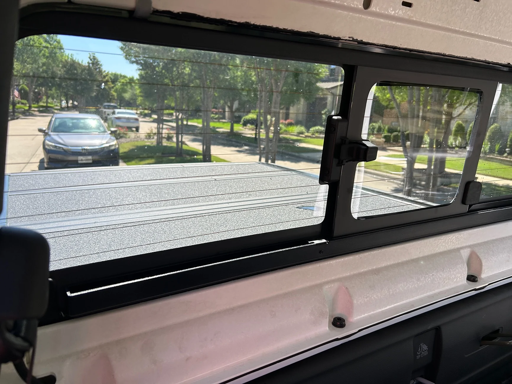

For those that have had rear window leaks, after repair do you still get water in the sliding glass lower tray?
Longer story. 2021 sport. Had rear window replaced twice while under warranty. Worked for a while but leaked again. Silicone tubing wouldn’t work for me because the top gap is huge. So, I used Sikaflex 221 caulk / adhesive along the top edge. Completely filled the gap. Top is not leaking now but still getting water in the plastic tray. I assume thru the sliding glass seal.

They mostly leak along the top edge. Search this forum for rear window leak. If you’re lucky the silicon tube will fix yours.

Forget about Jeep warranty! Search here and do the silicone rubber hose fix. Mine has lasted 3 years so far with no issues. Took about 15 min.

i did the 7mm tubing repair and it stopped my leak. pretty sure its been 3 months and no leaking. took me about 30 minutes to do. we have had alot of rain the past three weeks, no leaks.

i had read that 7mm vacuum tubing can be shoved into the crevice of the window and hard top. I had some in my generic supply, i did not buy anything. It was just 7mm vacuum tubing that i cut to length.
