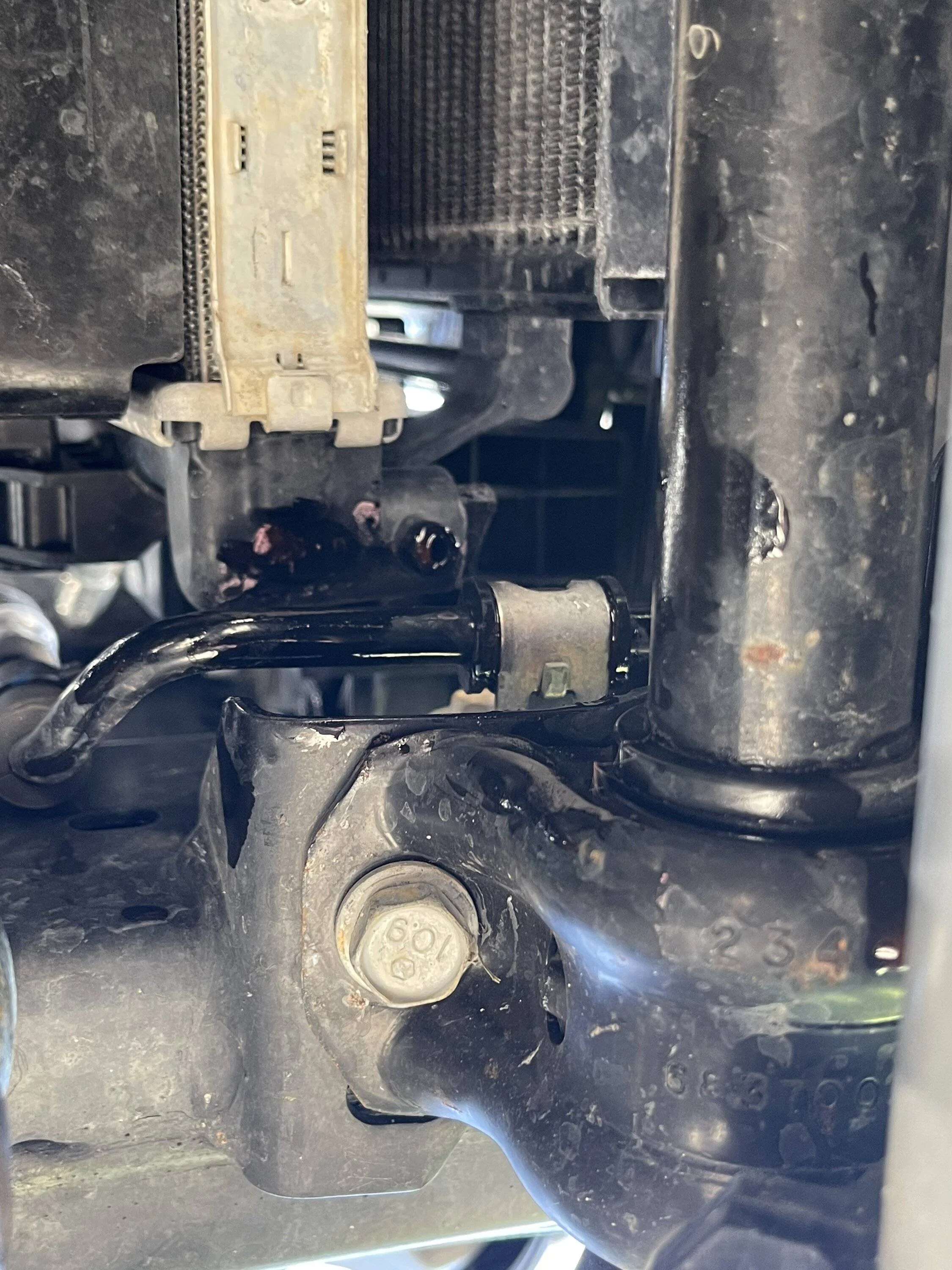

Red white blue
Redwhhpedf
Jan 6, 2022
MI
UPDATE MY GLADIATOR RADIATOR STEAM WAS FROM TOP RIGHT CORNER ORIGINALLY AND TRIED THE IDLE WHICH WORKED BUT FOUND SMALL AMOUNT R- FLUID ON GROUND AND LOOKING UNDERNEATH BOTTOM LEFT CORNER STOCK RADIATOR HAS DRAIN SPOUT AND WAS "LOOSE ENOUGH "TO ALLOW DRIP FROM OPENING FOR DRAIN LINE ATTACHMENT
