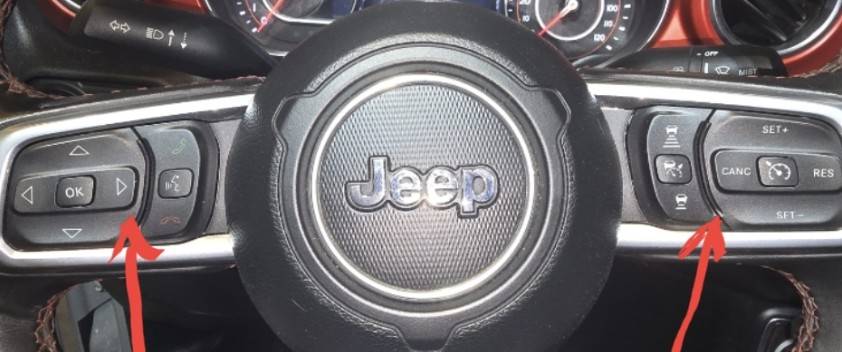

Do you have a Tazer on it? If so, pressing these two buttons simultaneously will turn the radiator fan on high, which always brings coolant temp down to 185 within a minute. Perhaps it's unnecessary, but I do this often, especially before leaving it parked with the engine so hot.
