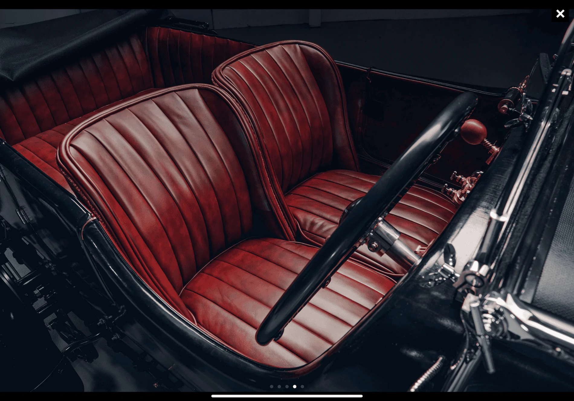

That would look sweet! I’d love a deep oxblood red; something like this:

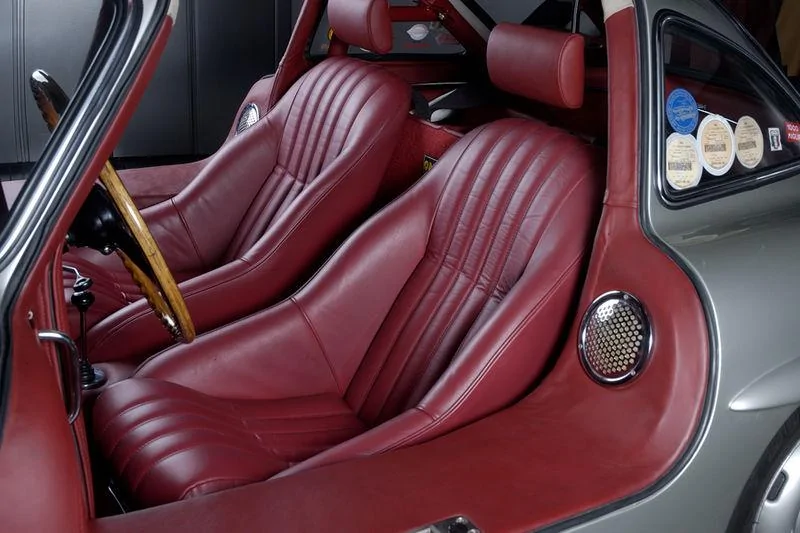

or this:

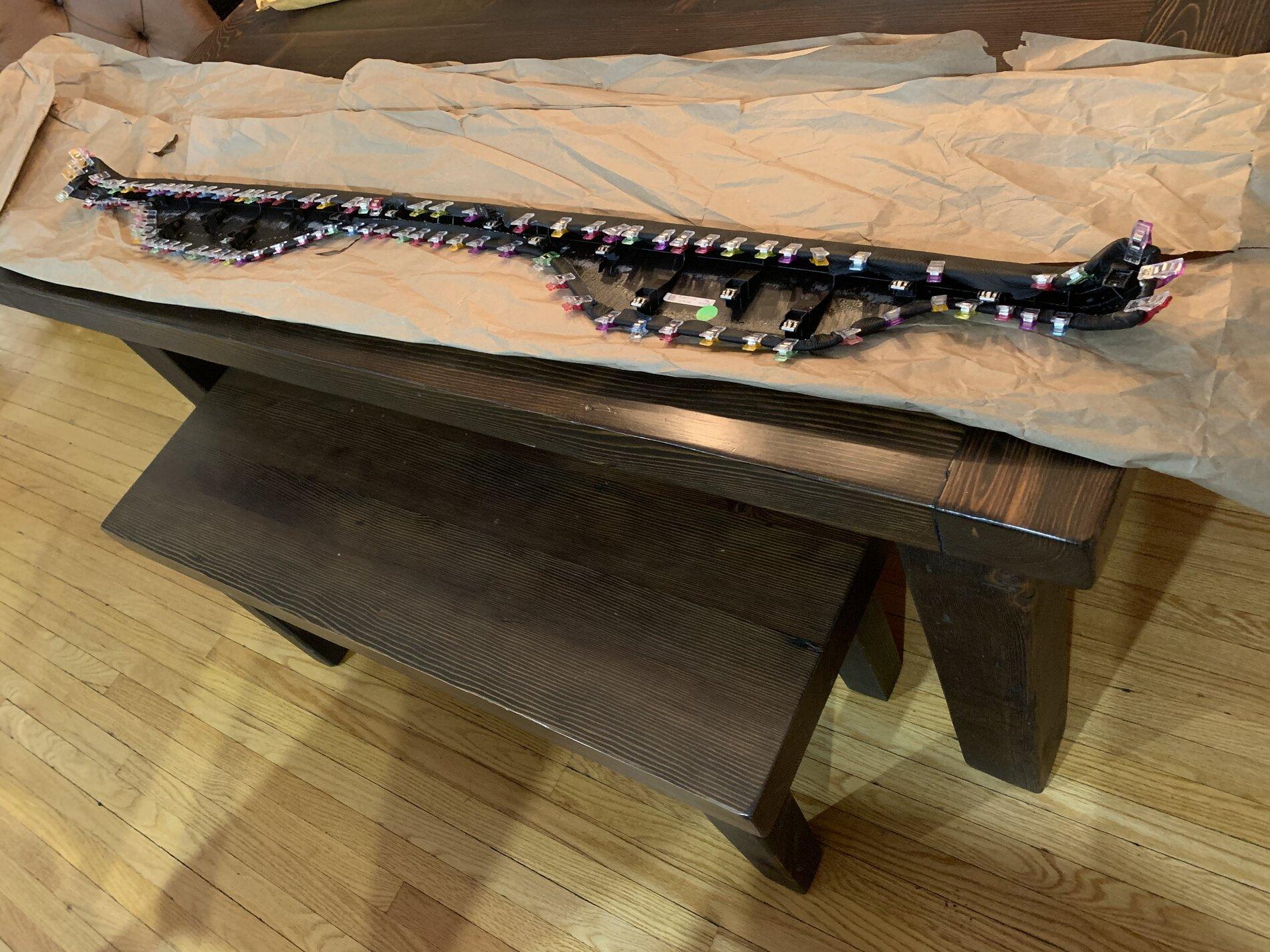

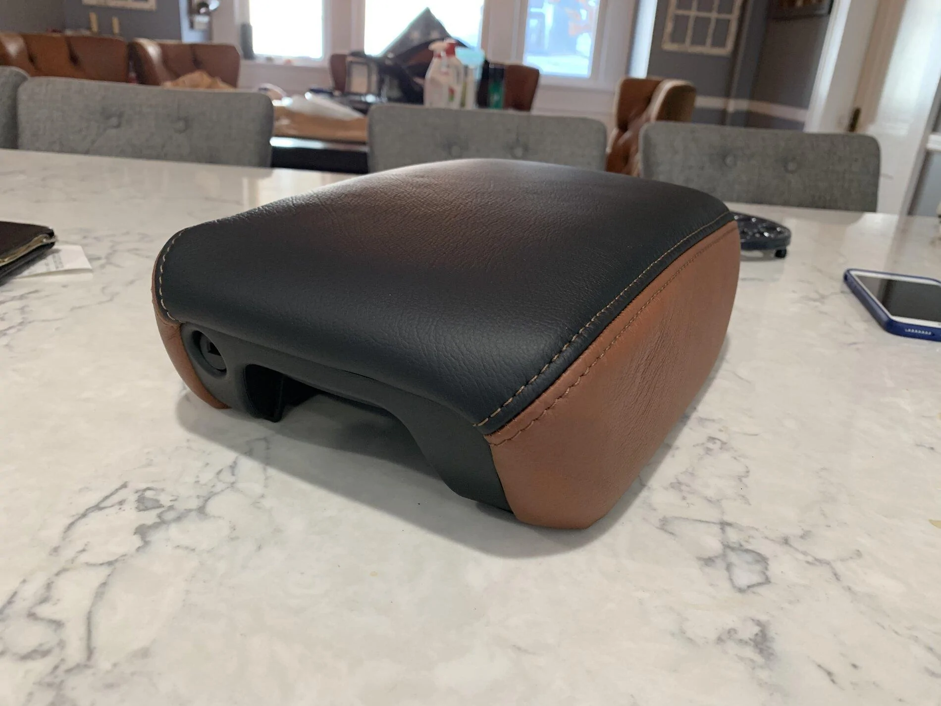

No, that's the factory plastic dash panel that I covered in leatherseats.com stitched leather. Black colored with chocolate stitch thread. Looks ballin'! That was when it was still a work in progress.

How do you cover it? Just 3m adhesive spray, wrap panel with large piece of leather and trim?

There is enough extra material to wrap over the edges by about a half inch. 3m spray and reinstall the piece. I did also trim a little plastic off the 2 ends where the seam wraps over so that the extra material around the seam would be flush as it wrapped over. To be honest I might re-do the dash because I did not notice a wrinkle that will end up annoying me at some point. But I learned a little about what to keep an eye out for...

I used about 100 fabric clips to hold the wrap over in place while the adhesive set. My wife’s idea. Very good idea.
ohh so the pieces you bought were purpose meant to wrap the dash panel? not just a roll of leather with a seam and stitching on it?

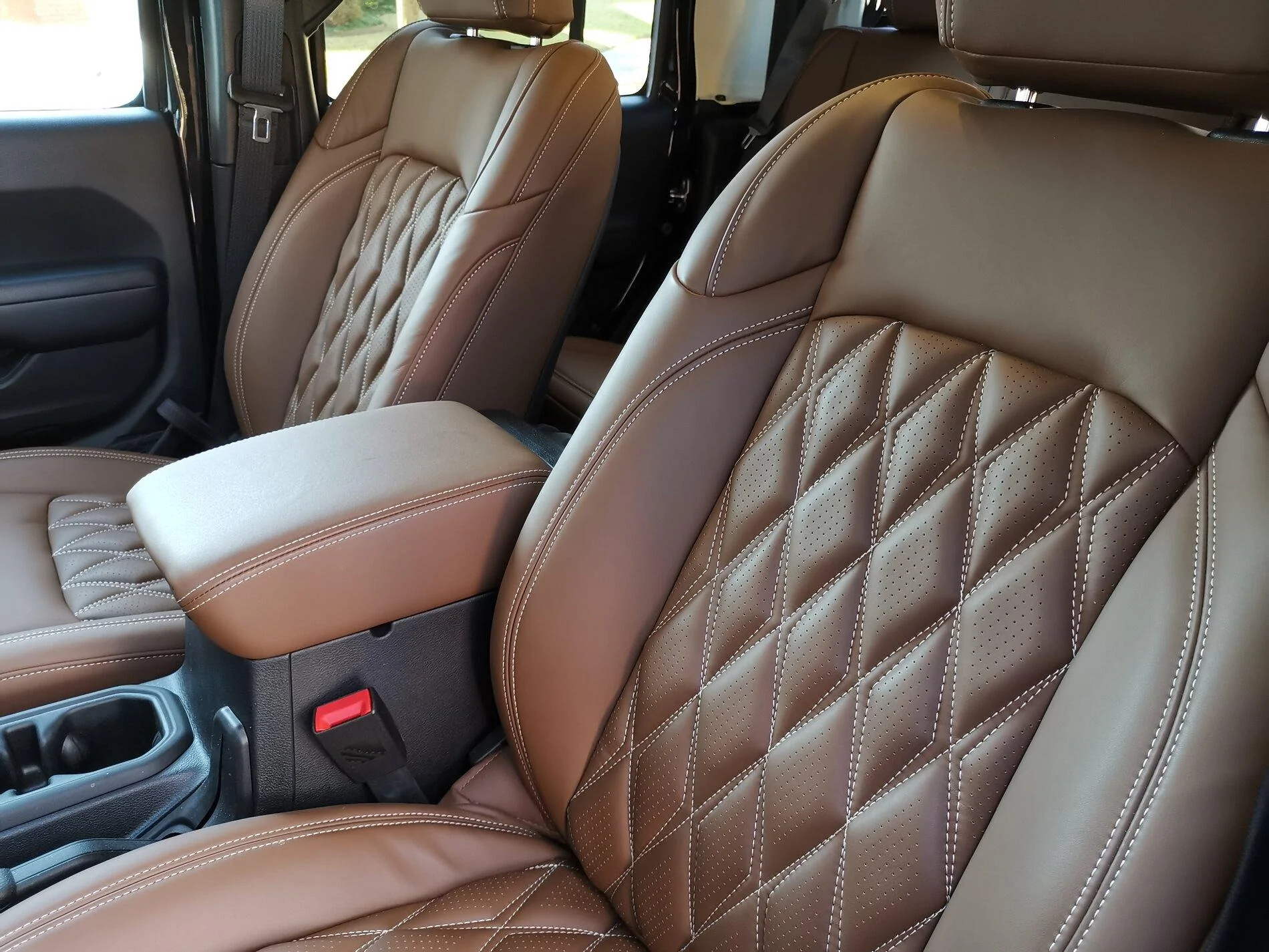

This is my customized interior
that looks awesome, like the diamond inserts. did you use leatherseats.com or katzkin or was it "cutom custom"?
Yachtnutz
Dec 28, 2019
64
78
Dallas Tx
2020 Jeep Gladiator Rubi 2016 Range Rover supercharged LWB, F350 KR S/D, 30th Anniversary Camaro SS convertible
Thanks no they are fully customized I pick the color and pattern when I had it custom built !
