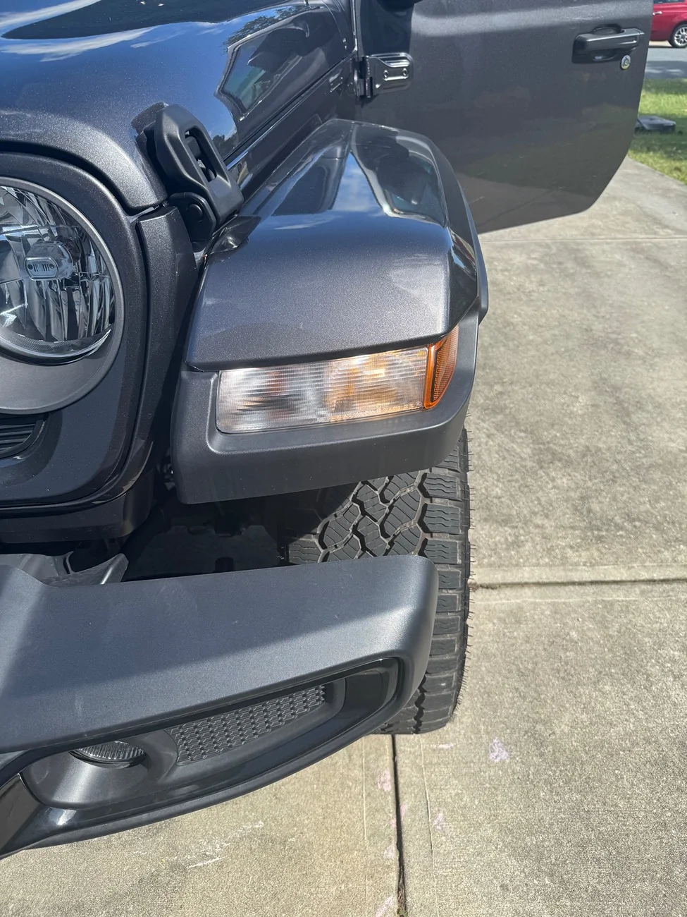

I'm new to gladiator, coming over from
a Silverado. I used lasfit for led's for the Silverado and when looking at Lasfit for the gladiator it doesn't appear to have a led bulb for the DRL in the fender, only the DRL incorporated into the headlight. Does anyone have any options they've used for this?

More than a couple of companies sell units to replace the whole thing rather than just the bulb.
Maybe an expert on here will pipe in with whether or not you need a Tazer to avoid errors with these the same way you do with switching to LED head/tail lights.

The DRL is the white marker light in the assembly, it isn't part of the headlight.

I have a set of Amazon LED assemblies in place of the stock halogen. They come with resistors and don’t throw codes. I noticed a very, very slight flicker at idle though, so used JScan to swap to LED.
There are bulbs available to just swap bulbs, but you still need a resistor or scan

You kind of answered something I wondered: does it cause problems to have the resistors AND change the setting?
I can’t really help there. I removed the resistors and changed Jscan at the same time…..
Parts store has them...I swapped the DRL bulbs with Sylvania led replacements, plug and play and no tazer/jscan needed

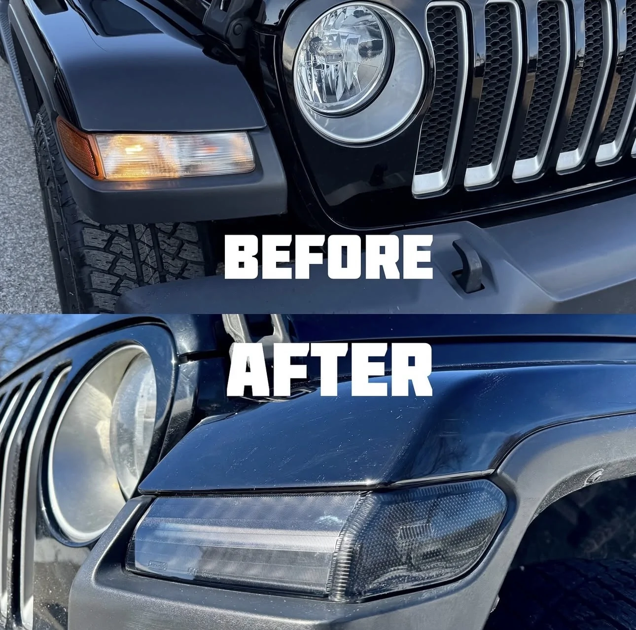

I swapped my sons JL Saharas headlights and fender DRLs to LED since unlike mine, the LeD lighting group was one of the only things his didn't come with.
for the fender DRL we went with the Morimoto XBs. They're legit. Did a little overview video of them on my YT channel as well.
