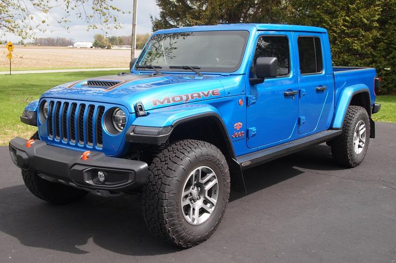

I went with the Morimoto sequential LED fender lights & side markers w/smoked lens. They're plug & play, & have been working great in my Mojave since installing them in March.
Purchased from Retrofit Source. They were great to deal with, & shipped quick.
https://www.theretrofitsource.com/j...-drl-and-turn-signals-TURNS-JEEPJL?quantity=1
https://www.theretrofitsource.com/jeep-wrangler-jl-smoked-clear-side-markers-SIDES-JEEPJL?quantity=1
Hope this is a help.
Dave
Edit: Here is a picture that shows how it looks with the smoked lens.

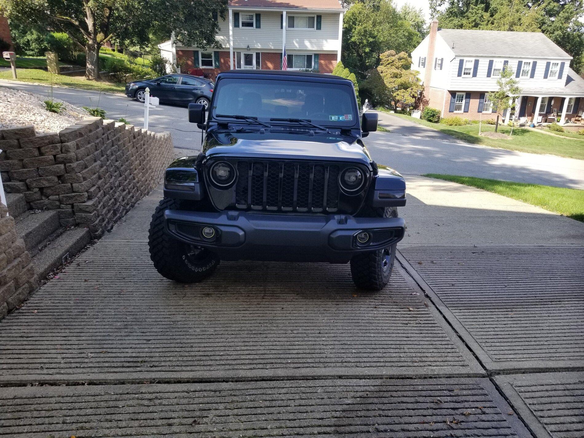

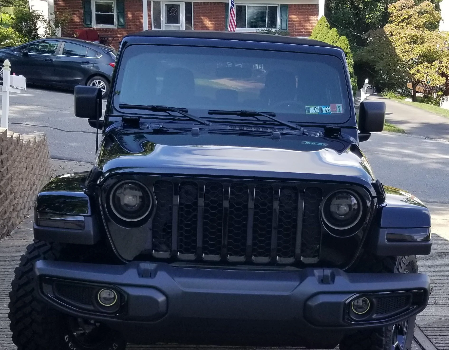

I took a shortcut and just tinted mine. Spent a lot of money on LED headlights,
Jeep Gladiator Which led fender parking and turn signal light recommend you guys? LED DRL 20210916_152807
Jeep Gladiator Which led fender parking and turn signal light recommend you guys? LED DRL 20210916_152822 (1)
Jeep Gladiator Which led fender parking and turn signal light recommend you guys? LED DRL 20210916_152822_2
fog lights as well as taillights. The tint worked well for me.

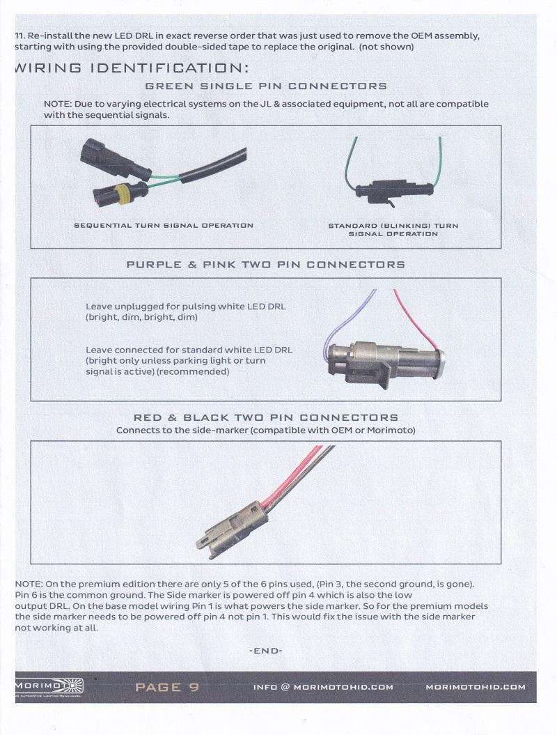

Dave,
Did you have the halogen originally?
I have mine installed and the DRLs aren't working. The instructions make no sense on the "premium" install with the DRL pin wiring.

Hi Robby,
No, my truck has the factory LED package.

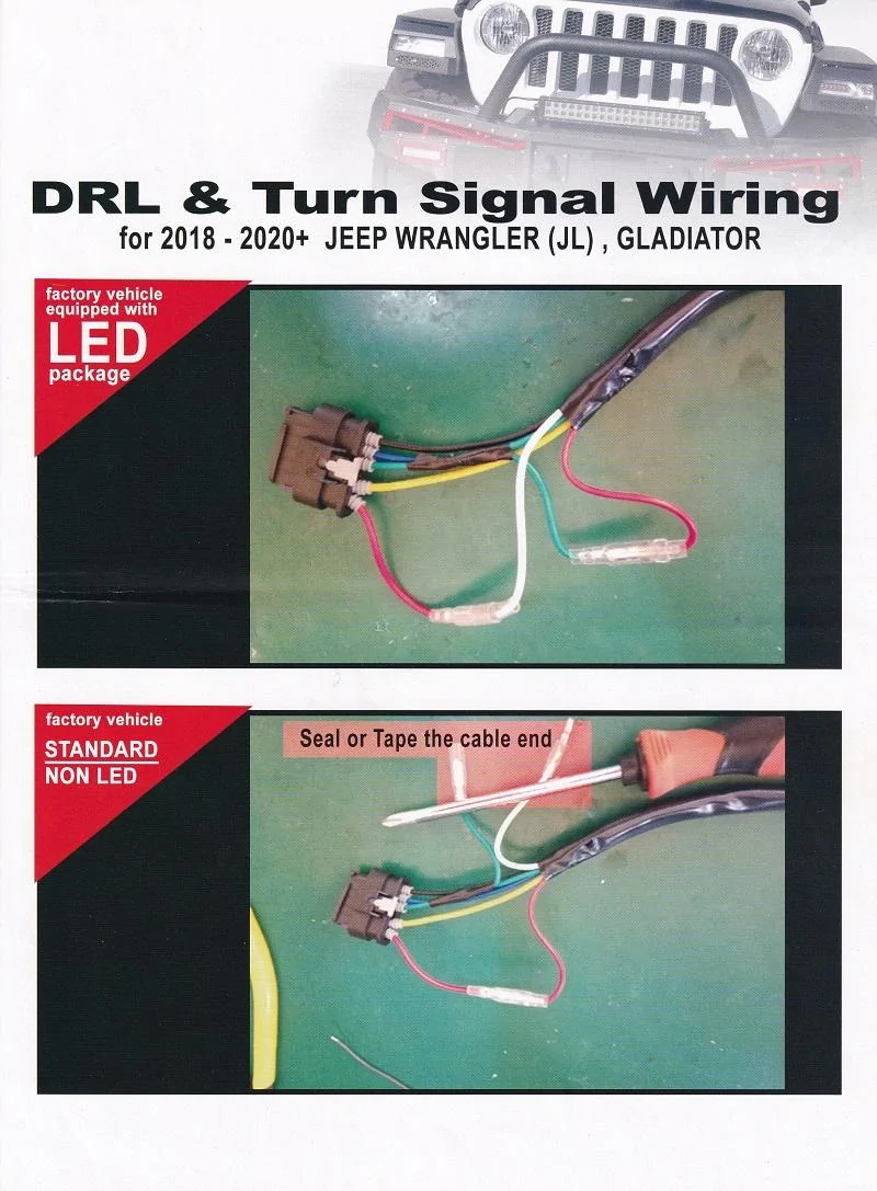

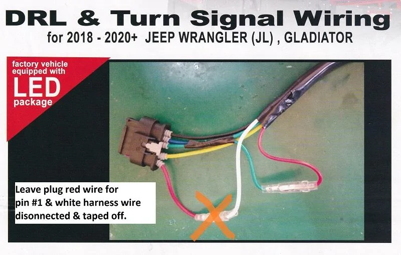

I have scanned the wiring sheets that came with my Morimoto lights & including them here in case they are different from yours, or yours are missing.
On the first sheet as shown at the center of the page, I left the purple/pink connector plugged in as it was shipped for the standard recommended DLR brightness/functionality. This appears to be the only wiring connection shown on this page that should effect the DLR function of the new LED fender light.
Jeep Gladiator Which led fender parking and turn signal light recommend you guys? LED DRL IMG_2031E
I believe the note at the bottom of this sheet regarding the "premium edition" pins is only applicable if you are having problems with the small side marker light not working at all after installation.
This separate page below shows the changes you make to the bullet connectors of the new light harness depending on if your truck originally had the factory halogen, or LED lighting.
Jeep Gladiator Which led fender parking and turn signal light recommend you guys? LED DRL IMG_2021E
For yours with the halogen set up as shown at the bottom, plug the red wires together, and leave the white & green unplugged. Tape/wrap the loose wires back along the harness to help keep them dry & possibly shorting something the the brain box for the new lights.

Dave, thanks much! Based on what you laid out, the DRLs are working as expected and are awesome. Now I just can’t figure out why my side markers aren’t working now.

Hi Robby,
Wish I had a quick answer for you. On my truck the side marker lights worked without any issues.
I guess I would give the tech support guys at Retrofit Source a call tomorrow to see if they can help you to sort out what is going on with your side markers. (404)220-7940 Mon-Thurs 10:00-5:30, Fri 10:00-5:00 Eastern Time.

Haven't had a break from work and honey-dos to pull it apart as of yet but I put everything back until I could try again on the weekend. I noticed that once I had everything pinned up, my factory side markers aren't working either! I didn't muscle anything around while I was down there. The only thing I can think of is that the side marker connection on the back of the plug wiggled loose or something. Any ideas?
Sorry for the delay in getting back to you.
Have been kicking it around, and am wondering if you will need to change the bullet connectors around on the Morimoto harness since your Mojave w/factory halogen lights would be considered a "premium edition" in the terminology used at the bottom of page 9 of the installation instructions which I have highlighted (see below).
Jeep Gladiator Which led fender parking and turn signal light recommend you guys? LED DRL 1637271788249
My thought is that to power the side marker lights on a "premium edition" JT originally equipped w/halogen lights, you will need to change the bullet connectors as shown below with the addition of my note in the text box.
Jeep Gladiator Which led fender parking and turn signal light recommend you guys? LED DRL IMG_2020102E
Unplug the red wire bullet connetors for the plug pin position #1, then connect the male bullet end on the wiring harness red wire to the female bullet connector on the green wire at pin position #4 of the plug.
You will leave the red wire female bullet connector at position #1 of the plug, and the white wire male bullet connector of the harness unplugged & sealed/taped off.
Before trying this, you will want to double check with the tech guys at Retrofit Source that I have figured this correctly, & that this will get the side markers working without messing something up in the brain box for the Morimoto lights.
Hope this is a help, and again let me know what you find.
Dave

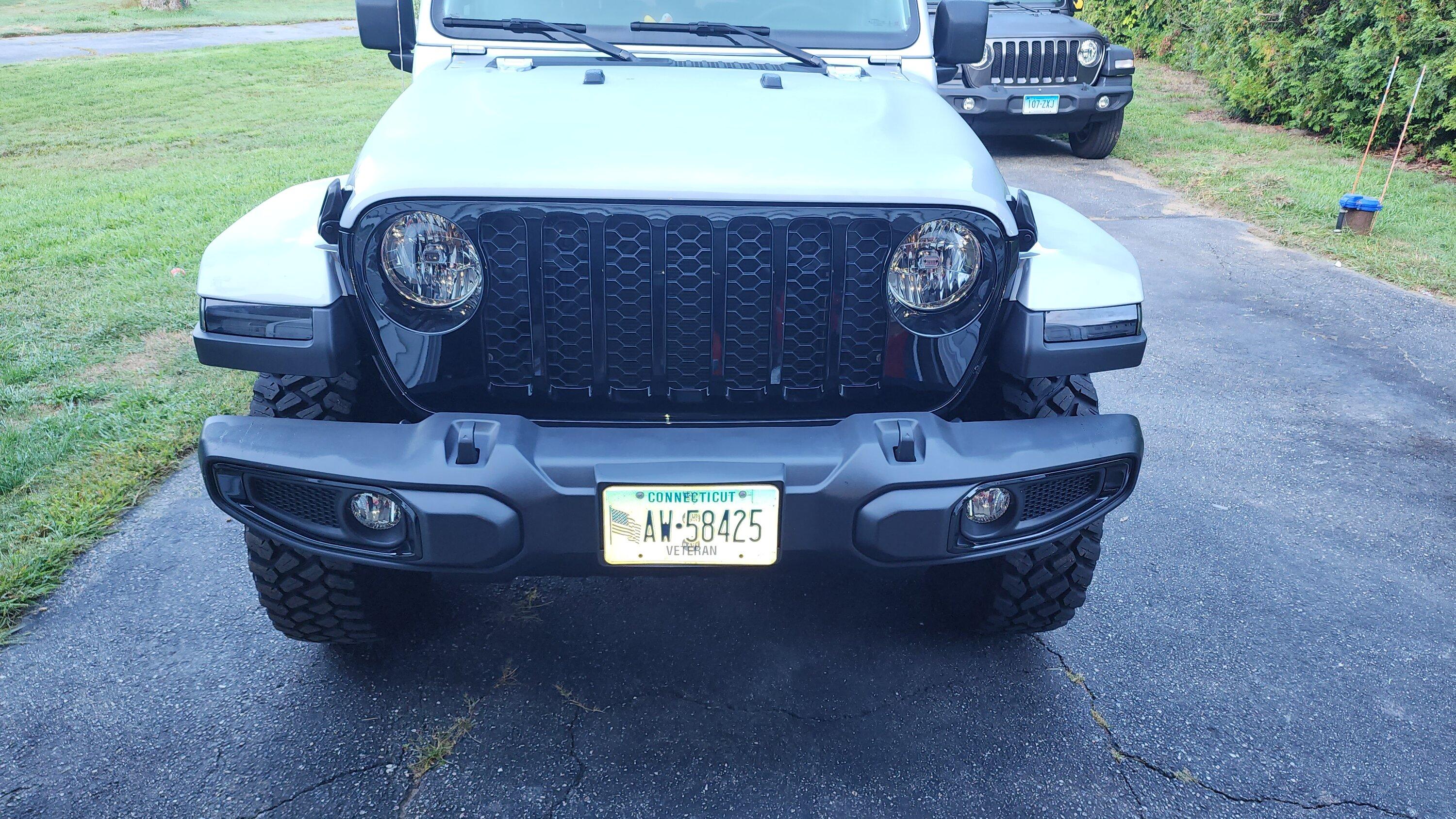

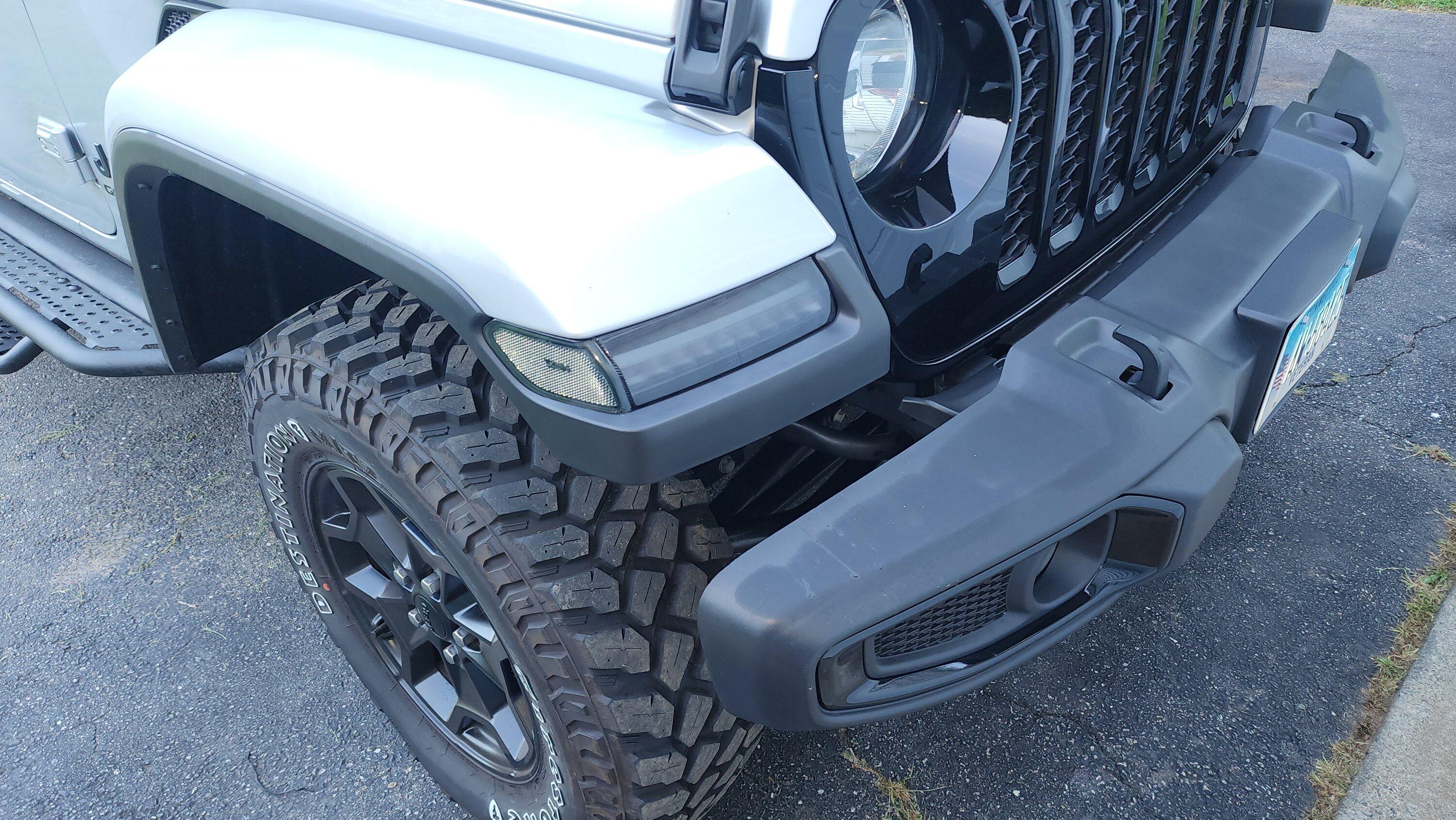

Adding to an older thread as I didn't want to recreate when info already existed.
I added the Morimoto Gen2 XB DRL lights to my Willys. I also added the Morimoto smoked side markers since I was already taking it apart. I didn't remove my fenders as I found this install video from Extreme Terrain:
Install was pretty easy besides trying to pry the units out because the bracket was still in the way but only took about an hour and a half for install.
Verdict: I think they are sweet. They come with a ballast so I didn't need to use a programmer to change the computer to recognize them as LEDs.
Con: I wish they were a little bit brighter -- not as bright as the OEM LED fender lights.
