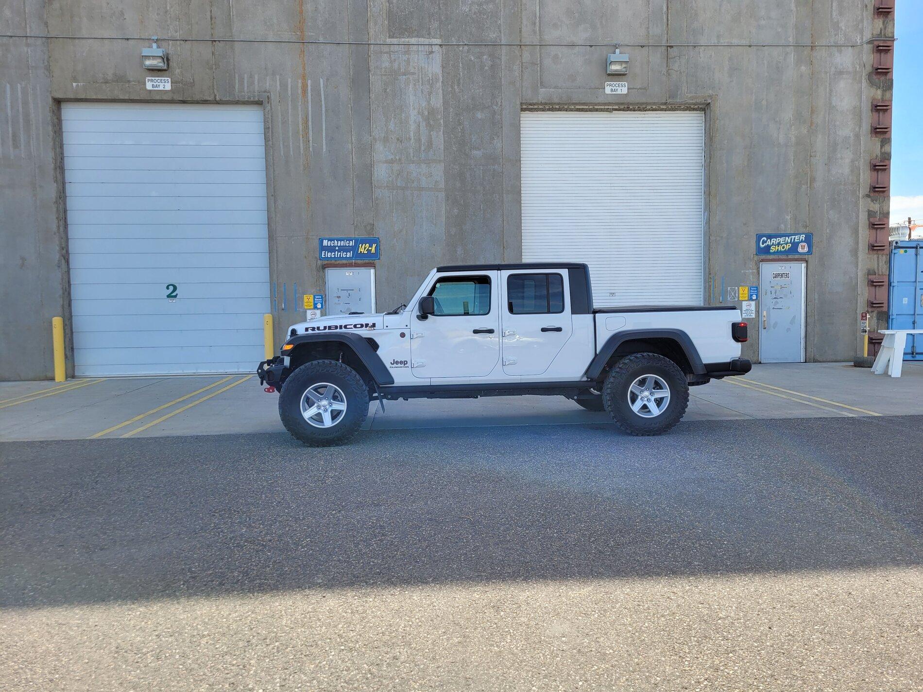

The good news:
RC 2.5" front/ Daystar .75" rear is still doing great. No clunks or problems. 37" tires. JT is now at 9,000 miles.
The bad news:
Picture was taken at work and not on a forest trail. ?
