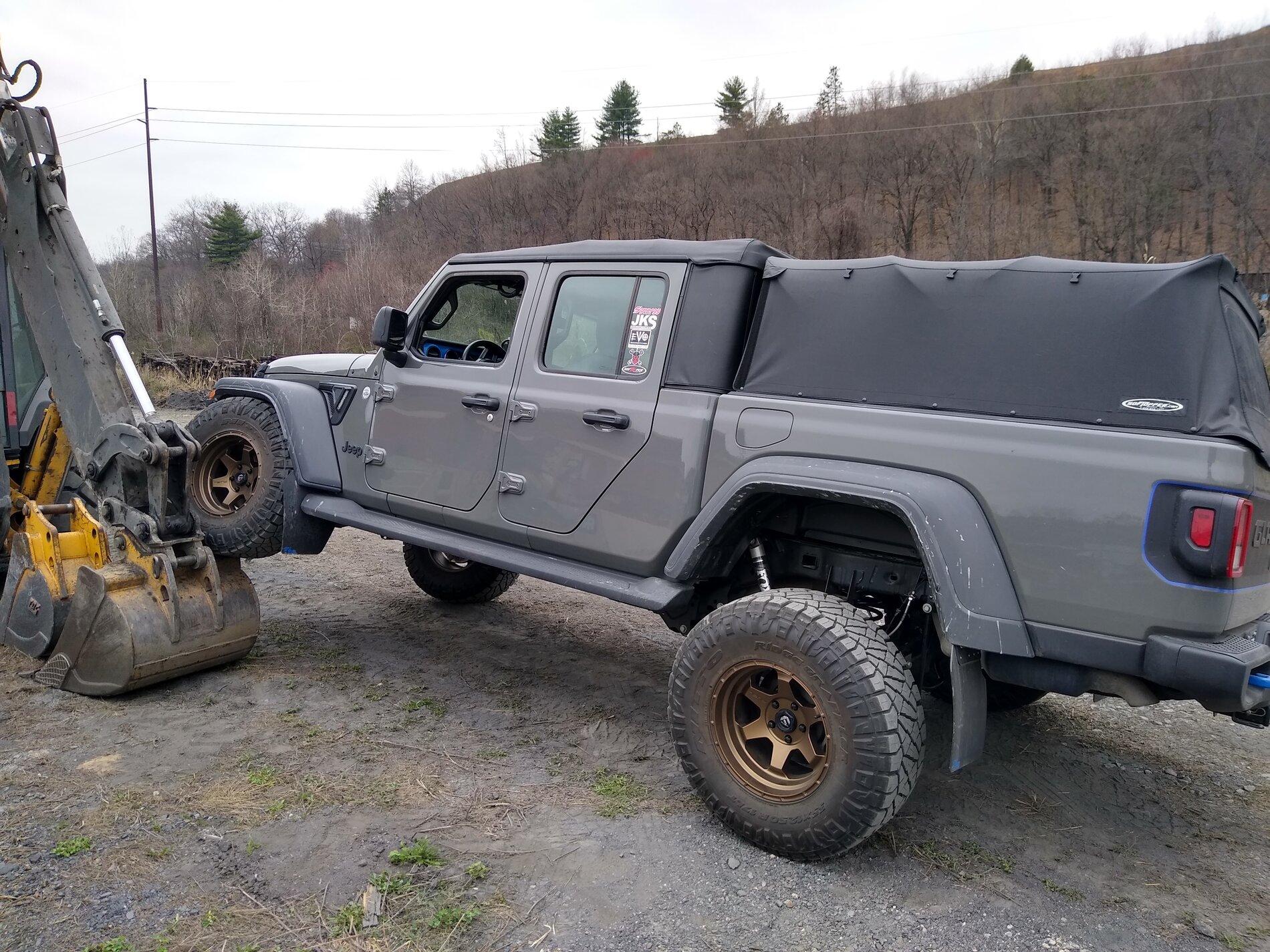

Benbean66
Ben
Apr 29, 2019
1,217
1,774
PA
1973 Honda CB350, '88 RHD YJ, '88 YJ, 2020 JT Spor
Railroad Equipment Operator
Sport w/ Max Tow
2.5" EVO Plush Ride springs
3/4" rear spring spacers (to get rake back)
Clayton Overland adjustable control arms and front and rear track bars
Fox 2.0 2-3" lift shocks
JKS disconnects
EVO extended brake lines and bump stops
35x12.5 Nitto Ridge Grapplers
17x10 Fuel Shok -18mm offset
Edit: Have since swapped out the Evo springs and spacers for Clayton springs, replaced the Fox shocks with a set of Bilstein 5160's, replaced the JKS discos for a set of Apex disconnects, and I am now running Toyo AT3's in 35x11.5.
Not completely flexed out, but just installed the lift the day before, so I was just out playing...

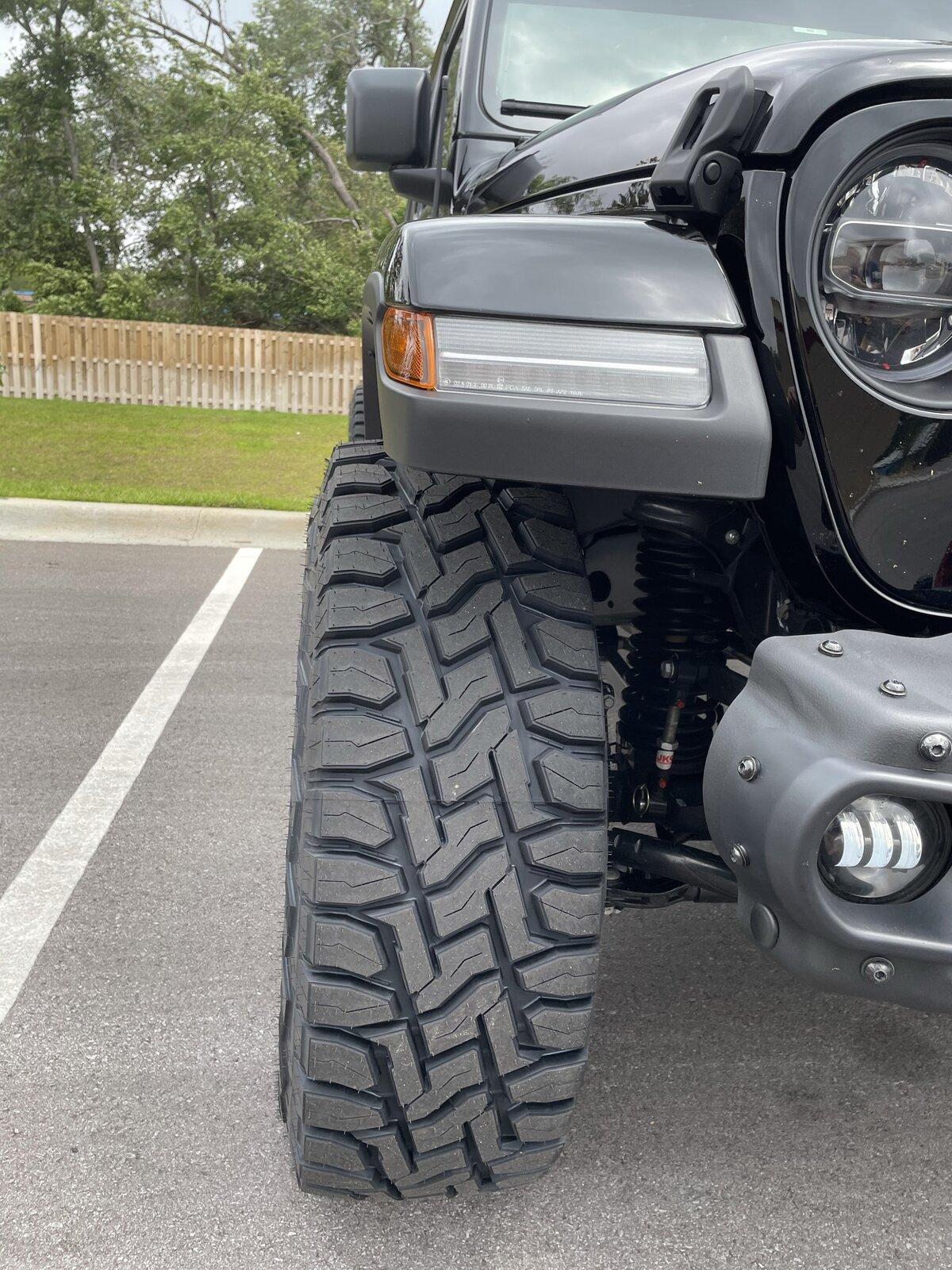

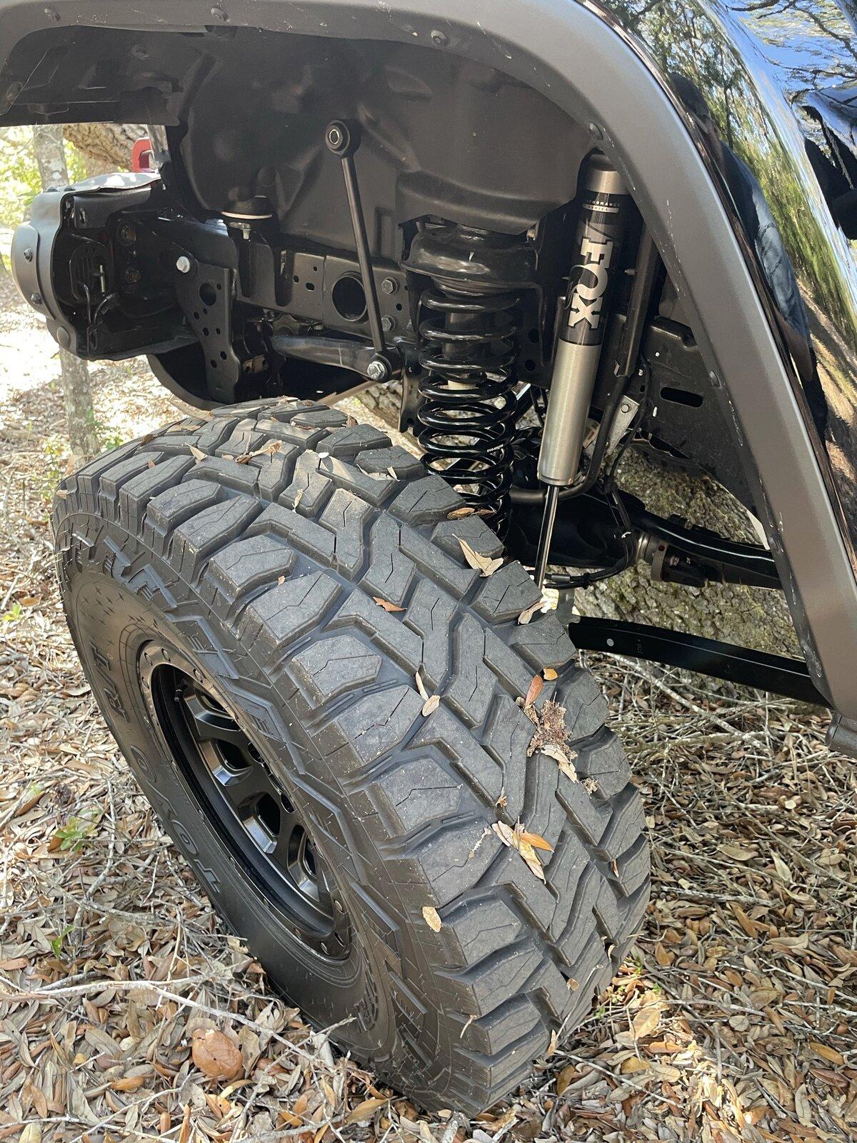

Abnmarine
David
Feb 2, 2021
139
203
Florida
2021 Overland

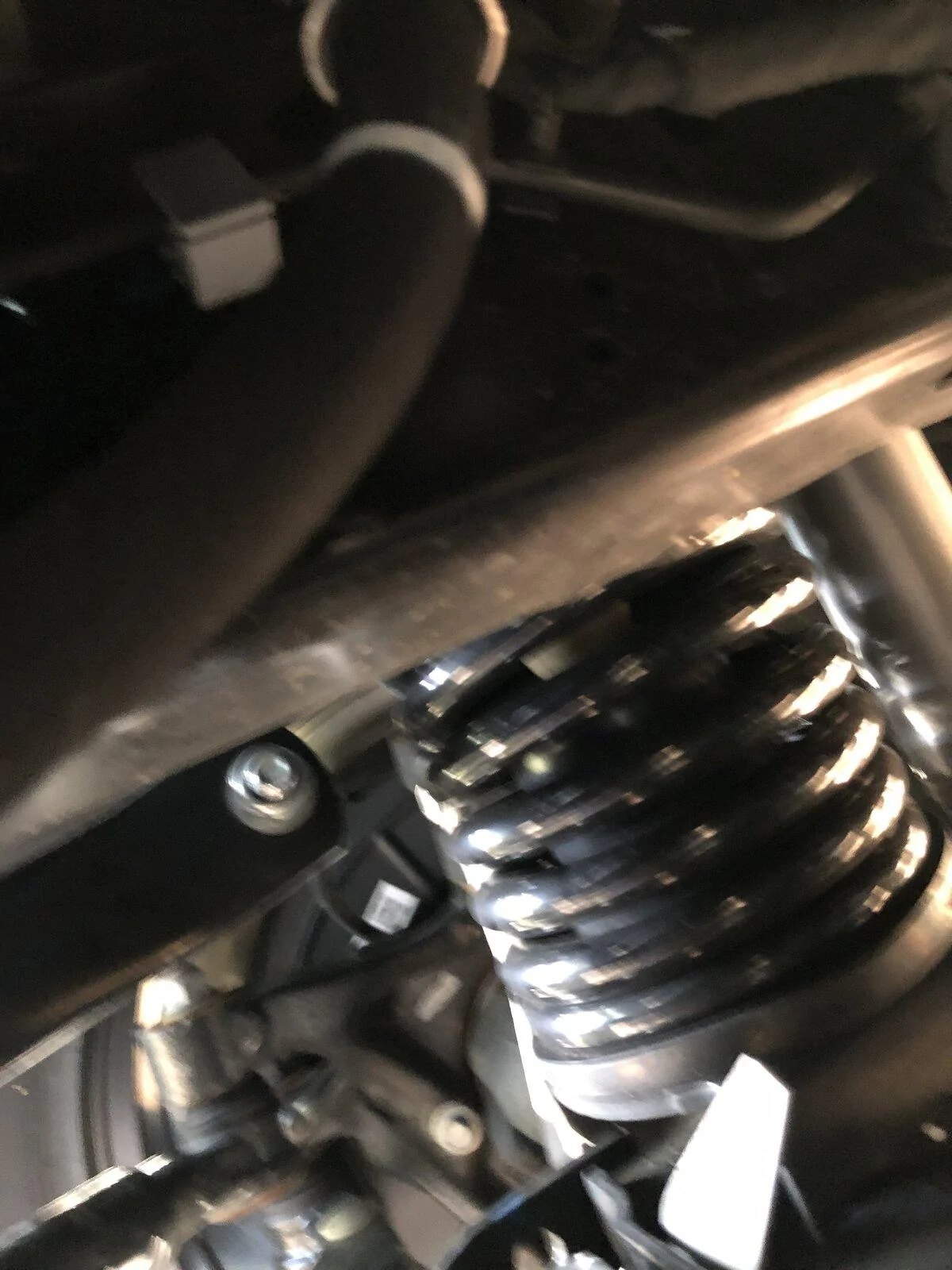

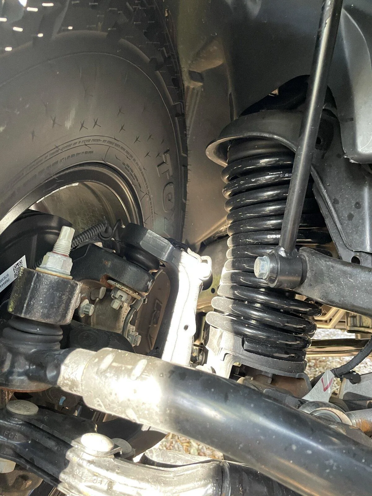

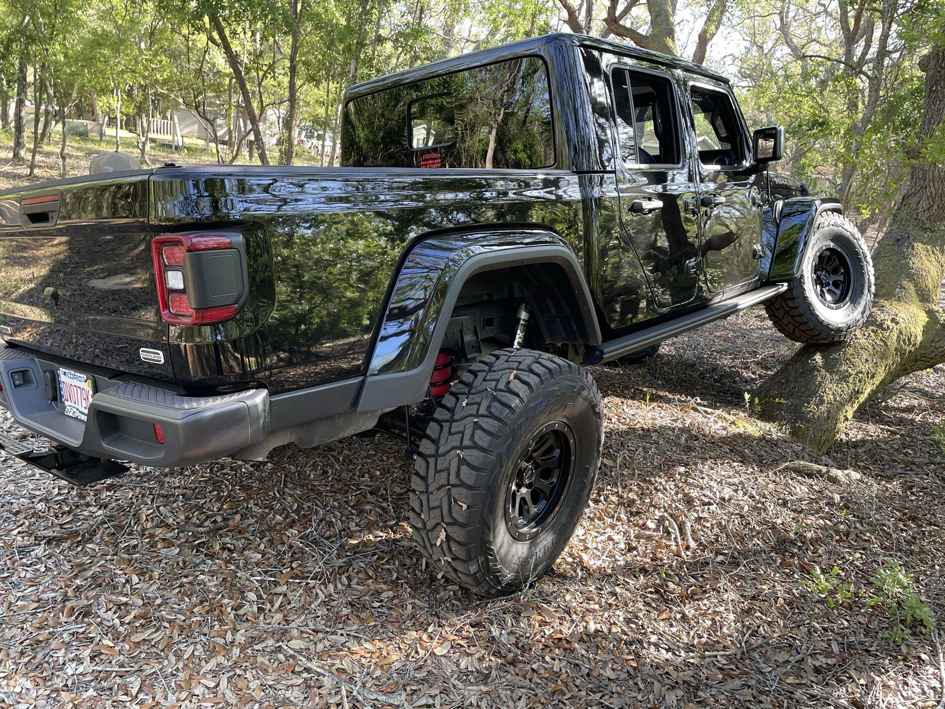

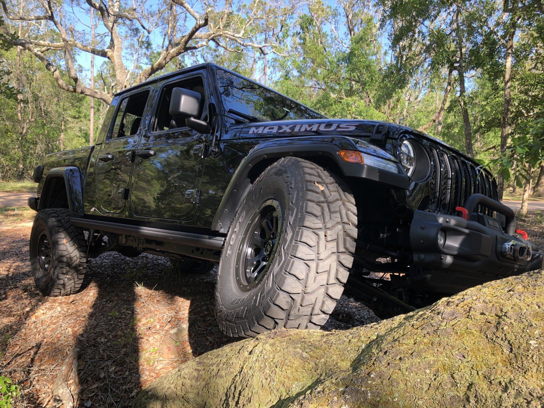

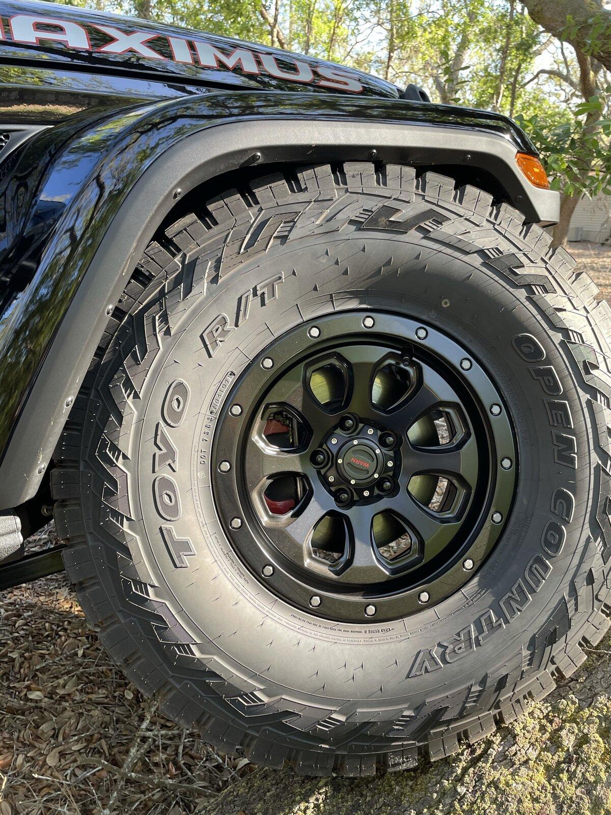

I’m tweaking my bump stops but here you go.
2021 Overland with Ecodiesel
Front Springs: 4 1/2” EVO Diesel Plush Ride with 1/2” spacer
Rear Springs: 2 1/2 EVO Plush Ride with 3/4" rear spring spacer
EVO Geo Brackets
Rusty’s rear upper adjustable control arms
Rusty’s front and EVO rear track bars
Fox 2.0 3 1/2”-4” shocks
JKS disconnects
37x12.5x17 Toyo RT
17x8.5 Warn Moonsault
I‘m debating on removing the spacers.

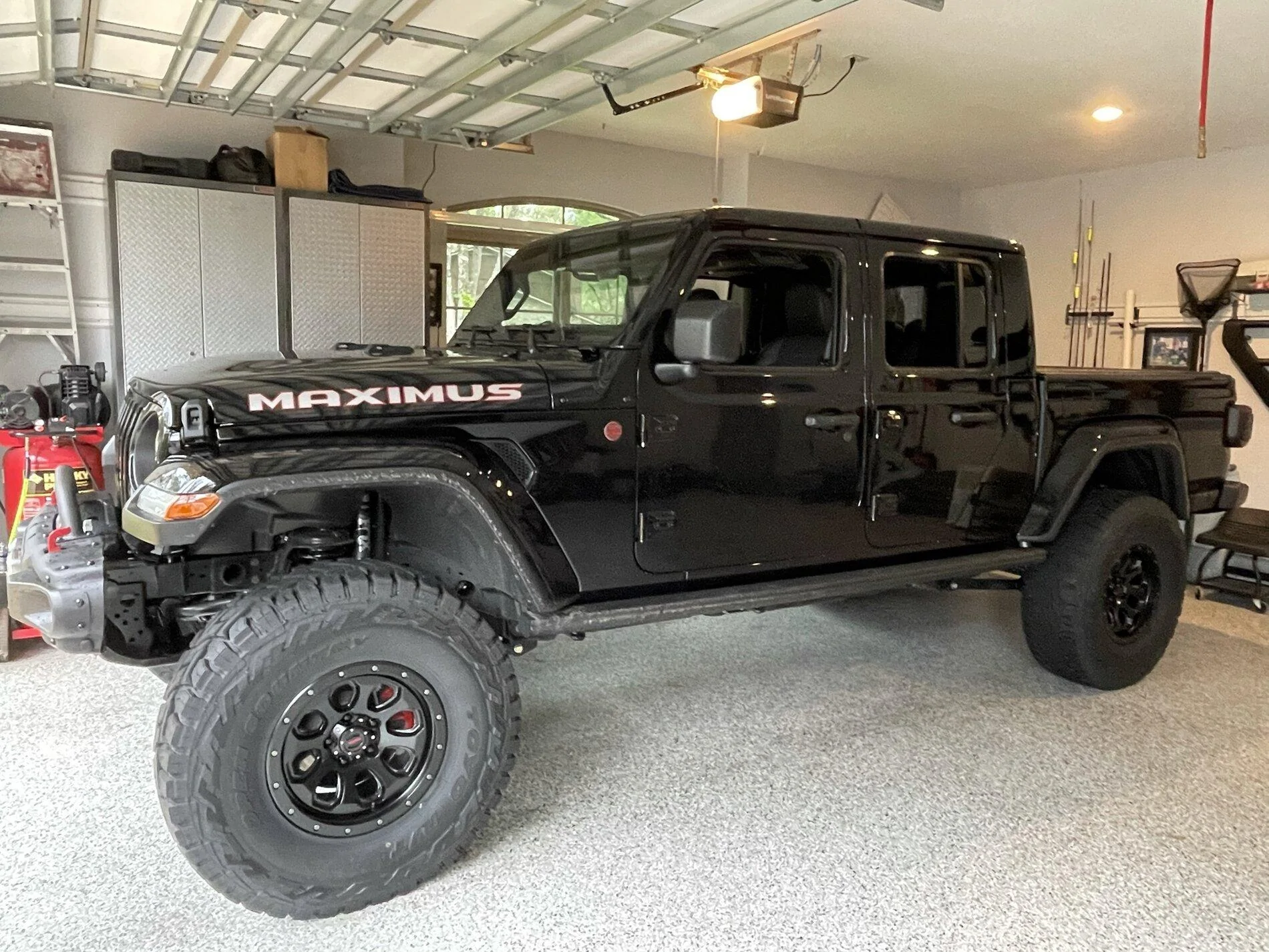

TheSolarWizard
Memphis
Aug 5, 2019
84
2,403
2,336
sun belt
3.0 JT
Solar & EV infrastructure
EVO Geo Brackets
JKS disconnects
37x12.5x17 Toyo RT
Jeep Gladiator Lets see them FLEXED out Jeep's with BIG tires and lifts :D 01C5DB76-9C2D-47EC-B1F8-01DDEBAD84AA
- zero offset
id love to see some more pics of this. I’m waiting on some parts for my Rustys 4” diesel advanced kit
TheSolarWizard
Memphis
Aug 5, 2019
84
2,403
2,336
sun belt
3.0 JT
Perfect! Looks like just enough clearance with a 0 offset wheel with the narrow axles
thank you!
no issues full lock in reverse? Got a straight down the side shot? My build is gonna look really close to yours
Abnmarine
David
Feb 2, 2021
139
203
Florida
2021 Overland

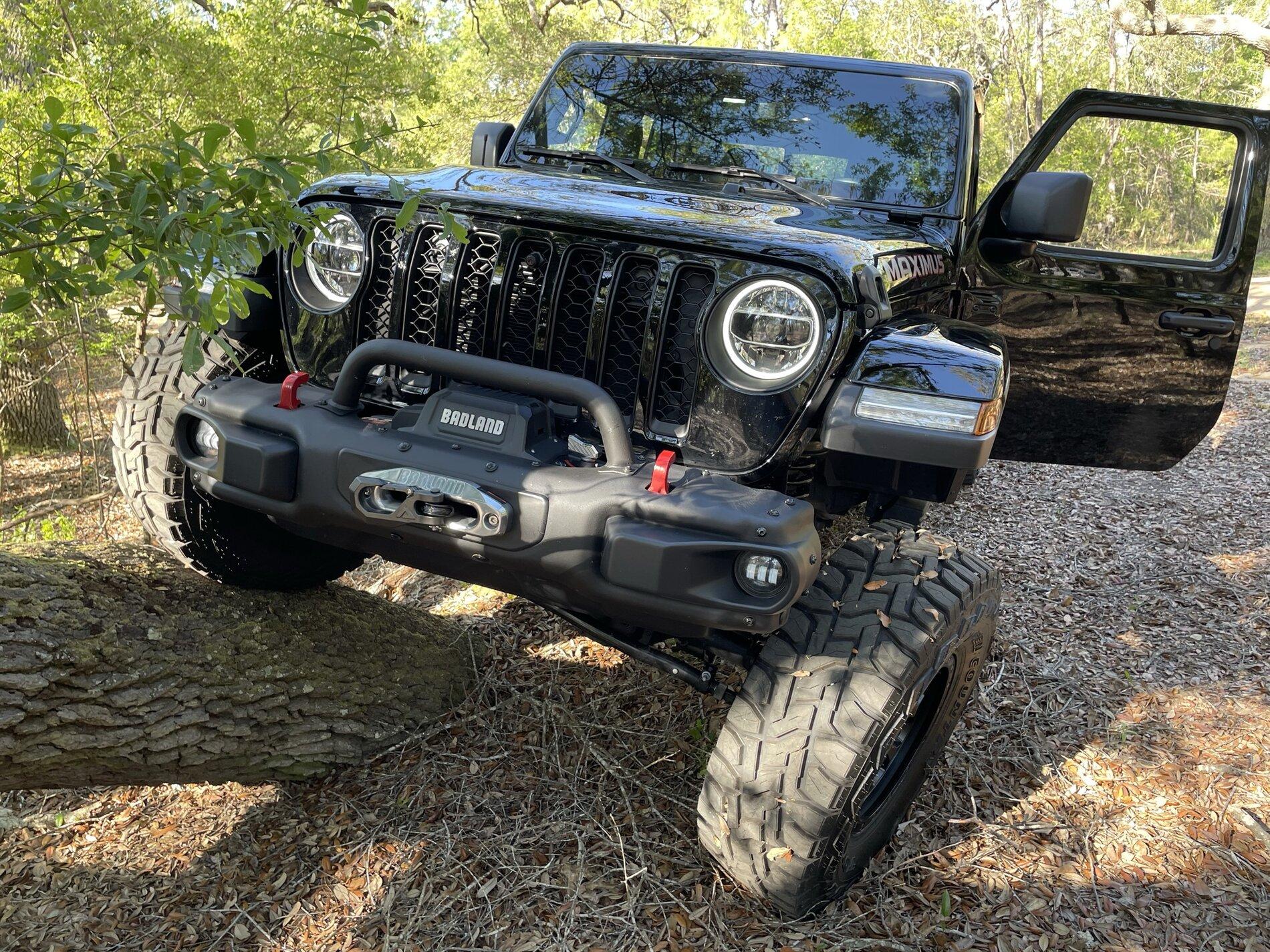

The rear bump stops are good. Their was about 1/2” gap in the front along with the tire rubbing. You will also notice that my coils were pretty maxed at compression. I’m currently using a 2 1/2” bump stop extension but will swap them for 3” plus the upper stops will get swapped with Teraflex stops which are 1 1/2” longer than stock. I’m hoping this prevents the tire from rubbing and not bind the front coils. I swapped all of my brake lines to extended braided right after this flex test.
Abnmarine
David
Feb 2, 2021
139
203
Florida
2021 Overland

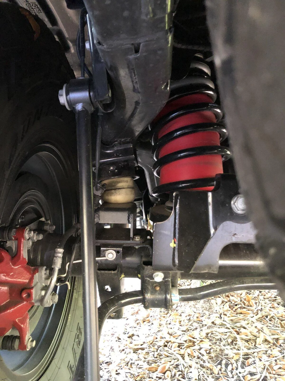

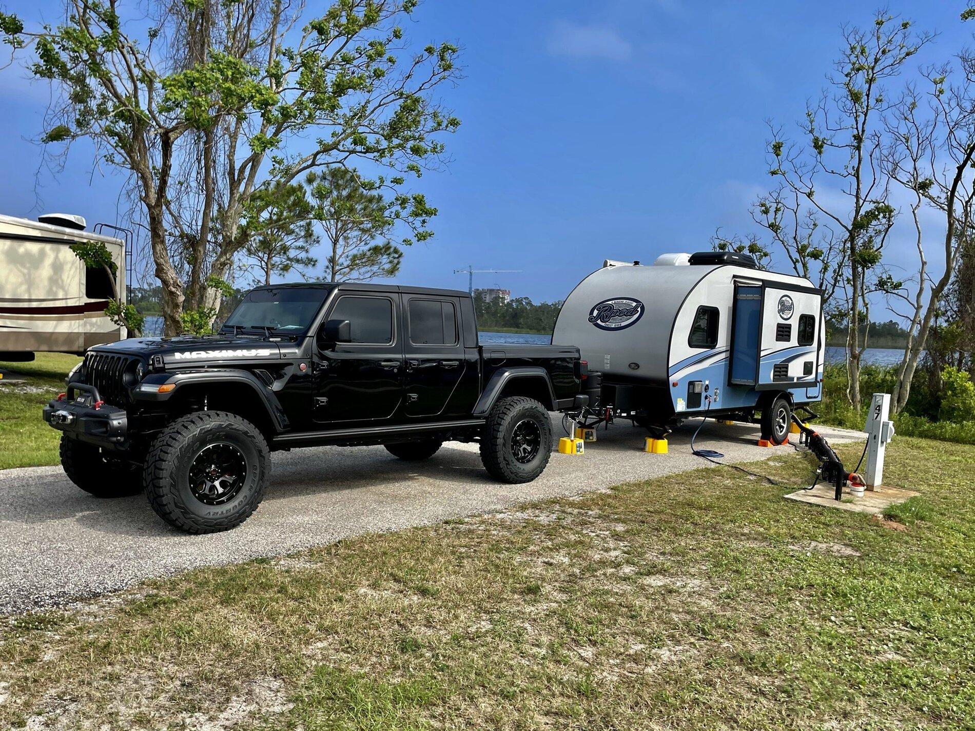

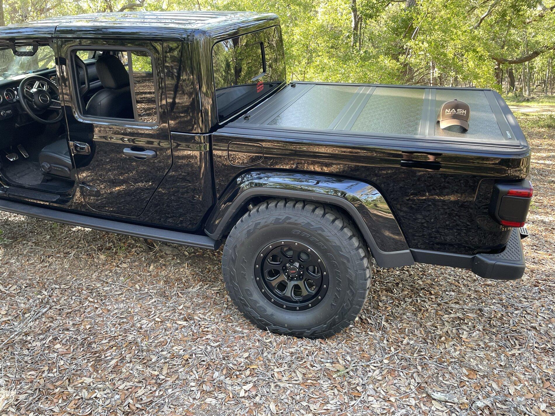

As for the airbags, I had a spare set of 1 1/2” bump stop extensions laying around and decided to bolt the, inside of the rear coils at the bottom for the bags to sit on. This helped with the height of the bags since I have higher springs. I tow a small Rpod camper and played with the air pressure. 30 psi worked best and helped prevent any sag. I also use a WDH But the bags work great with it.
Jeep Gladiator Lets see them FLEXED out Jeep's with BIG tires and lifts :D C48D2FFF-0CF1-439C-819F-3076F4789A4F
Abnmarine
David
Feb 2, 2021
139
203
Florida
2021 Overland
I don’t have any rubbing when driving but the front rear portion of the tire was up against the fender when flexed. I’m hoping the change in bump stops / extensions correct this.
Abnmarine
David
Feb 2, 2021
139
203
Florida
2021 Overland
thank you!
I didn’t want my tires poking out too much. This is why I chose the zero offset.

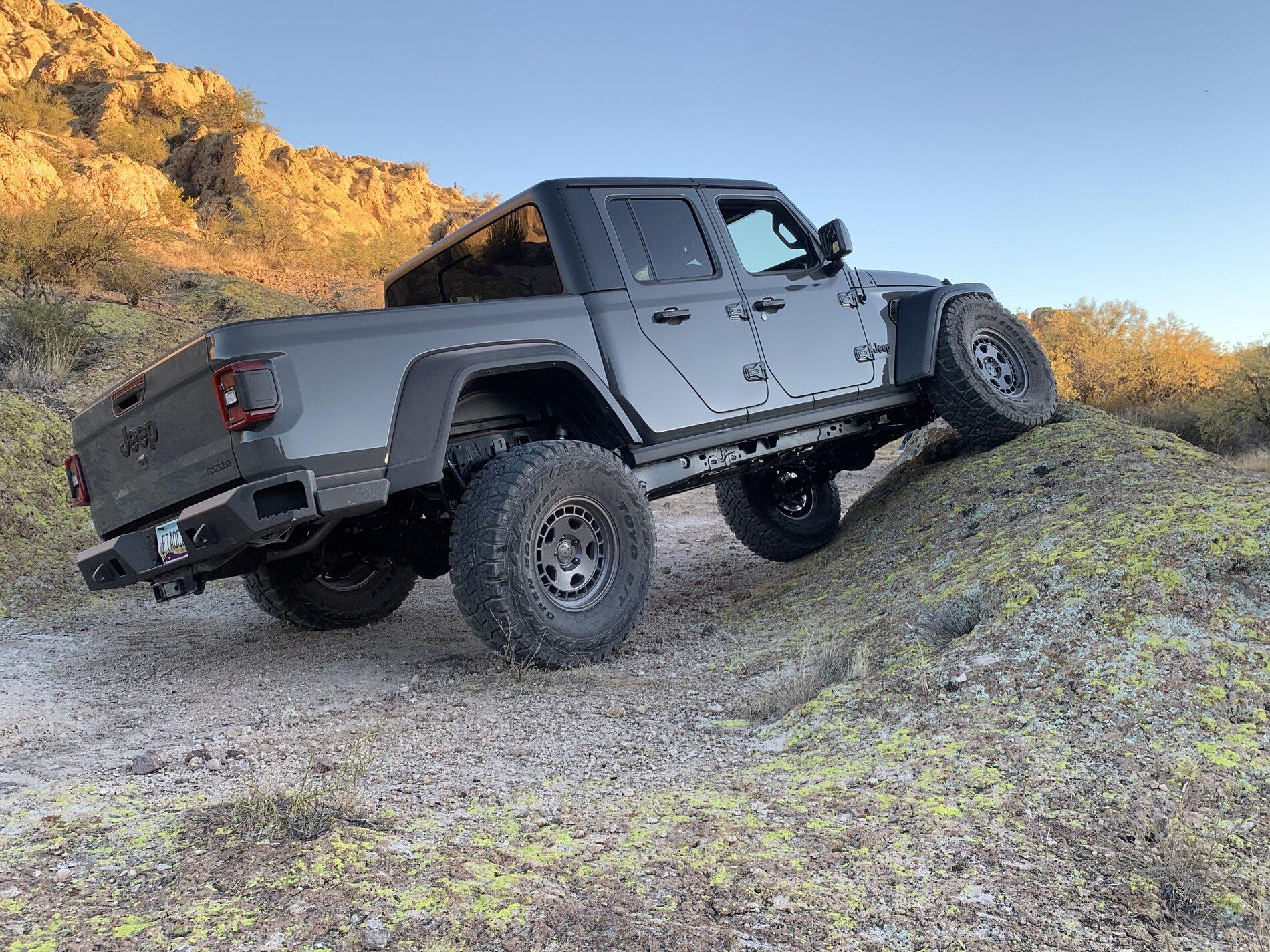

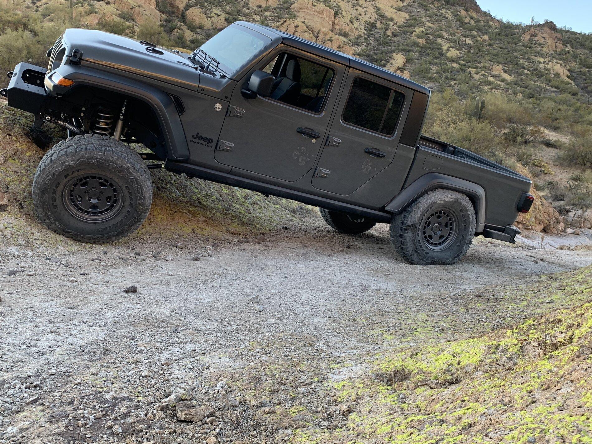

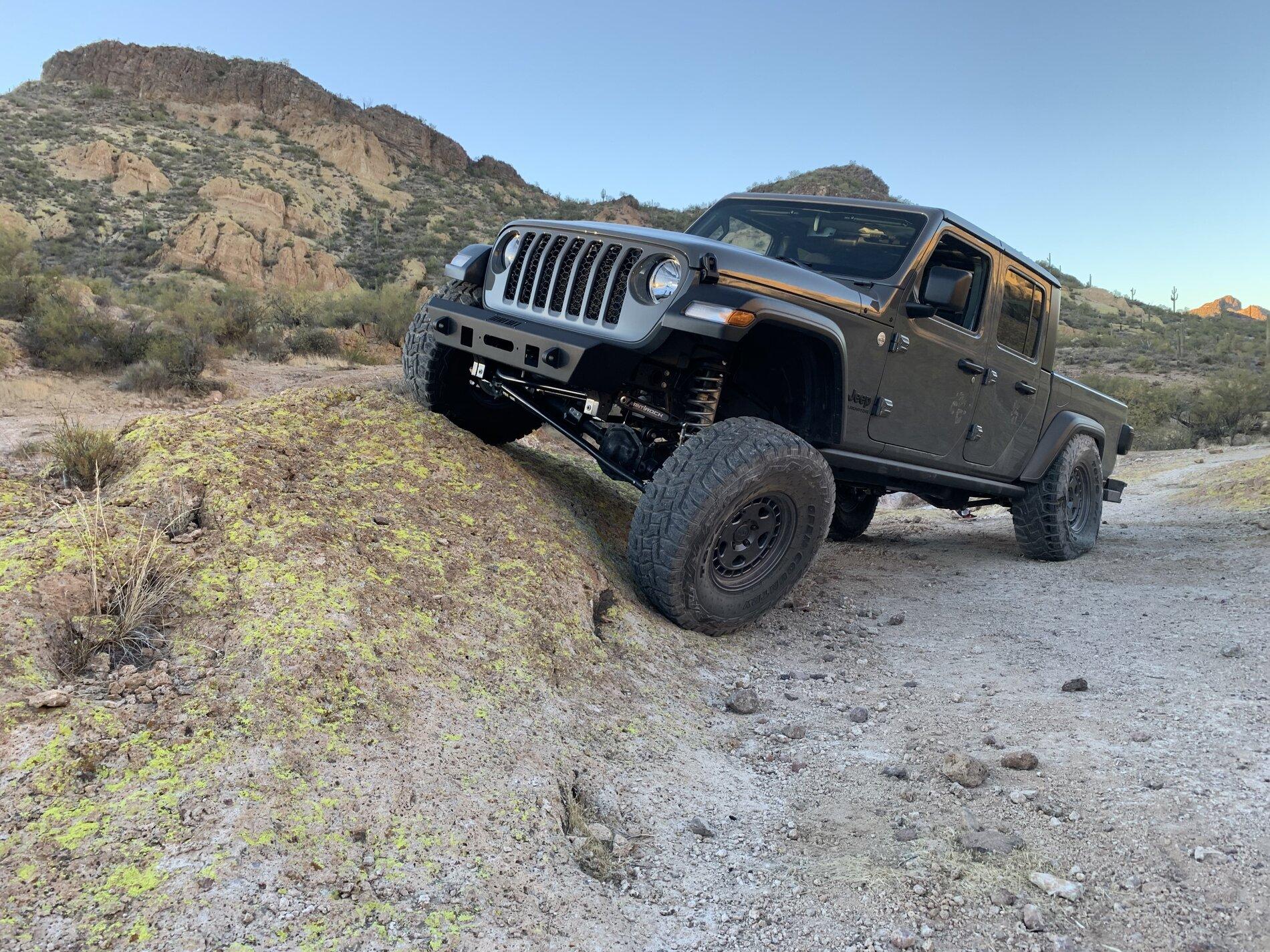

kgc
Jul 29, 2020
71
90
AZ
2020 Jeep Gladiator
Rock Jock lift kit with 3" front springs and 1" rear
3" bumpstops up front, no additonal bumpstops in the rear
37x13.5 Toyo R/Ts on Fifteen52 wheels, 17x8.5 - 0 offset
Fox 2.0 shocks: 3.5-4 front, 0-2 rear
I don't recall if I had 1 ¾" wheel spacers on the front when I took these pictures, but I do now.
Since taking these pictures I've added ¾" spacers in the rear, and have Fox 2.5 shocks (4.5-6 front, 3.5-4 rear) sitting in the garage waiting to be installed.
Jeep Gladiator Lets see them FLEXED out Jeep's with BIG tires and lifts :D tempImage9LIwhH
Jeep Gladiator Lets see them FLEXED out Jeep's with BIG tires and lifts :D tempImageOxAOe9
Jeep Gladiator Lets see them FLEXED out Jeep's with BIG tires and lifts :D tempImage746pD4
