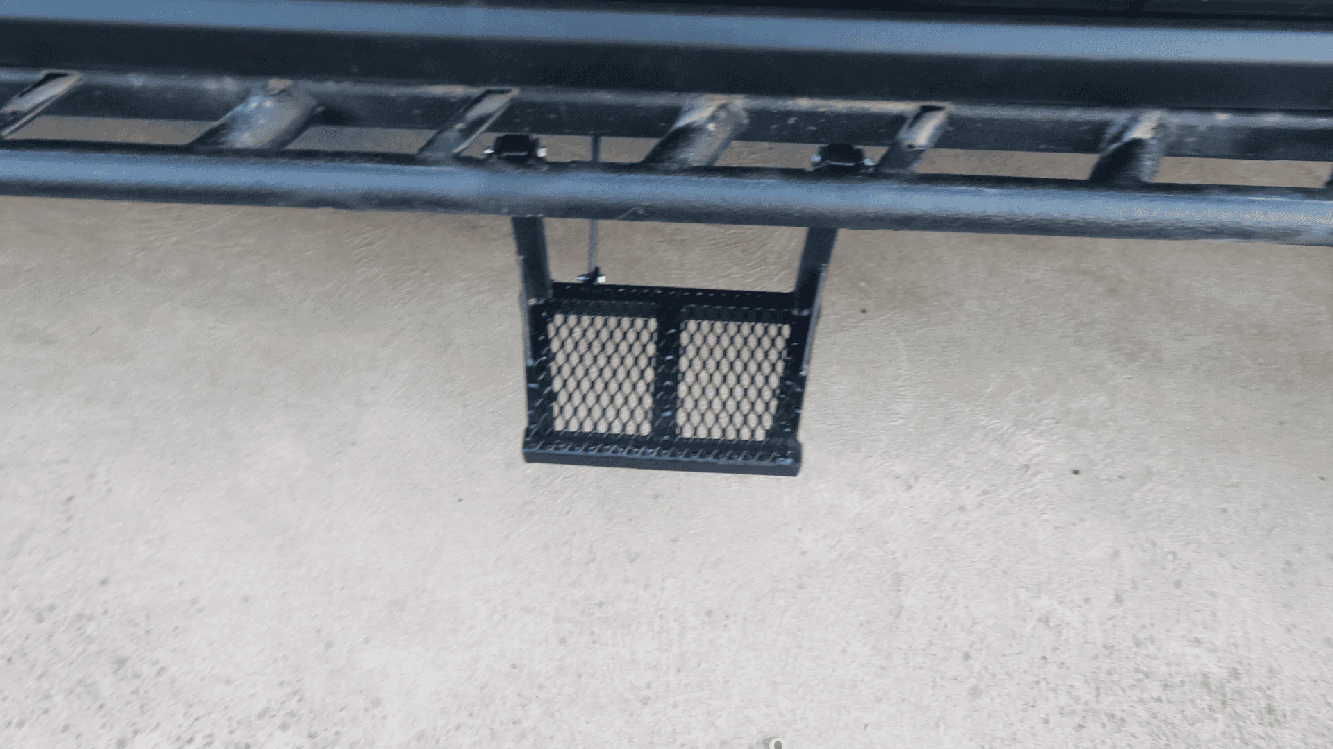

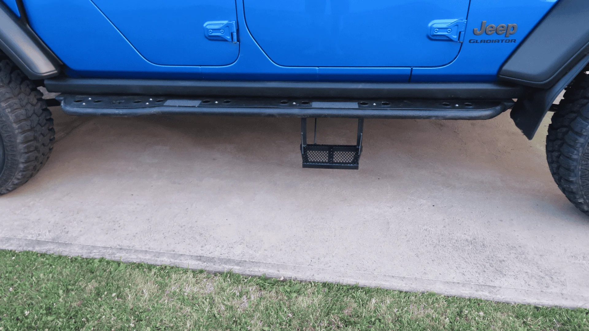

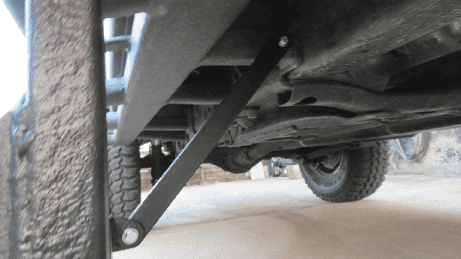

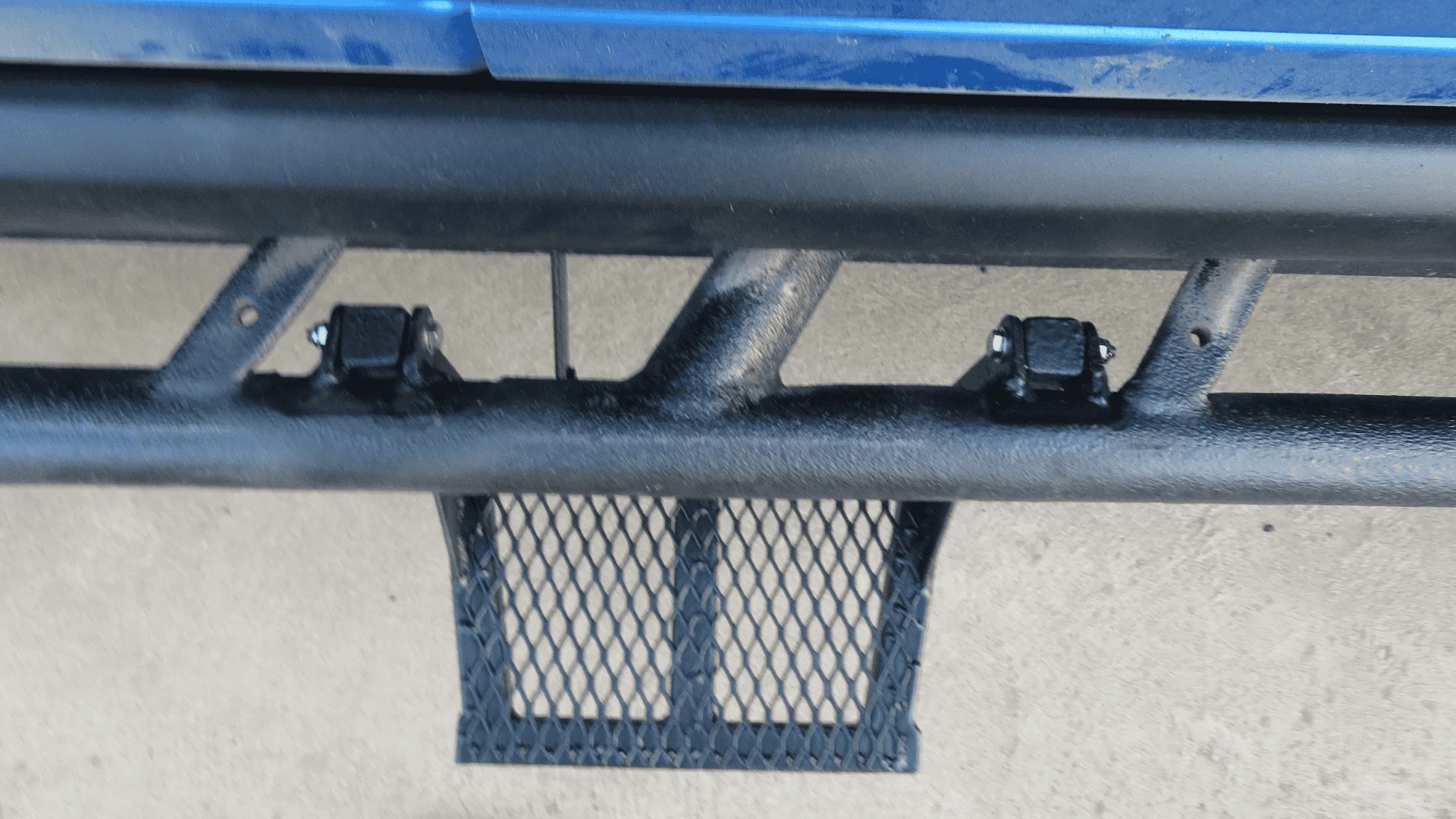

tell me more about that little step you rigged up
Because the wifey has Parkinson's, plus just having foot surgery. I had to make a set of steps that bolt on to the White Knuckle rock rails. If I go 4 wheeling. I can remove them easily. 3 bolts and they are off. Wanted to use round tubing. But couldn't find anyone to bend it. All of my friends that I have connections with are retiring. So...I had to go with square tubing. They're mounted to the rock rails using a double shear tabs. After I got them done. I sprayed them with rattle can bed liner from Advanced Auto.

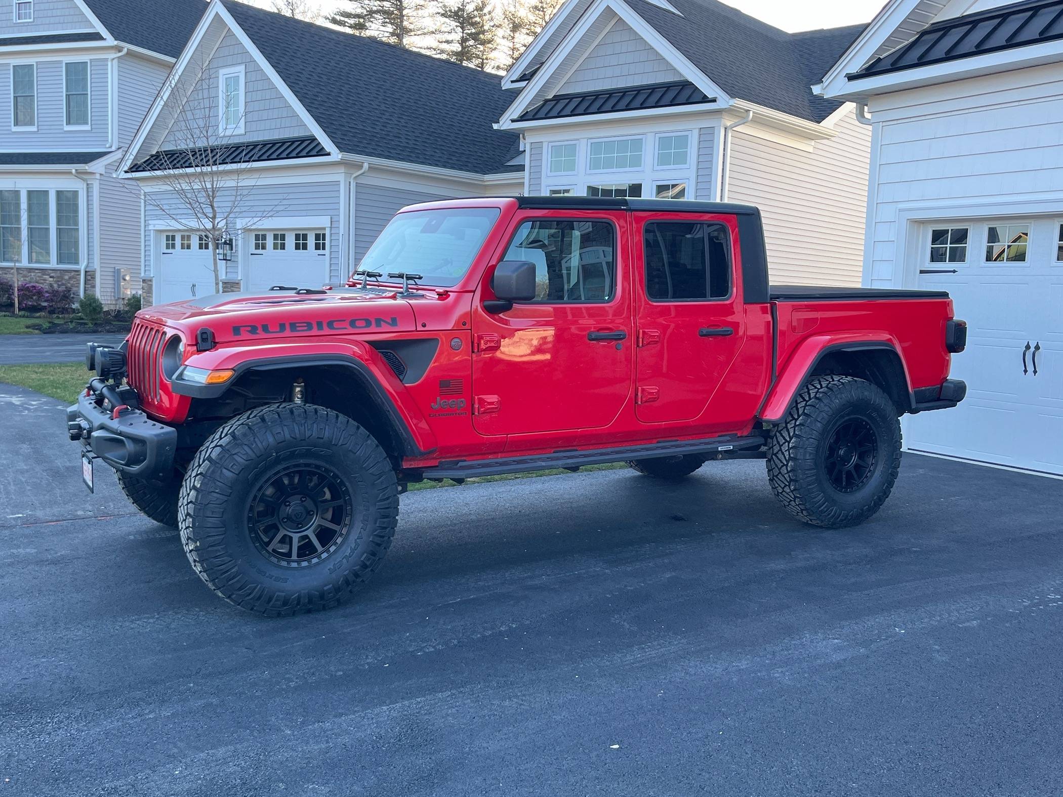

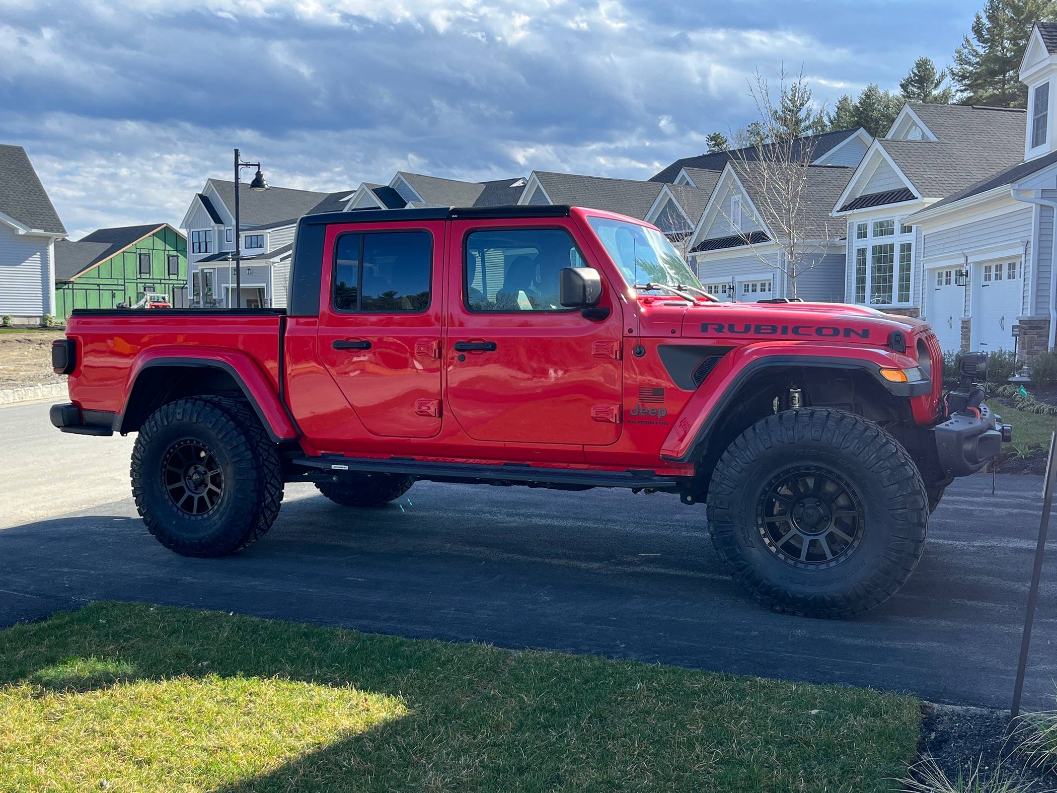

38” Nitto Ridge Grapplers on Alphaequipt Foxtrot 17x8.5 (+25mm offset) wheels.
Mopar 2” lift with Teraflex 1.5” level in front. AEV geometry correction brackets, EVO track bars, Teraflex track bar relo brackets, Falcon steering stabilizer, etc.
Looks Awesome!
