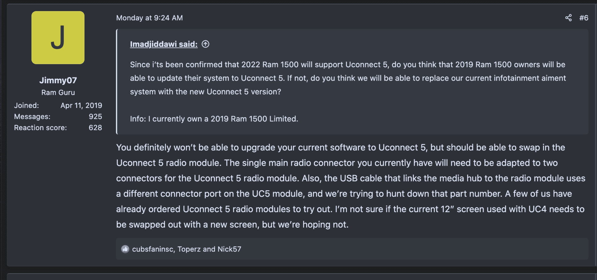

The UC5 radio itself would work as a retrofit with a set of custom adapter cables, but installing it would be a challenge. Sub-dash structure would need to be swapped, along with the three upper dash panels. Then, since the vents are no longer on each side of the screen, the hvac ductwork would need to be swapped.
Also, if the factory trail camera is equipped on the vehicle that the UC5 is getting swapped into, the CVPM will also have to be swapped out.
Oh. Yeah I just stumbled across it's 12.3" instead of 8.4" so it's a tough fit. That would be a lot of work! How do you know all this! I'm impressed.
