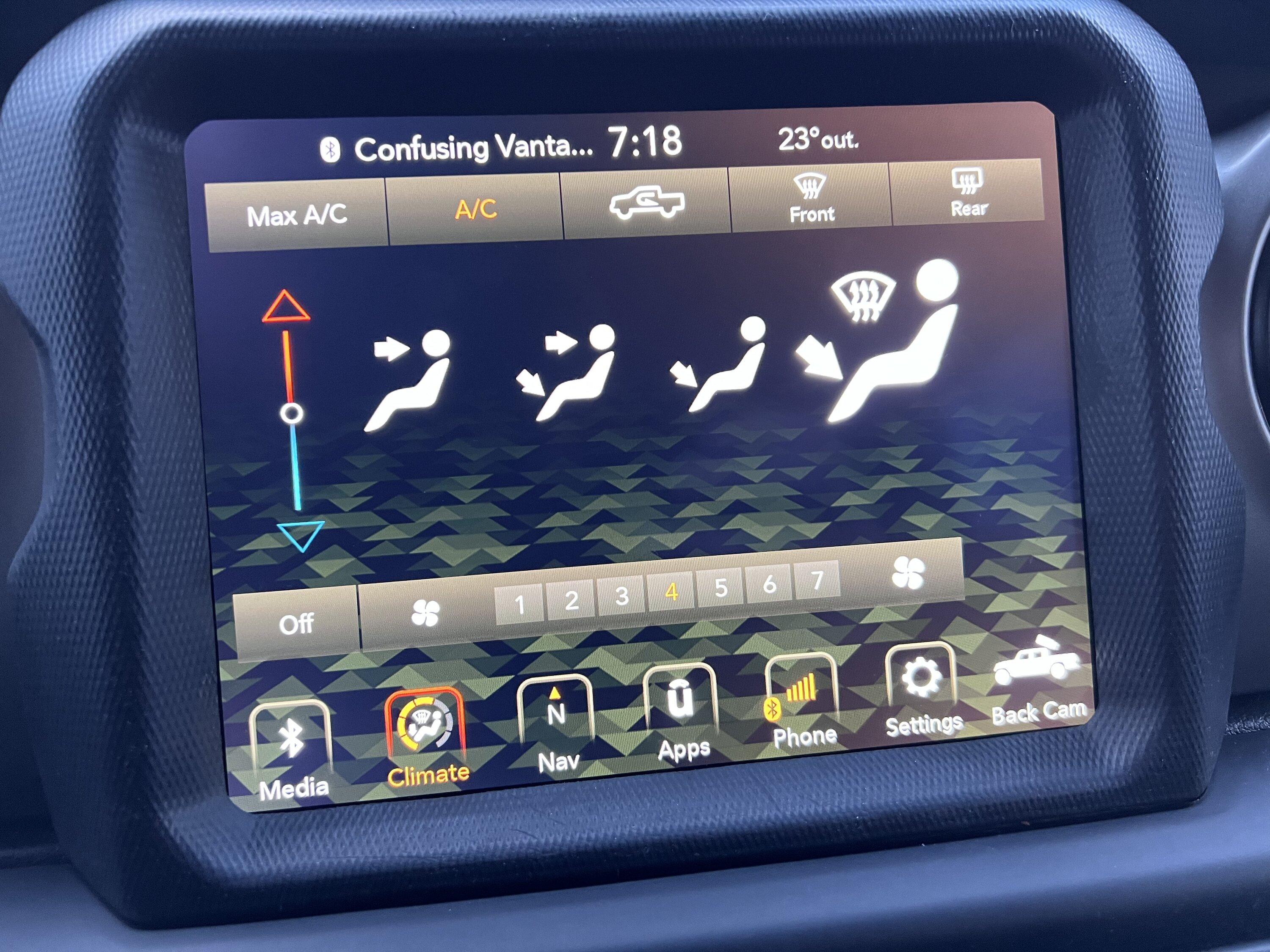

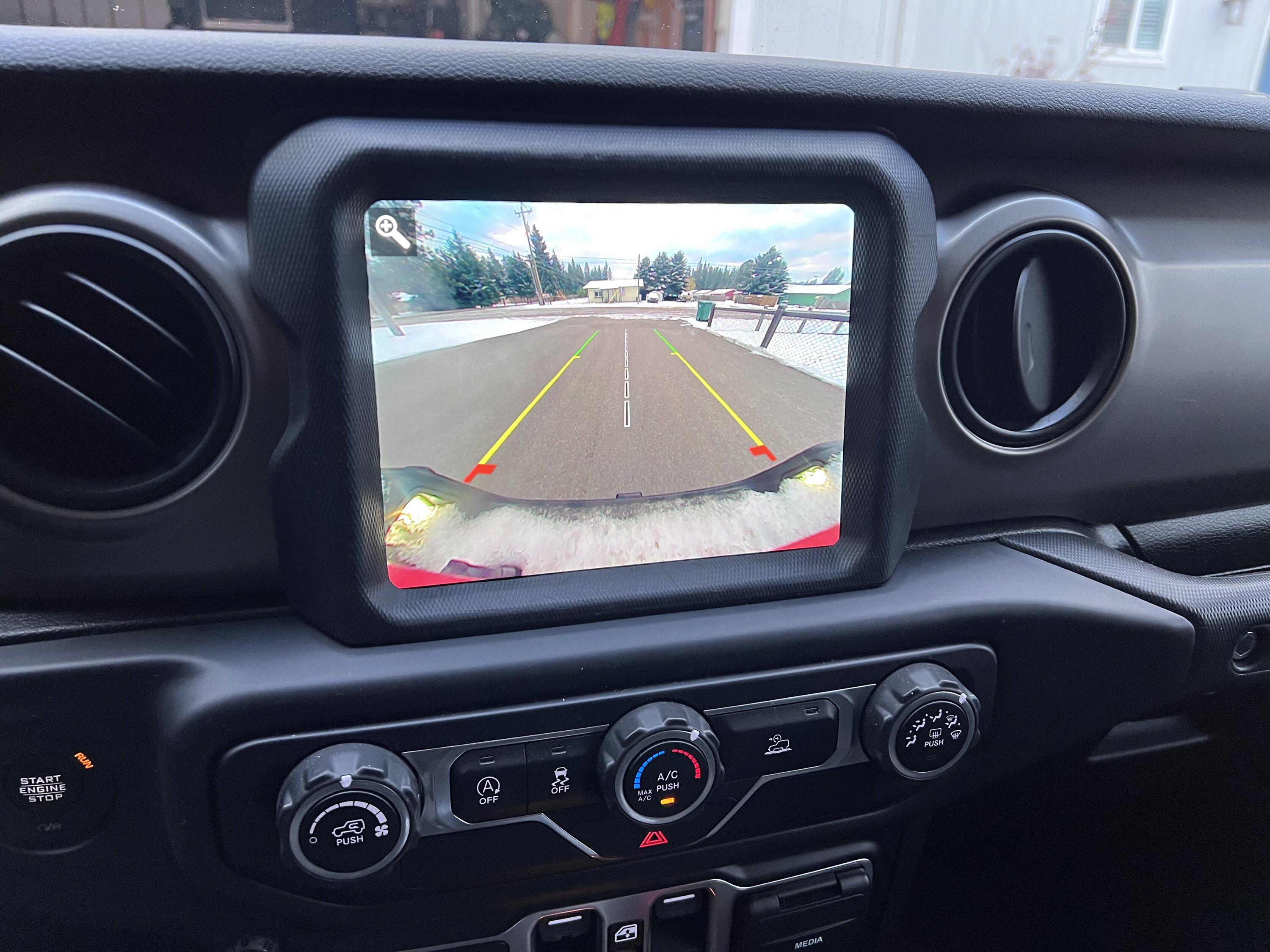

Ok, so here is what I figured out. I hope this helps someone.
Tying to vin is bs from what I see. I could be wrong, but I believe as long as you have the security code and the correct screen, the head unit has the ability to adapt.
plug the radio in, and give the car the entire night to adapt. I believe the chipset in the head unit reads the Jeep it is in and updates itself to the new vehicle. This morning, the unit works really well. Backup camera is great, the heater controls have even changed to my base heater. Dual zone is gone, and the temp scale follows my single zone setup perfectly. If I had a volume and power knob this would be excellent. The unit even has a bunch more settings screens and different layout than last night.
very little lag, and what I believe factory installs should feel like. My unit has been in two previous jeeps as well. This is pretty much worse case for a head unit to go through. Haha
As I add the heater controls and gps antenna I will update this thread.

Thanks @jeep1
I have the sun sensor but don't have the auto climate sensor. Still need to get some odds and ends but wanted to figure out if the big screen had better auto play for Bluetooth streaming. If the little 5" would automatically start streaming my music after a restart, I probably wouldn't have upgraded. I was so happy that when I started the jeep this morning, my music started playing without me having to hit three buttons!
