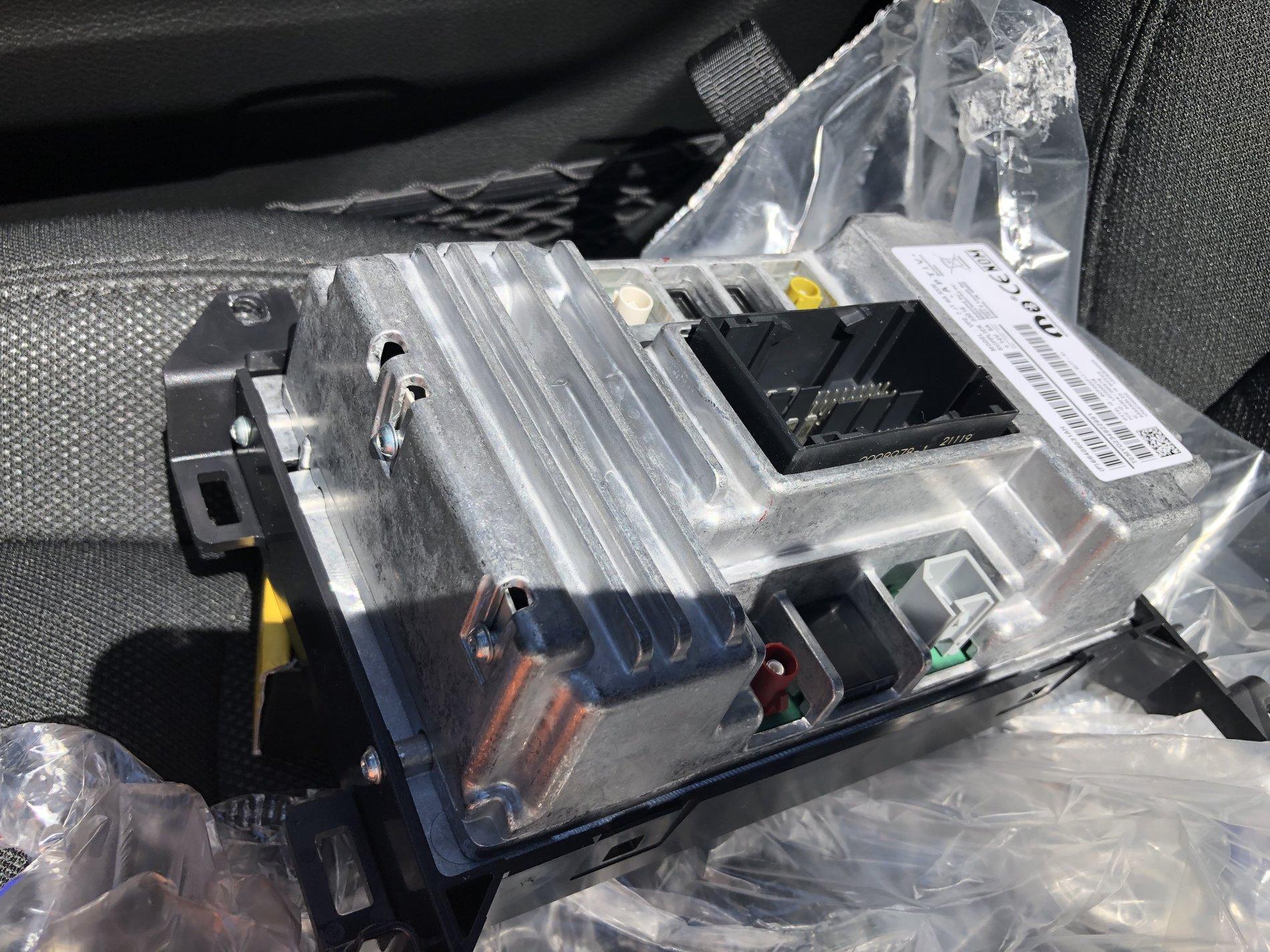

I swapped out my 7” for a new 8.4” screen (68417866AG) with NAV and I’m having problems after the install. Radio was in metric for temp, radio station cut in and out, satellite had some German text, no backup camera, and screen and icons were a blue theme. After a few hours, the camera works, radio works, temp is back to F°, and icons and colors match the old gladiator radio.
Remaining Issues:
Satellite radio doesn’t work still (nothing happens when I click on the icon). When I click on NAV, my location is showing up but there’s no maps/roads, etc. Also, USB2 in the counsel will charge my phone, but won’t connect to Apple CarPlay. No off-road pages.
First photo is the new 8.4” head unit. I plugged the turquoise Wire into the blue plug. On the old 7.0” the turquoise wire went into the yellow plug.
What am I doing wrong? Do I need to go to dealer to have it flashed? Should I wait for an OTA update?
Mike, did you resolve these issues? Did you have any issues with the backup cam?
We have a customer who performed a swap and this feature is inop. I believe that flashing may cure this but wanted some real world feedback first.
Thanks,
- Benny
