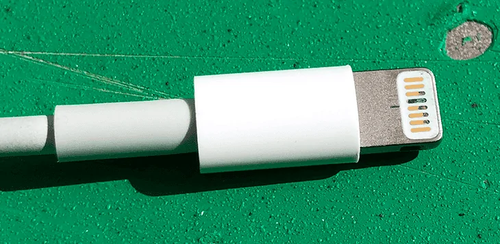

I would bet it's your cable.
Iphone cables actually wear out... I have had 3 O.E. apple cables wear out.
Look at the cable for this.
Jeep Gladiator Intermittent Apple CarPlay connectivity issues w/ 8.4" Uconnect 1683120912316
Then go google black pin line iphone cable.
