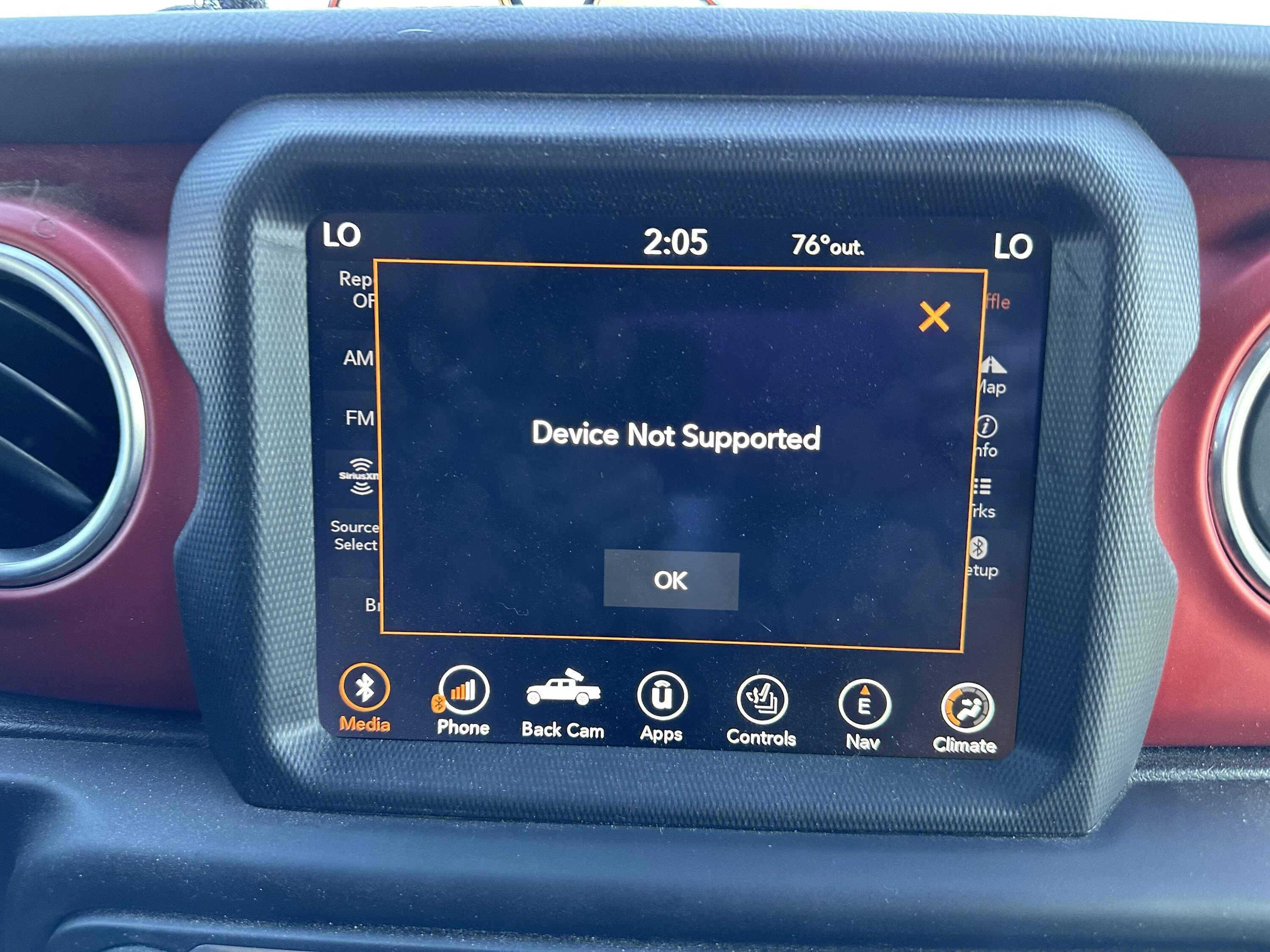

So I jus Stopped to check in on this because my 2020 Rubi which has been working flawlessly up to now, just started doing this on the way back from a camping trip. Dashboard usb, IPhone ProMax 14, iOS 16.0.3, 8” headunit.
