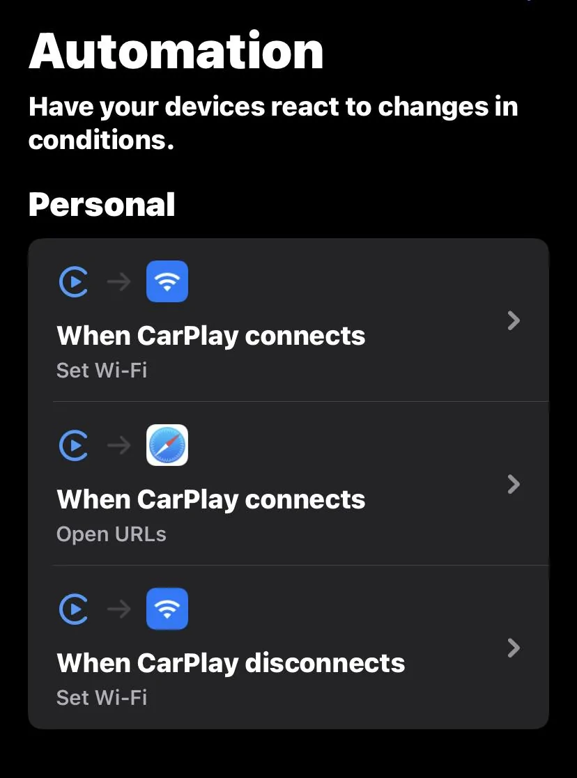

I found a little work around for my issue, I resorted to only using the USB 1 port and created a shortcut on the iPhone to shut off WiFi when Carplay is connected and it turns WiFi back on when its disconnected . It only happens once or twice a week now instead of multiple times a day like before. (forgot to mention i had to set it to open Pandora website, not the app) and i just read about turning off bluetooth but that would interfere with my watch but it could be added to the automation as well

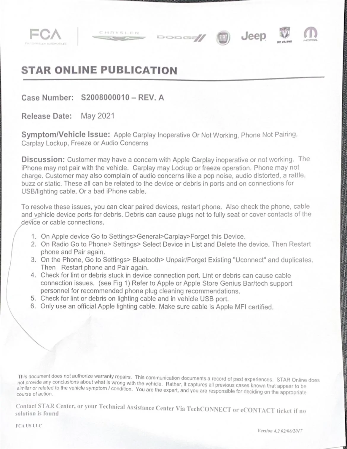

There is a troubleshooting procedure my dealer gave me when they said they’d need 6 hours to look at it. It was essentially update the phones software, unpair from the UConnect and the Phone, repair and advise back.
It immediately stopped working with the console USB port, but seems to now work fine with the USB port on the dash. I’ll switch back to the console and report back, I’ll also try and upload the troubleshooting documents given to me by the dealer.

FWIW, here is a pic of the form I got from my service advisor. The freeze has only happened once or twice since.
Tried this, doesn’t work unfortunately. Continue to have multiple freezes on each 5 min drive.
Mine only does it with the the center console usb, all others work flawlessly but I don’t like the messy cable look.
