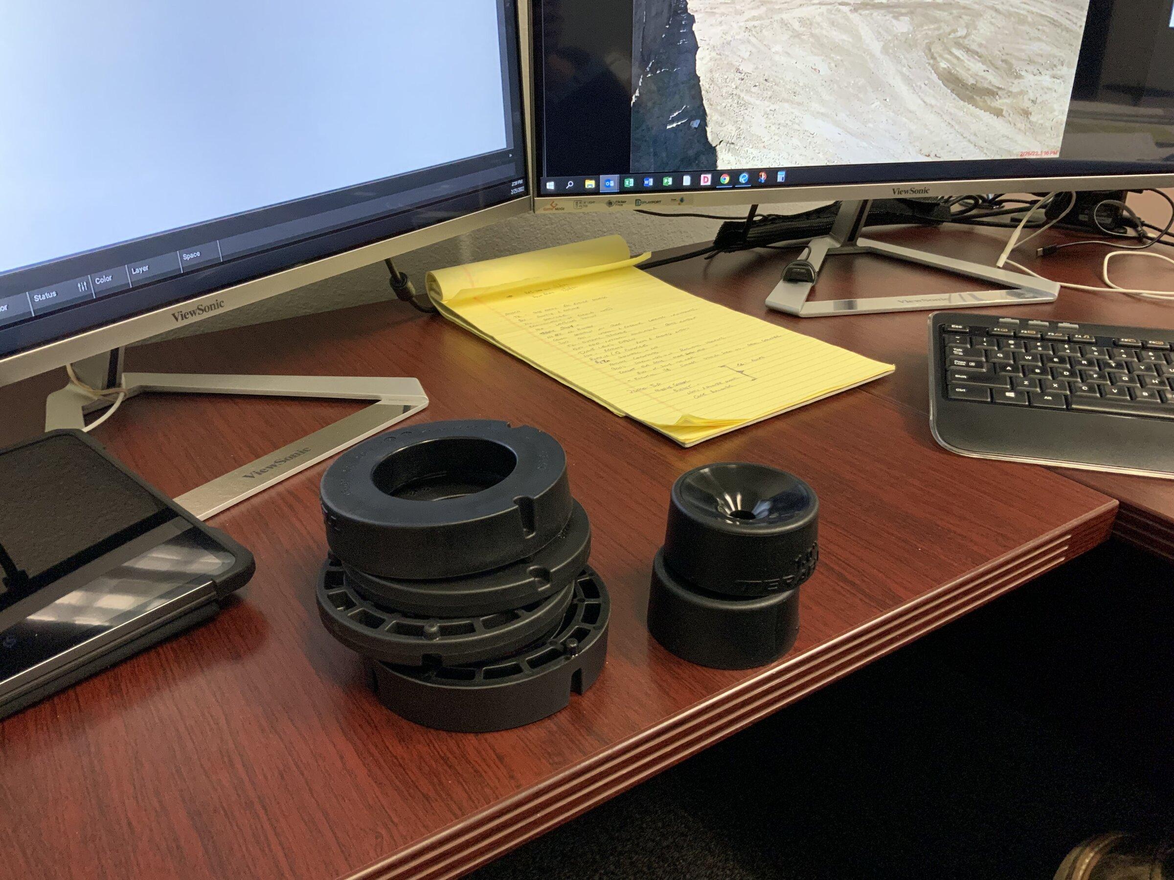

Ok, I see what I was missing. The kit comes with 1” bump stop extensions as well. Any harm in leaving these out?
if only going to run 35s, you’re fine.
37s and you probably will need them. Any comment as I’m still on 35s
