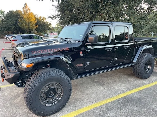

I'm in(was) is same boat. I went with the AEV 2", geo brackets, 37s and 4:88s. Love the setup. One day, I plan to go 3-1/2", but would swap the shocks out, add arms, etc. Before the AEV, the 35s I had fit fine.

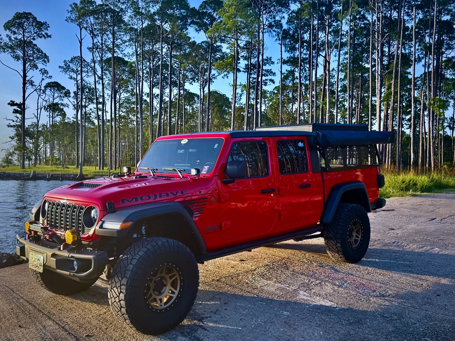

I went with the AEV 2” spacer lift so I could keep the Mojave suspension. I also added Falken wildpeak RT01 in 35x11.5 so I could use my stock wheels. The two changes together did make the ride slightly more rigid but I like it because it doesn’t float around as much as it used to. It also eliminated the leftward drift I had.

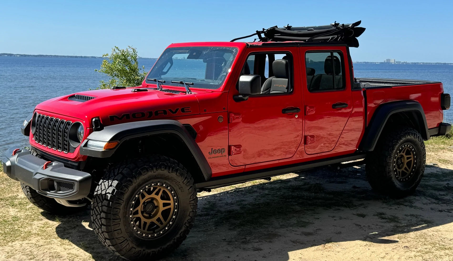

I put the same kit on my 24 Mojave as well as well as the Geo correction brackets .I'm still on the stock wheels and tires until i figure out what I'm leaning towards tire wise. Seems to be as good as stock.
