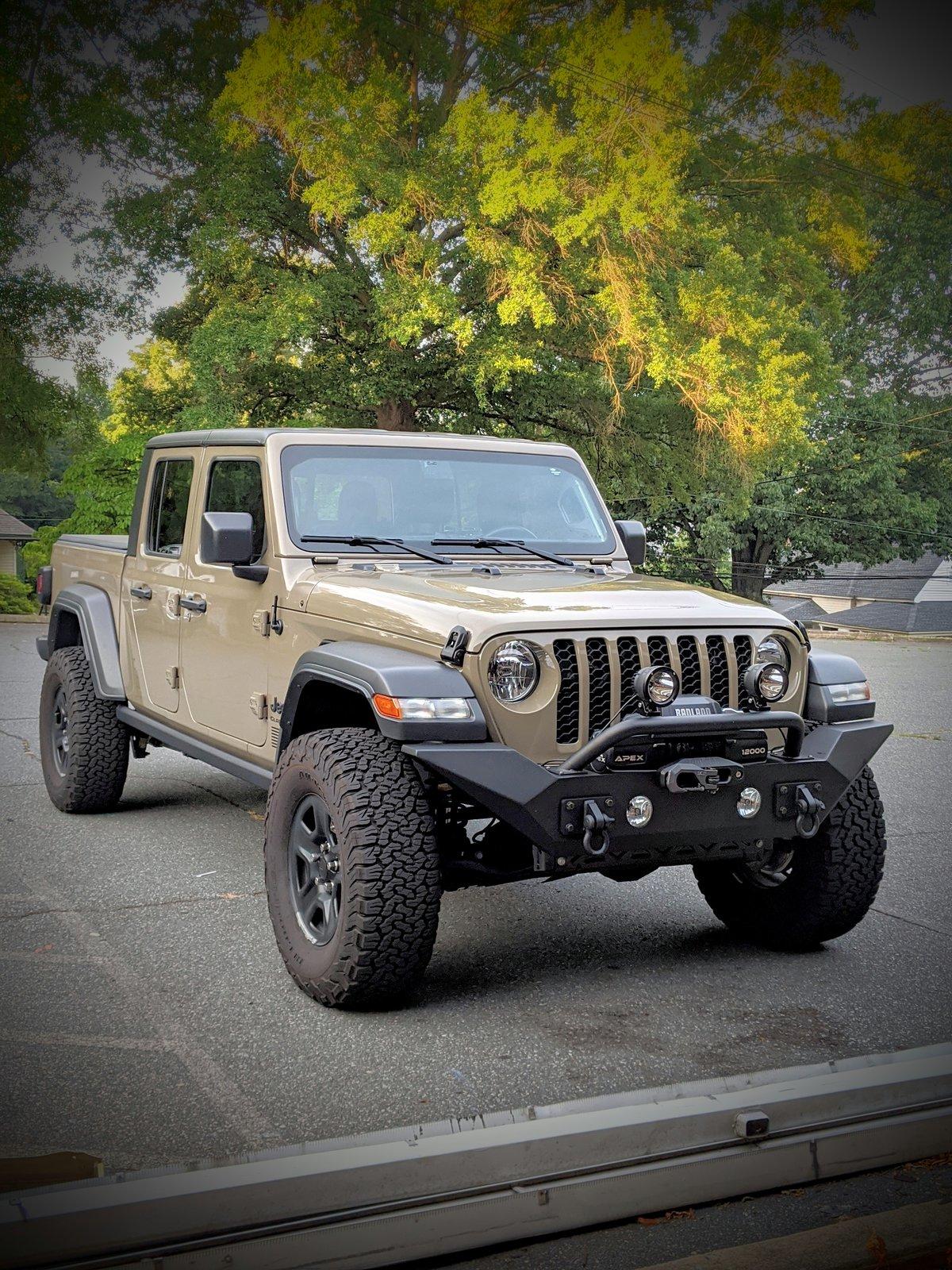

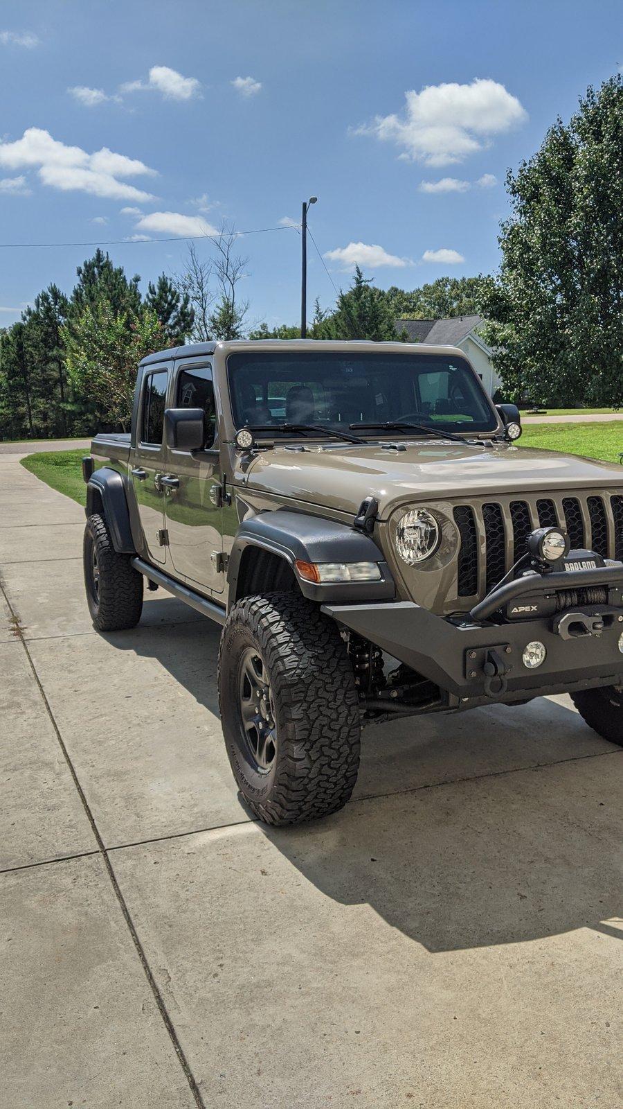

I had just the 2.5" ReadyLift sst kit installed on mine and complete with install and alignment I was out the door at $801. I added Rubicon take off front springs and shocks and I'm all in at $1095. Here are two pictures of mine with just the 2.5 and with the Rubicon springs added to the front
2.5 Ready lift sst only
Jeep Gladiator Lift kit recommendation 00000IMG_00000_BURST20200704070254346_COVER
2.5 ReadyLift with Rubicon takeoff shocks and front springs
Jeep Gladiator Lift kit recommendation PXL_20200913_173326147
The Rubicon front springs helped level it out, I still got a 1/4" of rake but that's what I was looking for for towing purposes. I also have 1.75" wheel spacers installed and I have a Max tow.
