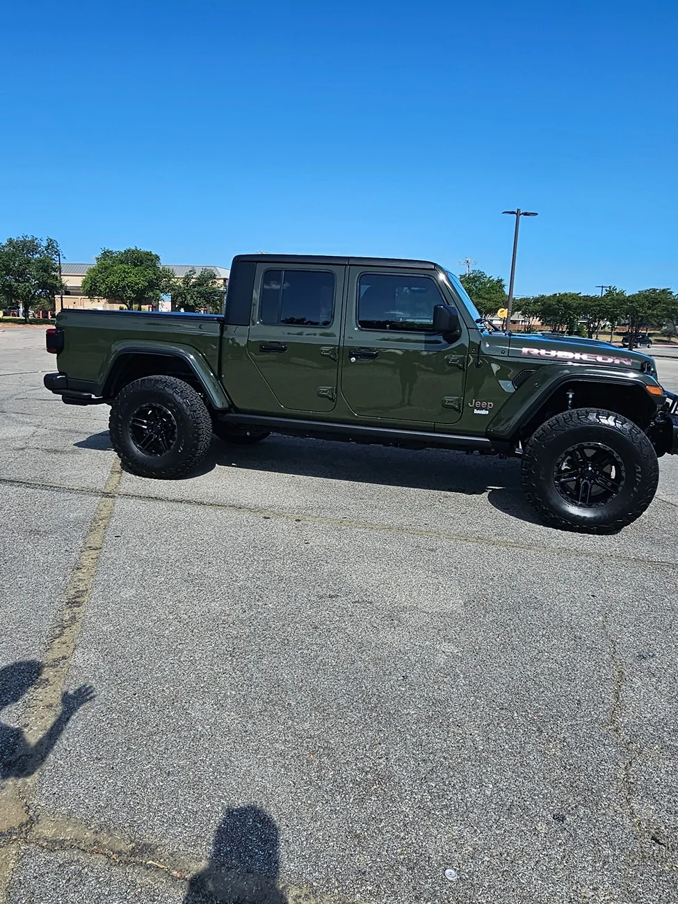

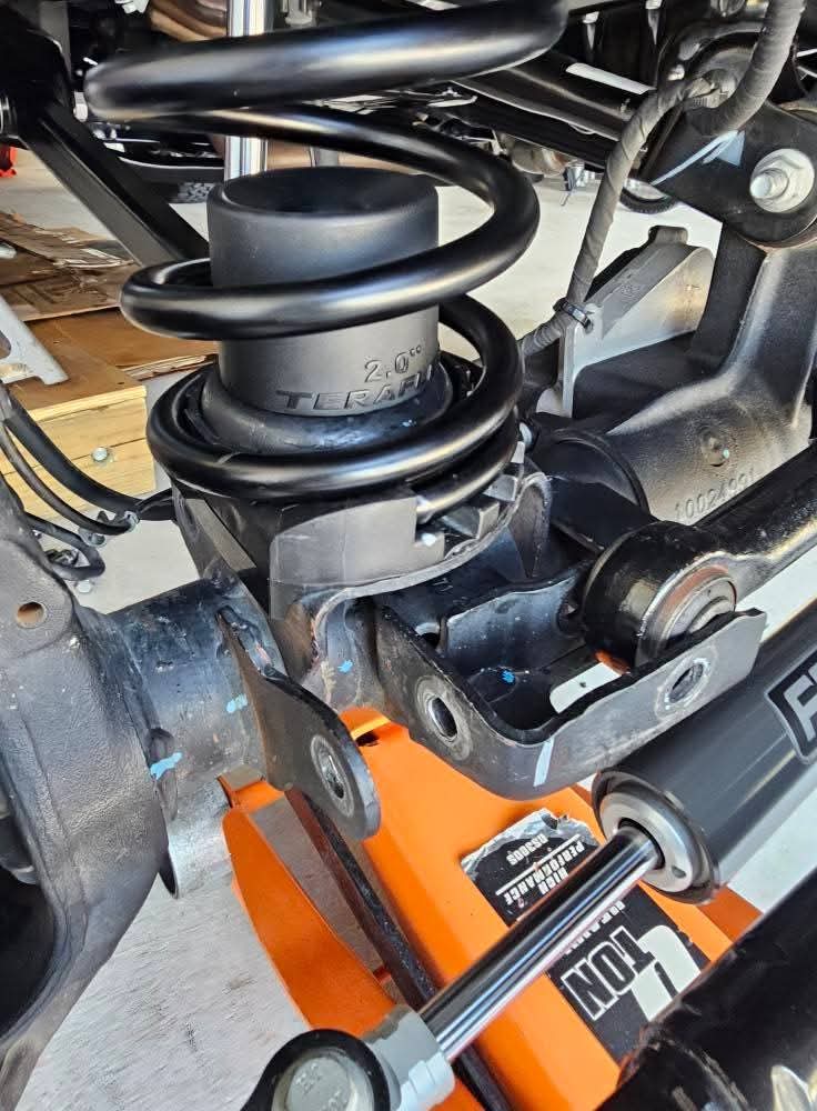

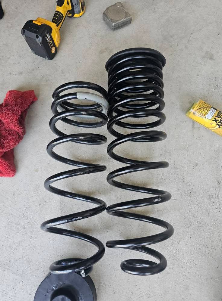

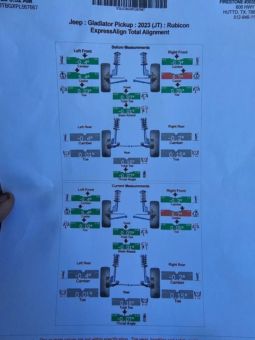

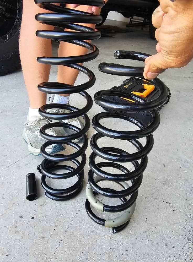

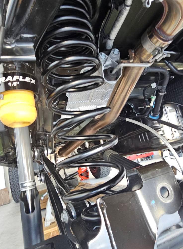

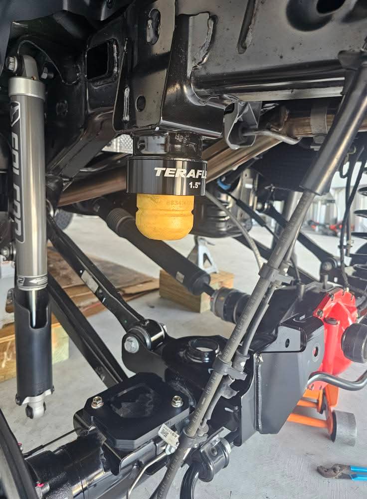

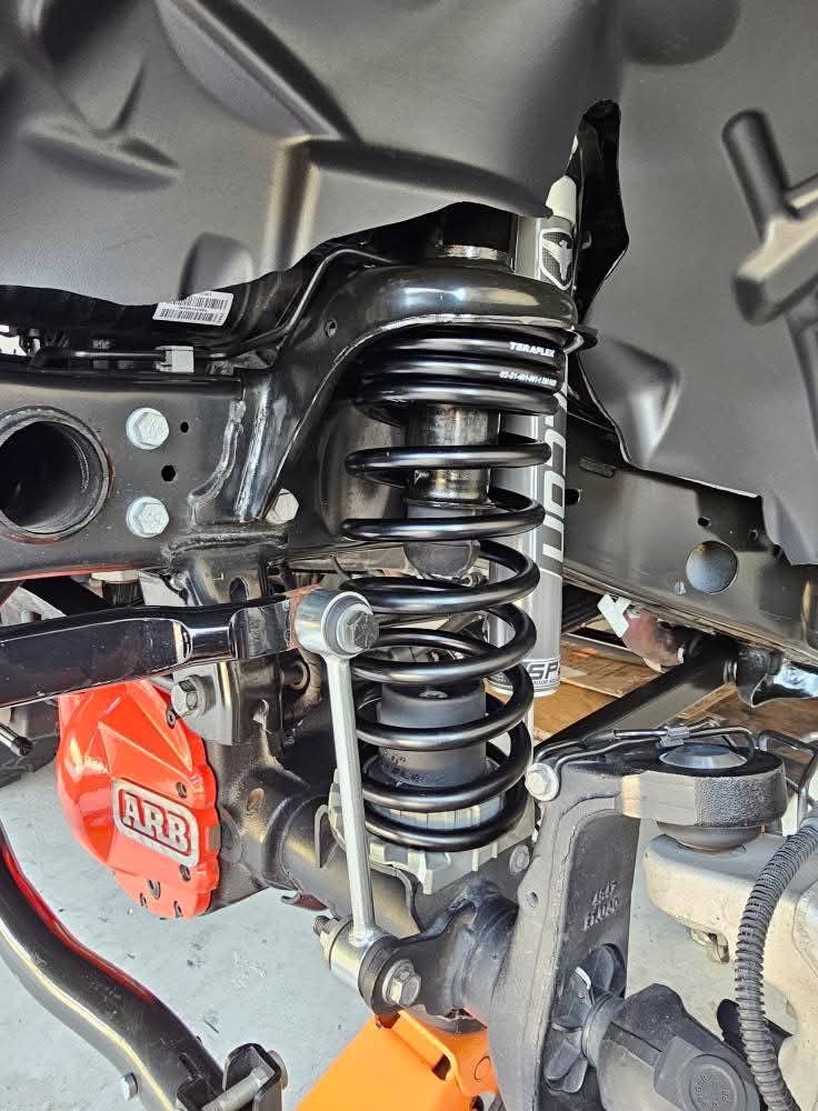

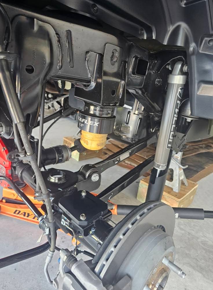

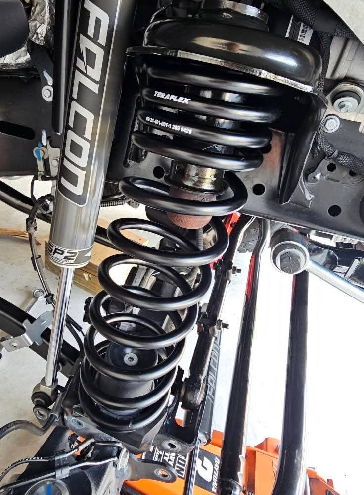

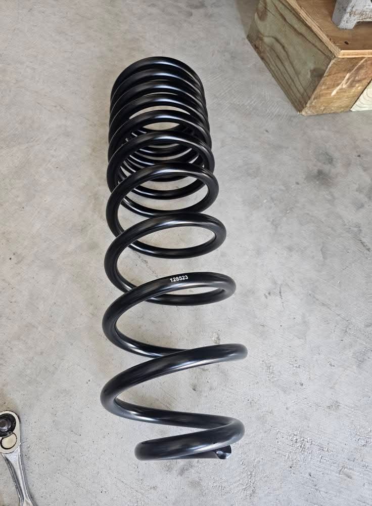

Installed springs and new bunpstops. Went from 42.5 to 44 from bottom of tire to bottom fender. Basically a true 3.5 of lift final height. Front sits right at 0.25 higher now.
Question is my caster went from 4.8 degrees on the left front to 5.4 and 5 degrees on right front to 5.7 from previous alignment on 2 inch pucks. Noticed sure how I gained by using the same lower control arms from the Mopar 2 inch lift.
I did have to adjust my trackbar just a little because I was off almost a half inch. Drives great just really weird.

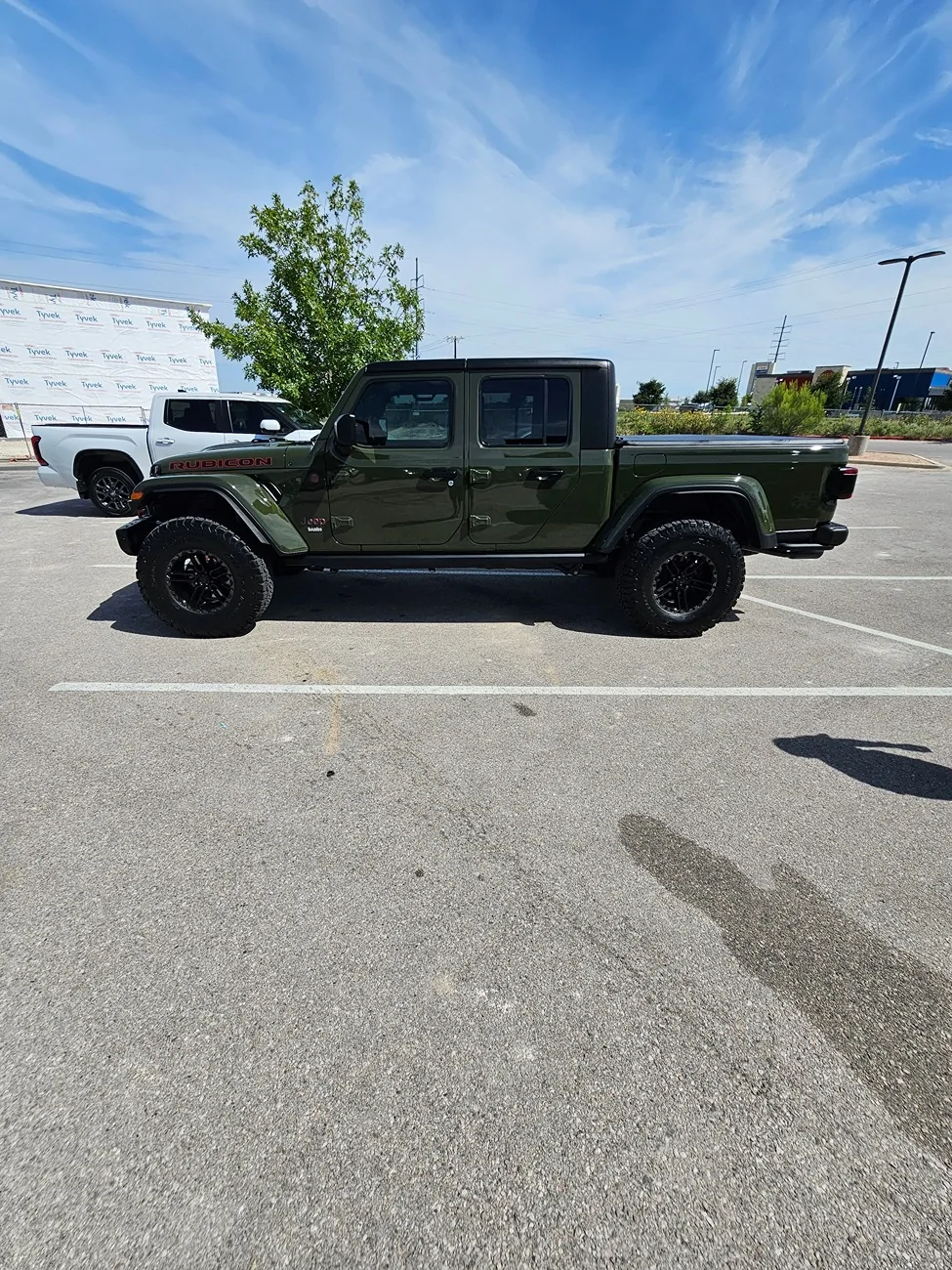

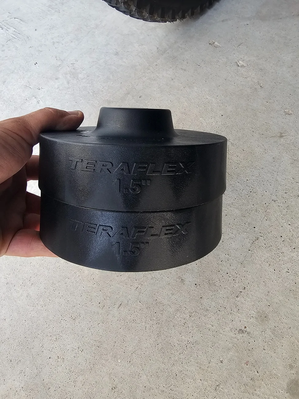

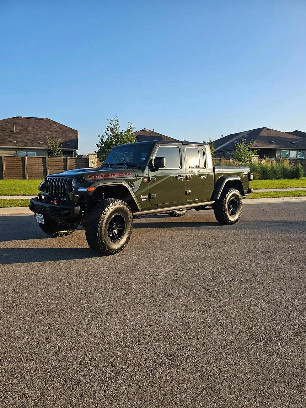

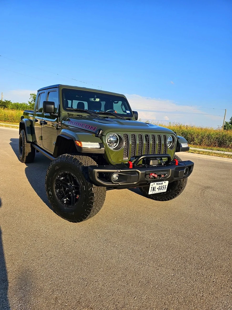

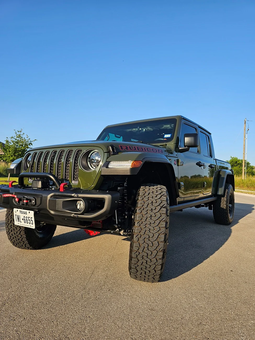

Lifted rear with 2 inch ICON springs and took those 1.5 pucks off. Perfectly 43.5 in rear and 43.75 in front. As level as she's going to be. I'm happy with it. No more stupid rear rake.
Jeep Gladiator Lift kit. FB_IMG_1755690776017
Jeep Gladiator Lift kit. FB_IMG_1755690778929
Jeep Gladiator Lift kit. FB_IMG_1755690789212
Jeep Gladiator Lift kit. FB_IMG_1755690792546
Jeep Gladiator Lift kit. IMG_20250820_065449
Jeep Gladiator Lift kit. FB_IMG_1755690782427
Jeep Gladiator Lift kit. IMG_20250820_070436
