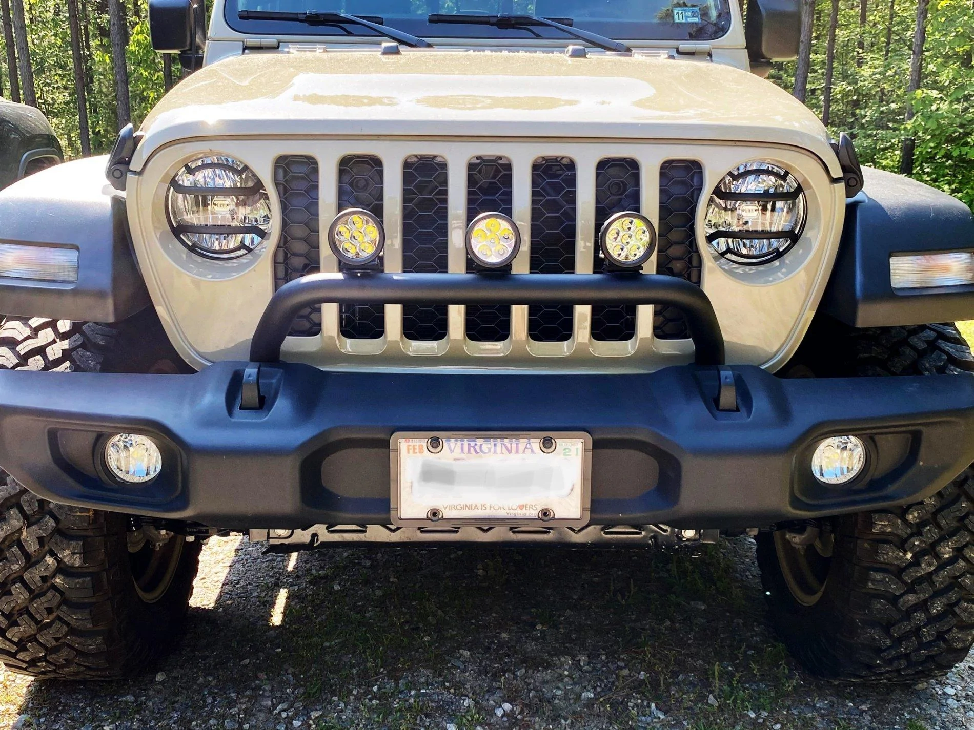

I fabricated one using Stainless Steel Tubing with parts purchased off Amazon. I used the Mopar frame mount for lights to attach the bar.

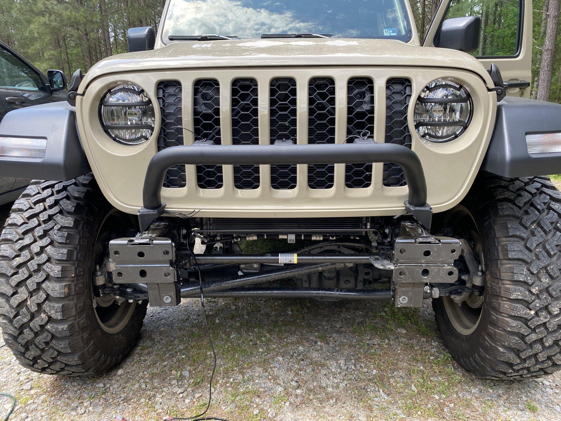

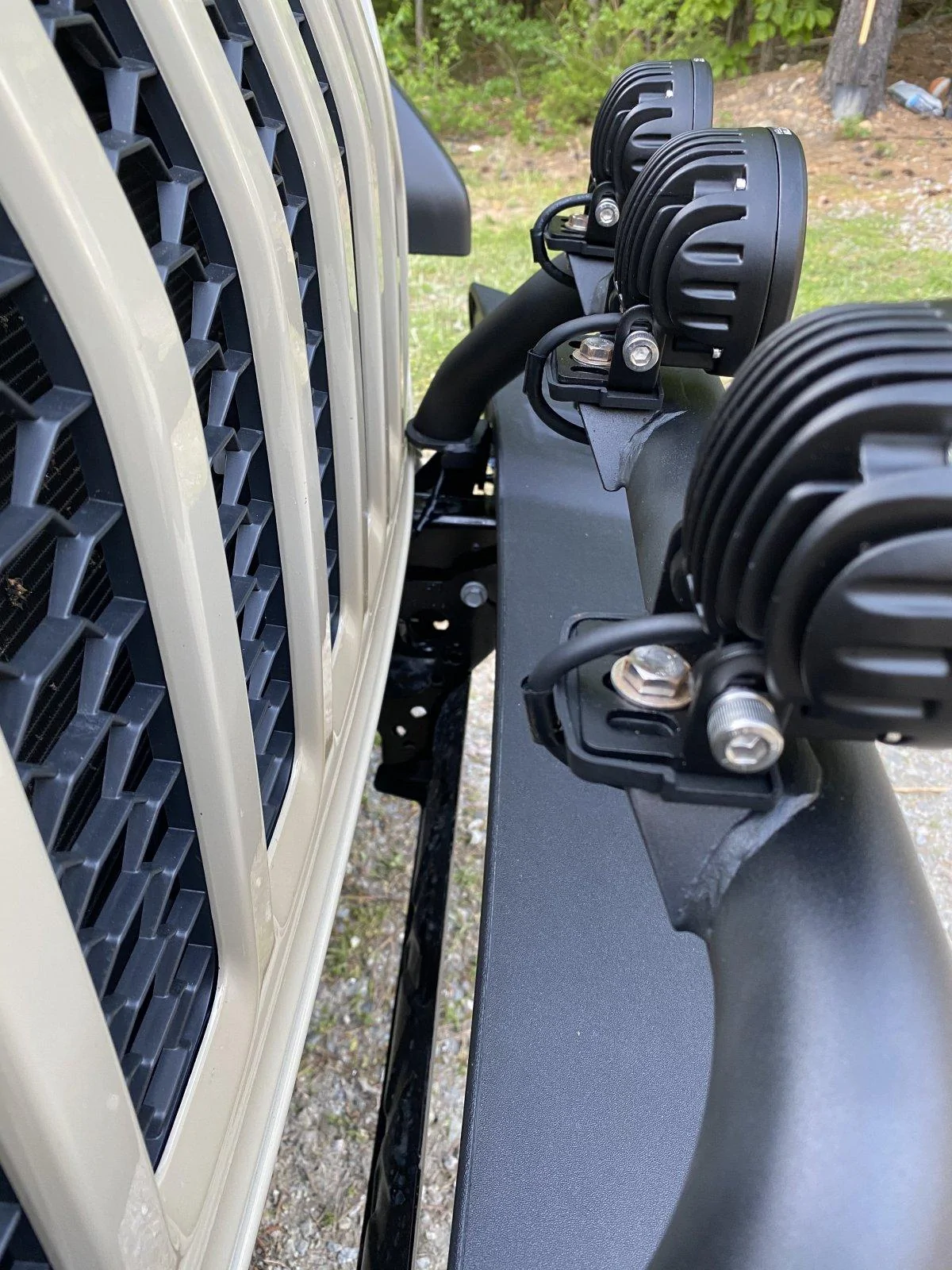

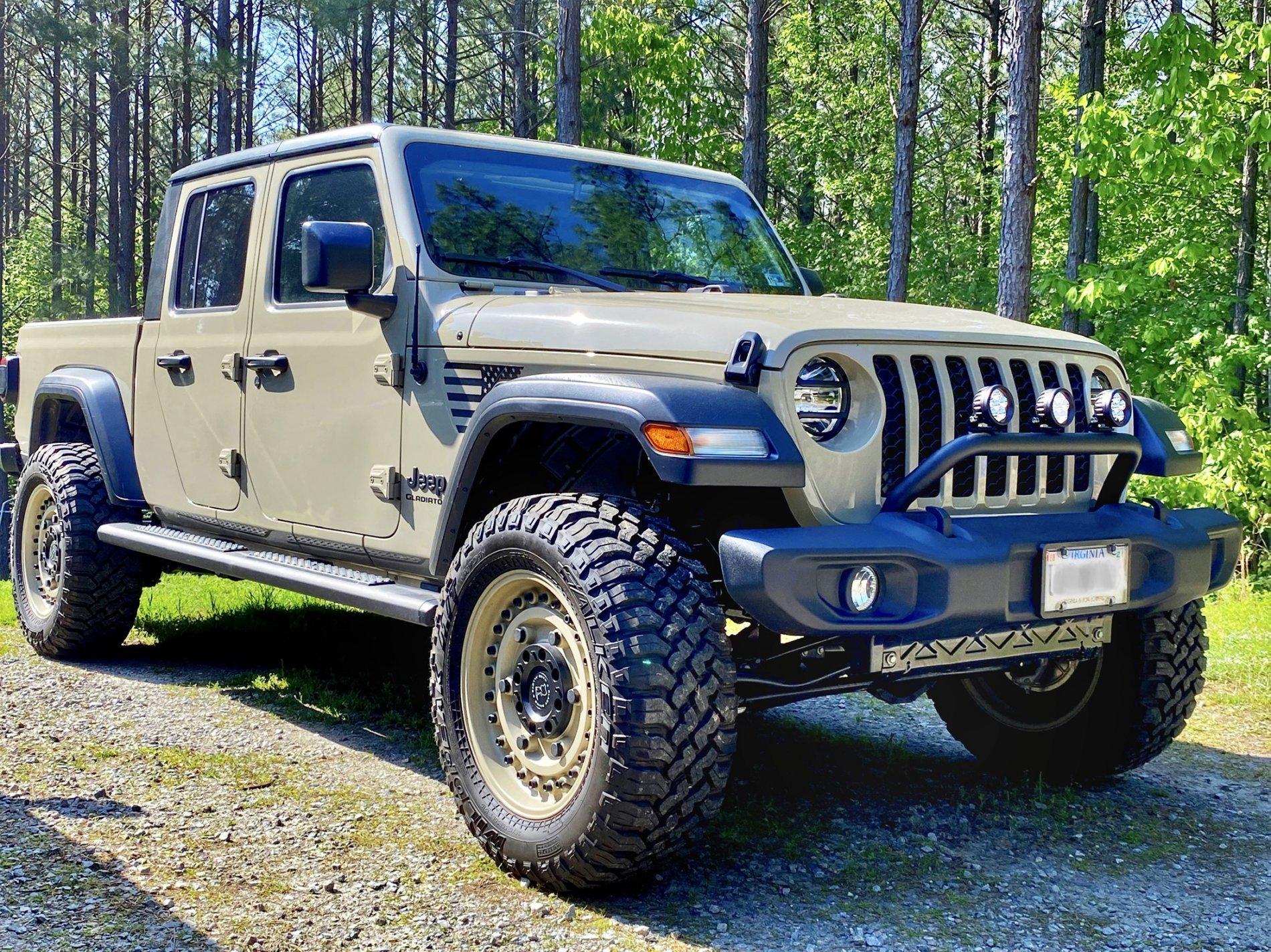

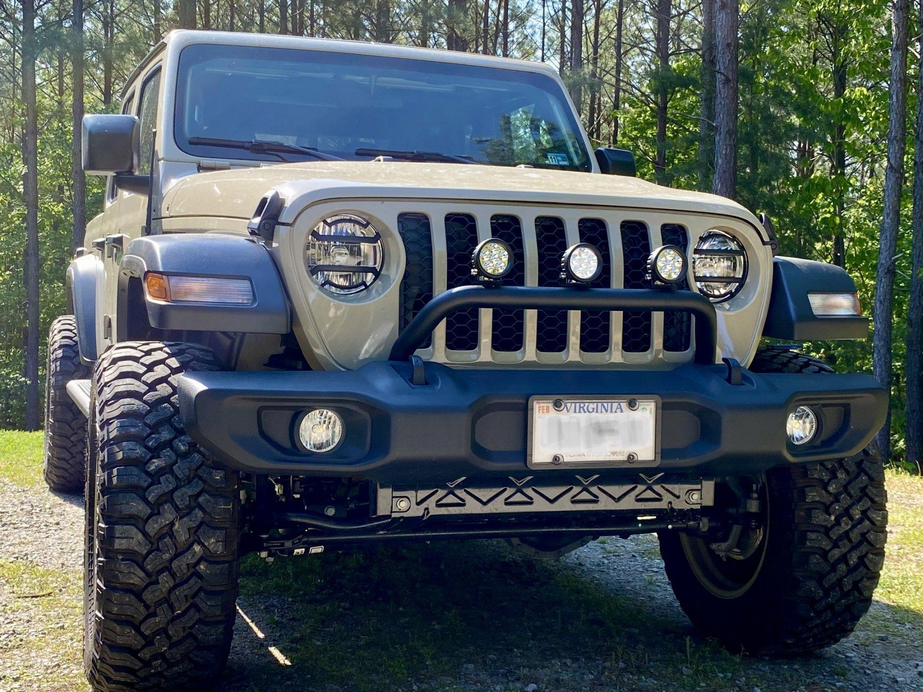

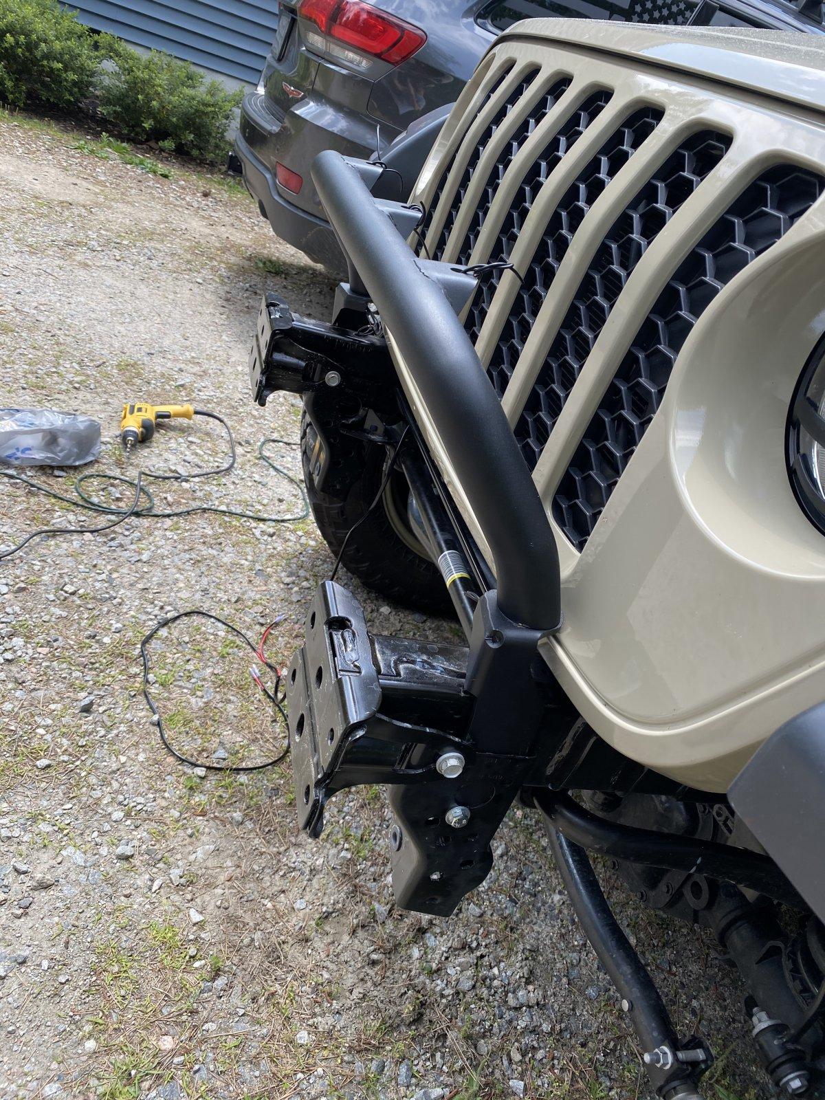

I was able to make the light bar from a JK fit with a little tweaking... pleased with how it came out..

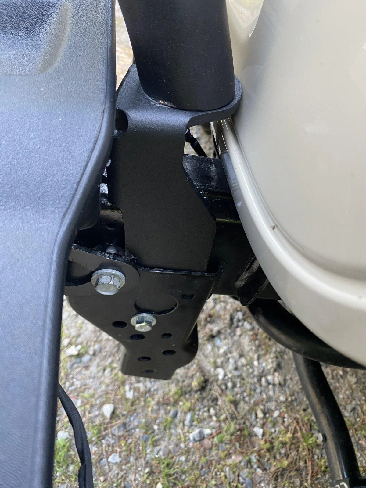

This is the Westin brand, there is a rugged ridge and a Mopar one... the Mopar also works as far as I know. I chose this one because it has a smooth finish where the Mopar has a hammered look.
You basically have to remove the front bumper and turn the brackets the right way To make them fit. Once this is done the holes don’t line up. However there are holes in the frame which you can use. Just have to drill the bracket and use the right bolts.
It’s really not hard, just takes a little visual planning and figuring. Once you get it and look at it you will see how to make it work.

couple more pics
