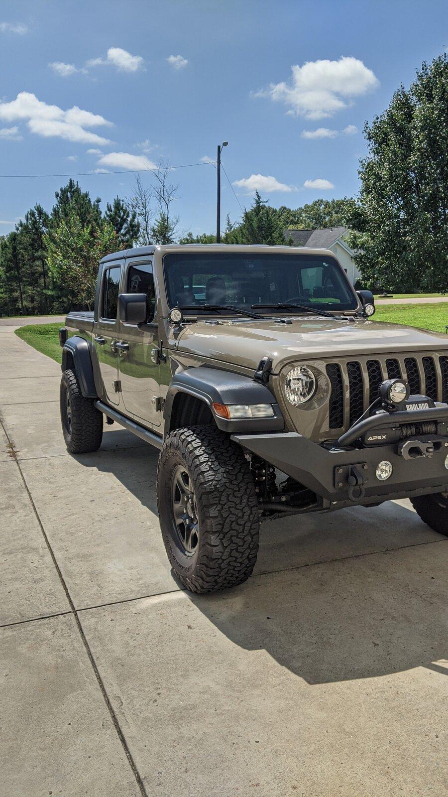

I'm running 315 70 17 BFG KO2s on mine and the 4.10 gears are plenty. I average about 18.5 to 19 mpg on those. I will be going to 37's when these wear out. I have got right at 21 mpg on a 6hr trip. Here's how it sits currently

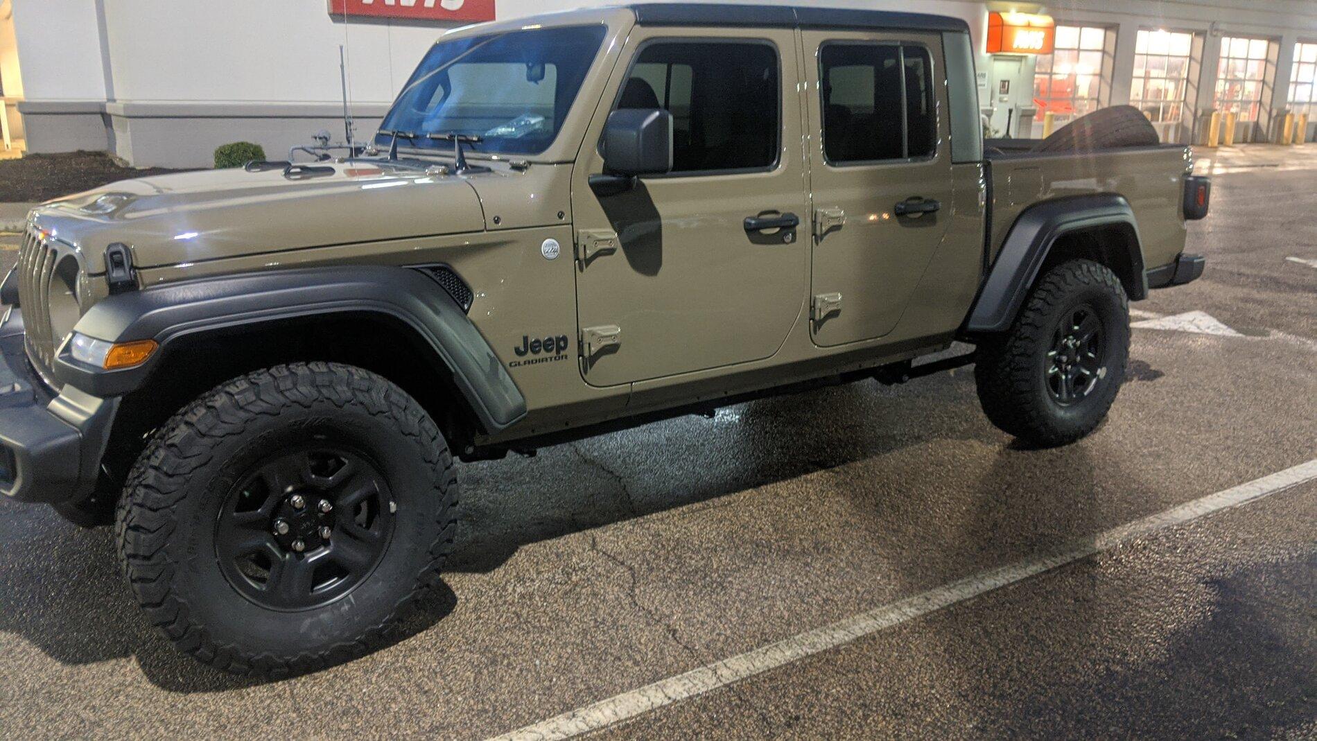

Here it is sitting stock with no lift the day I had the tires installed. If you got a Max tow and trim the bottom of the air dam a little you will have no issues fitting 35's and have no issues with rubbing.

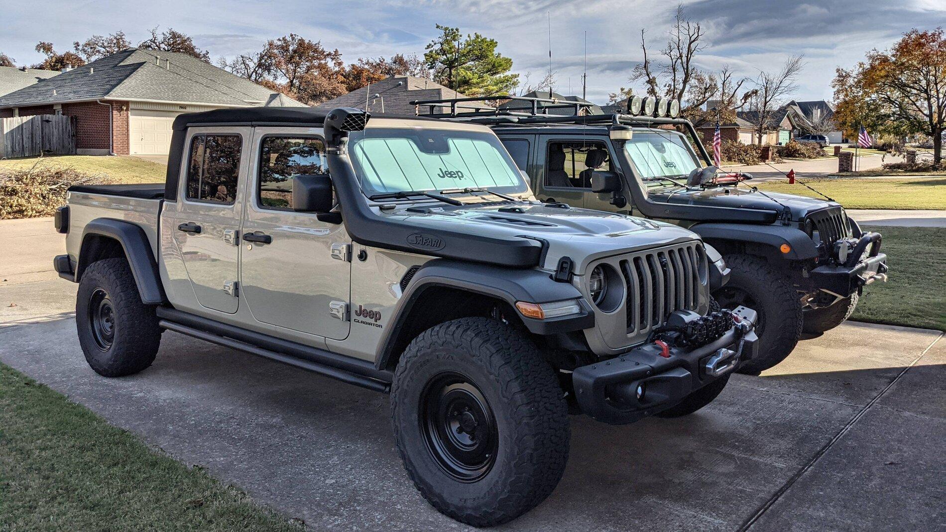

Rubi's can come with 4.10 gears or 3.73s (optionally). Rubi's can fit 35" tires without a lift. There may be mild rubbing at hard turns if you run stock wheels (or wheels with the stock offset). Here is my JT with Fifteen52 Analog wheels and 35" tires and no lift. It sags slightly in the front due to rock rails, dual-batteries and the winch and steel bumper (came from factory with plastic). It has plenty of acceleration with 4.10 gearing and those tires--but bear in mind that I also drive that 2007 JK with the the same tires, 3.8L motor, 4.88 gears, and way too much weight for a sensible overlander. The JK is a slug in comparison. I will install a 1.5" Teraflex spacer leveling kit once I receive the special torque wrench that it takes (one with angle measurements). If you're not familiar with that kind of torque wrench and do your own mods, might want to get on the order list for one. They seem to be all the rage in new vehicle torque specifications these days (i.e., torque XXX bolt to 100ft-lbs then 125°), and a lot of higher quality models are in short supply.
Jeep Gladiator Long Time Jeeper | Just Joined The Gladiator Club Driveway Poseur Shots, Nov 20, CP_954538, Jeeps and Clouds
If you'd like to see how the JT does for overlanding (including Black Gap, a Jeep Badge of Honor Trail), here are a couple video teasers for series I've made. Mods were in progress when these were filmed ...
