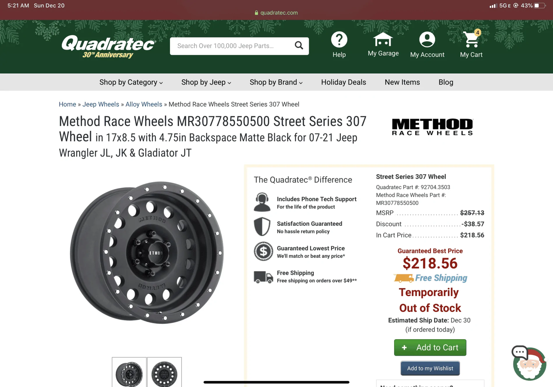

Does anybody know if this is the proper size wheel?
OP OP Ocotillo Boy Member Joined Dec 1, 2018 Threads 1 Messages 23 Reaction score 34 Location So Cal Vehicle(s) 2012 JK Rubicon, Jeep Gladiator Mojave Occupation Machinery Mover, Rigger Dec 21, 2020 Thread starter #16 Does anybody know if this is the proper size wheel? Sponsored

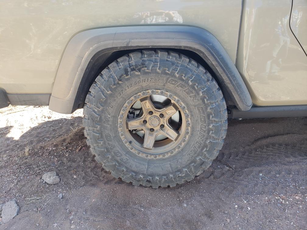

MoparToYou Well-Known Member Joined Aug 11, 2020 Threads 3 Messages 223 Reaction score 528 Location Utah Vehicle(s) 2020 Jeep Gladiator Mojave Dec 21, 2020 #17 The front has more clearance than the rear. I showed only the rear because it is the tightest clearance. That wheel would work. The "perfect" wheel in my opinion would be a 17x9 with a +12 offset. The closest I could find in a style I liked was a 17x9 with a +1 offset.
