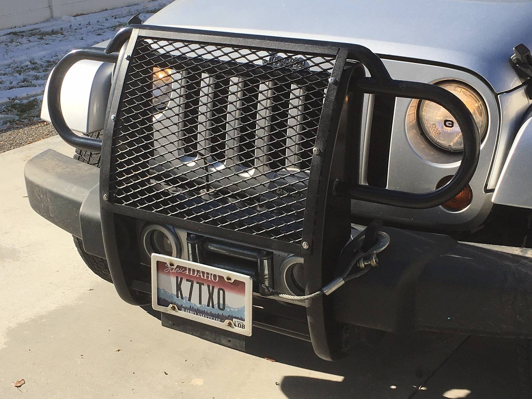

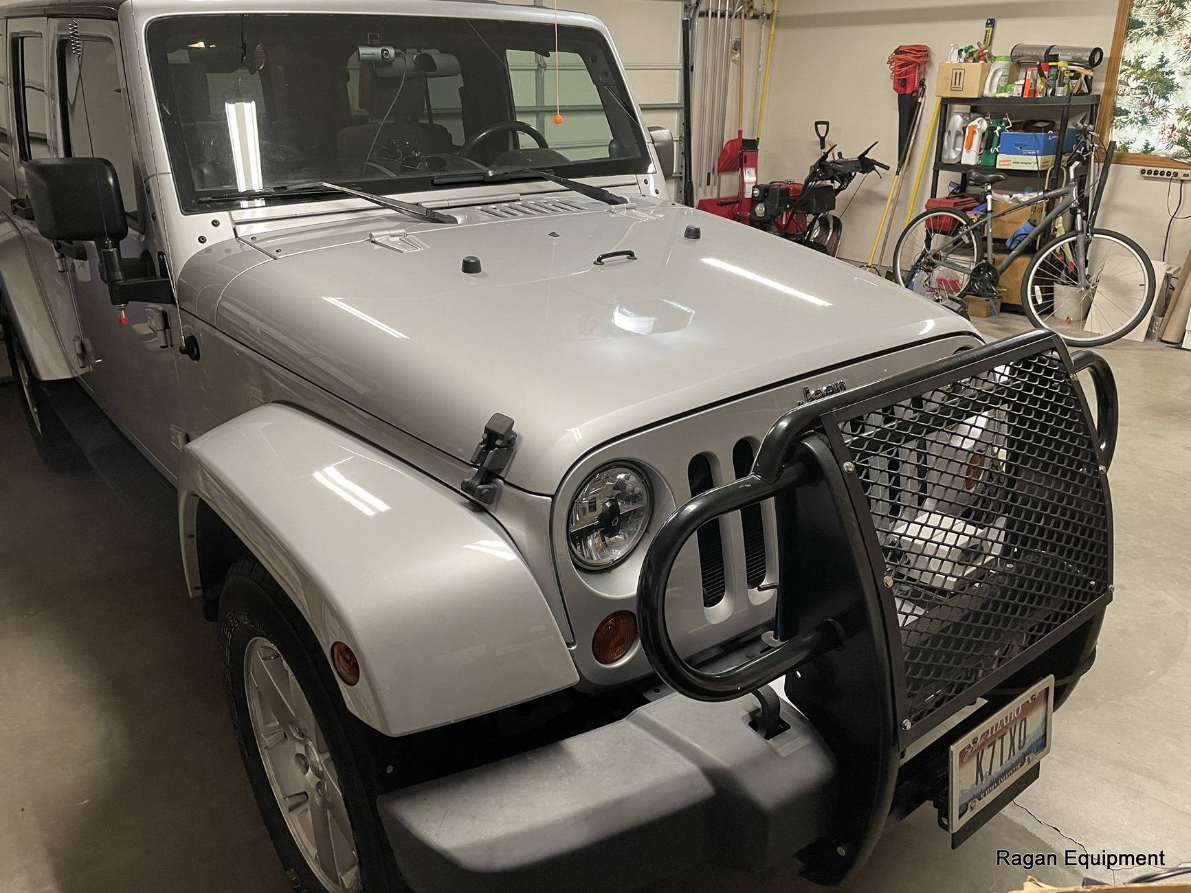

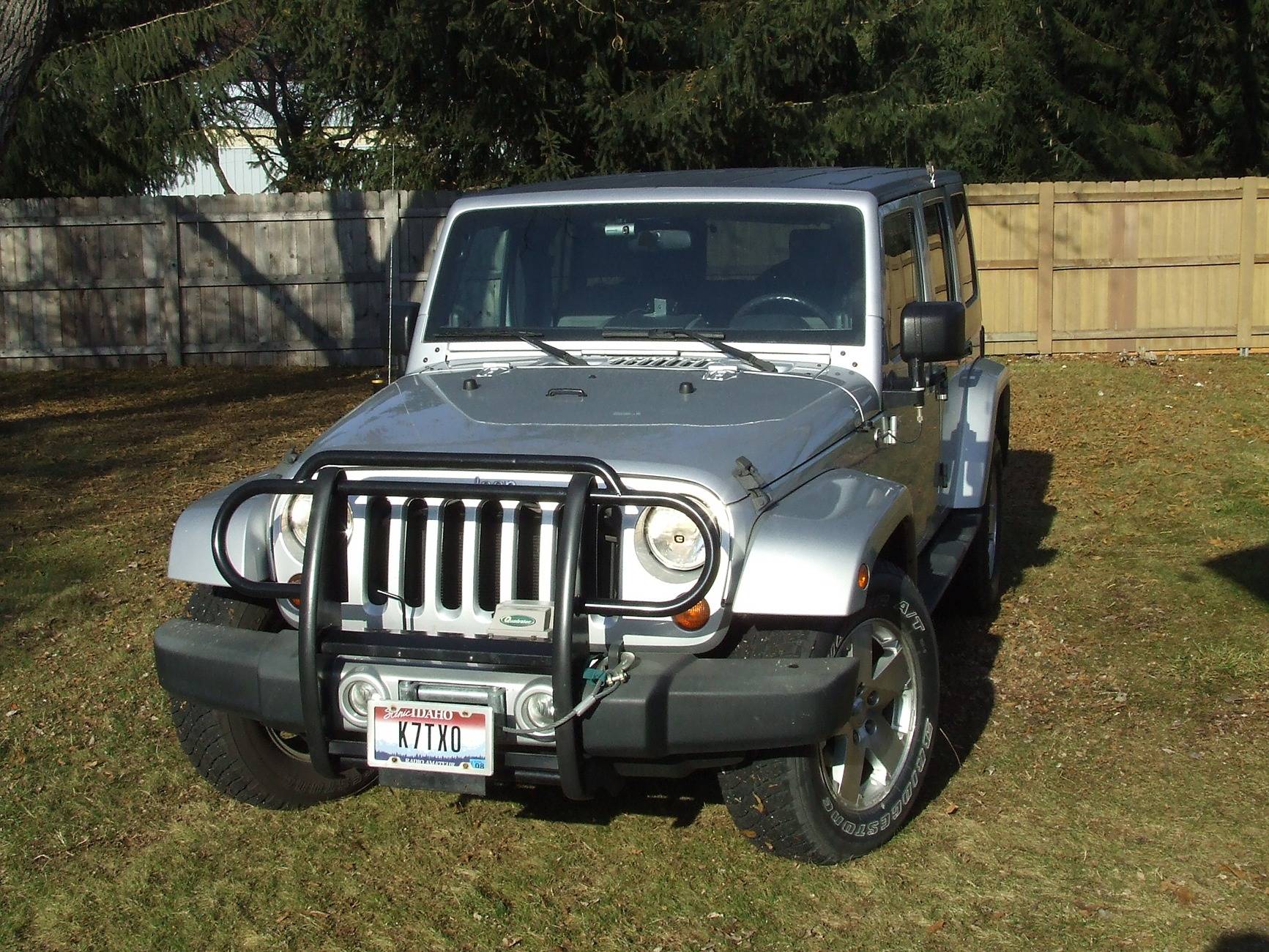

Years ago I was doing on the order of 50 mph on a road. A bird flew out from the side at just the right instant to smash into my JEEP JK's front grille. There was not time to react. It was also dusk so the visibility was already compromised. Just a glimpse of a dark object and bange. I pulled off the road. Engine was still running. Walked around the JEEP and saw the plastic grille was busted about dead center of the 7 bars by a Grouse, Hit the AC condenser but looked ok. Not the bird... it was dead. Removed the bird. Drove on to my destination I think maybe another 50 miles. All seemed fine. But the AC condenser had a tiny leak. This was in 2020. $985 for a replacement, painted grille, new condenser and freon charge at a local car dealer. I am sure today, this might be double in price, or more.
Anyway, I added some low cost "insurance" to the front of that JK. Steel grille guard that is sufficient for bird hits. Maybe a small deer at 15 mph or less, without damage to the JEEP but would it do good at 25 mph? There will be damage but likely a bit less to the JEEP itself. Above 25-ish mph, forget coming out unscathed. But then a JEEP or any vehicle is frankly, a disposable item. Hopefully occupants are ok which is the only thing that really matters.
Note that in the included picture, I added an expanded metal screen. Depending on driving speed, this will handle most bird hits IF, by the unlikely chance another bird hits me in the same area.
I have a winch. Located behind the disposable and cheap, factory bumper. I figure if an animal or just common parking lot bumper hit happens, I can get a new one or just find a decent used one in a bone yard. I have a heavy duty, hinged license plate holder, welded to a square bar I added to my grille guard. the license plate holder hinges down to allow the real-steel winch cable to come through. At the same time, the 1/4 inch thick plate used for the license plate when it is open-down into its horizontal position, makes a terrific step. Doing any work in the engine bay from the front of the JEEP is greatly enhanced with this step up. A cool piece that I transferred from my old DODGE Power Wagon.
Jeep Gladiator Looking for aluminum Ranchhand style front bumper/grill guard grille screen_2.JPG
Jeep Gladiator Looking for aluminum Ranchhand style front bumper/grill guard 2018 Nov 9 Jeep.JPG
Jeep Gladiator Looking for aluminum Ranchhand style front bumper/grill guard 135000 miles_1 Sept 2024_low res.JPG

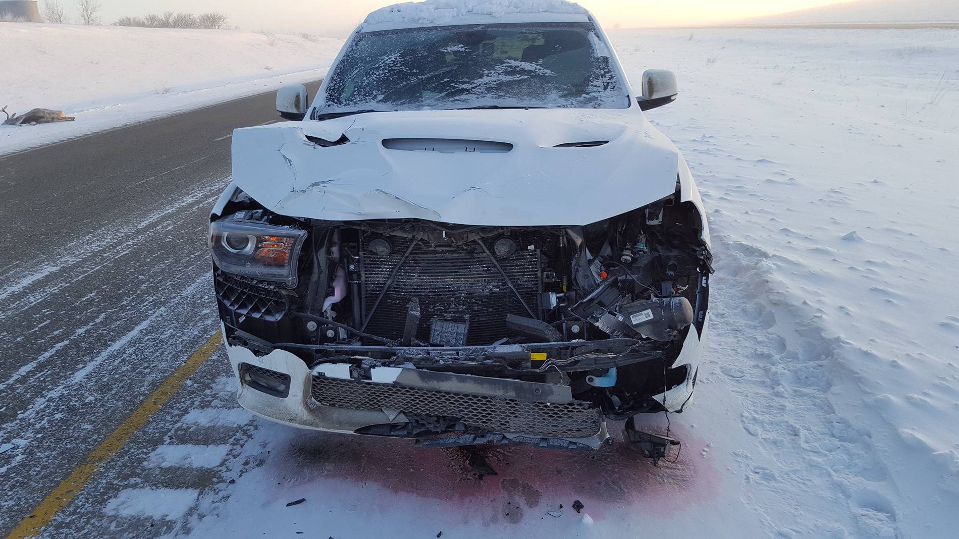

I have been looking for a bumper strong enough to minimize the damage from a deer strike for months, not much out there for the Gladiator, I finally settled on the ARB full width Classic, just waiting for it to arrive now.
I have hit a few large animals here in Alberta, Moose, Bison and several Deer, its mostly unavoidable. Luckily I had a very large, stout " FU " bumper on my PowerWagon that dealt out the punishment to would be wildlife that wanted to tango with me on our highways, but this Rental wasn't so lucky.
Jeep Gladiator Looking for aluminum Ranchhand style front bumper/grill guard 20200115_094701
Jeep Gladiator Looking for aluminum Ranchhand style front bumper/grill guard 20200115_094738

Wow all that stylish soft lightweight plastic sure did absorb a lot of energy! If you had a heavy duty steel bumper and grill guard, you might have bent the frame, or seriously damaged unibody if that was the case.
