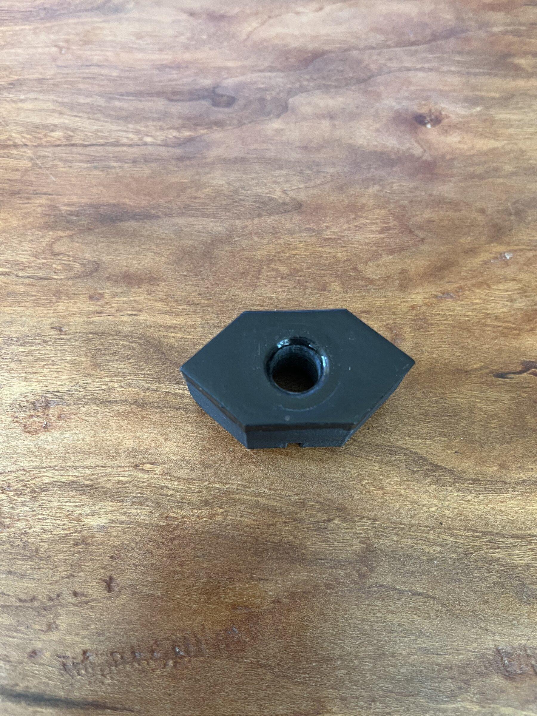

Actually, thanks for pointing me in that direction! That led me to eBay where I found these.
I’ve messaged the seller to see if he will sell me one individually.
I can send you one, I am not using them anymore. Just pm me your address and I will send it to you. Here is a picture they have a hole through from the light I had used.
Appreciate the offer but I already picked the one up from eBay. Can't wait to get this project underway.
